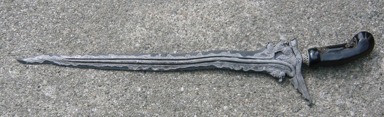

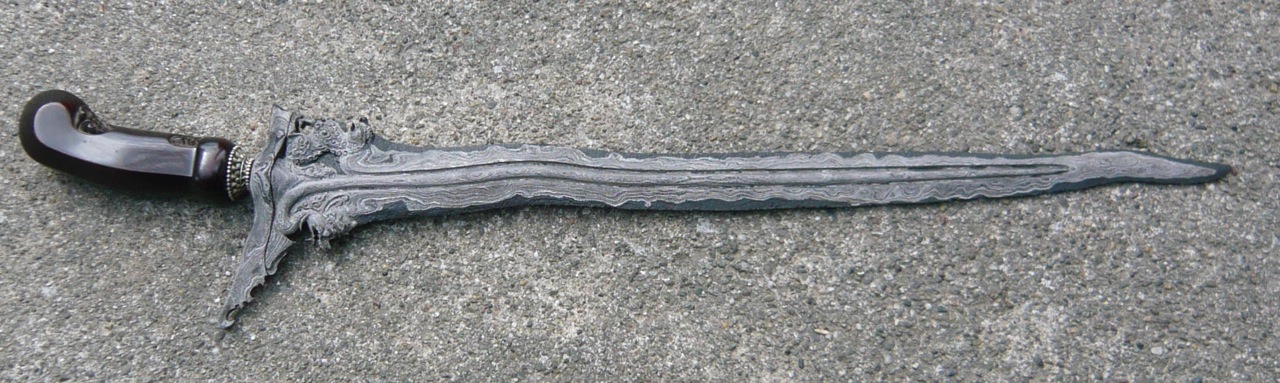

Dear Marco,
Basically, your keris has "two dhapurs" in one blade. That is luk three "naga" dhapur, and an "urubing dilah" or "damar murub" dhapur (one more luk almost in the tip of the blade) of "Singabarong" dhapur. Overal, this blade has five luks including the urubing dilah. In daily conversation among keris people in Yogya, and I think Solo too, also in Jakarta -- we call it keris with dhapur name, "dwi warna" (correction, not "dwi dhapur"), or keris with two dhapurs in one blade.
Why did you call it "panji kuda"? (Panji literally means "flag", and kuda means "horse"...)

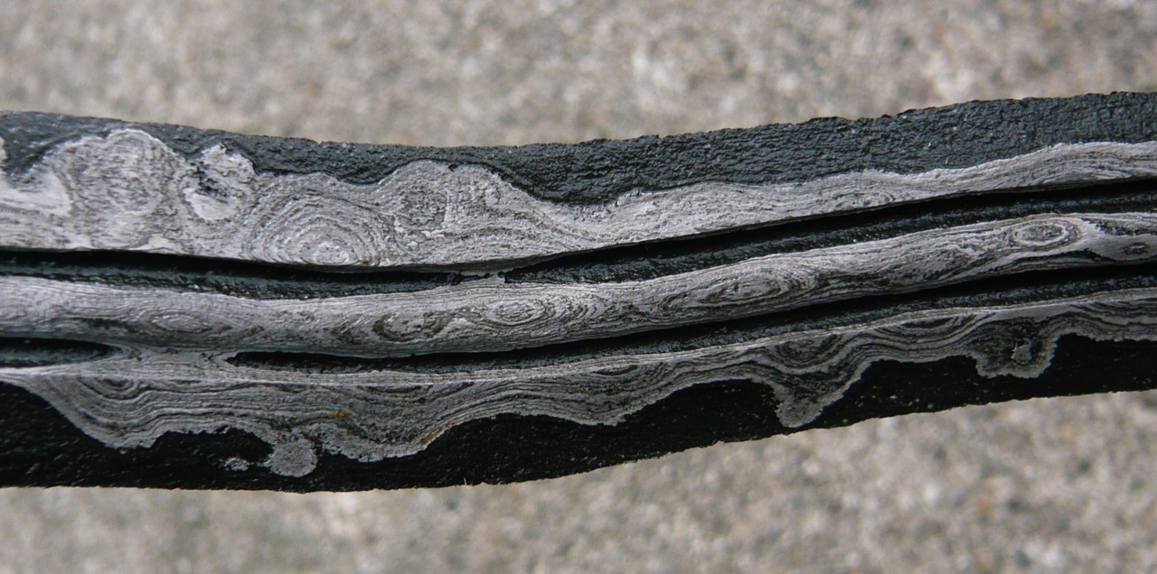

Lovely piece, congratulations! Love the hilt, mendak, sheath and blade.. that's about everything.. The blade layering can be seen very clearly with such nice photography, highly appreciated. Thanks for sharing.

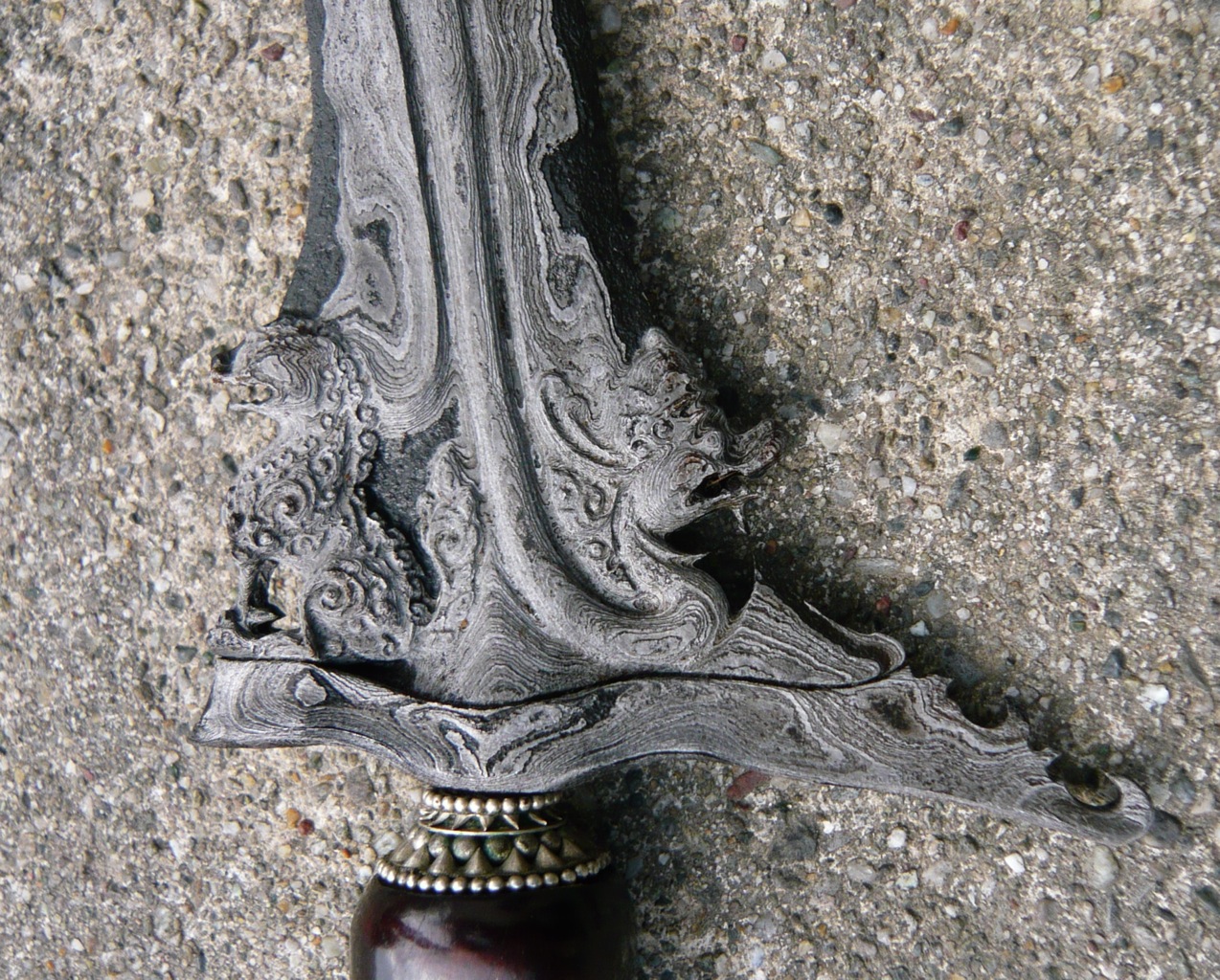

I find it really hard to tell much about the garap of this keris because of the confusing background ..
Would love to see it photographed against a solid background to really 'see' .

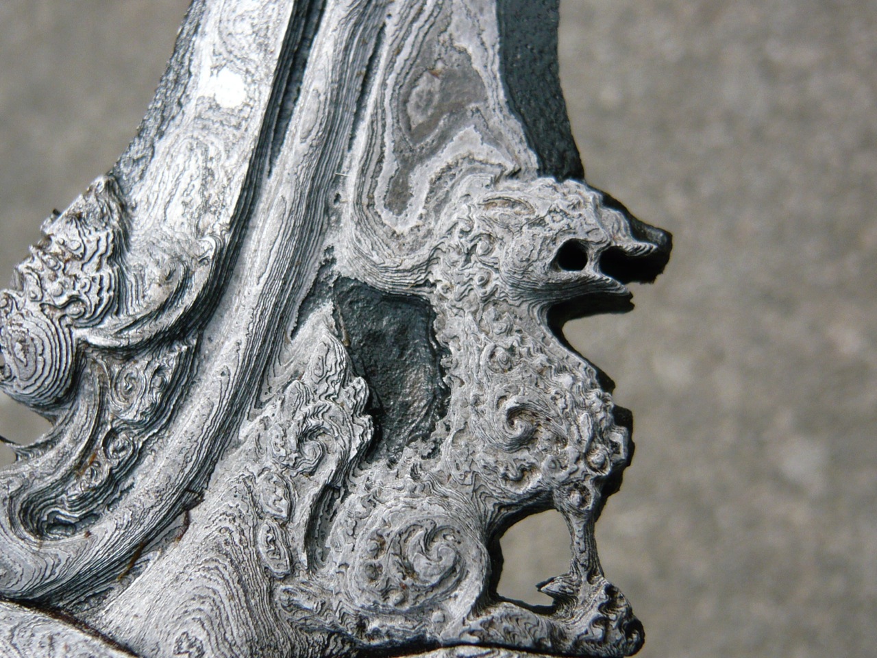

Marcokeris, I don't know which keris protocol you follow, so I don't know whether it makes any difference to you:
You may want to check whether the singa barong has it's vital organ ( although your second picture seems to indicate that it has).

.......( although your second picture seems to indicate that it has).
Yes ...but little

The blade has three arcs/curves from the base to the tip, with a straight section in the middle. The front edge has a lion at the base while the back edge has a jungle-king-serpent's head at the base, with its tail ending almost at the tip. The base area is decorated/adorned.The segment attached to the base of the blade has a curvy/wavy shaped bottom and its tail-end is adorned with fretwork.
