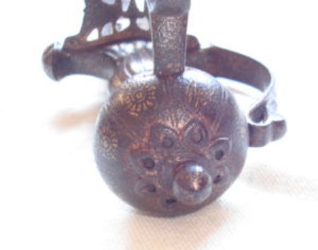

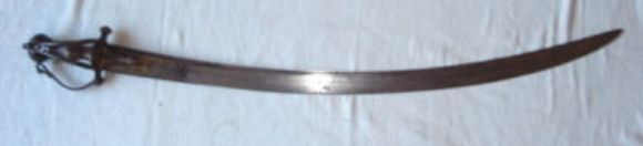

Hi
recently finished on eBay a seemingly very interesting and desirable Tulwar. Does anyone have any more details regarding the hilt.
http://cgi.ebay.co.uk/ws/eBayISAPI.d...MEWA:IT&ih=012
Thank you

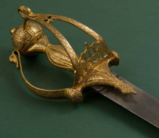

I saw this auction too. Here's a link to a similar one recently sold by Ashoka Arts:
http://www.ashokaarts.com/edgedweapons/ew-30.html

Ashoka makes reference to a Victoria & Albert example in Rawson, and notes the NW India attribution about end of 18th early 19th century, to which I completely agree ("The Indian Sword" . P.Rawson, #46, citing number I.M.98-1955).
It would appear that there are at least three, certainly likely more, of this exact hilt, and the Arabesque koftgari of course seems of Mughal style. I think Jens far better at assessing that characteristic, so that is just my guess.
As for the sword overall, the ebay example seems to have a British M1788 light cavalry sabre blade, and I have seen other hybrid sabres of NW India with M1788 sabre blades in other cases. One was a shamshir style hilt, solid steel with Indian tulwar quillons and langets. The blade had koftgari at the forte in similar fashion.

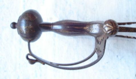

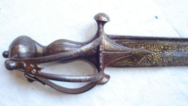

The "onion" hilt to me says afgani pulwar, so I would say a mix of indian and afgani swords. That side guard is what got me puzzled... Very unusual piece indeed.
Rick - the one from Ashoka is not the same one.
Included is another example I found online with all its gold work intact.
Alex
