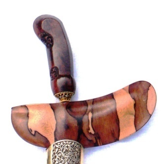

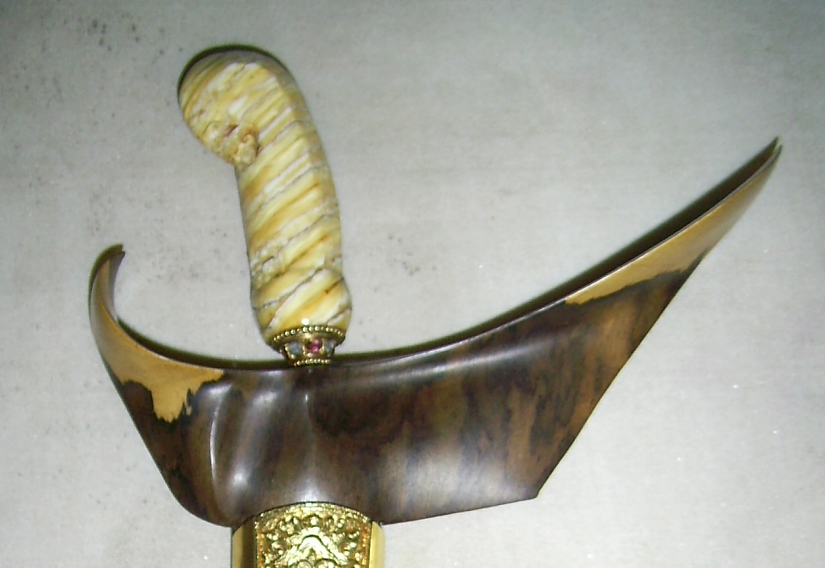

Some timoho sarongs with different patterns....
Old 21st September 2008, 01:57 PM   #11
Marcokeris
Marcokeris's Avatar
Location: Italy
Posts: 928
....others
Old 21st September 2008, 03:18 PM   #12
Marcokeris
Marcokeris's Avatar
Location: Italy
Posts: 928
one more
