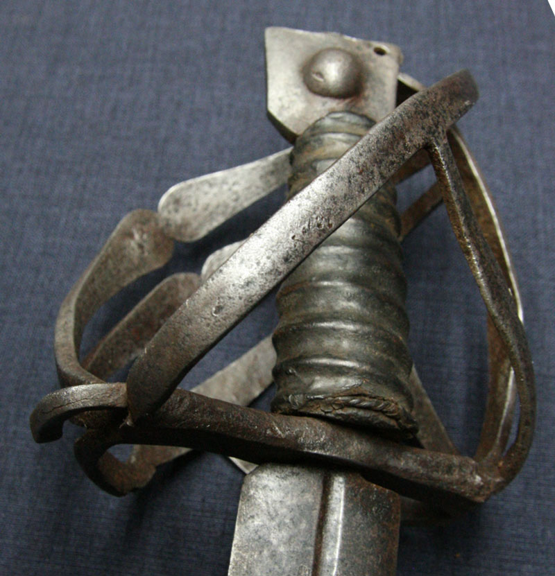

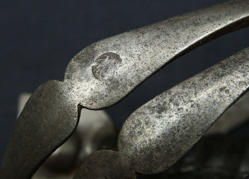

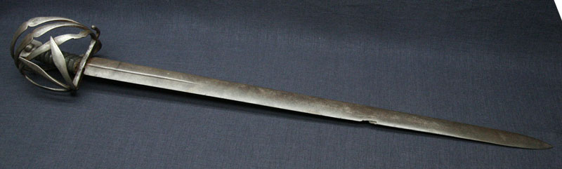

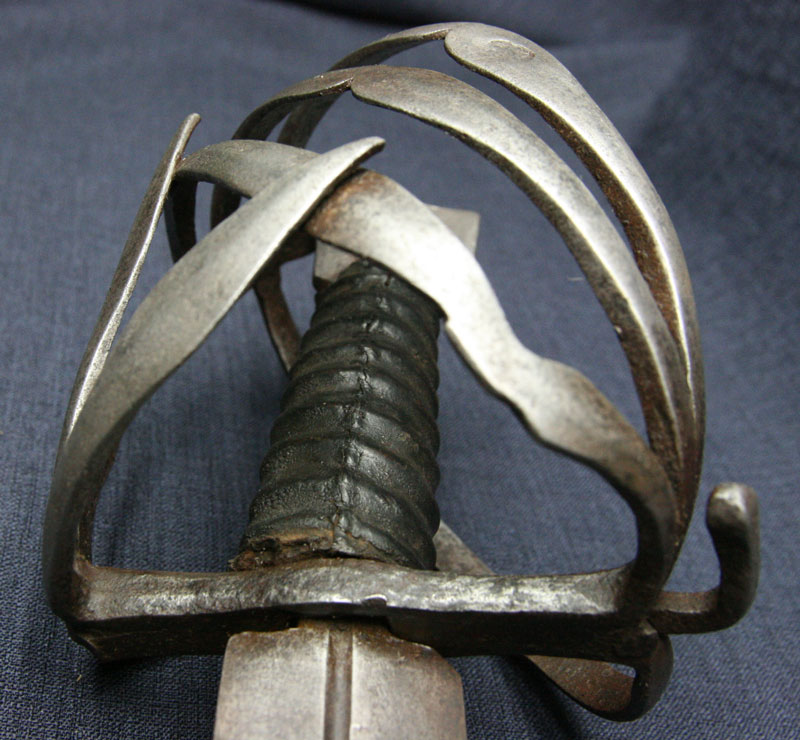

Schiavonas are getting very difficult to buy. Here is my example I've bought recently... Not so sound and decorated as it should be, but still a piece of history...

Well said Fernando!!! A beautiful warrior it is, and these are truly hard to find....real ones that is, like this one.
Valjhun, a sword such as this is never an investment, but a piece of history, and deserving being preserved. I always felt like I had 'saved' a worthy old warrior from the dealers with grinding wheels and steel wool, and couldn't wait to hear the stories it would tell me .
This is a good sound example of a true schiavona, probably mid to late 18th century. Wish I could make out the marking, but it seems unusual that it is on the guard, and I think that might be key to some identification.

Thank you Jim for your kind words...
Actually I think it was made between 1580-1600, relatively early example of a schiavona, from the venetian arsenal, official type. I figured it out from books like "ubojite ojstrice". There is precisely one like thatone (but in much better condition) in the dodge palace museum in Venice, marked as the oldest in the collection (they have 6 of them)
Theese markings (pommel and guard), wich are hardly visible, are the markings of the venetian arsenal - I can't figure them out, but seems to represent san Marco or the venetian lion. I'm posting photos of the markings from the sword wich is at the dodges' museum (palazzo ducale). Theese markings are also located on the guard and pommel.
The blade has a genova(?) type mark.... Any comments on that, Jim?
18th century schiavonas tend to have a different type of basket, representing more a kind of net, wich is more complex and more baroquese... Posting an example...
I'm rather happy with it as a piece of history, an old true warrior, like you said, but I'm still trying to find a later one with artistically more complex guard, like the last photo... btw, sold for 8.500 euro at the san girogio auction house...

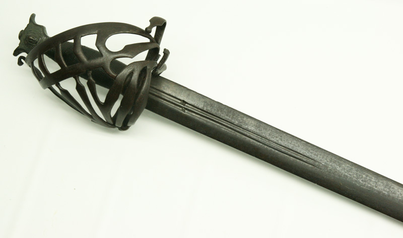

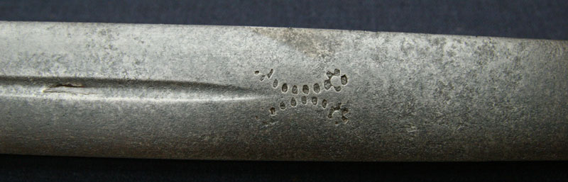

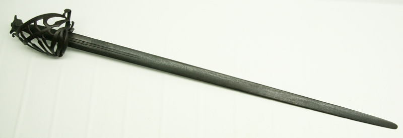

Here's my schiavona. Note the 'cockroach' or 'ant' marks on the blade, which were discussed in another thread. After browsing my [scant] sources on the subject, I would tentatively date this one to some time in the 1600s.
It was acquired by me together with the one that Valjhun is now so proud to own.
While they were in use up to the end of the 18th c., Valjhun's and mine appear a bit earlier.
The later hilts show more rows of "windows" in the lattice baskets, although dating them based on this characteristic alone may be false.
The last two photos are from Robert Elgood's THE ARMS OF GREECE AND HER BALKAN NEIGHBORS IN THE OTTOMAN PERIOD, and show two schiavonas from the late 1700s. Note more rows of 'windows' on the guard.
