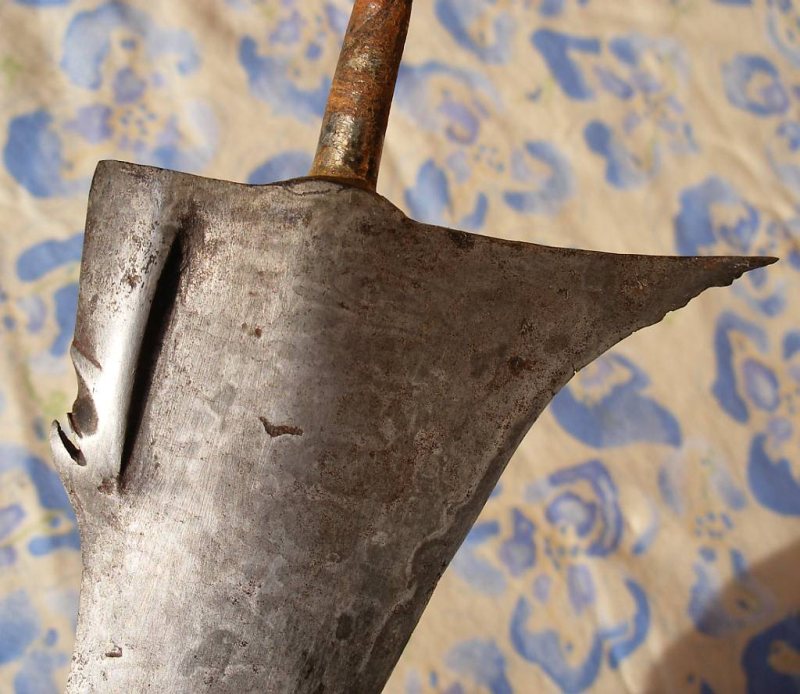

I'm thinking of trying ferric on this blade as it has a smooth surface .

Rick, that blade will be difficult to get a satisfactory result on with ferric chloride.
You need to get a blade absolutely 100% clean before you begin any staining. It must be white. Your blade has a few spots where rust will still be there, even after a really thorough soak and scrub. Those spots where there is still rust will give a dirty yellowish tint to the blade when you stain with ferric chloride.
You could give it a try and see if its acceptable to you, if its not, you just clean off and do something different. Spotting the rust areas with hydrochloric acid can help in preparation.
Something else that can give an almost OK result is a wash with dilute nitric acid.It works OK, but it is absolutely horrible stuff to use.
