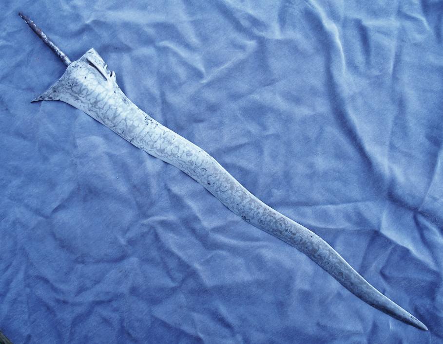

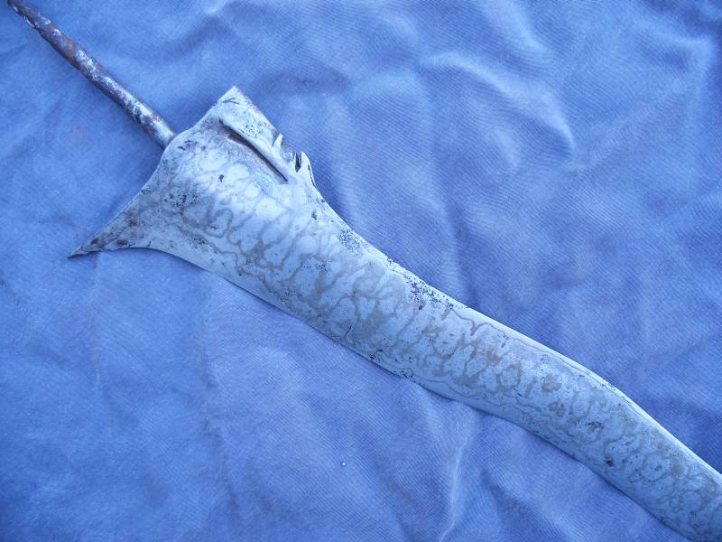

Well, I had at the Ganja Iras with the Ferric .
It took a couple of tries and the effect may be the reverse of what it might be if traditionally stained ... ![]() I just wanted to see the pamor . ![]() ![]() Last edited by Rick; 21st August 2008 at 09:35 PM. |

It seems a bendo segodo/uler lulut pamor.....but....it's like a negative picture!! ![]() ![]() |
#26 |
Posts: 6,339

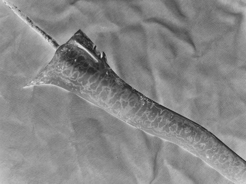

That's what I meant to illustrate; maybe the positive effect shown ( see bottom picture) would be caused by Arsenic .
With Arsenic the iron goes black instead of the result I got with ferric . ![]() I see uler lulut (albeit a loose one) Marco . ![]() Of course if this keris is Balinese the pamor may be called differently there . ![]() Last edited by Rick; 21st August 2008 at 09:53 PM. Reason: I think I've got this right , now ....... |

Rick, you have still darkened the ferric material, exactly as you would have had you used warangan, the difference is that it is simply not as dark.
I've made damascus blades that incorporated mild steel + 01 + nickel, and I've stained them with ferric chloride. The end result is very similar to what we see in a keris blade. If the pamor is high phosphorus content iron, then you're going to get a dark grey, light grey effect from ferric chloride, but if there is nickelous content, the nickel bearing material will still not be effected by the ferric chloride. |
#30 |
Posts: 6,339
Now I'm confused Alan,
Warangan would turn the core of this keris black; no ? Why then does the ferric render it as lighter than the pamor material ? ![]() The first ferric stain was quite muddy . BTW; did we decide an origin for this keris; E. Jawa, Bali ? ![]() Is it my technique ? ![]() |
