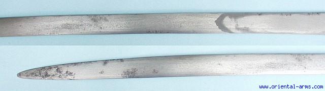

The problem wth VOC mark blades is that we have to be carefull
because a lot off Indonesian fake it to sell their weapons ,
but also some VOC swords where made in indonesia always difficult to tell

Ben, you are right about provenance, but if you want to further examine things, provenance can be easily faked. We have all seen fakes even in museums and sometimes those fakes have provenance.
I have seen fakes made from old pictures of artifacts and then the piece claimed to be the same one in the picture.
So the bottom line is to do the best you can and buy what you like at a price you feel is appropriate.

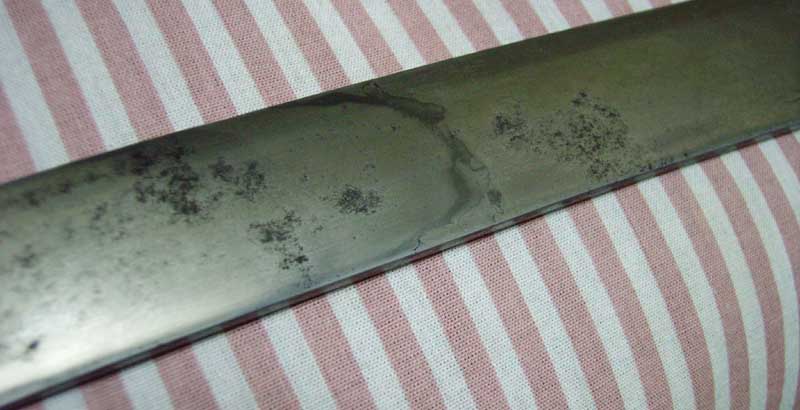

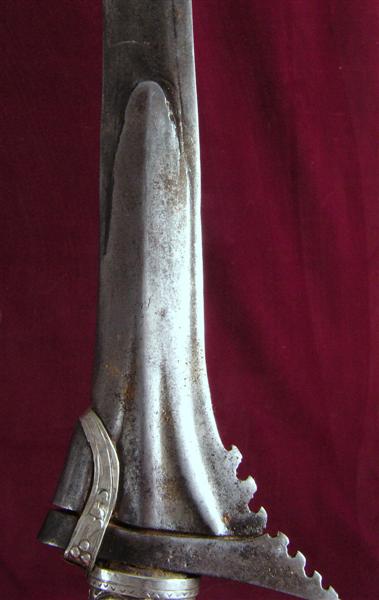

Is this blade scarf welded or has the sorsoran been split and the VOC blade inserted between the halves ?

This is difficult to say. The obvious part of the weld looks more crude than the rest. Notice how smooth and apparently one-piece the joining of the blade and sosoran as it approaches the handle.
I am not exactly sure what you mean by "scarf welding." If you are suggesting a butt weld, or rabbited end, of the VOC blade, then welding into a notch, I don't think this applies.
It almost looks like it was made this way from the beginning. Or the sosoran could have been split and the blade inserted?
I hope to be able to connect with one of my metallurgical friends and show it to him. Maybe then I can get some better answers. Or perhaps one of the other forumites who saw this could better answer.

Here are a few examples of scarf welded blades.
Lew

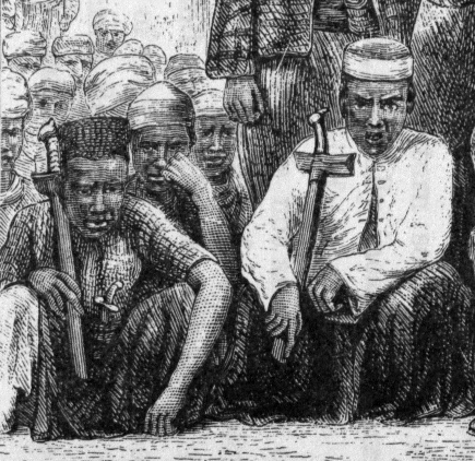

Here is a drawing from a picture of Sultan Abdullah and chiefs of Perak from 1878.
I have also seen the original picture taken and this drawing is resembling in details.

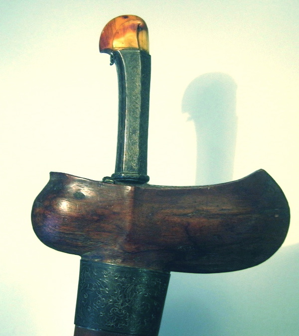

Someone recently suggested this might have been made for a boy?

I don't really think the kris was made for a boy, just offering a possibility.
The comment was basically about the size. Depends on whether you consider this essentially a Moro piece -- that would usually be larger, or Peninsular, that would normally be this size or even smaller.
I think that some of the diminutive Moro weapons were made smaller for youths.
FI here is a barong with an 11" blade (28cm). Probably made for a youth. Late 1800s, Sulu.

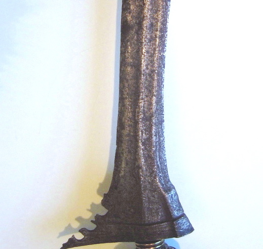

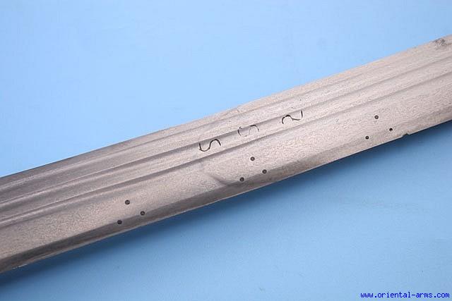

I may soon have an answer to the date on this piece. As you can see the first two digits are obscured by the sosoran that was welded to the blade. Since the VOC ended in 1800, the date is probably 1746, but if I am very lucky, it could be as old as 1646.
I have a friend who has access to a metallurgical x-ray. He is going to do full xrays on this piece and tell me the date. He is also going to xray the hilt. This will give us more clues as to how it was constructed.
Got to work this into his schedule, so I don't know how soon I can post pictures.
FWIW my friend says he can xray steel more easily than copper. He usually deals with Dong Song culture bronze pieces that can be 800 bc or earlier. These are more difficult to xray.

Forgot to post outcome of the metallurgical x-ray. Looks like 1646, but fuzzy. Second digit is more like a 6 or an 8 than a 7.
Seems the "R" has to do with Rotterdam if that helps place the age?

An interesting keris or kris or voc or peninsular?

An Indonesian friend has commented,
This is an alang bahari kapit in sundang /kalis style and hilt,,,
Hybrid ,,, Might be from reteh riau near sumatera where the tempasok, balanging, irranoon and sug settled down after the came after the demise of raja haji in teluk ketapang 1786 ,,,The dhapor is perfict ly ,,,,alang /bahari/bengkinang ,
I don't understand most of the language and someone could interpret this?
Could you please try to post scans of the x-ray images? Would like to have a look at the digits as well as search for possible additional marks.
1646 would indeed be quite an early VOC blade and allow for enough time to disperse throughout the archipelago and eventually get recycled as part of this k(e)ris!
The Rotterdam mark won't help to corroborate age since its trade chamber participated in the VOC from the very beginning. It's role increased with time (this won't allow any reliable inferences though).
If you compare the grip area with that of the full-size Moro kris (pic in post #2), there's hardly any difference. Thus, I'd believe this piece was meant for an adult, too.

Just some quick comments:
Blade in keris anak alang and keris bahari style with keris sundang fittings (hilt/clamps).
There were Moro settlements/colonies in the Riau archipelago (East of Sumatra).
[sug = Tausug, etc.]
Historical reference: the VOC defeated Raja Haji at Teluk Ketapang in 1786.
Keris panjang, keris anak alang, and keris bahari share a common blade style which gets collectively called after the town Bangkinang (traditional production center on Sumatra).

Kai, thank you very much with your explanations! Always a pleasure!
