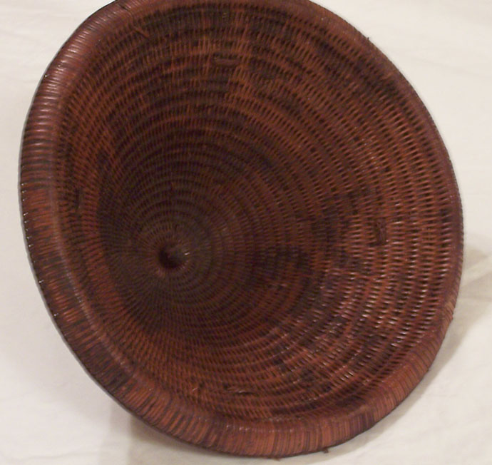

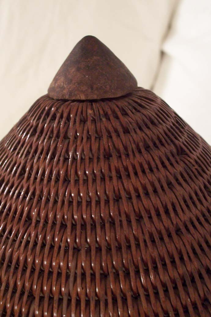

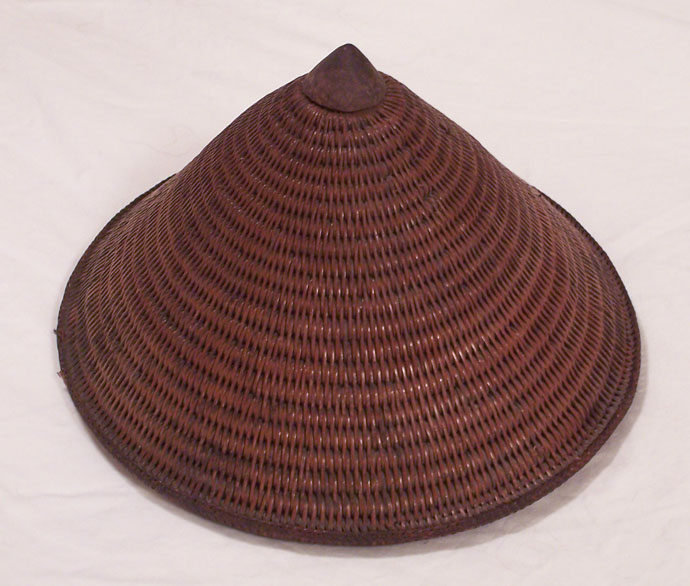

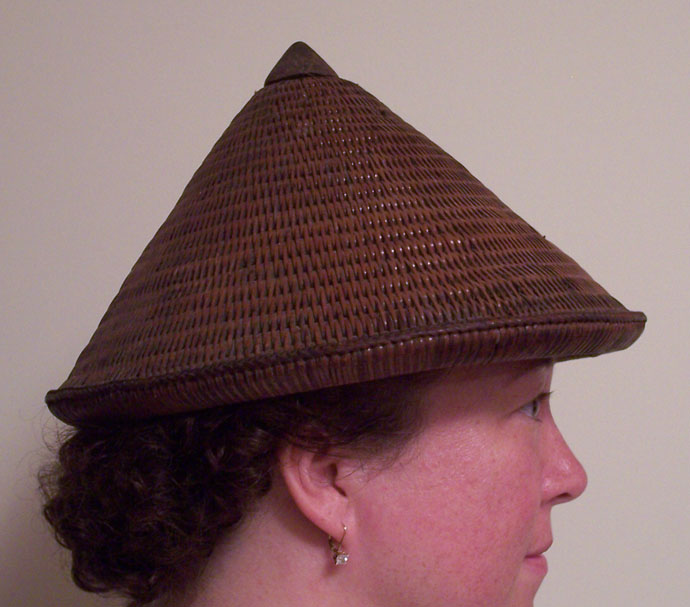

I'm attaching pics of a rattan helmet I picked up a few months ago that I suspect is Vietnamese, but I wanted to get some other opinions. I have a few reasons for suspecting its Vietnamese origin, but without going into long and laborious detail, I'm simply going to attach an illustration of a South Vietnamese soldier, circa 1850. Note that both helmets have a spiral construction, similar to Chinese and Vietnamese rattan shields. As far as I know, there is no Chinese equivalent to this helmet construction, but I'd like to know if anyone else here is aware of any other cultures that constructed helmets in a similar way. I would think Indonesia could be a candidate, but I'm largely unfamiliar with their armor. In short, I want someone to come up with a plausible candidate other than Vietnam.
The helmet is slightly oval, being 11.25 inches at its longest and a hair under 11 inches at its shortest. Height is about 6.25 inches. The model in the photo is my lovely wife. She enjoys supporting me in my hobby and can't seem to resist putting this thing on her head.

Neat headpiece, Nick. One thing I'm interested in is how thick the main strand of rattan is. If it's a functional helmet, then the rattan needs to be thick enough to absorb a blow. Otherwise, it could be primarily a fashionable hat, as your wife so ably demonstrates.

The hat/helmet is very sturdy. At it's base, it is nearly .75 inches thick. I suspect the main spiral of rattan is actually a double layer, but it is weaved so tightly that there's no way to prove this without deconstructing the thing. It probably is tough enough to absorb a sword blow, but more to the point, it's definitely tough enough to DEFLECT a sword blow. The particularly steep incline seems well-suited to deflecting an overhead strike...even the very top is peaked by a cone-shaped piece of wood. I think the construction, coupled by the soldier illustration, makes a good argument that this is a helmet rather than a hat. You are correct, however, that my wife makes it look so stylish that it is easily mistaken for a fashion statement.

Yes, I followed this thread with great interest when Scott first posted the photo. These photos depict fairly typical Chinese rattan helmets. The obvious difference is that the Chinese use vertical strips of rattan to construct the "bowl," whereas this helmet uses a spiral of rattan, held together by thinner rattan strips, weaved into the spiral vertically (again, very like Chinese and Vietnamese shields). The Vietnamese also used a helmet similar to these Chinese examples; I'm attaching a postcard depicting a couple of Vietnamese soldiers, circa 1910. Curiously, I haven't found any depictions of spirally-constructed helmets in China, despite them having shields of that construction.

Interesting to note that this helmet, like the Vietnamese and Chinese rattan bucklers, has an essentially spiral structure, the cane being of round cross-section and bound with thin, narrow strips of split rattan. The rattan headgear worn by the Vietnamese units serving in the French colonial forces (the Linh Tap) are constructed quite differently. Though they vary in size and degree of conality, they are made of thick rattan split into flat laths, assembled radially around a central peak and reinforced with other rattan strips at the rim.
Either type of helmet or hat will provide considerable protection against cuts to the head. Even a direct hit with a blade is not likely to penetrate the weave. The British learned from their experiences in Asia that they could not cut through a rattan shield with their naval cutlasses, which are quite stout, heavy-bladed weapons. The extensive use of cane for shields in areas as diverse as Tibet, Turkey, and parts of equatorial Africa attest to the virtues of this material in the construction of effective, lightweight, and inexpensive body protection.

Thanks for chiming in, Phil. Here's a thought...I wonder if the flat-lath construction you describe (and which I believe is depicted in the postcard) is more typical of Tonkin (North Vietnam) and the spiral construction is more typical of Cochinchina (South Vietnam). We already know that there were differences in their swords: southern Vietnam more closely resembling dha; northern Vietnam more influenced by Chinese jian and dao. It's no great stretch to imagine there might be variations in their armor.
