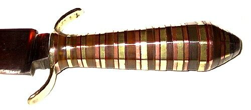

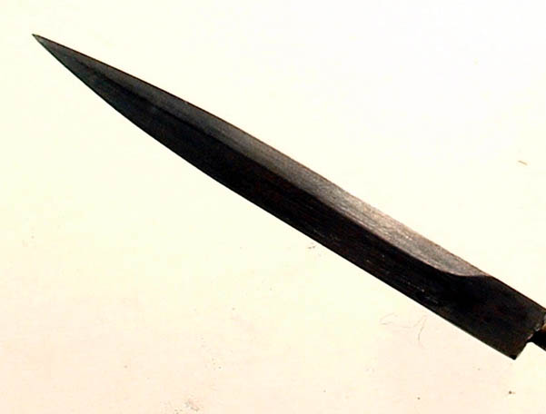

Default Mexican (?) Dagger for Identification?

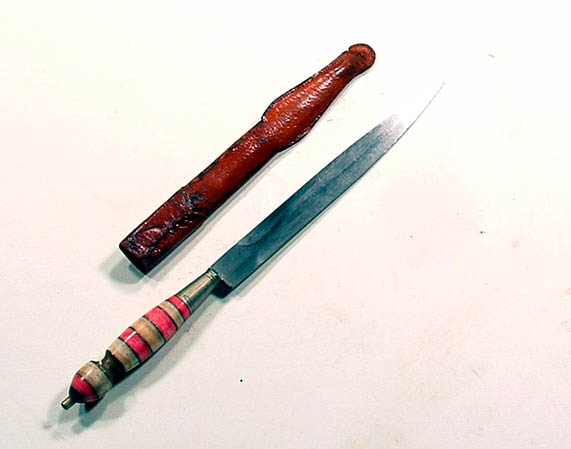

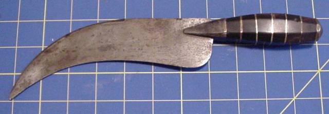

Hi all....here's another one that caught my eye at the wrong time.
The seller said he thought it was of Spanish origin, and I seem to remember seeing that these were Mexican (?), but can't remember for sure.
This one is 10" long, as opposed to 2"-3" minis which I believe is what stuck in my mind, with the hilt being pieces of dyed bone.
The seller specializes in African pieces, so neither of us could do more than speculate.....it was a fairly minor purchase, so no great loss, possibly best for steak tartar? **grin**
Am I correct or off by a mile?
Any information is appreciated, as always.
Mike
Old 11th March 2005, 03:50 PM   #2
Posts: 4,705
Hi Mike:
These are Brazilian in origin, I believe. You will find an example in Levine, listed as a faca da ponta, if I recall correctly.
I have a couple of these. Is the blade sharpened on this one? Mine are mostly non-functional and probably made for the tourist trade.
Pretty knife and well put together.
Ian.

LOL!
Score three for Levine's, the khodme, the corvo (if it wasn't for tequila I'd never remember this one!**grin**) and now the faca da ponta!
Thank you Ian and no, not sharpened, so useless except for stabbing, although, due to its size, I'll likely sharpen it for my own personal use with a good T-bone!**another grin**

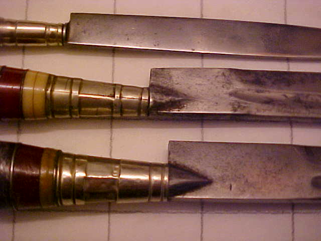

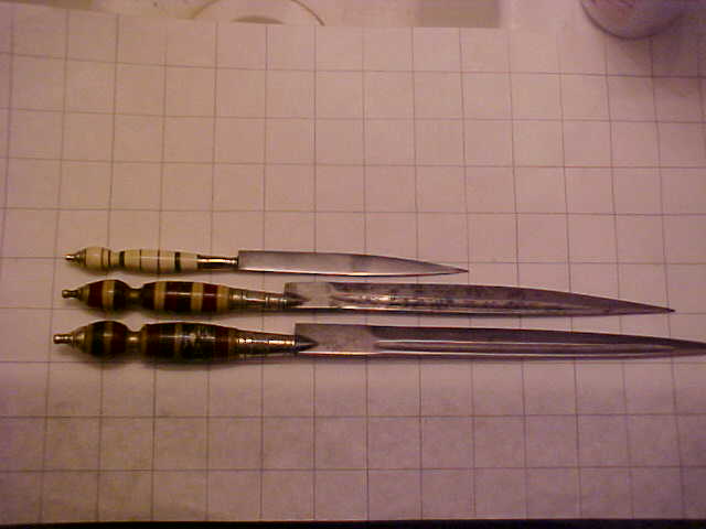

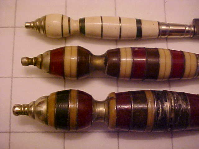

Thank you Ian:
I have 3 of them as well and two of the pieces have an unusual cone-shape that is integral with the blade right where it joins the handle.The smaller one for some reason does not.
I also notice that the rings are of a different color on all the examples. Do you know if there is some significance to the coloring?
Thanks anyway for the ID.I am enclosing a couple of pictures.
Cheers
Ray

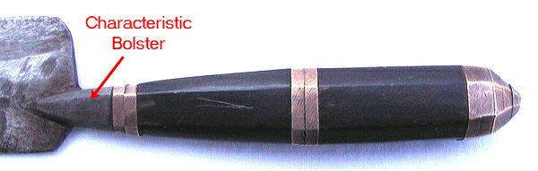

The pointed bolster is seen on Chilean corvo.

knife7knut, cn I ask a question or two?
What are the sizes of yours and, are all three unsharpened?
From the photographs, the two larger pieces seem to be very well made and if not sharp, at least intendend to BE sharpened and look like nicely made weapons intended for real use.

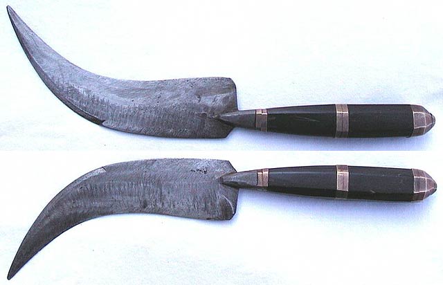

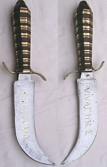

Thumbs up Corvo, Faca, etc.
Ray:
I think those older ones are nice examples of functional faca. As Tom points out, there is a similarity to the Mediterranean style of knife, and the stacked hilt is reminiscent of Canary Island knives (also a Spanish colony in the 19th C.) as well as the Chilean corvo, with a mix of bone and horn slices, iron and brass spacers. The conical bolster is seen on older Chilean corvo (as Tom has said).
Here are some archived pictures from previous posts that show Chilean corvo. The last one is a post-WWII tourist corvo in a more contemporary style. There are recently made military and civilian forms of the corvo also.
Ian.

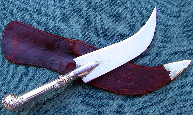

Smile One more corvo ...
and its the best one I've seen. This silver handled corvo comes in a red tooled leather sheath. The mode of wearing the corvo is illustrated in the picture of an officer in the 19th C. Chilean Army.
Ian.

The photos were taken on a grid of 1" squares(my usual method to denote size;I should have stated that before)and yas all three are unsharpened.
They were obtained from 3 different sources over the years.The first was given to me by a friend who used to purchase military collections and dump everything else at flea markets and such.The other two were obtained at other flea markets ostensibly as letter openers.I don't think I paid more than a couple dollars each for them.
This person also had a large assortment of Phillipino and African knives that I acquired a few of including a couple of swords made entirely of water buffalo horn (obviously for the tourist trade).

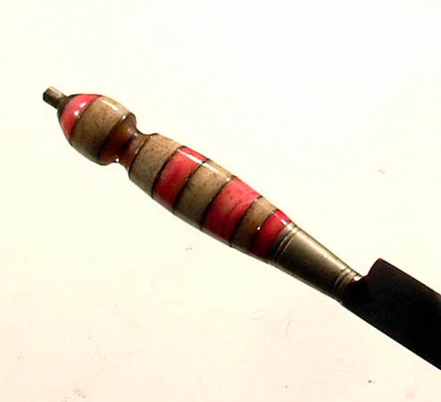

Mine arrived today and, as suspected/predicted is unsharpened, something that will soon be remedied if it's to have any use as a SKOW (steak knife of the world! **grin**).
The leatherwork on the sheath seems likely to be Brazilian as well, making me suspect that these were likely the precursors to the Goucho knives before the fancy silver incarnation that we associate with them today.
If used as a working knife it would seem that the blades would be particularly nasty as a fighting weapon or an assasination type blade that could be used without anyone ever being the wiser until the perpetrator was long gone.
I suspect that here's a case where we are seeing the devolution of a weapon as opposed to the evolution that we normally think about?
Mike
