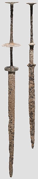

These may be akin to what you're looking for, but I don't think that they're quite as ancient as you want.

Those are great Joe!!! Can you say a little on what these are and where you found them. They are pretty interesting examples and I'd like to follow up on them as well.
Thanks for posting them,

Thanks Jim. These two came from Hermann Historia, where they were advertised as being ancient Central Indian two-handers, if I recall correctly.
Unfortunately, I don't know which auction number they were listed in, so I'm having a tough time finding the original listing...

Thank you for checking that Joe. It seems Hermann Historica does often have great pieces in thier catalogs, and lot of good photos. I only received the flyers which were of course understandably brief in descriptions given the limited space.
I found weapons of this type listed in Stone (p.643) as two handed swords used by Rajputs and Mahrattas, and it is noted that the hollow shafts of the hilts often encased small knives. While the hilts on these examples seem to have disc type elements spaced on the long grips, the example shown in Stone features the fluted brass orbs often seen on them.
It seems these are directly associated with similar two hand weapons with spaced guards from the south and termed 'mel puttah bemoh' (Stone p.444, Egerton 134) with long rapier blades and noted to be from 18th century.
These are very interesting and unusual weapons that seem to have influenced the two hand swords of the Naga in Assam, and illustrate the wide diffusion on weaponry on the Subcontinent. They are however indeed far from the period Steven has inquired on.

Ah, thanks for the correction Jim. I'd love to see the examples you're talking about in Stone's book, maybe you could send me a pm?

Actually the caption was correct and Central India was indeed the region of the weapons you illustrated, I should have clarified that in my post. The same type weapon you posted actually appears in Robert Elgoods "Hindu Arms and Ritual" ( p.94 , 8.51) where he notes that these are actually latter 16th c. to early 17th and from the Deccan in Central India. Perhaps someone who has either of these texts could post illustrations?
Thank you again for posting these, although we have not heard from Steven, I certainly do appreciate your response!

In further examining the descriptions in both Elgood and Stone, it is interesting to note that the swords Joe posted seem closer in form to the mel puttah bemoh (Stone p.444, fig.566) which has a long rapier type blade.
Elgood illustrates one of these swords (p.94, 8.51) and notes a stone image from Virabhadra Temple, Lepakshi (op.cit. p.94, 8.49) that depicts a warrior with a large two handed sword and dating it from the 1530's.
It would seem that these two handed swords were used further back than the example in Stone (dated 18th c.south India attribution ) and the example in Elgood ( shown as Deccani, early 17th c.).
The examples from Hermann Historica appear to be in excavated condition, and the hilt elements quite rudimentary in comparison to the hilts of those shown in Stone and Elgood, which carry a bit more structure. This would suggest that these excavated examples may have been from the earlier period noted by Elgood, and would confirm the use of two handed swords in India into the medieval period.
With these in thier rudimentary form and excavated condition and the examples shown in development in Elgood and Stone, it is interesting to consider not only the use of the two handed sword in India, but the diffusion and development of the form. While that movement seems to be chronologically from the south, into the Deccan and further north with the elaborate Rajput and Mahratta examples more decorative and with the fluted orbs separating the hilts as seen in Stone (p.643 #7) and Elgood (p.95, 8.54), it seems the influence carried into Assam with the Naga two handed dao.
Elgood notes that the two hand form became redundant with the advent of the khanda with basket hilt and projecting spur in the 16th c.
It is always good to have an opportunity to research and discuss the weapons of India and again, I'm glad Joe posted these!

What could be the possible advantages of a warrior using a 2 handed sword?
He can use both the hands to grasp the hilt and thus bring more force into his action. This extra force delivered with a heavier weapon may be used to incapacitate/kill the opponent or maybe even damage/destroy the opponent's weapon. This is a POSITIVE.
But when he uses both his hands, he cannot make use of one hand to possibly hold a shield and deflect the opponents blow. He also loses his freedom of movement. The entire body is flexible when one hand is free. I feel this is a NEGATIVE.
How would you balance the two?
Maybe a warrior can use the Khanda or it's similar types for delivering a final blow on an incapacitated opponent, say like beheading him. But would it be practical for him to use a khanda against a lighter armed warrior using a single handed weapon?

You bring up a very interesting and quite valid question. It would seem that in most cases, these large two handed swords were most likely used in shock action, that is against attacking cavalry to bring down horses. In the melee these huge weapons would indeed be cumbersome and ineffective, and as you point out, the individual would be open to attack.
