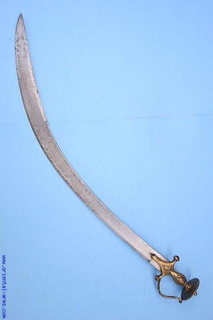

Hi All

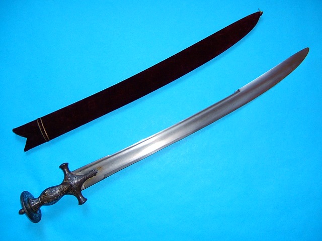

I would like to have some opinions on the possible uses of this short bladed tulwar? Blade length is about 22" long. Any theories would be appreciated.

Hi Lew,

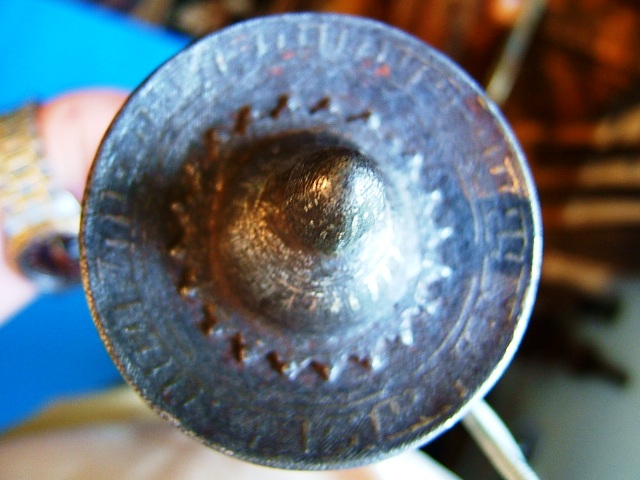

I think that this particular kind of tulwar is a gift for someone and if I read well on the disc pommel there is a write .... SEND TO FLAVIO
Very nice, congrats

Hi Lew,
Maybe it was made for a boy. That might explain why it is a short one.
Flavio, you made a big mistake in your translation. It says "send to Henk asap" The word "Flavio" is not present on the entire piece.
Congrats Lew, it is a beauty.

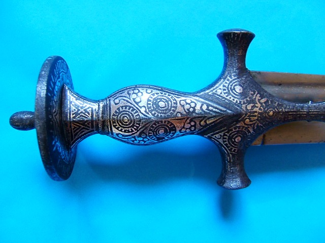

Henk the hilt is full sized my big hand fits rather nicely. I think this is an adult sword. Either a court sword or some type of palace sword to be used in tight spaces.
Lew
I agree Lew, seems the most likely or perhaps for an Indian warrior with extraordinary long arms
Regards David

Could it be an equivalent of "nimcha"? SW India had a large Arab-related populations. Perhaps, it is not a " boy toy" or a ceremonial gift but rather just a short sword similar in its function to the naval cutlass.

Boy toys have more curves and often smell nice. A close up of the fuller end and sword tip would be helpful.

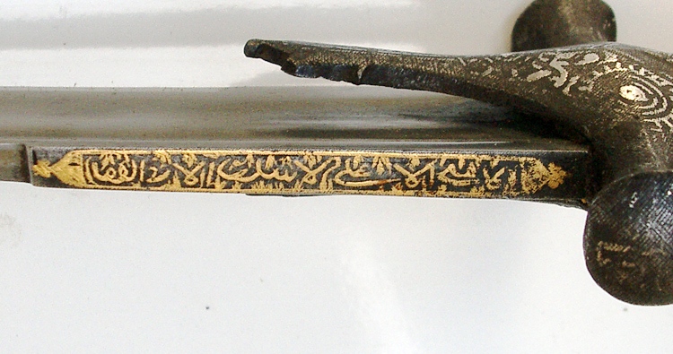

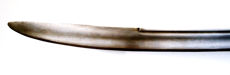

Here is a close up of tip and koftgari on the spine. Ham was able to translate it and it reads "THERE IS NO HERO LIKE 'ALI AND SWORD LIKE DHUL'FAKAR".

The blade looks as though it has been shortened to me. The broad fuller runs right through the tip area. Perhaps an old favorite that broke and someone had it reworked (albeit a very good reshaping).
Ian.

I thought the same thing but the axis of the tip would be all wrong if you added 8-10 inches. The fuller runs lower than the tip. I also checked the hardened edge and it wraps up and around the the top of the tip. So if it were shortened it would have to have been reheat treated to have that effect at the tip.

I think it is simply a secondary side arm, and a darn nice one.

I agree with Ian and Charles. I think it may have been altered purposely and expertly creating a heavy cutting weapon rather like a barong. To me it looks like it handles very nicely. Very nice.

whereabouts is the 'point of balance'....it may help to determine whether this sword was shortened or made that size

IMHO the blade was broken at some point and redone. I have some European swords in my collection that either been period shortened or broken and then saw naval usage. This piece was obviously too nice to be discarded or given to a child.

CharlesS is correct, this is a secondary weapon and there is nothing unusual about its size seen in that context. Such swords are not cavalry weapons-- rather, they are used for close foot-fighting of the sort in which a long blade would be a liability rather than a benefit-- a good parallel would be the wakizashi.
Its proportions and form in no way suggest that it has been shortened, actually it is quite a pleasing piece of work.

I agree with Ian and bbjw. If i look at the close up of the tip it says to me that the sword was shortened. The fuller ends very close to the tip like something is missing. Unfortunately we cann't see the sword in live.
Maybe I'm mistaken and Ham has a great knowledge of these type of weapons.
Fact is that we all agree that it is a beautiful sword.

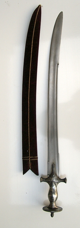

If this was a shortened sword than the fuller's placement would be higher up at tip it would not be running through the bottom third of the blade at that point which seems to be the center axis of the blade. If you were to extend the tip 8-10 inches you would have the fuller in the center of that section of the tip and it would have a much wider cross section. The sword below has the same swedge cut into the spine and if it were to be shortened you would loose that cut out at the far end of the blade.

I agree completely with Ham's assessment supporting Charles observation.This short tulwar does indeed appear a secondary type weapon intended as Ham notes, for close in fighting.
It is interesting to note that describing noticeably short swords as childs swords is a common assumption. We do know of course that such swords did indeed exist, but the best guage is often to evaluate the size of the hilt, as has been noted here.
The use of shorter swords for close combat is best seen in Ham's excellent comparison noting the wakizashi, which comprised the intermediate of the suite of swords carried by the Samurai. In China, many of the forms of dao are found with extremely short blades, which are considered to have been mounted for in close combat or use in the close confines in allies and narrow streets of cities of the time.
It seems that there are numerous instances of cross influence between the weapons of China and India.While comparison between this example of short bladed tulwar and the similarly short bladed dao does not suggest any direct connection, it does seem worthy of note.

4.5 inches foward of the cross guard.
