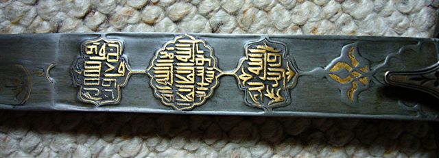

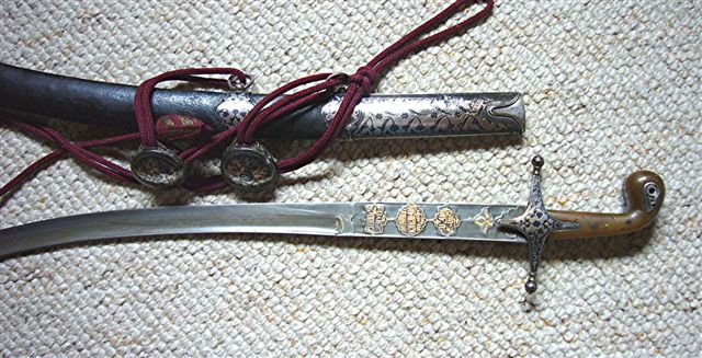

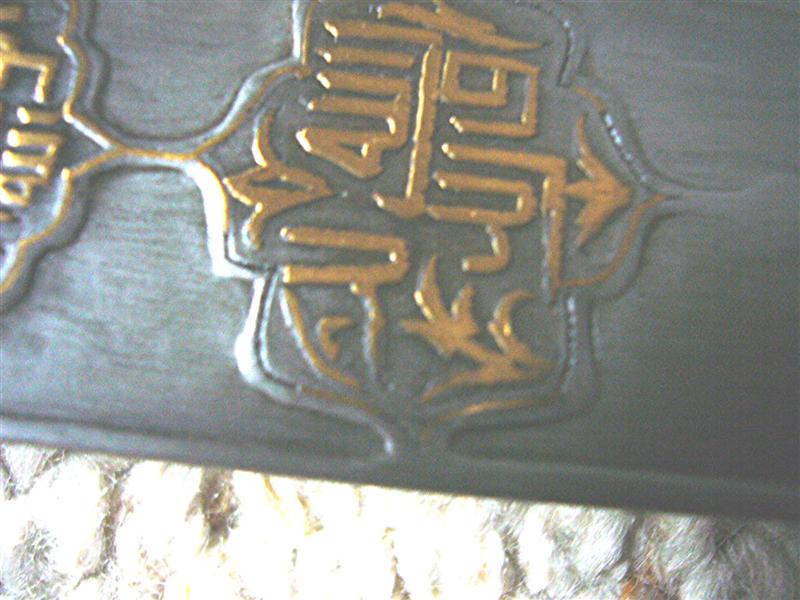

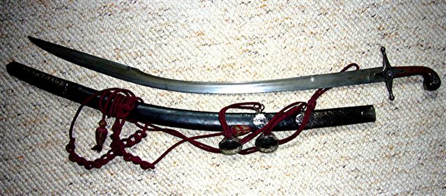

Kilij from private collection, would like to open discussion on any aspect of this sword.
Have been comparing square kufic insciptions on Turkish blades. the Square kufic was used during the time of Muhammad and the Quran was originally written with it. Square kufic is also the only calligraphy ever used to entirely decorate the exterior of buildings.
Every so often there seems to have been a revival of of this type calligraphy used on blades. Some of the inscriptions are phrases from the Quran. Muhammad was the one who started the use of text to decorate weapons and armor for talismanic purposes in the Islamic empire.
If we look at early examples of venerated swords that were cared for with great respect, we see that inlay and encustration of gold was lavish.
The technique that was used for inlay on Turkish blades 16th century and earlier has not been documented yet as far as I know. But it may be the same overlapping triangular punch we have so many later examples of, metalworking traditions do carry on for centuries as long as there is demand for it.
If you know of documented early Turkish inlay techinques I would like that information.
Also am finding very few transaltions of 17th century and earlier Turkish cartouches and inscriptions, if you know of a reference for that let me know.

There might be a dating like 975 (16th c.) on the left cartuche, or the cartuche closest to the blade tip. Am I right?
in arabic 975 = ٩٧٥
Old 10th August 2007, 10:10 AM   #4
erlikhan
erlikhan's Avatar
Location: Istanbul
Posts: 452
Right, the figures look like 975 in Arabic numbers, but in a decorated way.

Default Close ups

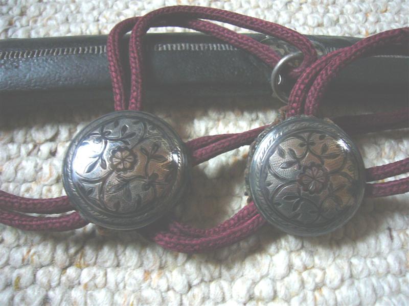

Two more images of sword...

Default 975
Originally Posted by kronckew
in arabic 975 = ٩٧٥
976- 29 (3%) + 622 = 1568
Don't know what the rest of the inscription says,
don't know if this is date for being made or a reference to something else.
But would like to know, there is a huge gap to fill of translations of Turkish inscriptions, espsecially translated to English.
But all the small clue when added up will help form a better opinion.
Received information this is not a date.....
rand

It also looks like you have at least one bismallah (name of God) and a Qur'anic verse.
Masterful work done on this - beautiful!

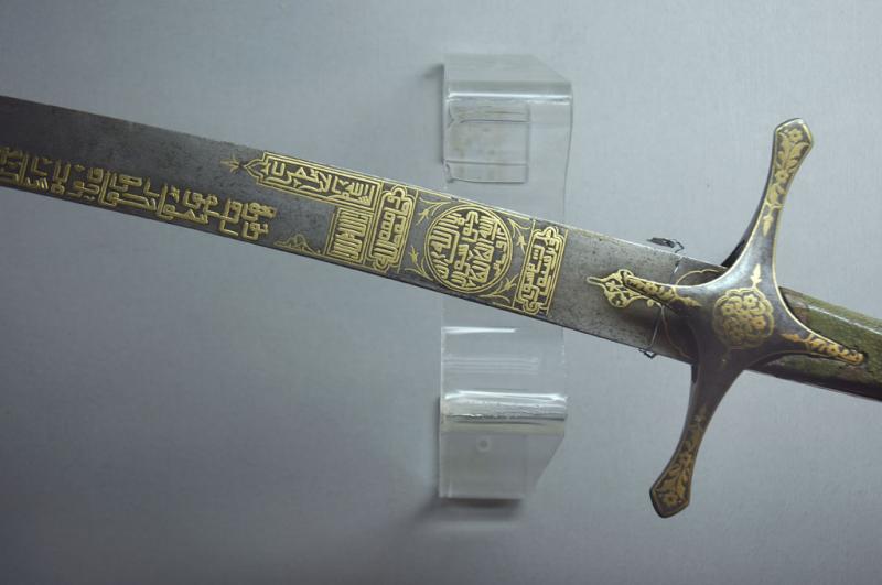

Default 16th century sword with square kufic calligraphy

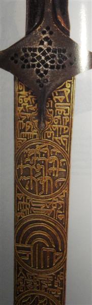

The swords with the green ray skin on handle belonged to Sultan Selim I, 16th century. "Decorated with kufic inscriptions,resettes,rumi scrolls, palmettes, and tulip motifs" quote from Military Museum catalog.
What I hope to start, is a gradual accumlation of datable inscriptions to help determine a time period for the date of these sword types. A typology of Islamic swords based on blade style, calligraphy, metallurgy, metalwork (such as types of inlay), art design progression, hilt styles, pommels, grip styles, grip scale materials, grip scale coverings, dimensions,weight, cross section of blade, crossguards, scabbard style and so on....

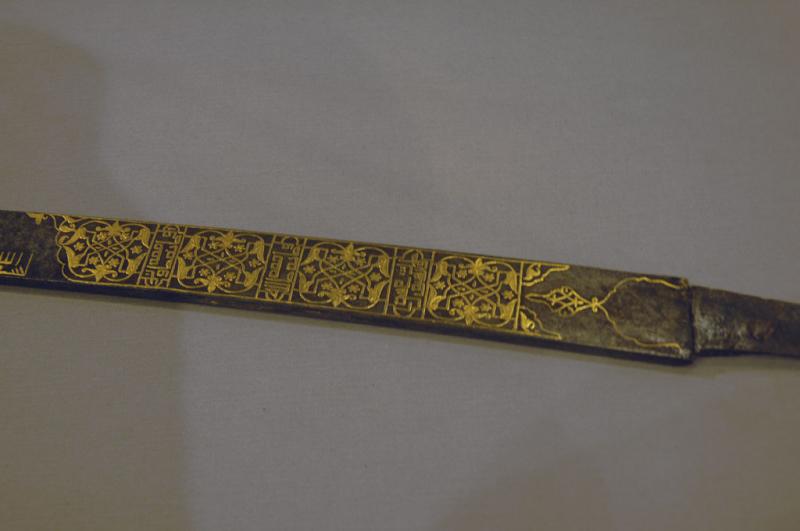

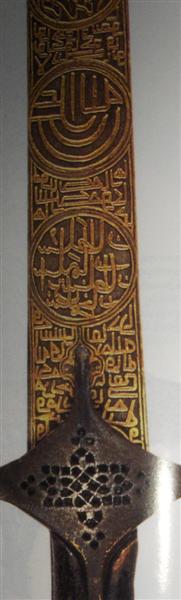

The technique used to inlay the gold on the 16th century swords posted above are unknown to me,
The first kilij posted on this thread has a form of channel cut inlay used to make the inscriptions. The blade has the appearance of a raised section cartouche by chiseling away steel and a sharper curve to its blade when compared with Sultan Suleymans kilij.
One thing to take note of is the 16th century swords above have animal skin wrapped over the handle.

How did you establish this?
Further:
This is not invariable. The sword you pictured above with the grip covered in green rayskin, for example, is a late replacement.
Ham

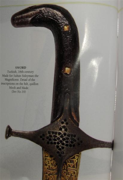

Default Sword grip coverings
Hi Ham,

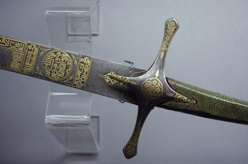

The sword with the ray skin wrapped handle belonged to
Selim I Yavuz (16th C.)
The sword pictured here belinged to
Sultan Suleyman (16th C.)
appears to be black leather wrapped.
Both these swords are on display at the Turkish Military Museum,
I assumed these coveted swords to have been safely housed and kept for centuries, any information you have to the contrary or indicating later use please share.
Reguarding Muhammad putting verses from the Quran on his arms and armor I will look for that reference and get back to you.
Appreciate your input,
rand

Old 11th August 2007, 10:36 PM   #15
ham
Posts: 190
Your assumption is inaccurate, unfortunately. This too, is a 19th century rehilt as are many of the others displayed in various Turkish museums. The guard and pommel are Persian or Afghan work, and there is a strong tendency for grips on this type to be leather-covered wood.
The mounts of the swords of the Rightly Guided Ones, preserved in the Reliquary at Topkapi, are more or less all 16th century; they are a reasonably reliable reference for mounts of that period. See
Yucel, Unsal: Islamic Swords and Swordsmiths, Istanbul: IRCICA, 2001.
Ham
Hi Ham,
Are you refering to quote "Most of the swords housed in the Holy Relics section at the Topkapi Palace Museum were, following the conquest of Egypt, repaired and redecorated between 923-927 hijia C.E. In most cases their hilts and scabbards were completely replaced" , page 64, Islamic Swords and SwordSmiths.
Looked but found no mention of Suleymans sword in Yucels book.
The crossguard on Suleymans sword pictured above sword looks a later replacement to me, especially the shape of the ends of the quillons does not fit 16th century style. The pierce work on the crossguard on it looks more to the Persian taste.
rand

Hi Battara,
The kilij at start of thread is all gold inlay, its type of channel cut with gold pressed into it.
The use of koftgari did become more popular in the 13th-14th centuries when certain alloys were in short suppy, especially silver. This change is reflected on brass/bronze metalware of that period.
As far as Suleymans sword posted above I have no idea what type of gold application was done, but we can assume price was no object. Would be very interesting to find out the answer to your question.

Some of the inlay had a triangular punch overlaping grooxe made that the gold was applied into, there was a further line incised around the perimeter that marked the edged of the letter and I assume also helped adhere the gold to the blade.
