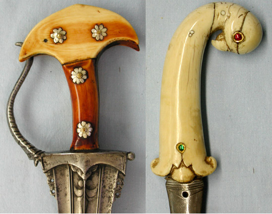

Here in an example, and yes, they did import ivory from Africa.
Is it Walrus on the left and African elephant on the right?
Josh

Thank you for your answer, but I have never seen walrus ivory look like this before, so I will try to get it checked by a specialist.

Default Jens ivory handled daggers
Hey Jens,
From my perspective the dagger on the left would be African elephant ivory and the dagger on the right Indian elephant ivory. would agree they are not walrus ivory as the do no have that "crystaline" appearance at all. Rather a smooth "woodlike' on the dagger grip scales to the left and a milk white appearance to the dagger grip scales on the right.
The use of walrus ivory is very much to the Persian taste. Then, there are exceptions to every rule...
rand

Spiral, I have not as yet been able to ask someone about the ivory, but I have examined it myself, and i am sure that it is elephant ivory. You only had the picture. I have the item, and that makes a difference when it comes to judging the hilt. Any new things you can come up with about the ivory will be most appreciated, as I think what you have come up with yet is great.
Jens
Old 8th August 2007, 11:13 PM   #46
spiral
Posts: 1,712
I made no comment about yours nice looking knives Jen, Just about ivory in general.
I can see the one on the top of the left one is probably Elephant, I cant see enough detail of one on the right to be sure but I think your probably correct. I couldnt be certan from those pix, so I passed no comment.
The end grain should show intersecting diagonaly curved lines under a lens if Elephant or mammoth.
And changing stripes of refraced light on the long gain if turned fore & aft in sunlight.

Originally Posted by Battara
There is one other note for the coloring of ivory. As Spiral says it depends on environment and one environmental factor is the amount of exposure to sulfur.
Sulfur is mostly what colors ivories. For example elephant ivories in the presence of sulfur will turn yellow to orange to brown. IT is always in the air, but heat will accelerate the chemical reaction as the ivories "breath" in the sulfur already in the air.
By the way, Jens I always love your pictures - and am insanely jealous.
Battara; Great information about Sulfur changing ivory yellow.
I know for a fact, unfortunately, that rubber bands have a lot of sulfur in them, and I assume all rubber products also has sulfur in them. The rubber bands were stored in a box with some of my old Silver coins and the coins turn black
Question, Battara, on this dagger as well as others daggers/knives that I have with ivory handles I use Renaissance Wax on them, will that protect them from the effects of ambient sulfur?
Gene
Gene
First: Sorry about your coins. Sulfur also reacts with silver to make sulfur oxide on the silver - also known as tarnish. This also happens on copper to produce copper oxide which is green (and poisonous) (lots of copper in brass and bronze).
Second: Renaissance Wax will protect them since it seals the ivory (also wood, steel, etc.). A very good question.
