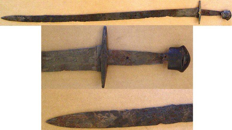

The appearance date of the earliest sabers is vague and so far not finally fixed. It was common to think that the first sabers appeared on the 11 or 12 C. With time, more discoveries moves this date backward and today it is dated to the 9 or 10th C. and may be even earlier.
The saber shown below was excavated in Central Asia, together with a group of several others. As it was not a formal archeological excavation (very unfortunately) any dating or provenance is very speculative, but several experts that examined this blade tends to think it is 9th C. :
Blade length 42 inches, slightly curved, quite heavy and thick, about 10 mm at its base. The tip is double edged for 11 inches with a diamond cross section.
At the base of the blade there is a steel collar used to hold the blade well in the scabbard. The tang has three holes for the grip rivets.
I was lucky to acquire several blades of this lot, and I am glad to share this one with you.

This is an outstanding blade!!! and if memory serves it would seem to correspond to Altaic sabres of the period you suggest. The angled tang (which becomes consistant in some Tatar sabres and the 'Mingrelian' shashkas among others) is seen on these 'Altaic' examples. I think there are good drawings of these in David Nicolle's work on the Mongols. The remains of the 'tunkou' at the blade root also seem consistant with these.
What an incredible find, and as noted, how unfortunate that more exacting provenance was lost,
It seems the remains of swords of this form were discussed a number of times over many years on these forums...can anybody help with the references in Nicolle (I think it is "the Mongol Warlords" that the drawings are in). I think the heading for the discussions here were 'Siberian sabre' ?
Very much looking forward to input on this as it appears an extremely important blade, and fascinating as the long standing and ever developing debates and discussions on the sabre form evolve.
Thank you again for sharing this blade!!!

very interesting, reminds me of my repro 9c magyar sabre:
similar shape, angled hilt and a semi-sharp upper edge at the tip for the 1st 10 in. this one is only 29in. blade, bronze guard and heavy bronze pommel tho. may help envision what yours looked like when it was new.....
An interesting hypothesis about the purpose of the collar is that it was used to accomodate for the grip in case an archer's finger was worn. Such rings were worn on the right hand's thumb and in a hurry, when taking the ring off was impossible, a normal grip would be quite uncomfortable, at least according to reenactors who have tried it in practice. To get a good grip in such a case, the easiest thing to put one's forefinger over the guard and in front of the so-called collar, the thumb with the ring lying on the guard. The collar serves to protect the forefinger from the edge. I do not know if this is true, but if you examine sabres with collars you will note that the collar is extended much further along the edge of the blade than on the spine, which seems to support this hypothesis.
As for the dating of sabres, there was a long thread in the forum a while ago. There are plenty of finds from the 9th century as deep into Europe as the Balkans and nowadays Hungary, which means they must have developped in Central Asia at least a century or two earlier.

Thank you for showing this rare blade. This made me remember another rare blade I have seen in Persian Steel by J. Allan and B. Gilmour, page 55. It is a slightly curved, single edged blade, 71.5 cm long, found in 9th century archaeological levels at Nishapur. Now at the MET. Here is a map – click to make it bigger http://www.metmuseum.org/TOAH/HD/nish/hd_nish.htm
At an excavation at Merv, where Ann Feuerbach participated, they excavated ingots, although they did not have any iron, it had to be imported, but Merv had at least two big plusses, it had a key position on the Silk Road, and it was an Arabian headquarters at the time. Have a look at the map showing some of the key towns on the Silk Road at the time, Herat, Nishapur, Merv, Bukhara and Samarqand.

These blades have been found over a very large geographical area. I would say from the Danube to the Kirghiz region. If the blade in the photo has some hilt elements it will be possible to say more about dating and place of origin.
The collar at the blade base was probably there to keep the blade tight in the scabbard like a habaki on a Japanese blade. They appear on Chinese sabres also. It could be for resting the index finger but the weight of these blades, usually very heavy, doesn't imply that.

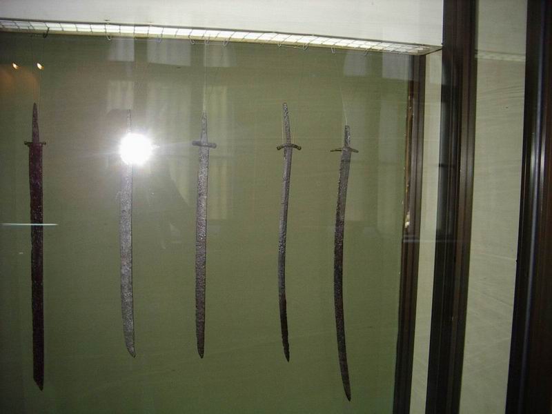

I am glad you joined us, as I have always wanted to learn more about early sabres, because they are the weapon that has always fascinated me the most. No irony intended, I am serious. I like your suggestion that sabres should be classified according to hilt and blade characteristics, rather than the surrounding objects in the burial, because this latter approach does not take into account heirloom blades, that survived for centuries and trophies, which could have been taken from neighboring peoples.
The picture I have attached is from Varna's Archaeological Museum and the display features sabres and palashes found in nowadays North-Eastern Bulgaria. They are dated VIII-X centuries, which was South-Eastern Bulgaria back then, if the dating is correct. What would your comments on them be, with regards to dating, origin, etc.?

OK, let's see-- well, the first on the left is about right for 8 or 9 century, but not exclusively Bulgar. Second one can't say because of the flash. 3rd one crossguard and blade both look Bulgar 10 century give or take 100 yrs, 4th one is definitely later, probably 13 century and kind of an international form from the Caspian all the way to the Balkans. The last sword is definitely Golden Horde so 13-14 century.
The thing with these ancient sabres is condition. I personally avoid the really corroded or incomplete ones. If there's enough material intact to show details like the form of the guard and the cross-x of the blade, you can pretty well date them but that's kind of rare. And if you find ones that still have the pommel, that's just plain luck.
Tim

I appreciate your comments. According to an archaeologist, who published a catalogue of finds from the VII-Xth centuries in the territory of nowadays Bulgaria, the first three are palashes and the 2nd and 3rd he claims belong to a group associated with Bulgars and Khazars. The 4th one, he claims is Magyar, as it is similar to finds associated with the Magyars. I have to admit, to me it looks similar to the well known Charlemagne sabre, which is considered Magyar. For the last sword, I completely agree that it looks like a Golden Horde one.
I will try to post pictures of more finds from nowadays Bulgaria over the weekend. I am also looking forward to seeing as many other examples in this thread, because as I wrote, these early medieval sabres are my favorites, even if I know too little about them.
