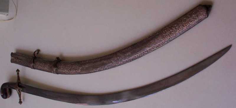

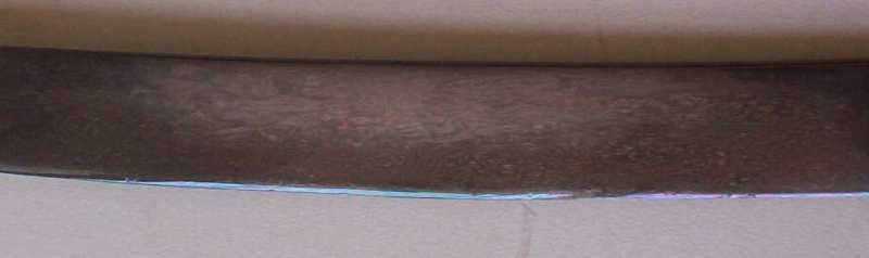

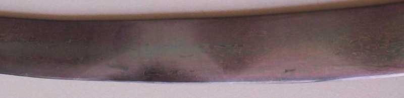

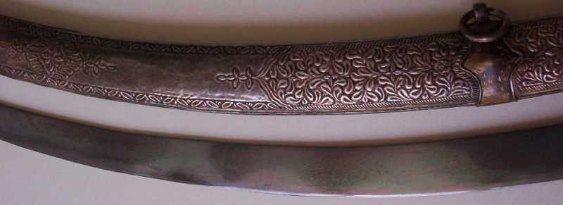

Default Discoloration and Loss of a Wootz Pattern
I have several wootz blades which exhibit some discoloration/random white spots. Some of these spots are of circular shape, which suggests the "damage" could have been caused by a high speed polishing machine. Another suggestion is that they occurred naturally during forging. And yet another suggestion is that the blades were exposed to fire after forging. All these can cause reduction of the wootz pattern. I suspect is has been polished on the machine, which is known to cause loss and distortion of pattern.
Any other opinions, and have you seen similar distortions on other wootz blades?

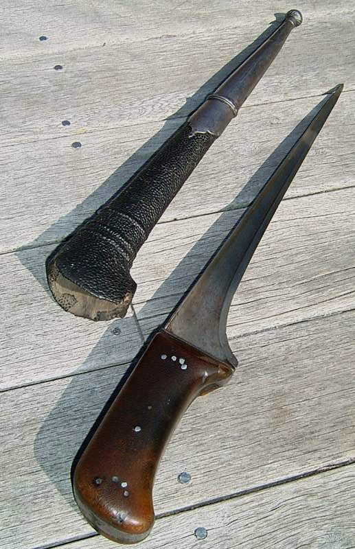

Posts: 1,243
Hi Alex, I have a tulwar that shows a similar sign on the blade, but no wootz and it was clearer after a light etching

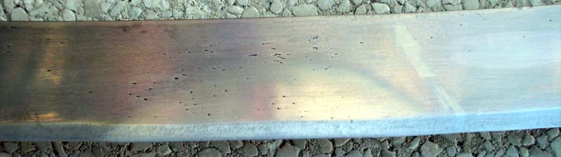

Posts: 6,436
Here is an example of a light area in wootz.
