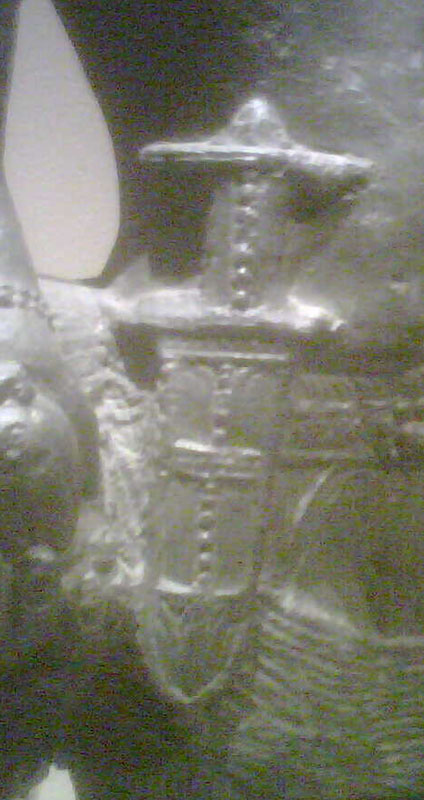

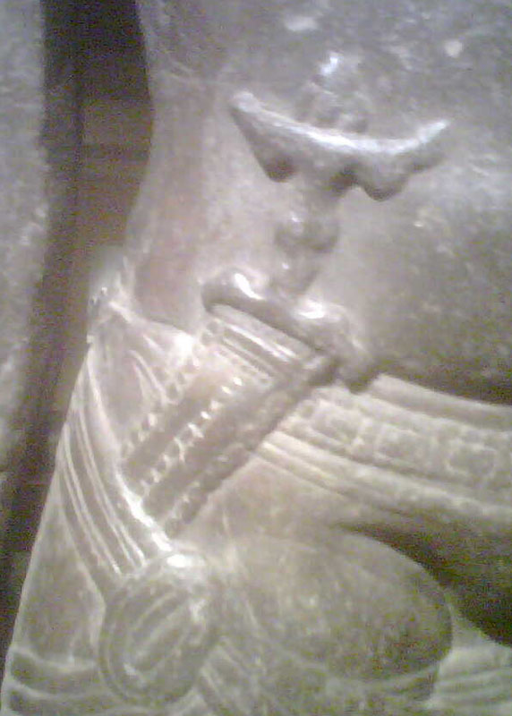

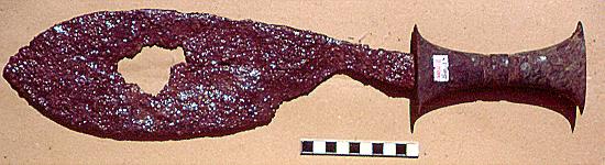

This find was very exciting, because it shows a dagger almost exactly like those found in Pyu sites in Burma (third & fourth photos). The Pyu were a Tibeto-Burman people related to the Bama, but preceding them in Burma by several centuries. The statue is identified as being possibly of Shiva, from Bihar in India (which is in the northeast of the country), and from the Gupta Period, 6th century.

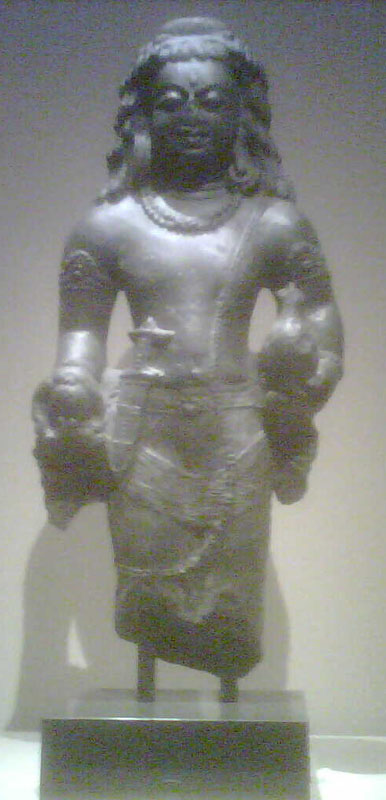

The fifth photo is a detail of another statue of Shiva, but from Kashmir and a later period (end ot the 8th century). In it we see a more typical bichwa or chilanum.
While it is unwise to read too much into a single sample, I'm intrigued by this Bihar knife that so closely resembles the Pyu dagger. Is the 6th century Bihar knife the forerunner of the Pyu dagger? Or is it rather the precoursor to the one shown in the Kashmiri statue? Or both?

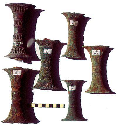

Are the pictures from Bob Hudson of the handles from Pyu sites predating Bagan or from his Bagan excavations ? I did have some .pdf files of his work but currently can't find them .

As I recall (its been a few years), they are from Elizabeth Moore's excavations at Halin. I know that the first couple times I posted about them I described them as being from Bagan, because Bob Hudson sent them to me, but I'm pretty sure they are from Halin. I might be able to go back to my e-mails and check that.
By the way, I did not post a second photo showing the backs of the handles, where it is seen that they are formed by wrapping a sheet of bronze rather than being cast. You can clearly see the seem where the ends join.

I've confirmed from my notes that the rusty dagger with the bronze handle is from Halin, a Pyu/Mon site.
