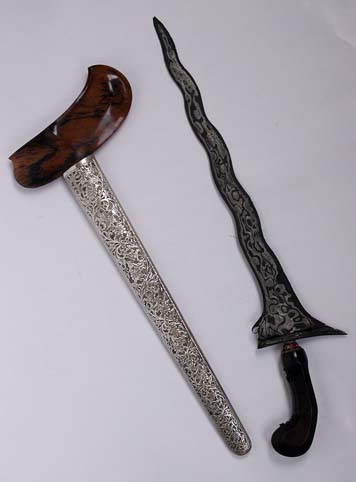

Disturb you, again and again... With pictures. This supposed (yes, just suppossed) to be Segaluh style, if not the tangguh Segaluh... Please forgive me for disturbing you, again and again...
Ganjawulung

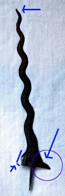

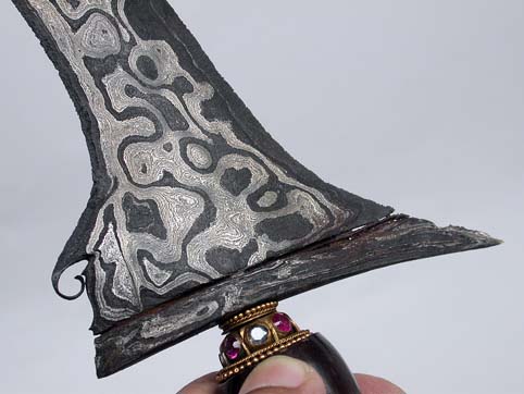

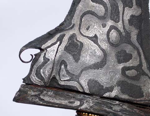

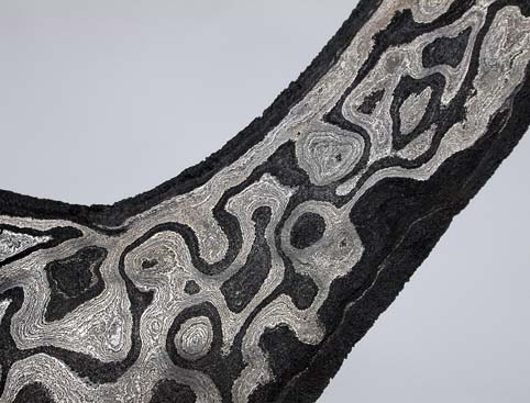

Dear Alan, Mans, and All,
This is my sharing of the pictures I posted, for the time being. I will complete my responsibility later, after finishing my other business. This assumption of tangguh Segaluh, based on opinion which I got from such source as: the late Mr Bambang Harsrinuksmo (once he saw this blade), and also in some occasion with Mr Haryono Guritno and even my other colleague of keris connoisseurs in Solo and Yogyakarta.
The bird eye view to recognize that the keris bears tangguh Segaluh, is the "protruding posture of the gandhik", sometimes extremely protruding. And Segaluh kerises is more protruding than any other styles of keris.
Also from bird eye view, if the segaluh keris with luks, never with "rengkol luk" (wavy luk). But with "luk kembo". Kembo means a kind of "fed up", or "lazy movement". Or say it, a snake in a lazy movement.
At this time being, I don't want to pose you the material argument. Otherwise you see it in your hand. Hopefully this 'first responsibility' will help your discussion. Believe me, I have no intention to cheat everybody. Or intent anyone to "buy this blade". Oh, no. This keris will be here for long, long, long time in the future..
Ganjawulung (or some other spelling, Gonjawulung, or Gonjowulung. Whatever)

Ganja, what you have posted here is perfect for a post on tangguh.
You have effectively said:-
in the opinion of Bambang Harsinuksmo this keris is tangguh Segaluh.
I think you have also said:-
in my opinion this keris is tangguh Segaluh and I base this opinion on information obtained from Haryono Haryoguritno and other people with more knowledge of keris than I have.
Nobody could possibly object to this.
Incidentally, from what I can see in the pic, I'd call it Segaluh too, but if we are trying to create a format for future use, we must remain consistent.

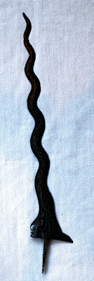

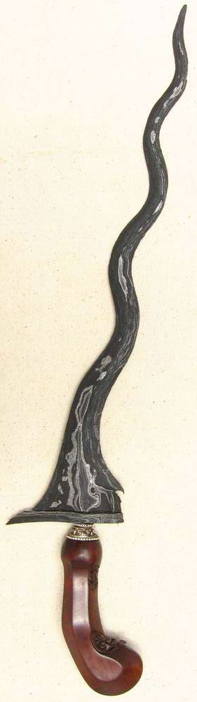

I've thought long and hard about this, but I've finally decided to do it anyway.
I do not agree with the posting of photographs of keris which I identify as a part of my collection. As a general rule I will only post a photograph of something from my personal collection when I decide that I want to sell it.
The keris shown in this post is one from my personal collection, and I have no intention of offering it for sale. I have adjusted the photograph so that all you should be able to see is a silhouette of the keris.
This keris was given the tangguh of Pengging by two of the most experienced ahli keris I know, one of whom was also a very well known empu.
It also displays all the features of a Pengging keris as I have shown in my earlier post.
I am not claiming that it is Pengging, but the weight of opinion available to me seems to indicate that most experienced people would regard this keris as tangguh Pengging.
Compare this form with the form already claimed as representing Pengging. They are very dissimilar.
I do not claim that this keris is representative of Pengging, and the tombak already shown is not representative of Pengging.
What I do claim is that there can be significant disagreement as to exactly what Pengging tosan aji looks like.
This is the reason why it is always desireable to qualify opinions on tangguh.

Posts: 7,255
I'm sorry Cahaya, no.
As I have already stated, I do not agree with the practice of showing keris in a personal collection on a public website.
I have intentionally made this keris very dark so only the outline can be seen, not the keris itself.
I am not holding an exhibition of my collection, which would be something in conflict with my personal standards and system of values,I am only showing an outline for comparative purposes.

hi.
seems like a madiun keris. shown by the pucuk (tips), luk style and aslant of kembang kacang. the ganja not simetris. longer than bottom of the blade. I supposed that the gonjo was replaced or revisioned ?
sepang.

Posts: 7,255
No, it does not bear the characteristics of a Madiun blade, the gonjo is original, however the buntut urang is eroded, as is the wadidang ; if the line of the gonjo and wadidang are extended to their original positions, this line will be seen to be quite long.It is not a high quality blade, but a very ordinary example, and in no respect could it be considered a work of art.The pesi is almost completely gone, and has been replaced with a metal cone held in place with jabung.
As I have already stated, in the opinion of two highly respected ahli keris, one of whom is an empu, now retired, this blade can be classified as Pengging.
It also bears the characteristics of a Pengging blade according to information gathered from Empu Suparman Supowijaya, and as confirmed in conversation with a number of other ahli keris, collectors, and dealers over a 20 year period.
I have provided this silhouette purely for comparative purposes:- a number opinions which must be respected classify this as Pengging, but it's form is nothing at all like the Pengging tosan aji that has already been shown.
I am positive that the attribution of Pengging given to the previously shown tosan aji has not been given lightly, and that a number of people would have this same opinion; in fact, I have another blade, a current era production, that is supposedly a copy of a Pengging blade, and the silhouette of this blade would agree with the silhouette of the previously shown tosan aji which has been identified as Pengging.
Then I have a third blade which is completely different from these other two that was given the tangguh of Pengging by two highly respected ahli keris from Jogjakarta.
The point I am trying to make is this:- Pengging is a very scarce tangguh, and there are clearly a number of opinions as to exactly what characteristics are possessed by a keris of tangguh Pengging.
We would not have the same problem with Mataram Sultan Agung, or with Surakarta, or with Segaluh, or with many other tangguhs, but Pengging is a very, very problematical tangguh.As a tangguh which attracts widely varying opinions it has been an excellent example to make my case that in discussion of tangguh, especially when photographs are being relied upon, all opinions must be qualified.
