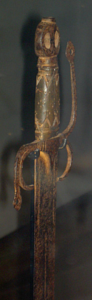

I thought I knew the London collections quite well, but know I tend to visit the same pieces and ignore the fields that dont necessarily interest me. So, I had never been to the African galleries in the basement of the BM. I happened down there today, in search of an answer to a friends question, and stumbled across a 16thC sword from the Kingdom of Konga. Severe Potuguese/Spanish influence (or even heritage, as the blade seems very European). Its hidden far behind glass, and is annoyingly displayed in front of patterned textiles, which confuses my digital camera.
But, it is definately very old and a sword with substantial presence. From its form and look, and have little doubt that the age attribution is correct.
Is anyone familiar with this sword, or ones like it from the same period in Africa?
The description card doesnt mention any provenance, and from the accession number, I think it a relatively recent aquisition. It just mentions the Portuguese in the Konga during this period.

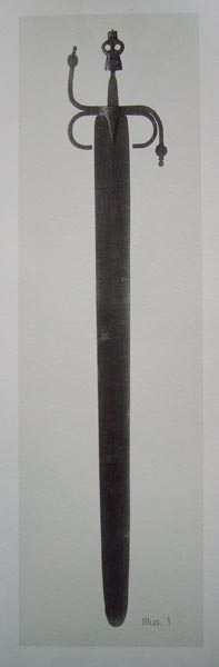

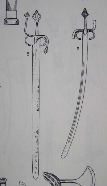

Hi Brian, is something like this?

Old 25th April 2007, 03:56 PM   #4
Flavio
Flavio's Avatar
Location: Italia
Posts: 1,243
Hello Brian, no this is Ijzerwerk van centraal-afrika (H. Westerdijk). This sword is from Congo tribe (tribe that is located near the congo-zaire river and the first that the Europen met when they "touched" the now a days Congo shores). For what I know these swords are 19th century old but for sure they copied the Portuguese older swords (see also this thread http://www.vikingsword.com/vb/showthread.php?t=4369) and they are more currencies than real weapons, but for sure there must be some older exemples that were the precedents of those that we can see today and that were real weapons
Edit: If I understand well (If the translator is correct ) in some examples the blades are imported from Europe and so at least some of these were real weapons and some still have some ivory pieces on the handle (and so no currencies at all). Where are our Belgian friends (Freddy!!!!) ???? The page is 66 (Groep X)

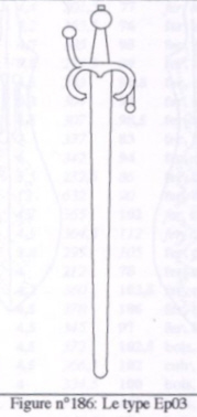

Some more from "Armes traditionnelles d'Afrique" Found around Congo and Angola. As mentioned based on old swords but not that old in themselves.

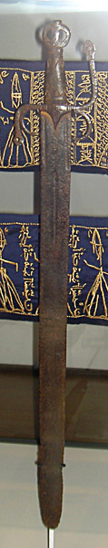

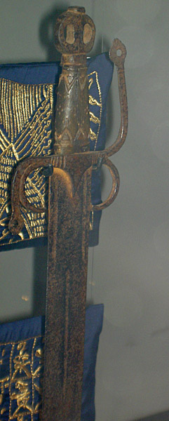

Old 3rd May 2007, 02:14 PM   #13
B.I
Join Date: Jan 2005
Posts: 485
Very sorry for the delay.
Looking at it now, I have doubts of the 16thC attribution, due to the crude fullers. Look forward to other opinions.
Old 4th May 2007, 11:37 AM   #14
Marc
Marc's Avatar
Location: Madrid / Barcelona
Posts: 256
Thanks for the pics, Brian.
The blade sure doesn't look european, 16th c. or else. If these were indeed produced since that time onwards in Africa, it could be from any date since then.
Funny... I wonder how many of the swords of that type presently labelled as "portugese" are in fact African...
Fernando, that bit of data about the portugese sailors making these swords for their personal use to explain their crudeness... ¿where it comes from? It would be good to have a reference for its origin.

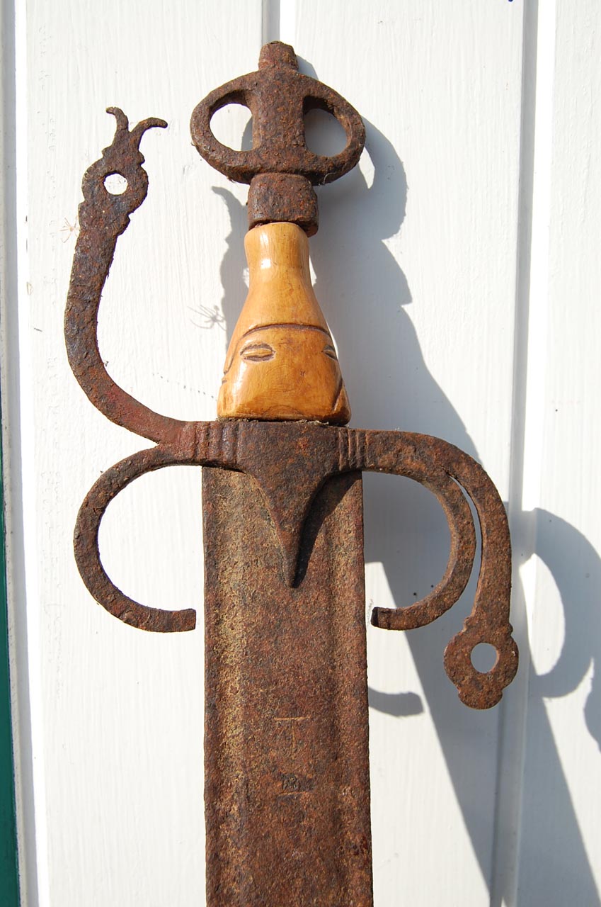

Posts: 143

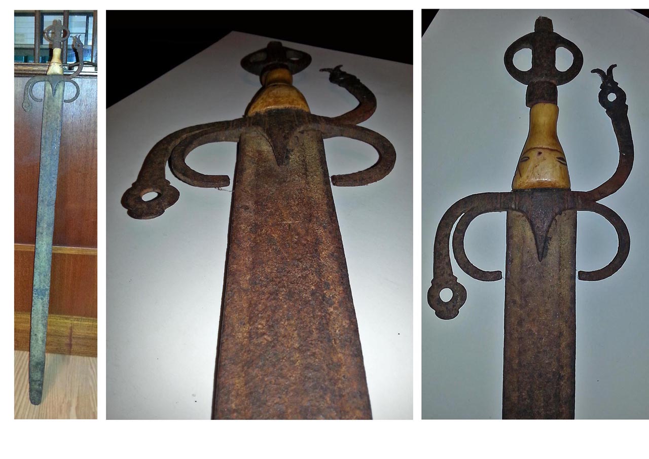

I just want to show you another example I recently obtained, "bought in Kinshasa in the 70ties". Probably a copy of a Portuguese XVI Century sword? Hilt is made of ivory.

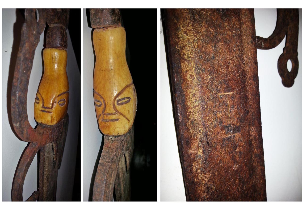

Posts: 143
Daylight pic..

Old 23rd October 2014, 07:44 PM   #20
Yes, it follows the same line ... except for the face on the grip
