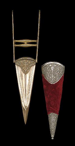

This one was owned by a friend of mine. European without a doubt. You cant see the decoration on the side-guards, but 100% not Eastern, and 100% never made to be used in a battle.

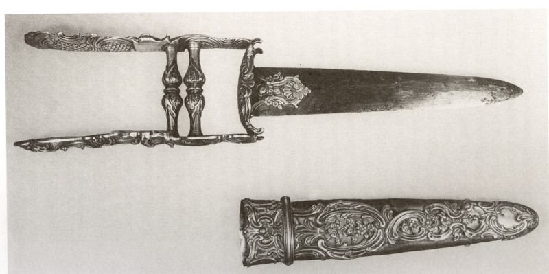

As it appears, there certainly were luxurious katars for novelty, as well as humble katars for rank and file, and also for civilians. Being largely divulged in the west as a combat weapon, i have read that the katar was also meant for defence against tigre atack.
The example pictured is work of a Portuguese silversmith, mid XVIII century. Both scabbard and grip are chiseled silver, mounted on an European blade ( Rainer Dahehnardt collection ).
