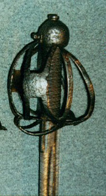

I was visiting a gentleman this weekend in Ladysmith, SA. He show me a sword and wondered if I might tell hine something about it. I told him, I knew noting of swoards, but did knoe a place on the internet where there may be people who are able to help.
He would like to know the typical information. Who made it, where is from, what is it (Claymore?) approximate age, etc.

Scottish baskethilt (?) - this is Jim's Mcdougall's specialty.

I know little about service swords really, but to me it looks bit of a dogs dinner. The blade does not match the hilt to me.

While awaiting the definitive answer from Jim, I will wade in here.
This appears to be a Stirling style Scottish basket hilt from most likely the early part on the 18th century. They often appear like a "dogs dinner" due to long use (often these were thought to be hidden in thatched roofs after the 45, accounting for their distressed look). There has been multiple old repair to yours (including the riveted guard to pommel)
The Blade is of German manufacture from Solingen or Passau. Yours has the Passau wolf as well as the Andrea Ferara Mark of quality. This style is in keeping with the early part of the 18th century.

This example submitted by Double D is magnificent!!! Especially as it remains in apparantly untouched and static condition. While admittedly looking quite rough, it reflects the character and history held proudly in its patination and wear. I would beg the owner not to touch it, and leave it alone, save curbing any active rust if should be the case.
I agree with Jeff, that the style of the hilt is basically similar to those found in Stirling work, however these Scottish hilts have significant variation so it is typically difficult to assign precisely to region. I think the most significant feature that I notice here is the guard arm being attached by screw to the pommel. In the resources and notes I reviewed, I cannot locate any examples of purely Scottish basket hilts using screws for pommel attachment.
This suggests English influence, recalling this method of attachment used most commonly on their so called 'mortuary' hilts as well as many 17th c. sword forms.
In "British Basket Hilted Swords" (Dr.Cyril Mazansky, 2005, p.29), the author notes "...certain Scottish hilts incorporate features of English design", however does not specifically address the pommel screw attachment.
I also agree with Jeff on the blade, clearly of Solingen trade, and of form favored by Scots. The blade itself appears of probably third quarter 17th c. form, and the 'Andrea Ferara' along with the 'running wolf' support same.
It is interesting to note that the running wolf (of Passau) became quite popularly used throughout the blade trade, and also was commonly used in England by the German smiths at Hounslow during the mid 17th c.
The pommel on this sword is closest to Scottish forms of double cone shape.
I would suggest this beautiful basket hilt was probably furbished in the early years of the 18th c., just as Jeff noted, and possibly earlier, and most likely in Scotland and again noting the distinct English influence.

I still have doubts of the Jacobean designation here. Look how clean the forte section of this blade is. The only corrosion is at the blade tip. To me there seems quite a contrast with the hilt. Compere with the blade and hilt match with this one.
This may be silly, but it could be that the blade area susceptible to have markings was cleaned, in later times, to provide for a clearer examination of all the symbols ?!
The riveting of the tang looks coherent with the pommel, in age.

That is ture the riviting does look old. I cannot put my finger on it but the whole forte section and the fullers just do not look 18th century to me. You have to admit that the basket has unmatched corrosion. Scots things and a Jacobite artistic revival was very popular at the end of the 19th century in the UK because of Queen Victorias love of Scotland. I may well be wrong but that basket is at odds with the blade to me.

It is good to be cautious in assessments of weapons from photographs, but such caution should extend as well to sales catalogs. I have closely examined a number of Scottish baskethilts with identical fullering and markings which are clearly from the second half of 17th century. The deteroration of the hilt is also consistant with these hilts of that period, and the sword here appears homogenous. It would seem rather odd to remount this blade on an aged and worn hilt, despite the heritage, especially as well made interpretations of Scottish basket hilts were being made during the Victorian period honoring that heritage.
Fernando has a good suggestion concerning the cleaning of the blade, and very well placed. It seems that the blade tip often is subject to more rapid corrosion as it is one of the thinnest areas of the blade.

I would offer a few possibities as to the difference in patina between hilt and blade. Perhaps there was a surviving scabbard for a good part of the blades life that protected much of the blade. The hilt would have remained unprotected while the blade better protected. A broken tip of the scabbard could have allowed more exposure to the blade tip than the balance of the blade. Also, another factor, is maintenance probably would have been more often for the blade than the hilt. I doubt the hilt was ever oiled or wiped down while I am sure the blade was. Another factor is that the blade and hilt are of different steel. I am sure a well forged Soligen blade of good steel would corrode at a different rate than the iron/steel that the hilt was made of which is probably a bit more crude than the blade. All of these factors would play into the hilt being more corroded than the blade over a period of a few hundred years.

Hadn't thought of the scabbard possibility. The hilts on these were typically painted black (japanned) to protect the iron from rusting in the damp climate, and as this deteriorated and flaked off, they were open to rust.In examining many of these, you can still see traces of the black paint amidst the rust.
