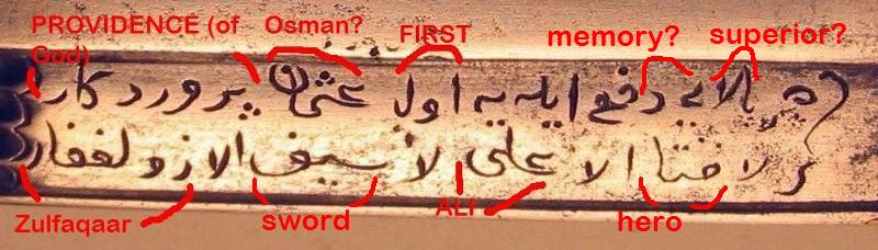

Default New pics of inscriptions!
I managed to get decent pics of the inscriptions:
You can see what I thought was a date at the left of the second one. Thanks in advance for help with this!
Fenris

I agree with Jeff that the date is probably 1933 since I could not see any arabic date on the inscription. In the second picture at the bottom there is a
C. 88 (if I am correct, but I have no idea what it means or why the knifemaker chose to wrote it in half latin and half arabic) I will try to give a meaningful translation of the first inscription later but the knife was made in Erzincan (or Arzincan if you wish) a city in eastern Anatolia.
http://en.wikipedia.org/wiki/Erzincan
Thus the second picture is
933
Erzincan
Yadigar (souvenir)
C.88
the knifemaker's signature

On the first line I can pick out a few words, but not all...The word Osman means Ottoman in English, if I didn't misread it. At least one of the words is Persian.
The bottom line says "there is no hero except Ali, there is no sword except Zulfaqaar"
لا فتى إلا على لا سيف إلا ذو الفقار
The reference to Ali and Zulfaqaar indicate Shi'a origin.

Just a note: yaadgaar can mean souvenir, but it also can mean memorial or monument, so it probably wasn't made as a souvenir but as a commemoration.

Personally, it looks more like 935 to me, but even then the blade may be commemorating a significant event in Erzincan that wouldn't necessarily be a national event.

The first line can be read as:
Her belayı def' eyleye evvel Osman Perverdigar
Which can be translated as:
May God fırst protect you from all calamities, Osman (probably the name of the owner)
This is my best shot, since there are some points which need to be explained or I am not very sure about. Without the phrase "evvel Osman" this a very well known formula (or prayer) for Alevis. But as far as I know Alevis never use the name "Osman" since they don't accept the Caliphate of Osman. However I can't claim to have a deep knowledge about different groups among Alevis. Maybe it is totally legitimate for some of them to use this name.
I don't have any objections to the translation of the second line.

Thanks for the correction, Zifir! I was having a load of trouble with the first line since I only recognised two words and the name Osman. I don't know Turkish, but I'd really like to learn since it's a fun and very useful language from Anatolia to Central Asia. Unfortunately it isn't offered at my school
