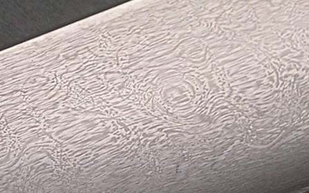

The steel I make typically runs a little higher in silicon and quite a bit lower in phosphorus compared to the analyses in the JOM article, but I recently got an ingot with comparable phosphorus that has great pattern, even though it's 0.73% Carbon...but I also get good patterns with low phosphorus, so I'm not sure what that means
Need...more...data
