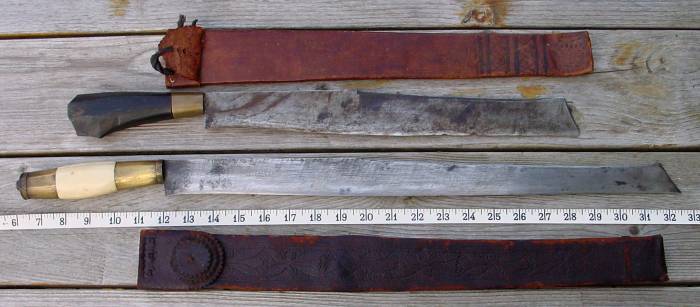

Old 31st October 2006, 05:49 AM   #4
zelbone
zelbone's Avatar
Posts: 169
Smile not Batangueno
Tabaks from north central Luzon...Pampanga or Pangasinan. The chopped tips comply with Spanish law at that time that bolos could not have sharp points because they were considered "threatening." The long tabak has a bone hilt.

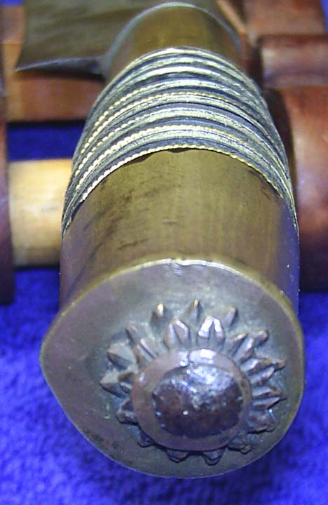

Old 31st October 2006, 06:29 PM   #5
Posts: 7,415
Thanks Zel. Very helpful. On your example on the bottom, does it have a sunburst/flower on the butt ? Mine does and I was thinking that this is a Katipunan piece. What do you think? (When I get pictures I'll post).
Old 31st October 2006, 11:21 PM   #6
zelbone
zelbone's Avatar
Posts: 169
No sunburst pattern on the butt of my sword. It could very well be a Katipunan...at least from the same time period.

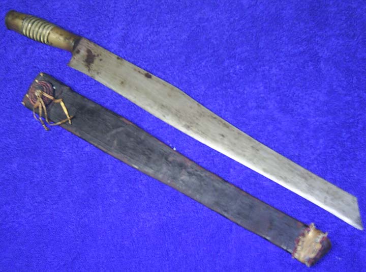

Old 22nd November 2006, 08:15 PM   #9
Posts: 7,415
Finally, here are pictures of my now Pampangan piece. Hilt is brass with some zinc(?) or greenish metal in the spiral. Somewhat laminated, the brass flower/sun is on the butt (not on mine ) and the leather sheath has shrunk over the years and no longer completely fits the blade.
Thanks for all your help.
