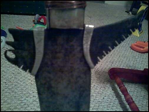

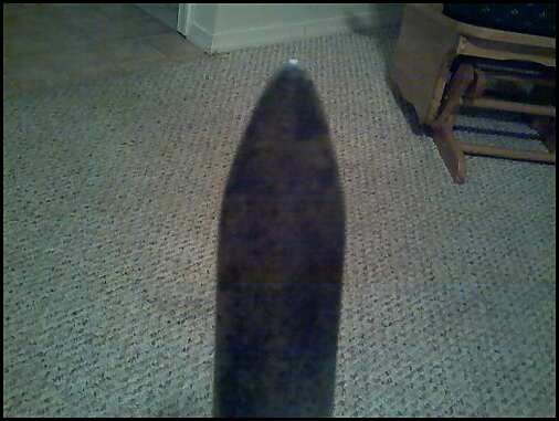

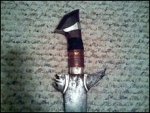

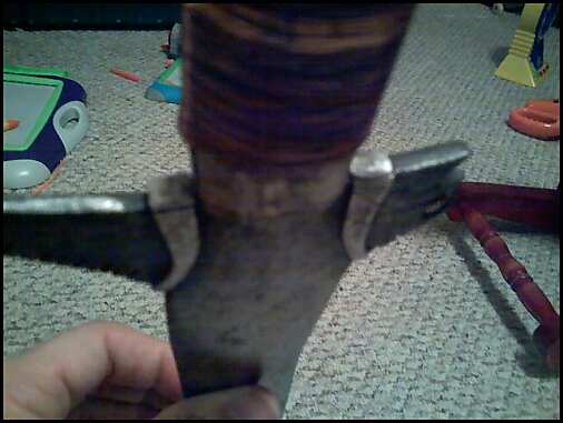

Default Some pictures
Here are a few photos. They are not great either. I only had the camera in my phone to take them with. One day I WILL get a digital camera, really!
Originally Posted by kai
BTW, what's the blade's maximum thickness at the gangya area?
It is about .5 cm at the thickest part of the gangya.
So any ideas?
Old 22nd September 2006, 11:22 PM   #6
Well, that's really thin - any distal taper? It's hard to tell from the pics but workmanship does seem to be lacking a bit. I tend to view this more as a repro rather than a genuine later example but you're the judge. I'd guess all parts are post WW2, possibly not even vintage. Hope others will chime in, too, since I'm definitely no authority...
Old 23rd September 2006, 01:16 AM   #7
Posts: 7,303
I am afraid that from these photos i've got a better idea of what your rug in your living room looks like than i do this kris.
Try shooting it outdoors, preferrably not in direct sunlight (overcast days are great. Try to keep the focus on the blade, not the background.
I agree with Kai that this is probably a post WW2 kris, but i don't think that necessarily makes it a "repro". Is the blade edge-sharp?
