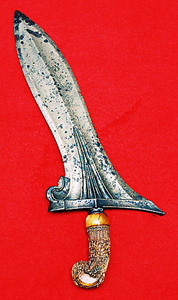

Interesting stuff Pusaka ; welcome back to the show !
You've been absent too long .
Any idea who the entity is wielding the K.L.O. ?

Sorry, i accidently posted under the wrong name as i don't intend to use two different monikers on this forum.
Anyway, hey Pusaka, welcome aboard. Any chance you can supply a close-up on the weapon in the first photo? If i try to blow it up it will just pixelize.
Rick...K.L.O.?

Keris Like Object .
I suspect Pusaka found that online; what say you Pusaka ?
Any chance for a better (sharper) picture ?

Yes, certainly what would help determine whether it is more than just a K.L.O. or a E.K.L.O (extremely keris-like object ) would be what happens at the base of the blade, which appears to be somewhat covered by the hand of the figure in this relief. Doubled edged daggers are quite a common occurrence. Hopefully a close up would tell more.

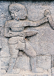

Yes, this is a good graphic example of the line of descent of the keris.
A number of Indian swords as illustrated in Rawson (Library of Congress Cat Card:- 69-11144) display the symmetric blade base observed in the Karnataka relief shown by Pusaka.
A 5th. Century Gupta sword, 10-13th century Pala sword, various khandas including the Harasnath, the South Indian Madrasi swords---some even display a waved blade---the Orissan khanda; all these types shown by Rawson have some feature which can be seen as keris-like.
Older Indian swords tended to be shorter than the khandas I have mentioned, but the typology is still evident in these later, longer blades.
As I noted in my "Origin" article, the keris seems to be a descendant of the leaf shaped blades of India, which Rawson considers to be a "a common Aryan heritage of the Indo-Aryan peoples".
The Panataran relief showing a monkey warrior wielding a dagger with symmetric base is often distorted in published photographs by having the part of the blade where the gandik would be , shortened, or otherwise manipulated, to make it appear more keris-like.In fact, this Panataran representation shows a blade with a very symmetric base---which of course, makes it even more Indian.
There can be no doubt that the keris as we know it developed in Jawa, however, I think that there can be equally no doubt that it developed from Indian roots.

Personally I find the depictions strikingly similar

Thanks for the better pictures Pusaka. Yes, i agree that they are strikingly similar and as Alan has stated, there is a strong line of development that seems to lead to a great influence from India. Generally, though, the keris as we know it is an asymmetric weapon while these are both fairly symmetric in form (the exception would be the keris sepang which is a relatively rare form and, i think, came a bit later in the evolution of the keris form). I think that most folks here probably buy into the concept of a strong Indian influence, though i would agree with Alan that the keris as we know it in it's asymmetric form probably developed in Jawa.

It has what looks to be a primitive Gajah too!

I see what you are looking at, but at this level of enlargement i would find it really hard to be definitive about that. I think we might all need to go on a field trip.

Sorry Rick, yes he is king vishnuvardhana.

First, is the monkey with the blade Hanuman?

I always thought he was Hanoman, but I`ve seen this same relief ---with the altered blade base, of course---in publications by people who know more about the literature than I do, describe him as just a "monkey warrior". I don`t think it makes much difference for our purposes whether it's Hanoman or or a warrior. Both monkeys. Both using weapons.
