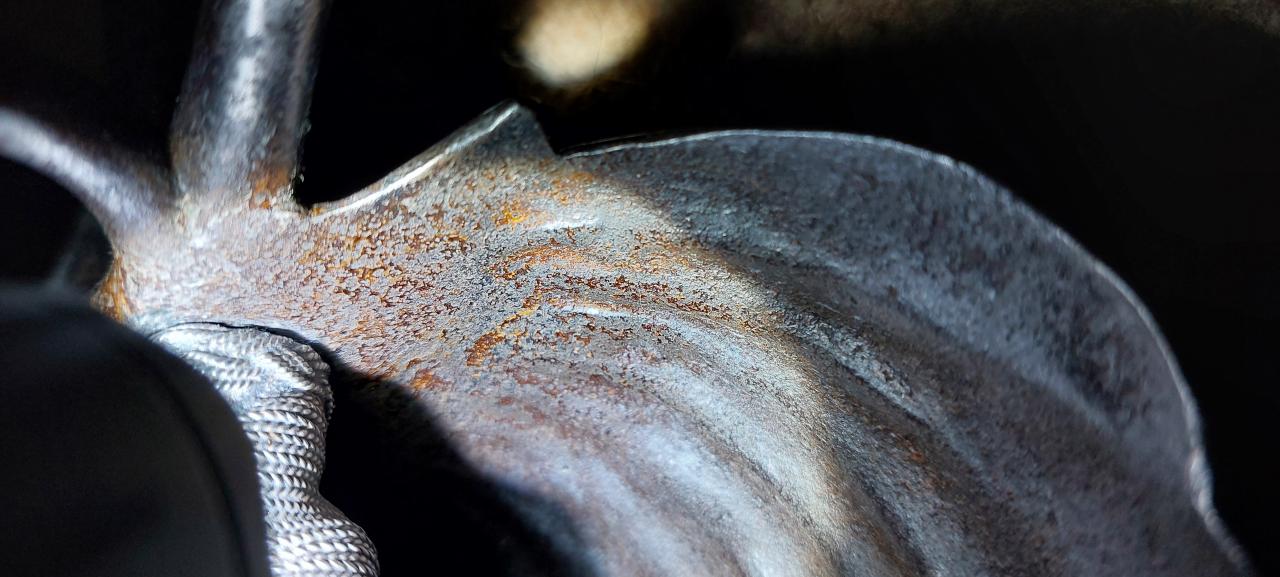

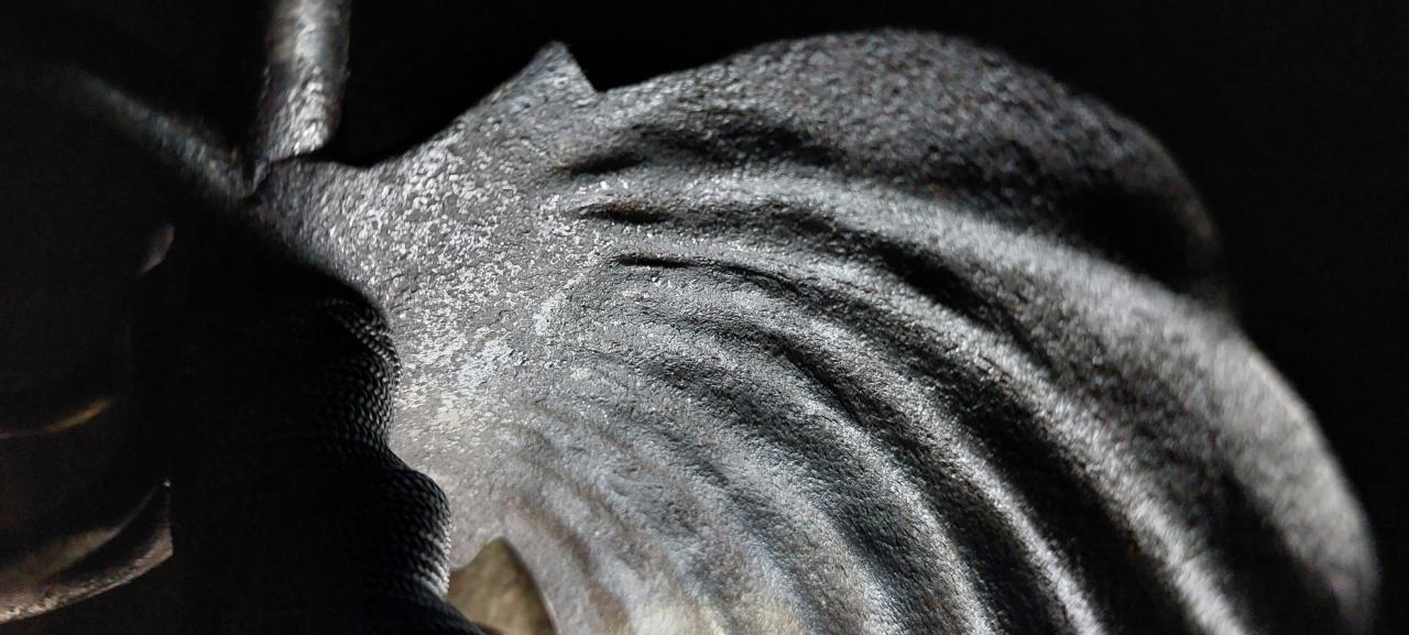

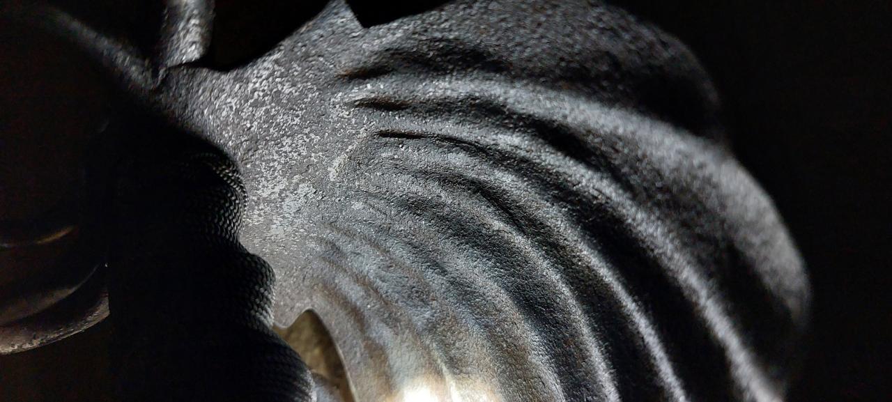

Could you please send an image from the inside of the shell guard?
KR
Andreas
Old 30th July 2026, 02:43 AM   #14
shayde78
shayde78's Avatar
Join Date: Mar 2017
Posts: 454
Sure thing, Andreas - pictures of the inside of the shell guard
Old 30th July 2026, 08:42 PM   #15
AHorsa
AHorsa's Avatar
Join Date: May 2014
Location: Rhineland
Posts: 399
Thank you. On the 3rd picture next to the grip, is this delamination? Can you see delamination anywhere, also on the blade?
BR
Old 30th July 2026, 08:48 PM   #16
shayde78
shayde78's Avatar
Join Date: Mar 2017
Posts: 454
I'm not sure it's a delamination. It's a tough spot to get good pictures, but I tried shining the light at different angles to give a sense of the surface texture. Do these help?
Old 30th July 2026, 09:03 PM   #17
AHorsa
AHorsa's Avatar
Join Date: May 2014
Location: Rhineland
Posts: 399
To be honest, also after having seen the latent images, I tend to think that Copycat is öikely right. But there are others which much more knowledge then me here. Maybe they also state their opinion
