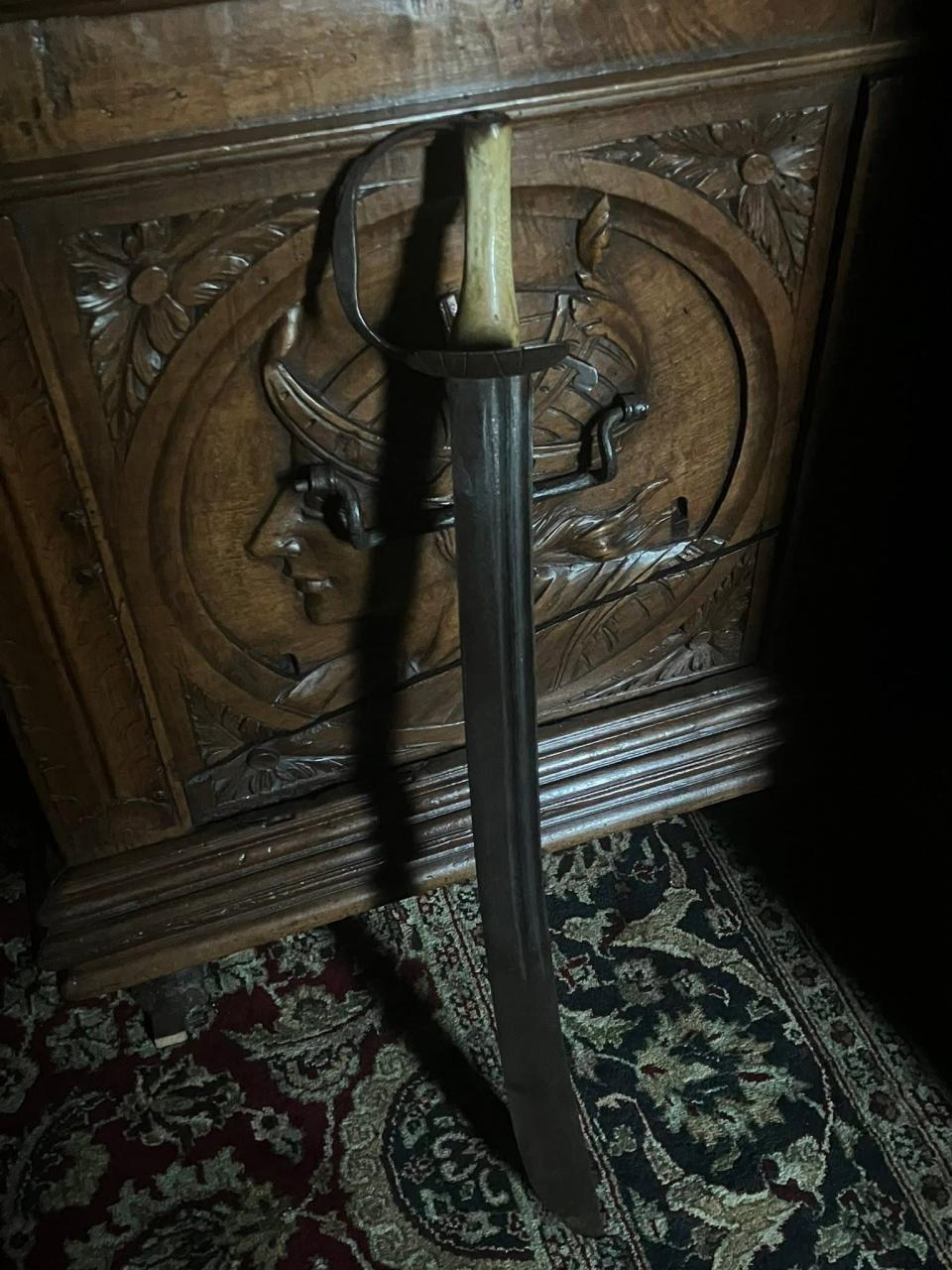

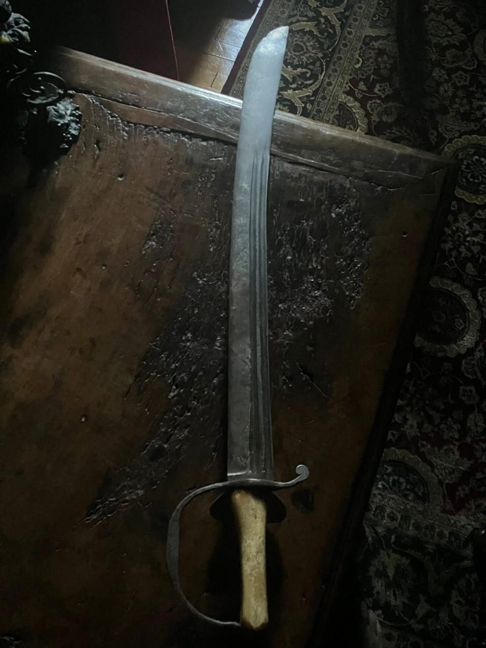

Hello everyone,
I hope you're doing well. For those I've chatted with in the past, I've missed you and I'm glad to be back. It has been a while since I have posted (life has a tendency to keep me away from this part of the hobby, it seems).
However, I recently acquired what may now be the nicest piece in my collection.
The auction site listed this as "contemporary" and referenced "artificial aging". However, my assessment is that is is a true 16th (or early 17th) century Dusack, despite the less than expected hammer price.
I still need to take my standard measurements, and the pictures below are the seller's, but it was listed with the following dimensions: 8.5" Width (Quillions) x 4.25" D x 35.0" Length.
I think it is nearly all original. The grip wire looks a bit too perfect to be original, but if replaced, they did a wonderful job.
Michael D. Long has a very similar piece on their site (it is sold, so I hope it is OK to link to it). My piece has more a decorative pommel and finials. However, the blade is identical (albeit with different maker marks).
I would love to get your impressions of this piece. If it is indeed a reproduction (as the auction company stated), the amount of hours that went into making it are staggering because i don't see any evidence of modern techniques.
It is heavy (again, I'll post stats like weight, dimensions, point-of-balance soon), but it is well balanced in the hand.
Oh, and because it is fun to think of connections to events of the past, this bears a striking resemblance to the sword depicted in the hand of François l'Olonnais, the brutal pirate, as shown in the woodcut in Alexandre Exquemelin's 1684 account "The History of the Buccaneers of America". He was active in the 1660s and the book was published in the 1680s, so who knows if something similar would have been carried at sea. But, since this was sold as part of a "Maritime History" auction, it may have been collected as such.
(additional key words to aid search results - dusack, dusäck, dussack, dysack, tesak, tuseckn, thuseckn, disackn, dusägge, dusegge, dusegg, sinclair)

It's modern. 19th century or younger. No need to be an expert to see this. Just compare it with originals. Plenty of subtle differences.
Still a nice piece.

When only having photos and not the opportunity to have the item in hand, I would say its a very nice example that has been overcleaned at one stage in its life.
When claiming that an item is a copy rather than overcleaned. The follow up question is why ?
What is the indicators ?
Who makes this copies ?
Circle around the parts that clearly shows that the item is new and explain why it is new.
Propper metal surgical assessment can not be done on photos alone. Lack of metal impurities alone is not evidence of a copy for this period.
Below is one of mine that has seen some overcleaning, with a slightly short blade, also heavy but well balanced.
As the starter of this interesting thread I also left this forum some years ago, not because of loss of collecting interest, but to many unsubstantiated statements. It just was not fun to contribute here for this reason.

It was sold as a copy, so that's an indicator.
No one is asking for the "why" in this topic. There is no need to explain if people are not interested.
The example of Michael D. Long is also not good. The whole hilt looks replaced, instead of only the wiring.
Modern looking on the example of OP:
The ricasso
The bars in the hilt.
The pommel
Dot decoration
The blade and false edge also look off, but I need better pictures.
Compare the Hilt with pictures from users. Similar design, but original.
http://www.vikingsword.com/vb/showpo...6&postcount=29
http://www.vikingsword.com/vb/showpo...2&postcount=30
Copycat is offline   Reply With Quote

There are people making very nice repros of these, and other swords with exquisite detail to the hilts, but the one I know is a bit of a one man band from the Czech Republic. I have a simpler one.
However, the blade on yours certainly looks original, though the hilt has been well cleaned.

Thank you for the pictures. They are much more clear then the first pictures. The uniform pitting is a sign of artificial aging. Natural pitting is varied with clear steel, deep pitting and wide pitting. The false edge should be sharp right away and not gradually.
The examples in your books are tricky. They are museum examples, shot from a distance and one dimensional. The blackened hilt makes observation even more difficult.
But even then, you should still see the difference with the bars. They do not have the same diameter along their length.
I stand with with my previous assessment.The blades mark might be genuine from a contemporary smith.

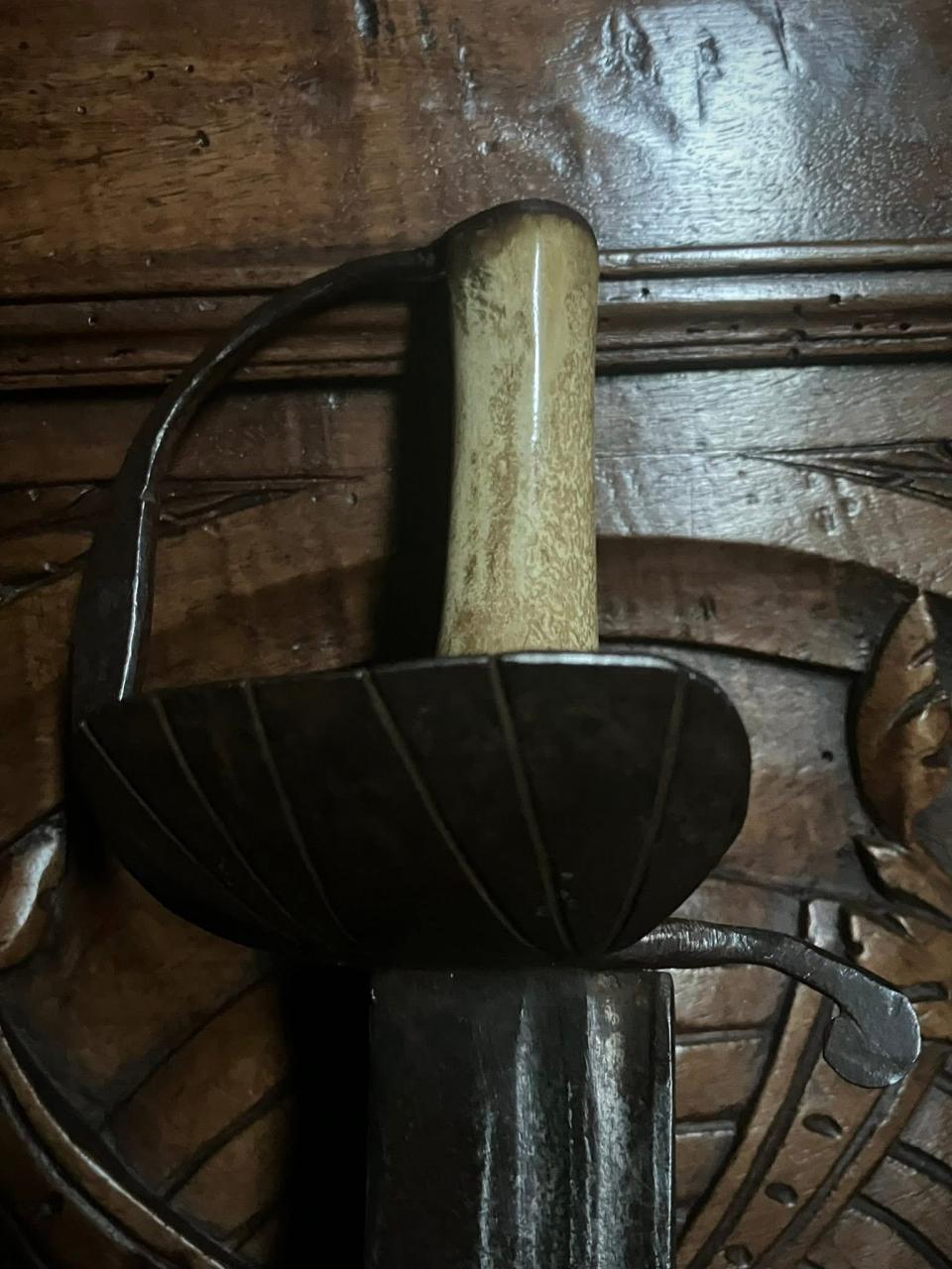

Could you please send an image from the inside of the shell guard?

Sure thing, Andreas - pictures of the inside of the shell guard

Thank you. On the 3rd picture next to the grip, is this delamination? Can you see delamination anywhere, also on the blade?
BR
Old 30th July 2026, 08:48 PM   #16
shayde78
shayde78's Avatar
Join Date: Mar 2017
Posts: 455
I'm not sure it's a delamination. It's a tough spot to get good pictures, but I tried shining the light at different angles to give a sense of the surface texture. Do these help?

To be honest, also after having seen the latent images, I tend to think that Copycat is öikely right. But there are others which much more knowledge then me here. Maybe they also state their opinion

How the surface condition of the blade appears in photos is right to give people pause.
The construction methods still lead me to believe in a period creation.
Also, to correct a previous understandable observation, the hilt bars are not of uniform girth. The thickness of each bar varies throughout their length. However, the variations are not drastic. Still, it suggests fully hand-forged technique and not use of some standard bar stock.
Still, I'll try to provide specific measurements that may help as people try the dubious prospect of assessing an item by mere photos alone.
