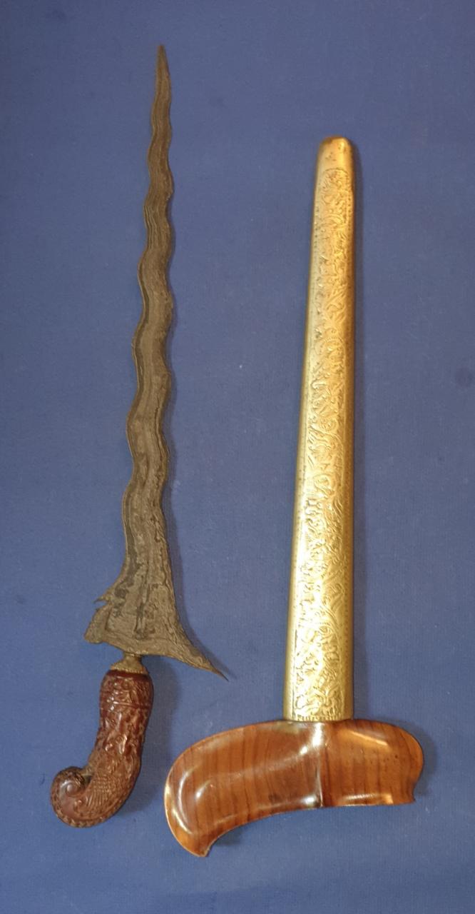

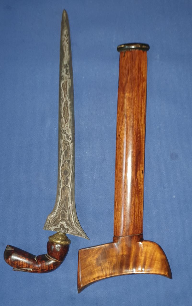

Yes, Palembang keris with gangja iras are somewhat common but they also pop up at other spots.
First example Java/Madura, second one Palembang, third is Bugis. And I think I have seen Balinese keris with gonjo iras as well.

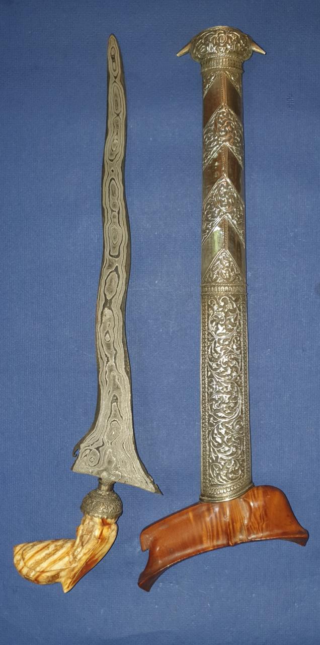

Old 10th May 2026, 06:13 PM   #5
Posts: 6,436

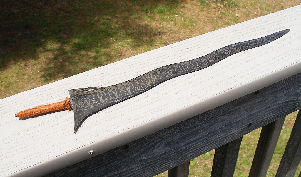

Here's my Iras blade.
I have a feeling, that due to the size (15") and polish, it may be from Lombok.
Old 10th May 2026, 08:17 PM   #6
Gustav
Join Date: Jun 2009
Posts: 1,346
Yes, many Gonjo Iras Keris from Lombok.
Detlef, the blade in your Straits Bugis sheath likely also comes from South Sumatra. Hilt looks like Sulawesi Bugis.
Old 10th May 2026, 09:11 PM   #7
Hello Gustav,
Possibly, got the blade with scabbard only a long time ago on Bali from a Bugis man.
http://www.vikingsword.com/vb/showth...ighlight=Bugis

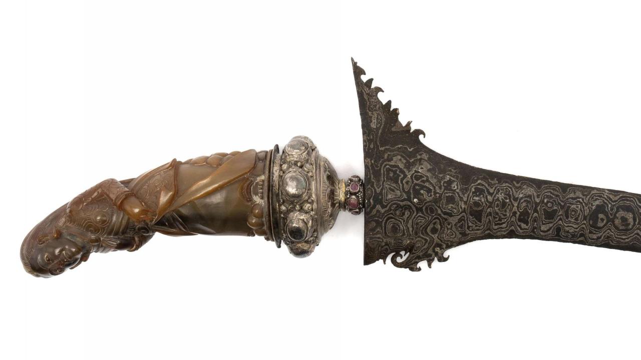

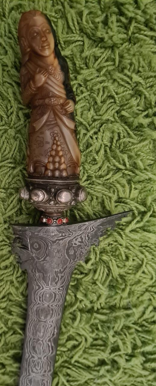

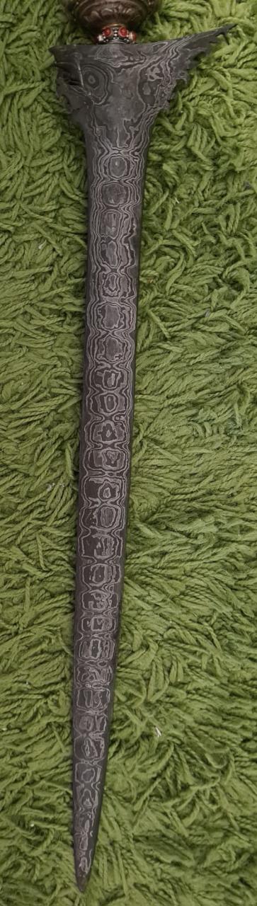

I have owned a few ganja iras krises and they came from several regions.
Palembang and Bali for example.
At the moment I still have one which is one of my precious possessions.
A Balinese kris which I bought without the Hulu ( it had a wrong sheath with a pencil written description of the village where it was found in Indonesia by a Dutch soldier ) and later on I had de sheath made to measure and purchased a Hulu at auction which then turned out to be almost identical to other kris, also Ganja Iras from Bali with a similar Bengo Segodo Pamor which belonged to the collection by E.A.N. (Emile) van Veenendaal.
I have shown and spoken about this kris before.
Im my opinion making a true ganja iras (so that the Ganja is not lost and not replaced) is a sign of great security of the kris maker.
If the maker at the last stages of making this kris makes a mistake it would be very difficult to recuperate the kris.

if the greneng carving goes wrong then the Keris has to be rescued somehow, in that respect if not taking longer, the kris maker has to pay more attention to the carving of the small details
this is the almost identical kris from the E.A.N. ( Emile) van Venendaal collection
Slightly different but incredibly with the same hilt and the same ganja iras and pamor
