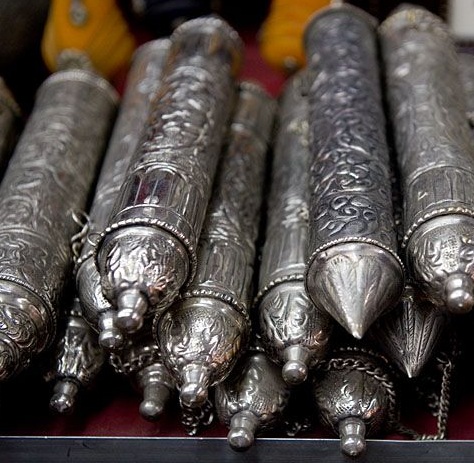

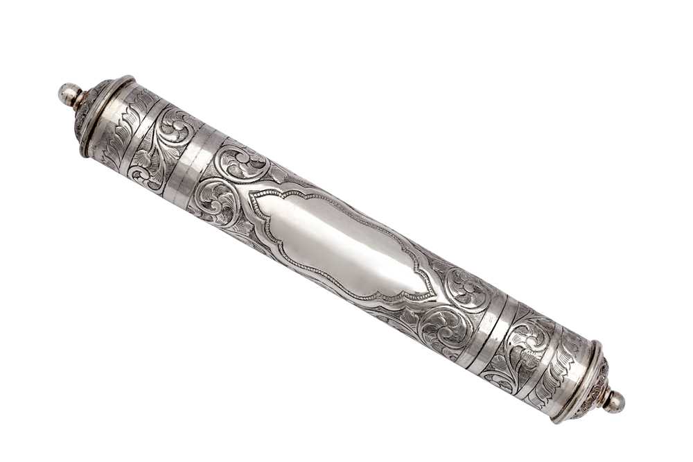

Hi,
The hilt appears to be a Yemeni silver scroll holder that has been repurposed as a sword hilt.

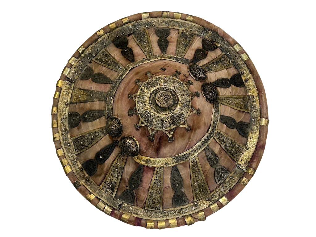

The green velvet is commonly seen on Ethiopian shields (sometimes red as well).
This DIY modification may have been done recently by a European collector, or possibly earlier in Ethiopia or northern Somalia

That is a perfect match, thank you.
