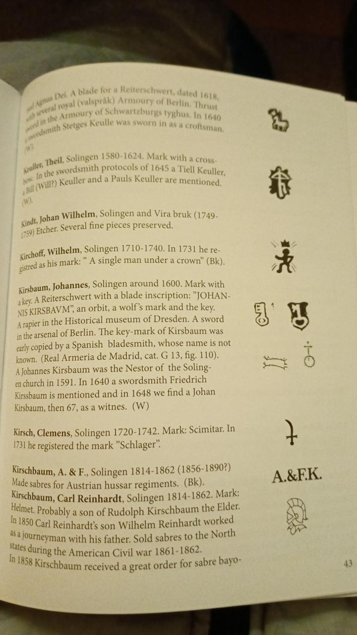

Dear All,
I'm in need to find a help in identifying these marks found on Saxon rapier. I was told they can be found in Steffan Kinman book "European makers of edged weapons". I don't have an access to this book at the moment, so I need your help (ASAP)
Thank you in advance.

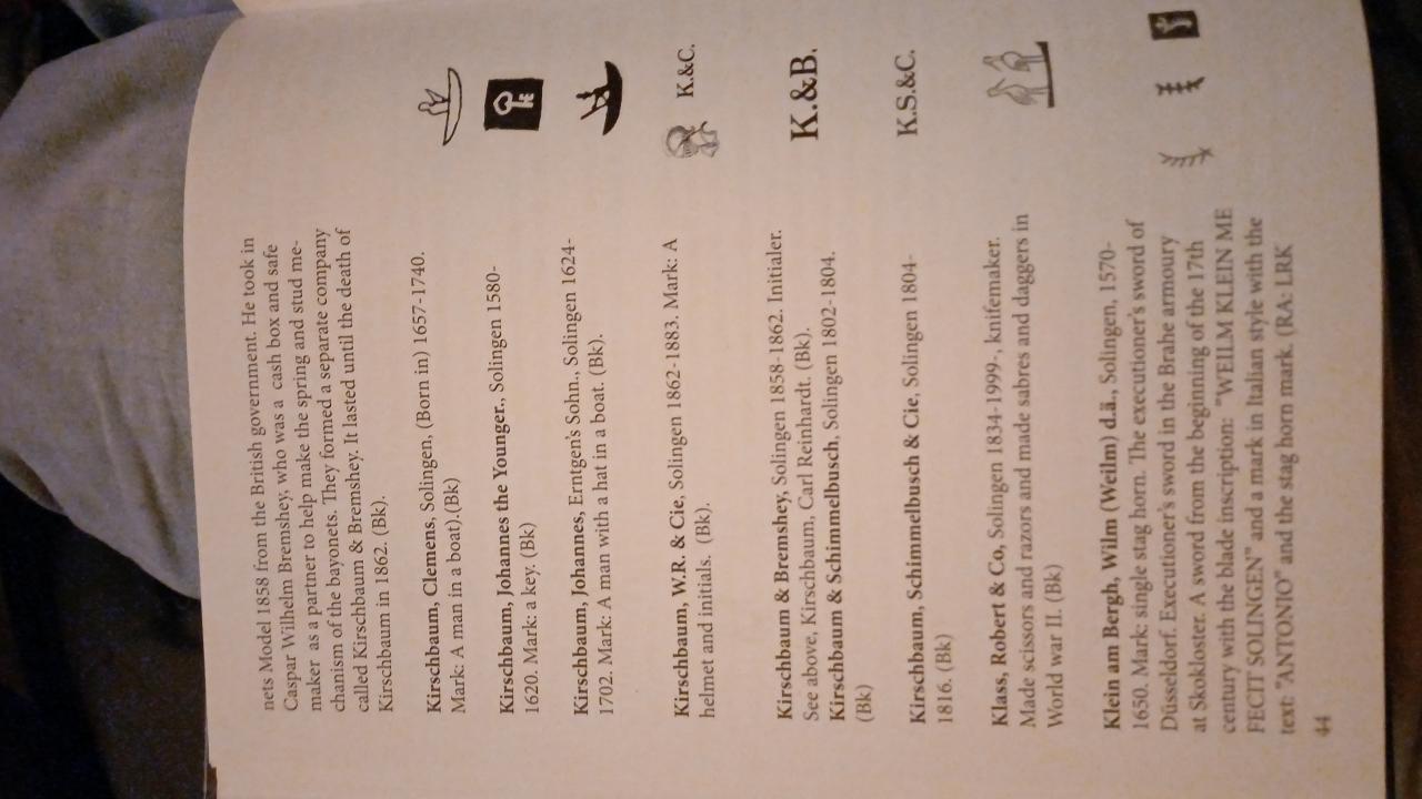

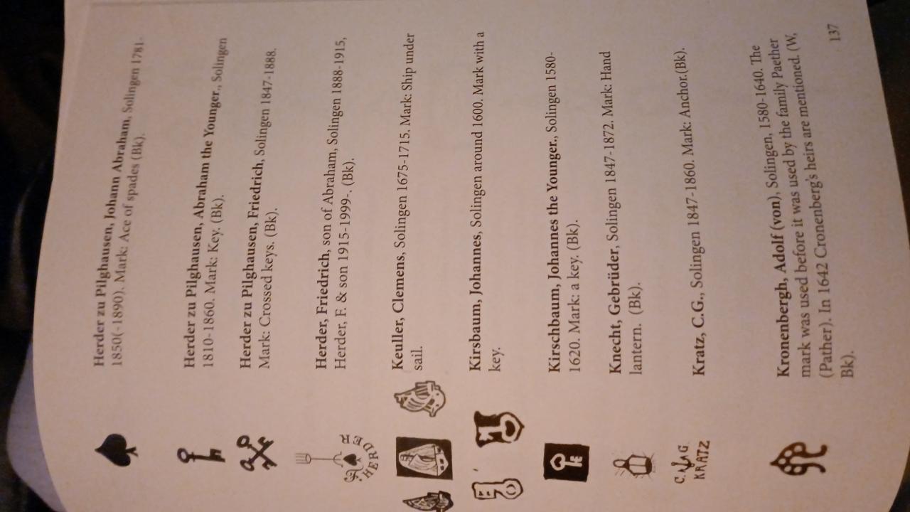

I did find these keys, though not the letters.
Iohannis/Johannes Kirs(ch)baum (the Younger?), maybe?
Also, please post a picture of the complete sword.
Last edited by werecow; 4th December 2025 at 12:35 AM. Reason: Missed page 43, added
Old 4th December 2025, 12:26 AM   #3
Posts: 10,848
Probably Iohannes Kirsbaum Solingen c.1600
On p.43 Kinman,
A Iohannes Kirsbaum was Nestor of the Solingen church in 1591.
This would match the initials and the key, however as usual he used odd variables of the running wolf and cross and orb as well.
On a reiterschwert inscription JOHANNIS KIRSBAUM an orbot, wolfs mark and key.
An unknown Spanish swordsmith also used the key mark (Real Armeria de Madrid, cat.G13 fig.110)

@Werecow
@Jim
It should be it! Thank you so much!
For legal reasons I can't post the whole sword at the moment, but this is exactly the same hilt as here in Dresden, RA or MET (just different blade):
https://skd-online-collection.skd.mu...s/Index/286406
https://royalarmouries.org/collection/object/object-95
https://www.metmuseum.org/art/collection/search/23042
