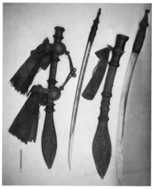

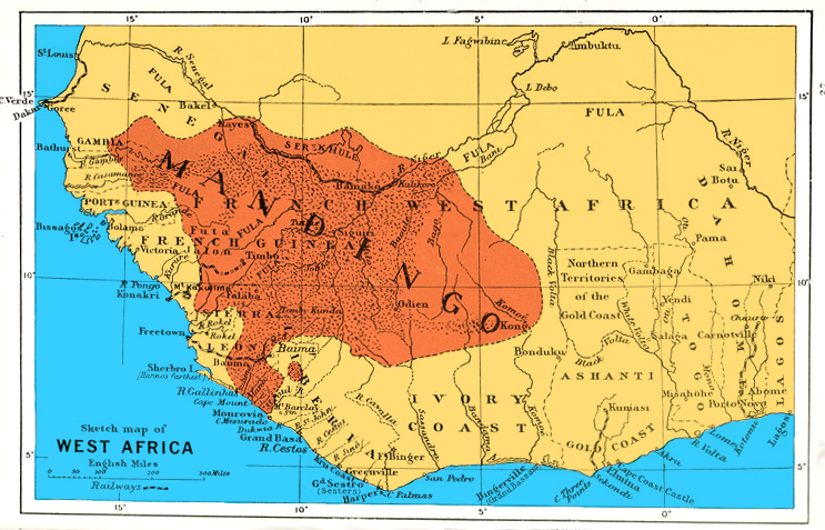

The Mali Empire began in Manding province in about the 13th century. The history of these regions in the Sahara are complex, and not necessarily relevant to my questions.
Just when did the distinctly Mandinka (Manding) saber appear in its well known form? and from what influences"
Further, what is it called?
While it is associated primarily with these Mandinka/Mandingo people in the Mali regions, these people also inhabit West African regions in Gambia, Guinea, Guinea-Bissau, Ivory Coast and Senegal.
An example with provenance shows the present form is from the collection of the governor of Mali (then French Sudan) Lt. Col. Joseph Gallieni , circa 1886.
The photo of a tribesman wearing one of these is c. 1907.
We know these are often with European saber blades, most often French, which is of course quite understandable. What is most intriguing is the distinctive leatherwork on the scabbard, guardless hilt, knob pommel, and most perplexing.....the flared scabbard tip.
Across the Sahara, this same distinct scabbard feature is seen with those of the Sudanese kaskara, and seems to have originated with the Funj kingdom of Sennar areas of S. Sudan from around mid 19th c.
Clearly the transSaharan trade networks might account for such diffusion, but which way? where was it first, and as yet, there seems no explanation for the feature.
What in the world were these Mandinka sabers called?
In one reference, it was said the name is fan-ho.
A Fulani man I once knew, from Guinea, told me the sword was 'kota' and that the scabbard was 'holga' (=house).
The top photo is the c1886 example from Gov. Gallieni.
The tribesman c. 1907

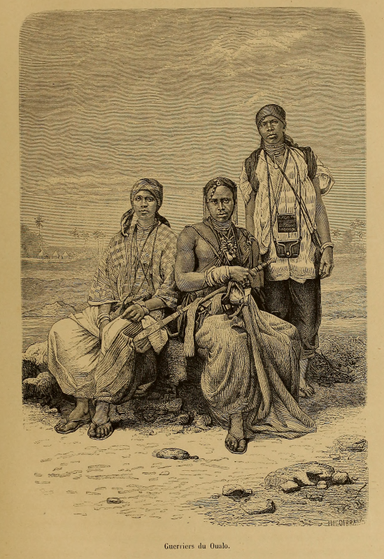

On page 17 there is an engraving of Guerriers du Oualo, he has a sabre that is well known to us, unfortunately I was not able to find out who the Oualos were.

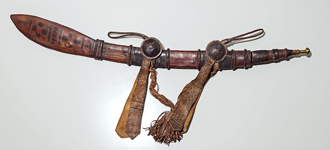

Changdao provided a brilliant overview of the region from the 12th to the 18th centuries. But as we know, all empires have phases of rise and decline: some disappear, and new ones arise.
We have surviving examples of sabers called "Mandinka," dating from the late 19th to early 20th centuries. During this period, the Mandinka region and related tribes were in decline. According to 19th-century travelers, they practiced primitive agriculture and had primitive industry, including metalworking.
As I wrote above, in 1904 these territories became a French colony. The year 1897 proved fateful for the neighboring region, the Sokoto Caliphate. In January and February, a small, well-armed force, equipped by the British Royal Nigerian Company, invaded and destroyed the strategic southwestern emirates of Nupe and Ilorin, Adamawa and Kano in 1901, and Sokoto in 1903. However, after the Berlin Conference of 1884, the entire continent was colonized, leaving Liberia and Ethiopia as the only sovereign states in sub-Saharan Africa.

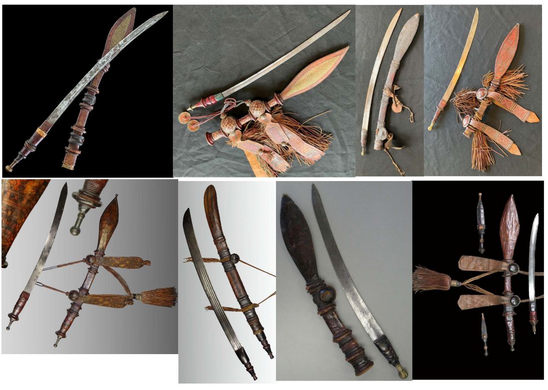

I've selected sabers that were freely available from the internet and offer them for discussion.
All the presented specimens date from the late 19th to early 20th centuries. The overall length ranges from 74 to 82 cm, and the blade length from 60 to 76 cm.
Almost all the blades are from European cavalry and infantry sabers. Judging by their overall length, these are blades with broken hilts. Based on this, one can conclude that these are not commercial trade supplies, but blades that accidentally ended up in the hands of good craftsmen for reworking.
The brass pommels of each specimen are different, but executed with great skill and taste. The same can be said for the leather work. The high-quality leather handles and scabbards are truly works of art. All this testifies to the presence of well-established handicraft industries, rather than isolated artisans.
I have no data on the existence of such industries in Malinke, but my neighbors did. Read J.P. Smaldone's "Warfare in the Sokoto Caliphate":
Page 139
This centralizing effect of war is clearly shown also in the organization of the various craft industries in the nineteenth century. In each emirate the craft industries operated under direct state control, each craft being organized under a chief responsible for quality and price control, tax collection, and production for the needs of the emir. The leather industry provided saddles, shields, sheaths, quivers, horse trappings, and baggage cases. Blacksmiths made swords, spearheads and arrowheads, horse trappings, flintlocks and shot for the gunmen; brass workers produced more exquisite and expensive varieties of these items. The weaving industry prepared "uniforms," blankets, tents, baggage, and suits of lifidi. As Nadel has written of Nupe, this organization of the craft industries amounts to a full control of the political system over all the more important industries
. . . this control was dictated by the needs of the state: based on constant warfare, committed to uphold the splendour of a huge court, the political system has to guarantee a dependable, uninterrupted supply of all that is needed - arms, tools, clothes, saddles, as well as the many symbols of wealth and status.
Looking at these specimens, one might speculate that these are not combat sabers. Ceremonial, status symbols, merchandise for tourists?
As always, questions, questions, questions...

Regarding the antique examples posted, I would say that all the top row look like they have European saber blades, and the second from the left on the bottom obviously has a machete blades. The others I'd say are of local manufacture. As to their use, neither of those is mutually exclusive. Swords are multidimensional objects, that have a use in combat but also a social and aesthetic value and symbolism. But they were used in war, even in very late dates when most West African soldiers would have been using a gun of some kind.

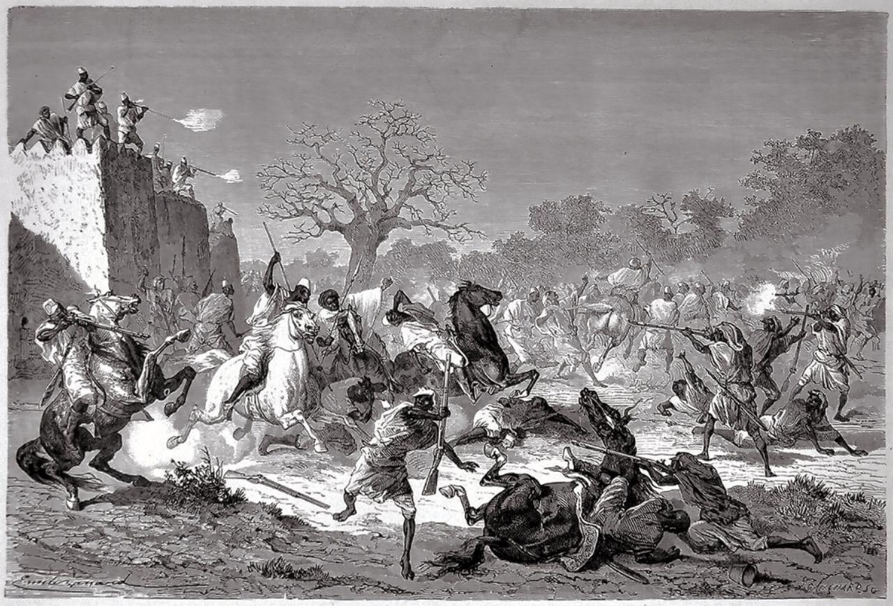

As an illustration, here is an engraving from 1868 depicting a battle between Bambara and Umar Tall's Fulani

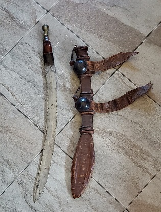

Guys, I just wanted to thank you both so much for all this material, illustrations, examples you have both provided. Changdao, your specialized and comprehensive knowledge of these tribal peoples and their history is phenomenal, and Yuri your research skills are well shown in augmenting detail.
This is exactly the kinds of results I have always been so grateful to see here on these pages, as it is all focused on the discussion of a weapon form or its associated contexts, and to learn from them.
Truly brilliant! I have had my single example of the Mandinka saber for decades, and never knew much about it as little was ever covered on them in the circulating references.
It is a mystery no more!!!
Thank you again,

But I would like to discuss specifically the "Mandinka" sabers, which date to the late 19th - early 20th centuries.
I have the following questions:
1. The production of the specimens shown in the photo involved various crafts—blacksmiths, tanners, coppersmiths (this is not the work of a lone artisan), similar to the Blacksmith Market (A. Suq al Haddad) in Kassala described in Edwin Hanley's brilliant essay. Where could such production have taken place at that time?
2. I rightly mentioned the Berlin Conference of 1884 and the colonization of Africa by the early 20th century. Did the colonizers in the occupied territories allow local residents to make swords and sabers?
All this calls into question the dating of these specimens.
Finally, the presence of such richly decorated scabbards calls into question the use of these sabers in combat.
Sincerely,
Yuri
Those certainly are interesting questions.
Regarding 1, in traditional Mandinka society there is a tripartite hereditary division between horon or free farmers (from which the "noblemen" and headmen come from), nyamakala or specialized professionals, and slaves (who could become freemen, or their descendants could). Amongst the specialized professionals we find leather workers (garankew, and they claim Soninke origins), wood carvers, bards, and metalworkers or numuw (that also do pottery in the female side of the clans). They are integrated into wider Mande society, but one would find greater agglomerations of them, capable of more complex and specialized work, in large villages and urban areas. Some areas in particular have greater concentrations of metalworkers than others, but every single town had (and still had in the 20th century) at least a blacksmith family. Their workspaces are invariably in these towns, and most have three to five families of metalworkers living there. Smelting furnaces were, however, located outside of town and operated jointly by the local smith communities.
Here I am working from The Mande blacksmiths : knowledge, power, and art in West Africa
Regarding the scabbards, I don't see why being ornate would make them unfit for combat. Lavish decoration on weaponry has been a feature of warfare everywhere since prehistory, and when individuals could afford some bling on their gear they almost invariably did so. Besides, in 19th century engravings where they appear one can sometimes spot these leather decorations.
Changdao is offline   Reply With Quote

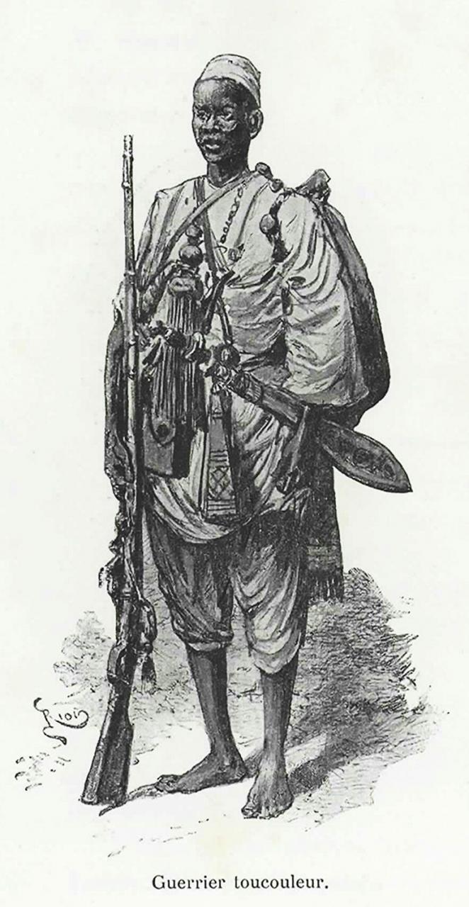

P.S. Please share which book the engraving is from - Guerrier toucouleur.

But they are functional and simple weapons. The unsheathed swords are pretty spartan, except for the quality of the leatherwork, that varies a lot. And there is also variation in how much decoration they have on the scabbards. Some just have a bunch of leather strands, and others have much more. That's not going to be a hindrance in combat. Besides, cavalrymen and officers (on horse) usually can afford to carry more ornate decorations in their panoply, but infantry also do. Plumed crests for helmets in Greece and Rome, horns in Bronze Age helmets, the lavishly ornate Celtiberian weapons, the luxurious Sassanid swords and the textile bells they hang in their horses' barding, Medieval European decorated helmets, bejewelded swords and armor, the beautiful Renaissance plate armor sets, samurai scabbards with fur decorations at the end and their decorated helmets...
Those paintings and photos of officers showing off their status through weapons show a reality that also manifested on the battlefield; they went to war armed in the most spectacular fashion they could afford. Sure, coral hilted swords for example were exclusively civilian, but there's a difference between that and a gilded hilt. The European contemporaries of these antique examples also carried swords in Africa: the troopers were given plain sabers, but the officers often purchased and carried more ornate things such as non-regulation pattern blades, engraving and etching on the blades, custom hilts, etc. And then top officers carried even more luxurious objects that were part of their attire (ceremonial in a way), but perfectly capable of being used in earnest in a dire spot.
As for the second point, how does a copper or brass pommel make them expensive? West African warriors had a very old tradition of carrying copper bracelets and torques. These were no more in the 19th century (but they still used gris-gris), but those supposed a much greater amount of metal. On the whole, these would be rather cheap swords (keeping in mind that not everyone had one, so some wealth would be necessary). And these were not mass-produced by a state-owned arsenal to equip warriors on the cheap, they were bought by the soldiers themselves out of their pocket.
And these sabers were not necessarily the go to for the highest status swords in Mandinka society. You also have the straight shortswords and daggers that have much more complex and expensive materials and style for the hilt. These are rare in 19th century art, but the only example I know of is carried by a Mandinka chief of the Gambia.

P.S. I do not know exactly from where the engraving comes from.
