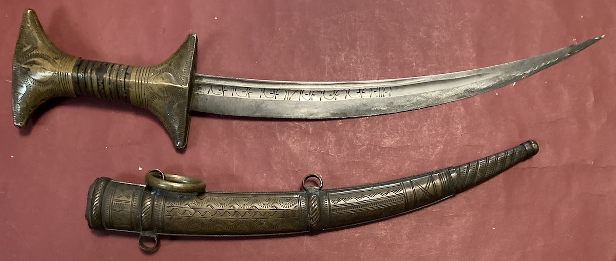

Hi All,
I know that it sounds like the beginning of a verse from Shirley Ellis' name game song but I was wondering how forum members would classify this knife. The hilt is clearly an s’boula/jiboula form but the blade and sheath are just as clearly shula. I’ll come right out with my opinion that it should be considered an s’boula/jiboula because the hilt was placed on the blade by a person of the s’boula/jiboula culture. But were the situation the other way around (shula hilt on an s’boula/jiboula blade), I’m not so sure I would want to call it a shula. What do you guys think?
Sincerely,
RobT

When it comes to ethnographic arms, we tend to classify swords and daggers by their hilt. For example, the same blade can be a takouba, a kaskara or even a firangi, depending on the hilt.
Based on this then, this would be a sboula.

I decided to resurrect this thread because of a map in the online sample of Hans Wealth’s book (https://www.armes-anciennes-du-maroc..._selection.pdf). The map shows areas for the Moroccan khanjar, shula, s’boula, and various styles of koummya, The areas for both the shula and s’boula are in the northernmost part of Morocco. The shula area is roughly oriented east to west and extends over almost all of the Alboran seacoast (part of the Mediterranean) while the s’boula area is roughly oriented north to south and its coastline is mostly on the Atlantic with a small portion on the Alboran seacoast. The s’boula area is larger than the shula area.
The important thing is that the shula and s’boula areas overlap in part. This likely explains why my dagger wound up with an s’boula hilt on a shula blade and sheath.

Very nice and interesting dagger! For me it's just the name game. I wouldn't be surprised that "s'boula" and "shula" are only different spellings for curved dagger and the "classification" for two, for our view, different curved daggers, is a western collectors "classification.

Coming back to your knife at the start of this thread, I think it might be an example from the area where the s'boula and shula coexist on Waelty's map. In other words, a local hybrid of the two. I think you could call it either a s'boula or a shula or a hybrid of the two, just as we see hybrids of Moroccan koummya/khanjar in the late 19th/20th C.
