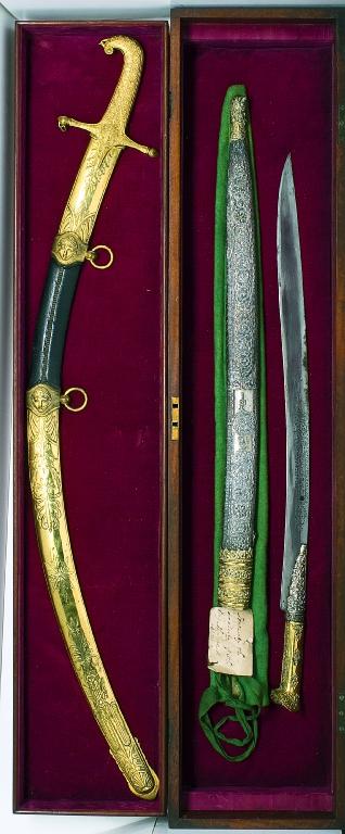

Salaams All...I went searching for Omani Shamshir of any description perhaps presented to visitors or whatever.. and found this peculiar double presentation of a Yatagan and a Shamshir...to the same person. and Described by the Auctioneer Thomas Del Mar (hammer price recieved) as...
Quote"THE GILT-BRASS MOUNTED SHAMSHIR PRESENTED TO
SIR CORNWALLIS RICKETTS BY THE IMAM OF MUSCAT
AND SULTAN OF ZANZIBAR, CIRCA 1845.
With curved blade double-edged towards the point, etched
and gilt with celestial motifs within a panel over the forte
on each side (worn), gilt-brass hilt cast with scroll work
enclosing expanded flower heads in low relief, comprising
cross-piece with fluted terminals, a pair of langets, and
integral grip rising to the pommel, in its original leather
covered wooden scabbard, with large gilt-brass mounts
comprising locket and chape chased with flowers and
foliage and a pair of suspension mounts decorated with
masks in the French taste; together with
A TURKISH SILVER-GILT MOUNTED YATAGHAN, 19TH CENTURY".Unquote.
I have to say I found this very odd since it is a Shamshir but not in the Omani style but in the French... and presented to an Englishman!
Ibrahiim al Balooshi.
