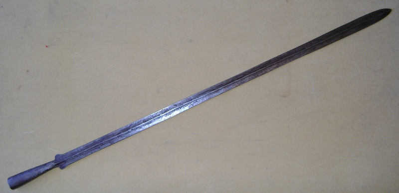

Dear all, i bought this spear from one collector, he claimed that it is real hunting spear from Maasai. Spear head is 106cm long, total spear length is 188 cm.

I believe that it is a proper spear, suitable for use by a young warrior. This is not to say that these have not been bought "new" by tourists; a friend of mine has a very similar example he acquired during his time in east Africa in the Peace Corps in the 1960s.

I assume that the 106 cm (about 41.75”) head includes the ferrule? Even with that, it’s a big boy. I have a pair of these spears and they both measure (including ferrule) around 85 cm (about 33.5”). Your photos show that the workmanship on the head is excellent, so I would say that your spear is the real deal (whether newly made or not).

It is the real thing but a late form different from examples from the 19th century and early 20th century, nice to have.

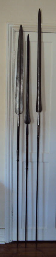

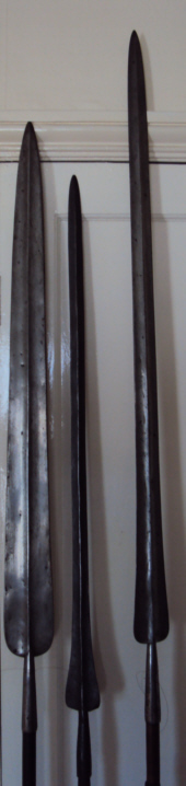

Sorry for the late reply have been away in the Orkney Islands. These later spears are shorter and having a narrow blade with a blunt section Approx half way up the spear. The older types had a broader blade at the base and mostly sharp all the way up. The was a narrow version where the blade would be over a meter long and blunt with a pointed tip.
