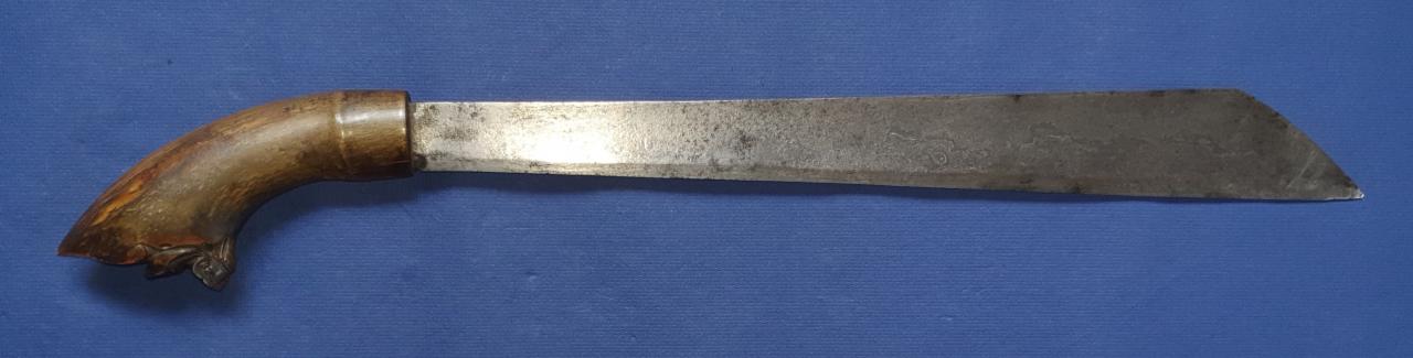

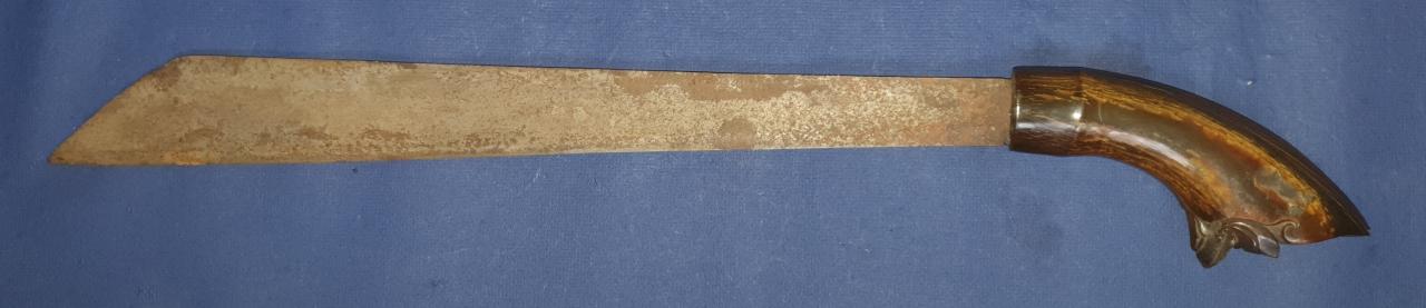

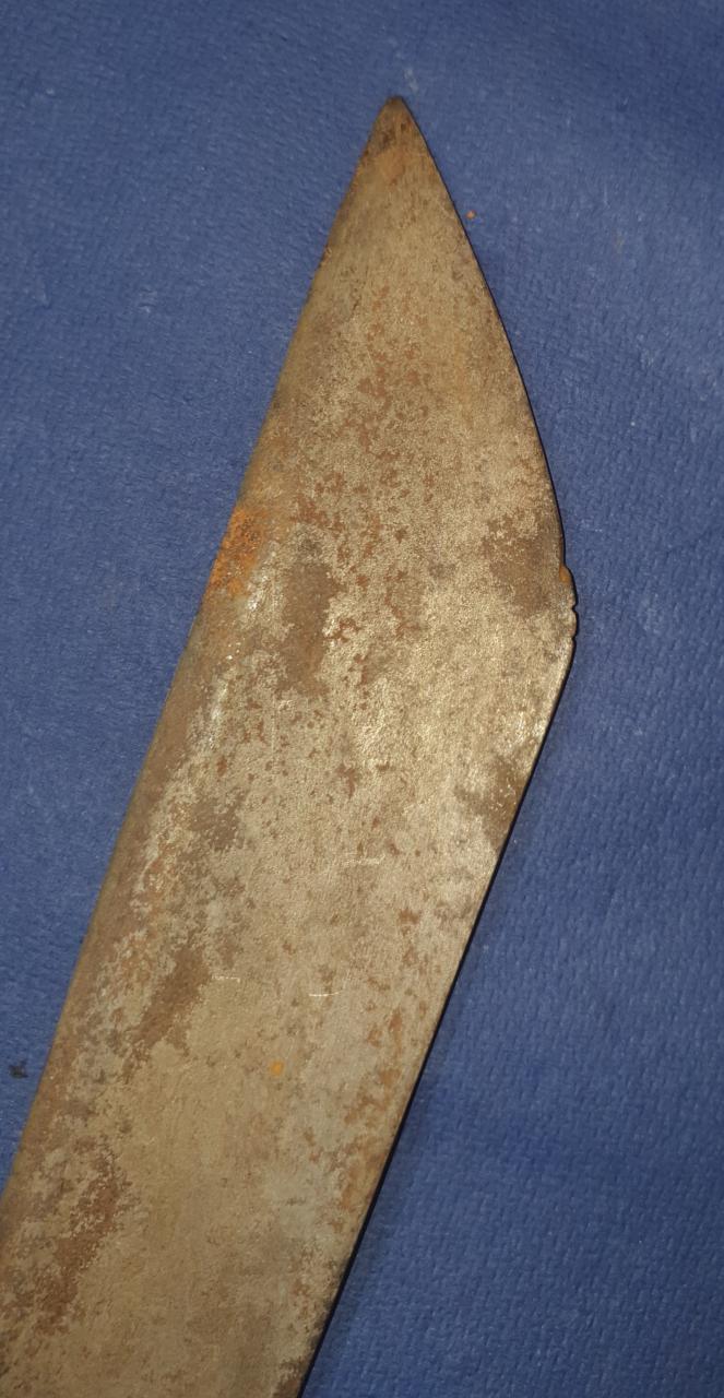

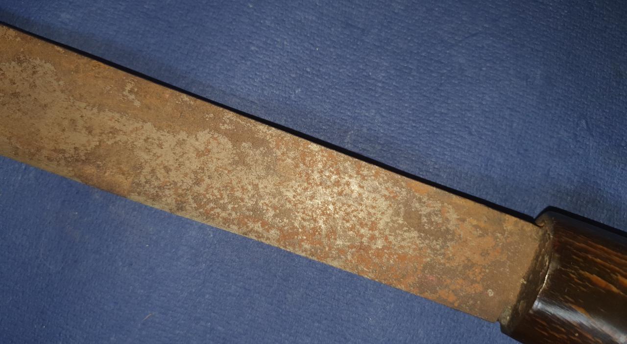

Hello dear members,

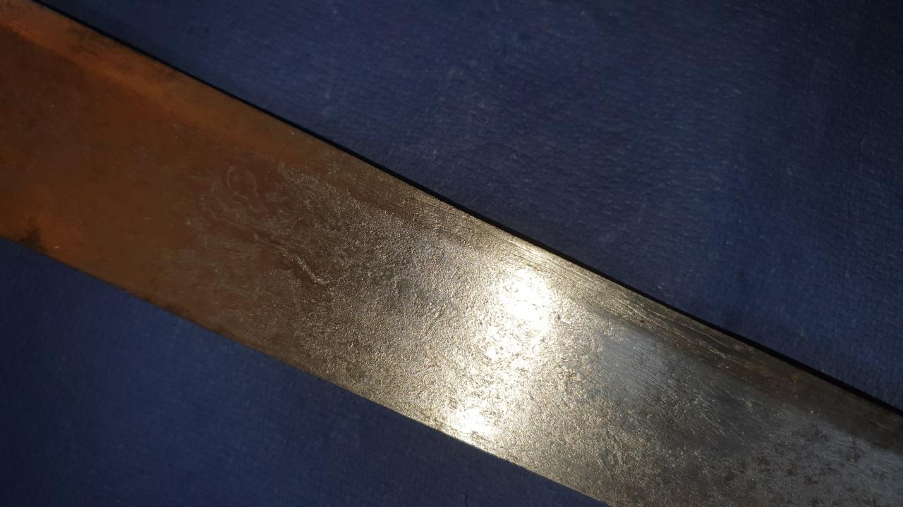

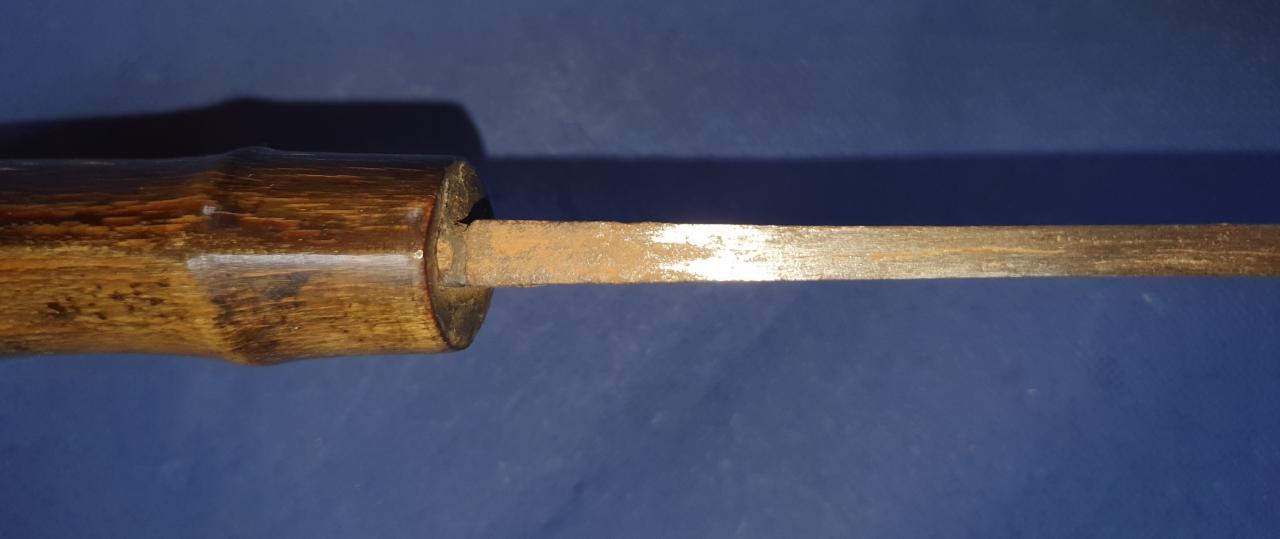

I won a rusted Sulawesi sword (alameng) for low money by a German auction house. It was described as mandau! I've decided to let you see my restoration, first step has been to give some linseed oil to the nice horn hilt.

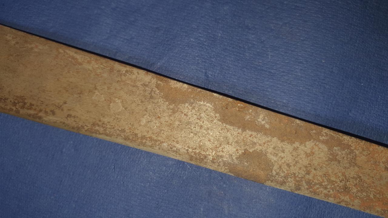

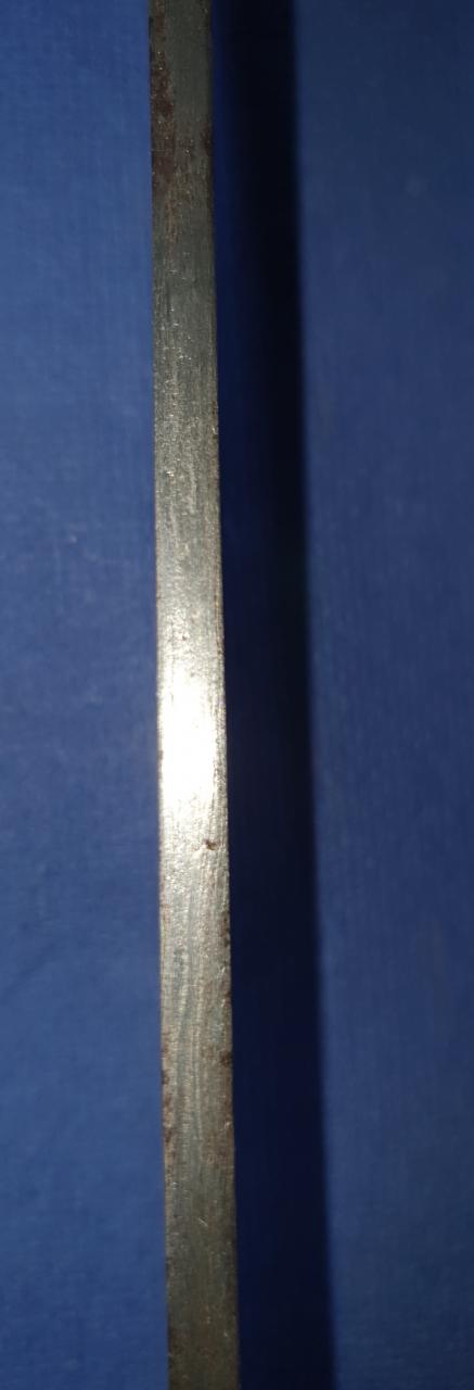

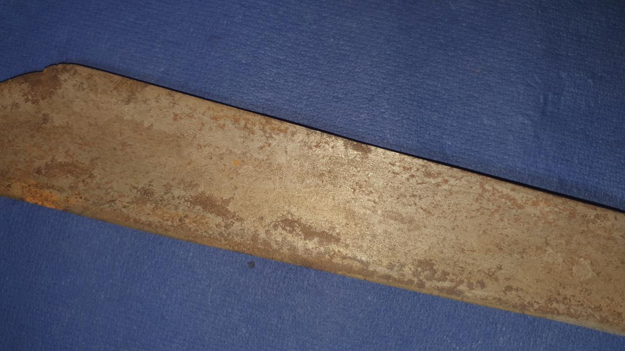

The blade was/is badly rusted, the first step will be to de-rust it, one side I have nearly finished. When the blade is rust free I will work further at the blade to let it look nice again but it will take time so this thread will continue.
The alameng is 60 cm long, the blade is 44 cm and 8 mm thick at the spine behind the handle and quite heavy with 621 gram.
The blade is ground slightly hollow on both sides and has a "V" shaped cutting edge.

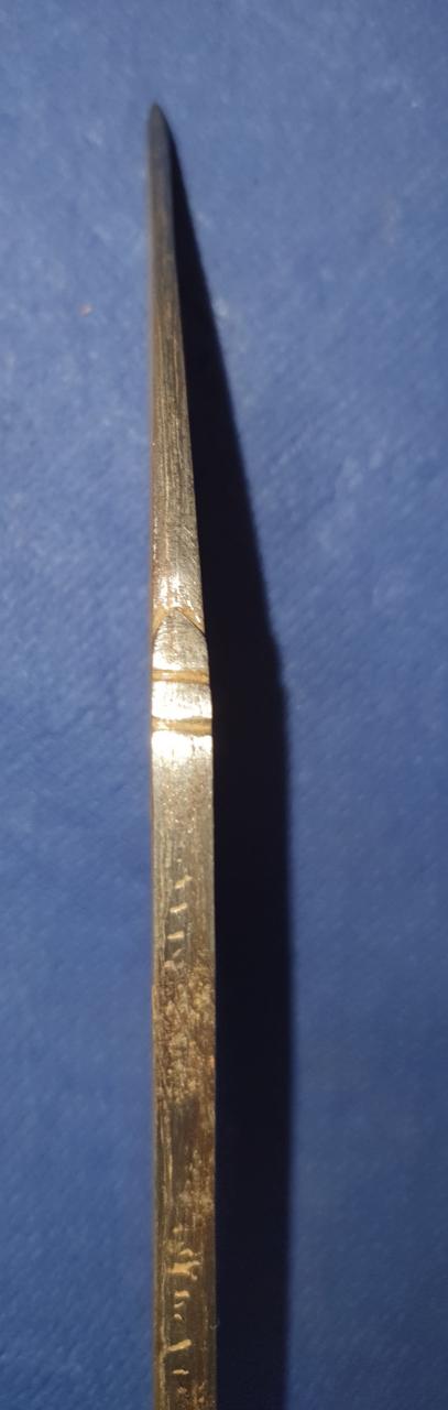

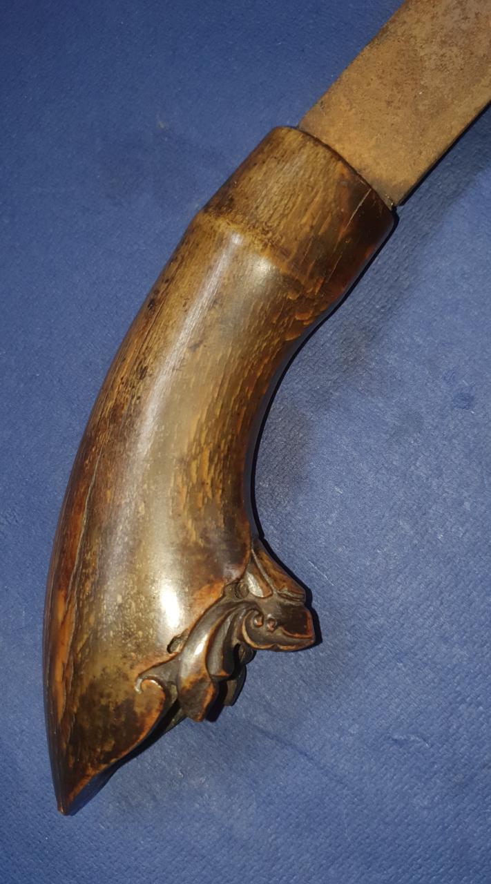

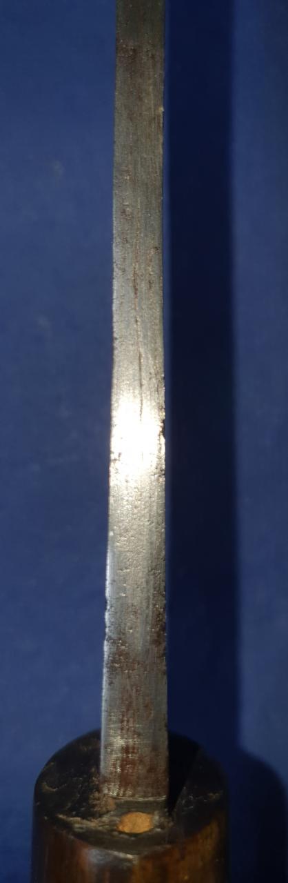

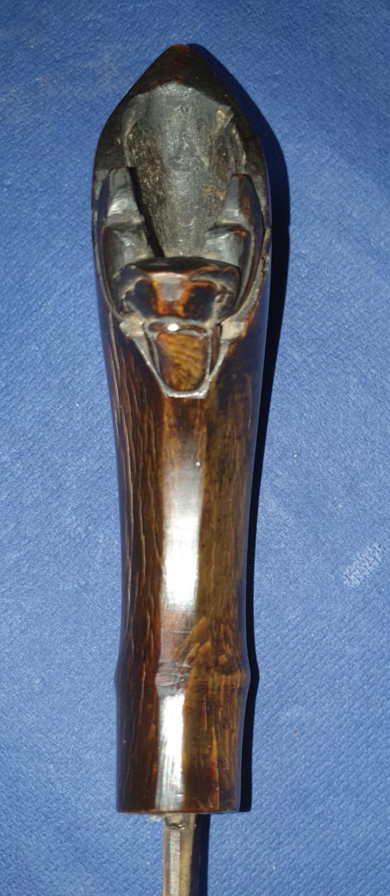

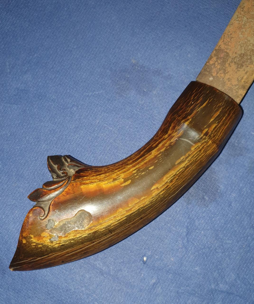

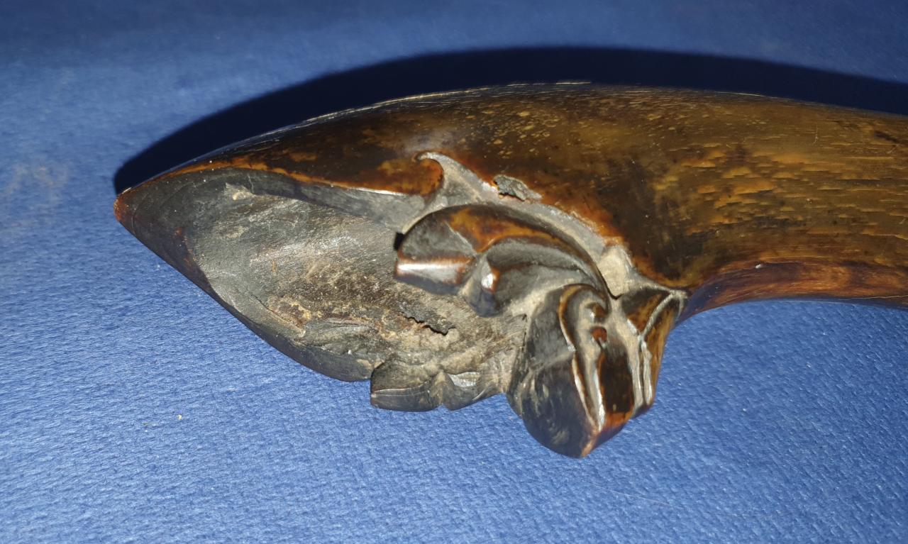

Old 15th December 2024, 10:01 AM   #2

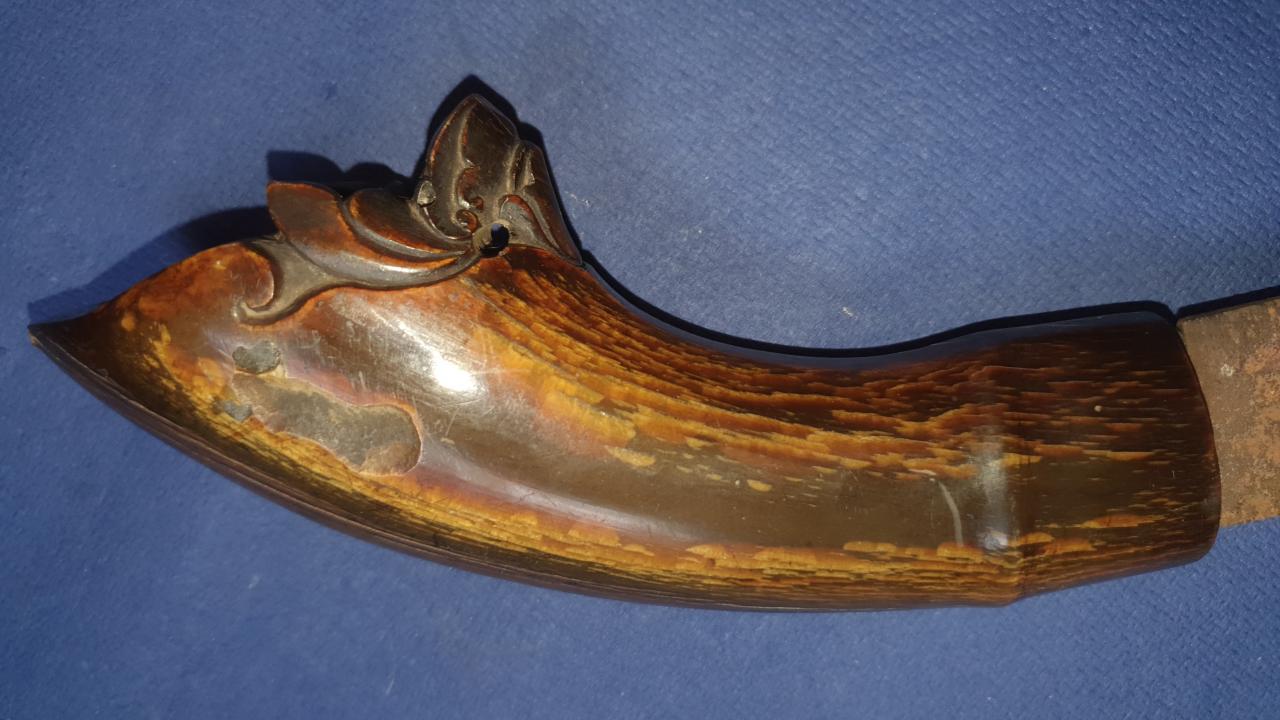

Default the handle
Pics from the handle.

Excellent - great to see restoration process. Interesting piece, I have not seen thst style of hilt. What was your method for removing rust from the first side?

Hi Detlef,
looks good the de-rusting, the linseed oil you used was it boiled or cold pressed oil? And did you soak the handle or used a rag to apply the oil?
I am curious if you used a wire wheel for derusting or only waterproof sandpaper?

Hi Jeff and Martin,
Thank you both! For the cleaning of the blade I used a rust rubber gum and at places where it was hard and encrusted rust I used a stone. No power tools involved!
I have used cold pressed linseed oil for years for wood, horn and other natural materials.
Congrats on your recent acquisition. It’s coming out very nice.
Thanks for sharing your restoration methods. For us that don’t know, could you please tell us what a “rust rubber gum” is? I like to other rust removal items other than sand paper.
Old 15th December 2024, 04:52 PM   #7
Thanks Albert! Attached is a pic of such a rust rubber gum, I buy them on Amazon. They work well by surface rust and a little bit deeper rust.
I think you'll get the same effect as when using steel wool 0000?
(That's what I usually use)

No, it's better and much faster!

Am I just not patient enough with 0000 (or 000) wool? I find it almost never removes anything but the most superficial rust, but I'm not sure if I give it enough time. Am I supposed to keep going even if I feel like I have not made noticeable progress after a few minutes? Also, I'm curious on the type of stone and method you (Detlef) use for deep rust pockets. If soft enough I will use a metal pick but often find rust crusts to be extremely hard and need abrasive anf/or repeated acid washes (vinegar) to remove.

Yes, only for superficial rust ofcourse. And I use it combined with oil. Works perfect for me. If the blade has more rust than superficial rust, steel wool 0000 will not work anymore at some point.

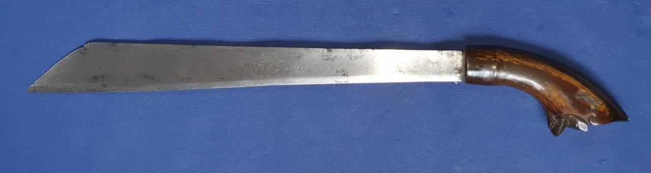

Old 26th December 2024, 11:20 AM   #13

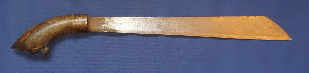

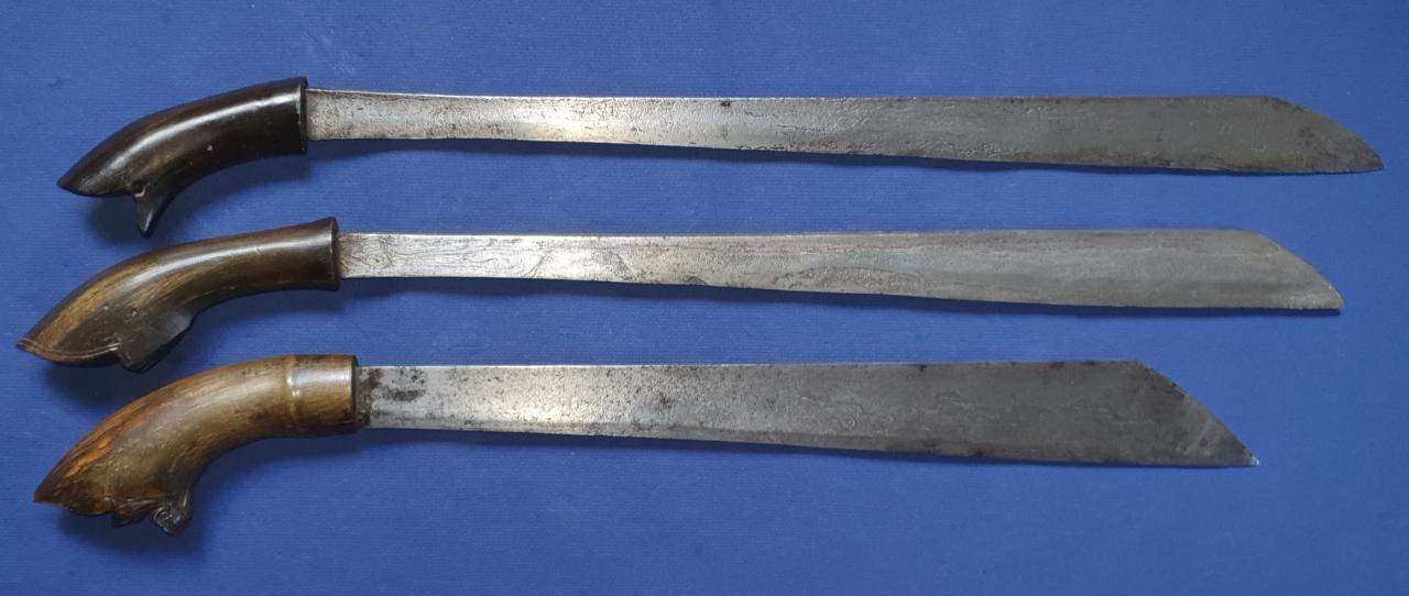

It's cleaned now, here are some pictures. The last two pics show it together with two other similar Sulawesi swords from my collection.

Originally Posted by Maurice View Post
That's a cool Celebes grouping you've got their Detlef!

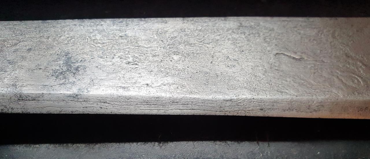

Thanks Maurice! The "new" one is a very massive chopper with heavy lamination. I've rubbed the blade with lemon juice but it needs a stronger etchant to show it better. Here a pic without flash to get an impression.
Thank you for the photo which shows the lamination of your alameng. Celebes had imo top blacksmiths!

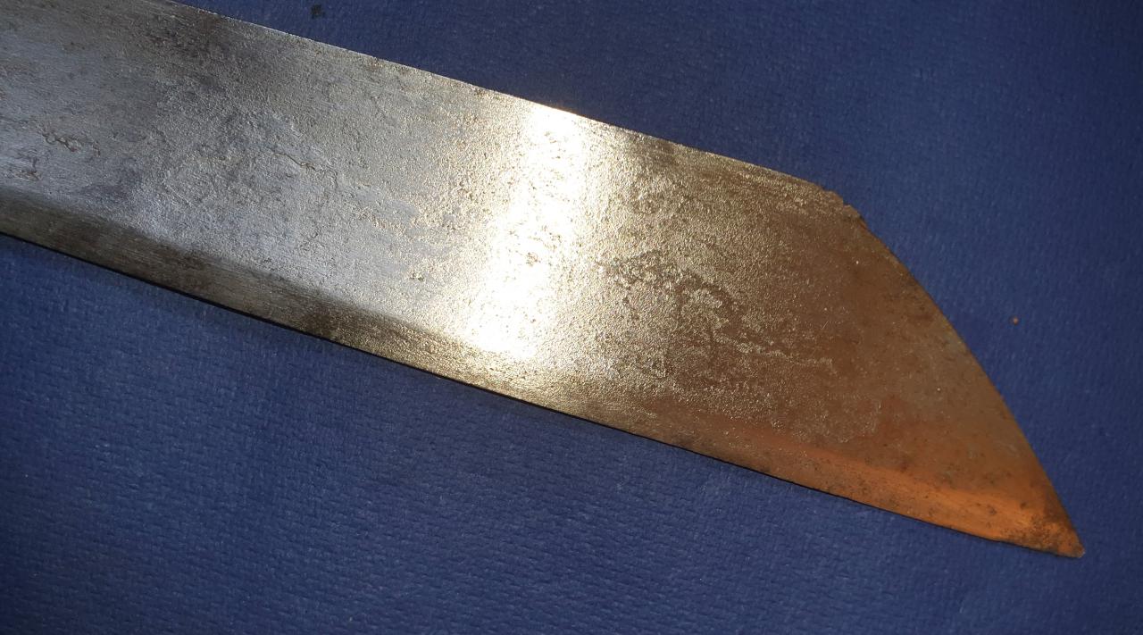

Another short alameng entered the collection with another handle form. One side of the blade is cleaned from surface rust, when the other side is also cleaned I will post a new group picture. The blade was badly bent but I was able to straighten it again perfectly.
48 cm long with a blade from 38 cm.

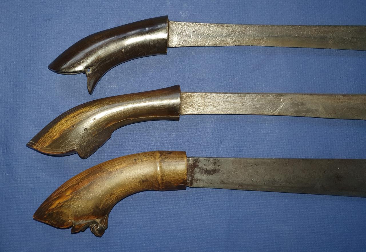

Here a new group picture, also a close up from the handles. Three blades show a talismanic pamor at the base.
Very nice Detlef!
I've seen most of these kind of Sulawesi blades with this pamor at the base near the hilt.
Hi Maurice,
Thank you! And yes, these talismanic pamors at the base of Sulawesi blades seems to be a common feature so far I know.
