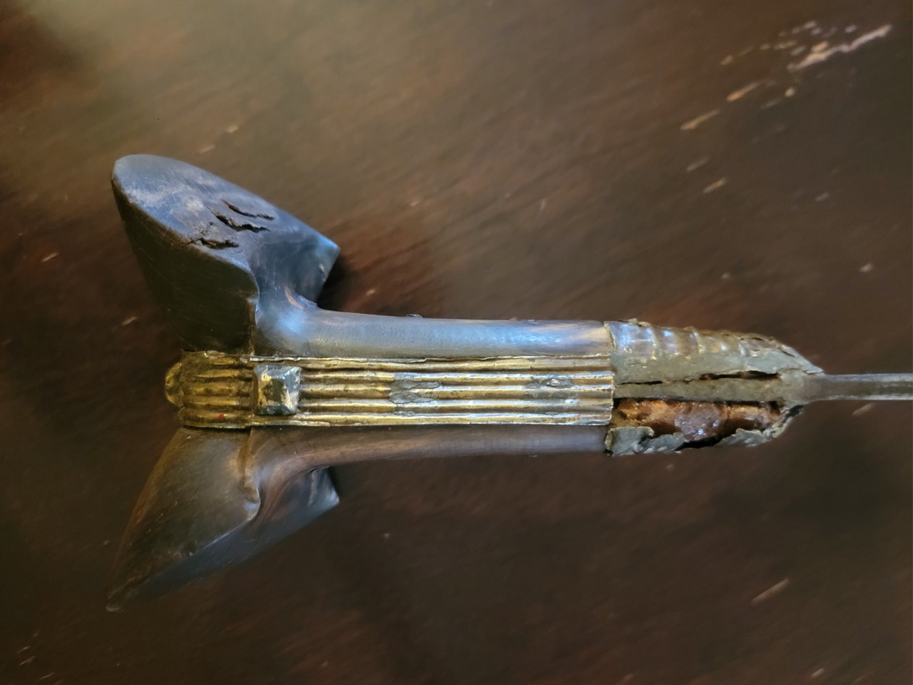

I recently acquired this, my second Yataghan. It's a little beat up, but I'm still happy with it, especially give the price.

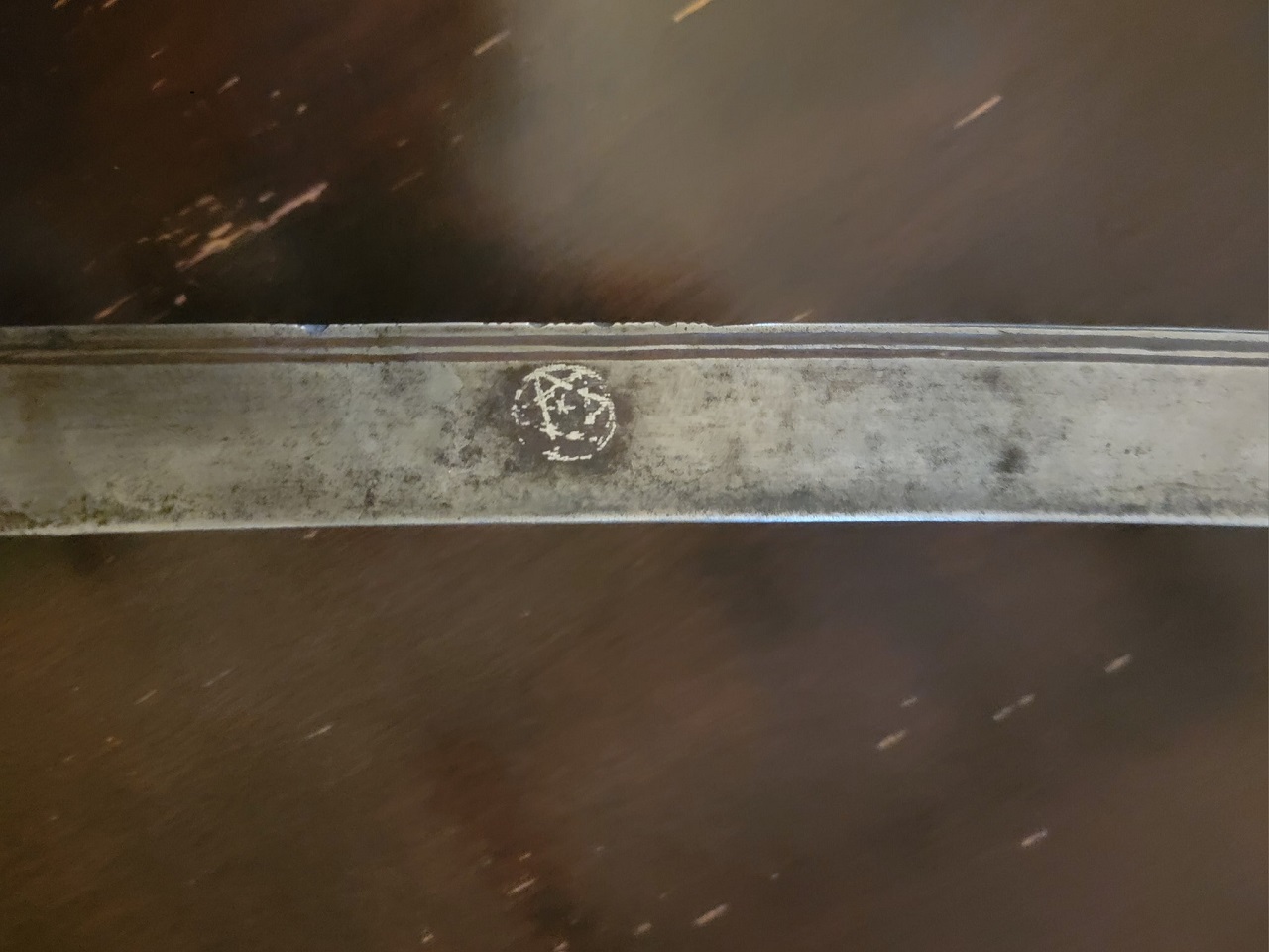

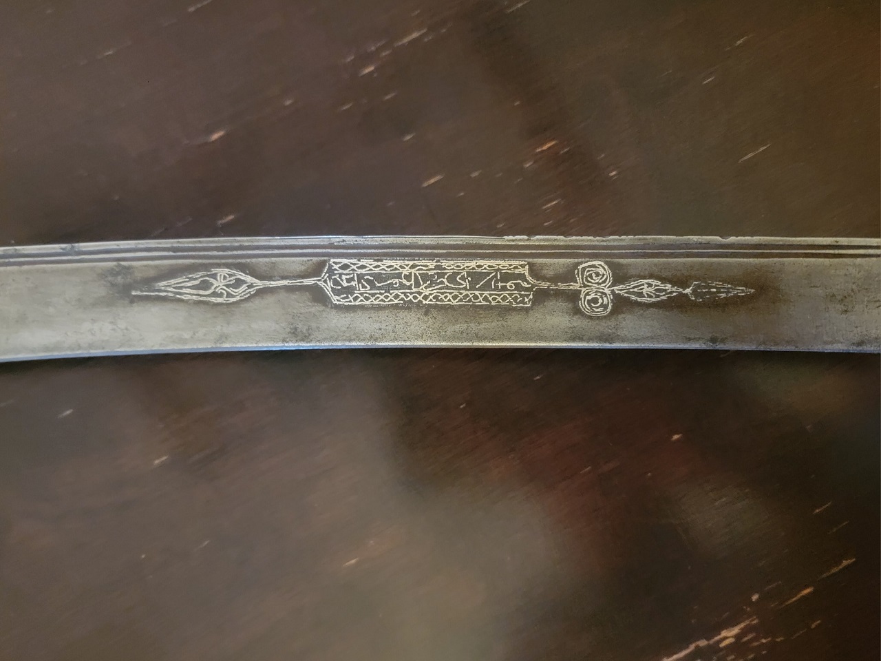

My other Yataghan, previously posted to the forum, has a gibberish (Arab-ish?) inscription on it, which I understand, is not uncommon on 19th century Balkan yataghans. I'm wondering if the inscription here this is the same?
Any opinions?

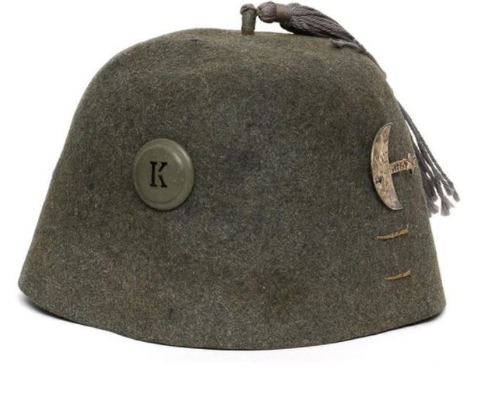

And also a bit of a family photo, staged with a couple other things from (*or inspired by) my recent trip to Sarajevo.

could you specify "gibberish" or why you come to call it "gibberish"?
Also in order to determine anything, the sizes / dimensions of the yathagan might be helpfull....

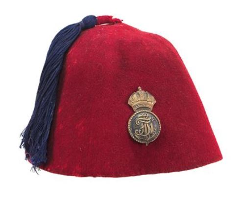

FYI: the Fez shown on the pictue might either be from :
1. the Bosniaken K.u.K Infantery Regiments I to IV
https://en.wikipedia.org/wiki/Bosnia...inian_Infantry
or
2. the 13. or 21. Waffen-Gebirgs-Division of the SS Handschar
https://en.wikipedia.org/wiki/13th_W..._(1st_Croatian)
https://en.wikipedia.org/wiki/21st_W..._SS_Skanderbeg

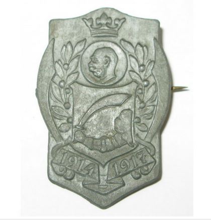

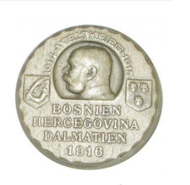

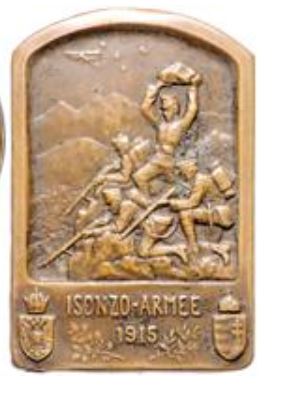

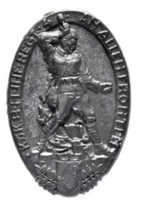

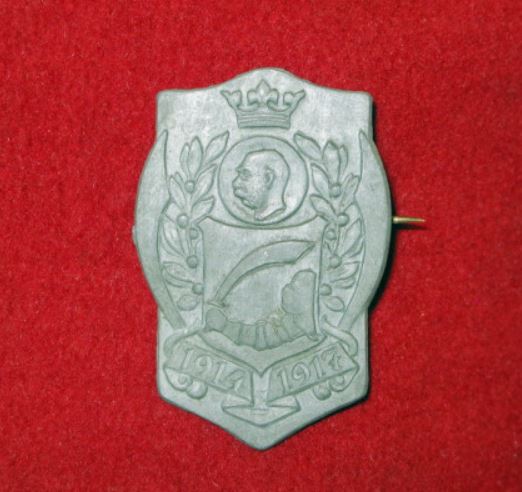

or (what is recently often seen) a recent copy made for either historical enactment or fake copies of the original ones
an indication might be the pet-badge or holes in the Fez where these badges used to be ( enclosed some pics of the K.u.K. Habsburgian ones)
My first Yataghan (http://www.vikingsword.com/vb/showthread.php?t=28326) has an "inscription" on it where it seems the engraver "used their fantasy and just did write something or nonsensicle." Probably added to to "fancy up" the weapon. I'm wondering if this is something similar, rather than actual meaningful writting.
The yataghan is 28.5 inches long overall, with the blade being 24 inches.

It is absolutely modern. I bought it from a vender in Baščaršija in August. It's just there for fun. :-)

Concerning the scripture: in the Ottoman times of the Balkan, the writing was mostly Turkish but in Arab scripture.
One small difference or addition: in former Yugoslavia, specially Bosnia, they had , used their own language…also in Arabic lettering.
I have placed somewhere an overviewof that alfabet in Bosnian Arabic scripture and will look it up and ad it here again.
That might often be the cause for (mis)understanding it as “ gibberish” if one looks or reads it with either Turkish or Arabic language skills.
A second “challenge”, rather less occurring, might be an illiterate or person with limited written knowledge (a villager or so) trying to do his best…
But this one is the real McCoy! Although it looks a little rude, the writing is in a beautiful condition and also the length of 28.5 and the grip specially is also proof you have a real one
you can compare it to the writing on some of mine :
http://www.vikingsword.com/vb/showpo...02&postcount=6
Try to rubb some gum / rubber eraser over the writting: it will bring it back to some more beauty!

found it, Bosnian in Arab scripture: see # 10
http://www.vikingsword.com/vb/showth...ure#post287035
and also here
http://www.vikingsword.com/vb/showth...har#post270932
some more to read ( is legal to be downloaded ) : https://www.researchgate.net/publica...e_Banat_Museum
