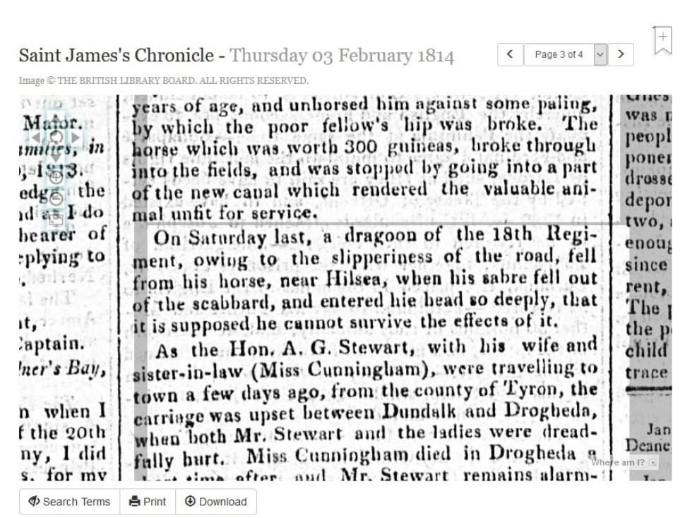

The man falling from his horse, actually an 18th LD, using an LCS:
Triarii is offline   Reply With Quote

From "The trial of Major William Gordon of the 2nd DG, for the murder of George Gregory (on 25 March 1814 at the 'Vill of Ramsgate'), a private in the same regiment, at the Guildhall, Sandwich on April 15, 1814, as taken by a short-hand writer".
A summary:
Major Gordon was on foot for the altercation with a mounted trooper who was alleged to be drunk, he drew the troopers own sword, hit the horse with the flat and then according to witnesses, 'gave the point at the man' (this phrase is repeated in the testimony and questioning) and according to the charge inflicted a wound in Gregory's left side one inch wide and six inches deep, 'near the last rib'. (The doctor testifies that the wound was 14 inches deep).
Some describe the troopers horse as 'linging' (dropping) and turning towards the major who already had the sword pointed and were surprised that it did much damage. Others, notably the Rutland Militia soldiers present, disagreed about the horse moving, though the Q&A indicates some animosity towards the DG officer.
Interestingly, the Corporal with Gregory didn't have his sword with him as 'it was at headquarters [of the regiment in Deal] to be ground'.
They then discuss that the troopers sword - handed to another officer in the court - was "much sharper than cavalry swords usually are" because it had "been ground for foreign service" the day before. "They are not allowed to be sharp, excepting on particular occasions."
The key point is that the jury are directed to examine the troopers sword and told "The Gentlemen of the jury will observe that one sword is sharpened along the edge as well as at the point." and "having not only been sharpened, considerably reduced at the point."
He was found guilty of manslaughter and fined £50.

With the other most bizarre incident, the 18th 'Kings Irish" light dragoons were using of course the 1796 light cavalry saber. While the trooper who was severely injured by the sword by falling on it as he fell off the horse has nothing to do with the modifying of points on the 1796 heavy cavalry sword, it is an interesting anomaly of an accident. How would the trooper fall on the sword, which 'fell out of its scabbard' presumably in the same action of falling off a slipping horse?
He must have gone off and headed down head first, with the sword coming out in the same movement, thus landing on the ground prior to the contact of the troopers head.

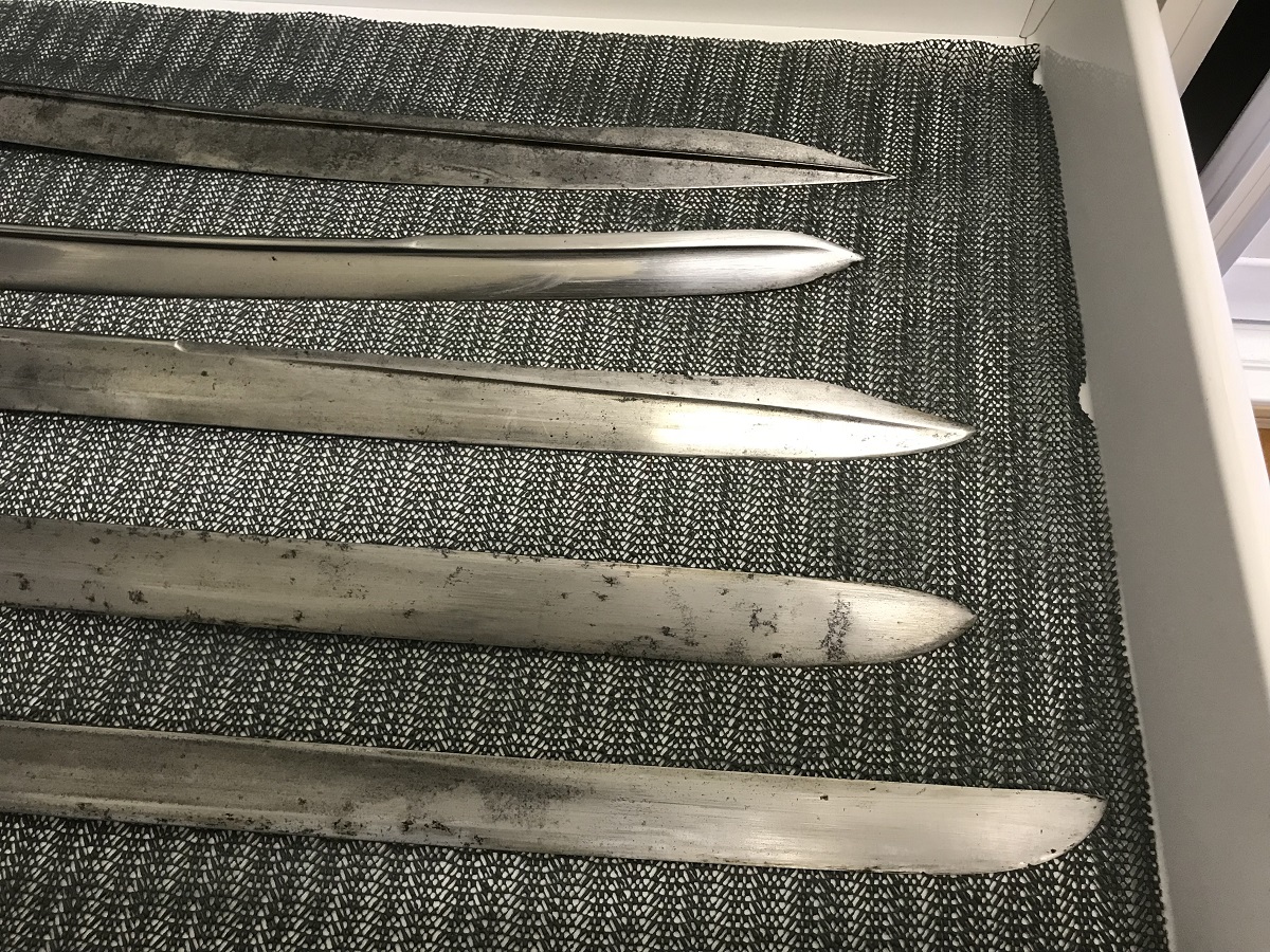

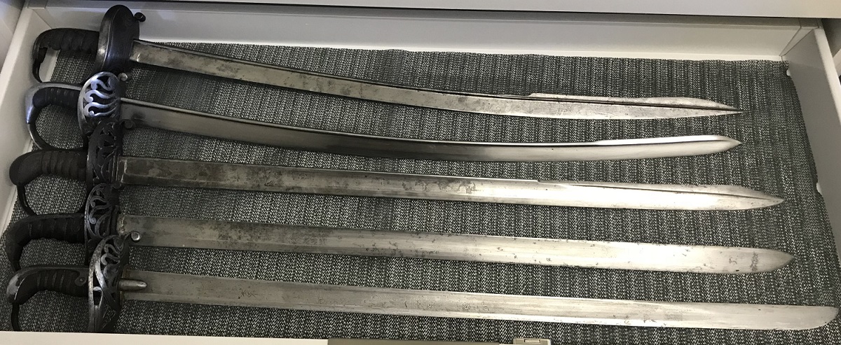

Here is a photo showing a range of blade tips found on 1796 heavy cavalry officer service swords.
From top to bottom:
1. Quill-point
2. Spear-pointed pipe-back
3. Spear-pointed intermediate pipe-back.
4. Modified semi spear-point
5. Original unmodified hatchet point
Cheers,
Bryce
Bryce is offline   Reply With Quote

Bryce - excellent photo. What's not to like about that collection. I always did like the look of the hatchet point. I've read about HCS with spear points where the scabbard length matches, implying that they were made that way. I'm not sure you have to lose much blade length to make a spear point, especially an asymmetric one.
