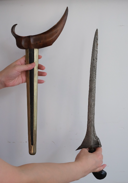

Hi, all

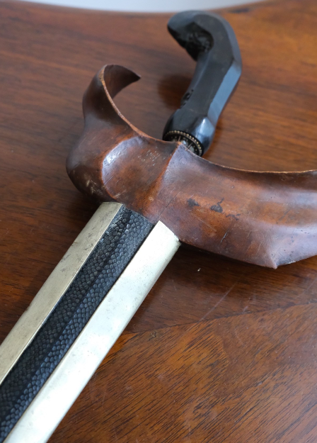

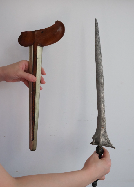

A friend showed me two Javanese Keris. They are alleged to be from 1900s (I don't know if it's ture). Can you identify them?
Why almost every Keris always be alleged to be from 1900s?
Many old Keris seems to be white but doesn't have too much red rust. Is that a valid method to identify old keris?
Another question, it's said in the process of forging, Keris will be folded 500 times. Is that real?
HughChen is offline   Reply With Quote
Old 13th August 2024, 07:21 PM   #2
Posts: 7,303

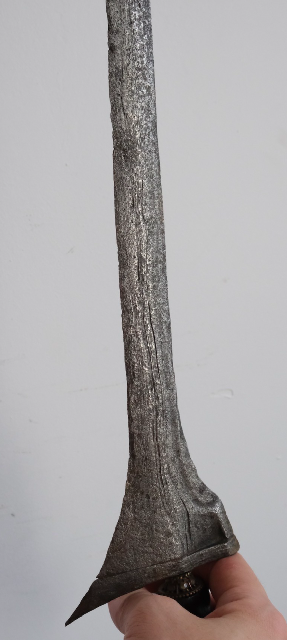

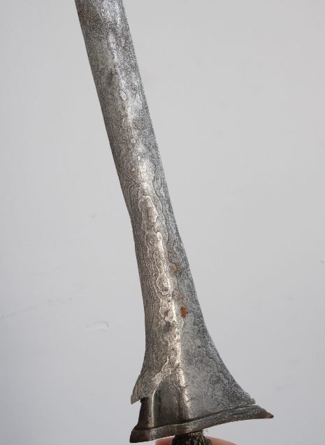

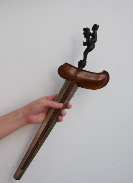

Blades look legitimately old. First one could easily be 19th century. The second blade is possibly older.
That's also a very strange hilt on the second blade. I don't think it was originally intended for a keris.

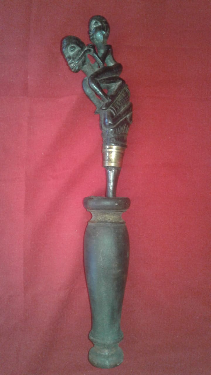

I wonder if the strange hilt might be Batak. I've seen a fair number of Batak carvings depicting figures riding upon each other.
Hi, Rick, Like this

the majority of keris that we encounter can be attributed to the 1800's, ie, 19th century, because there were more people who wore keris in the 19th century than in previous periods, thus more keris were made, & because it is closer to our own time, more have survived.
Old 14th August 2024, 06:09 AM   #8
The hilt is from a betel crusher from Lombok, see here: http://www.vikingsword.com/vb/showth...ighlight=betel
Yup.
That's what I had in mind Sajen.

Hi, Rick, Like this
But it's not Batak work, these hilts are common on Lombok.
