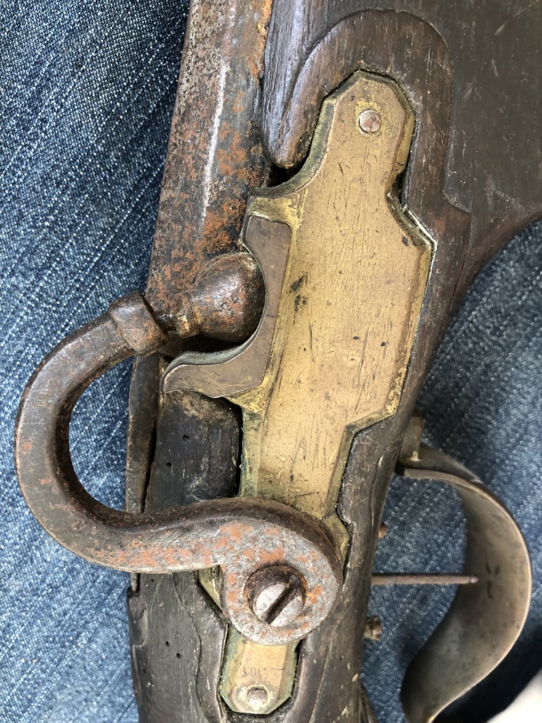

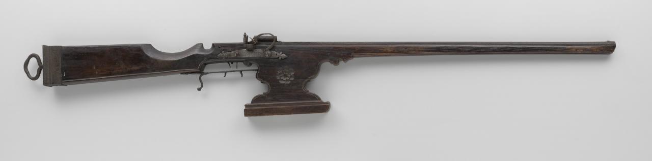

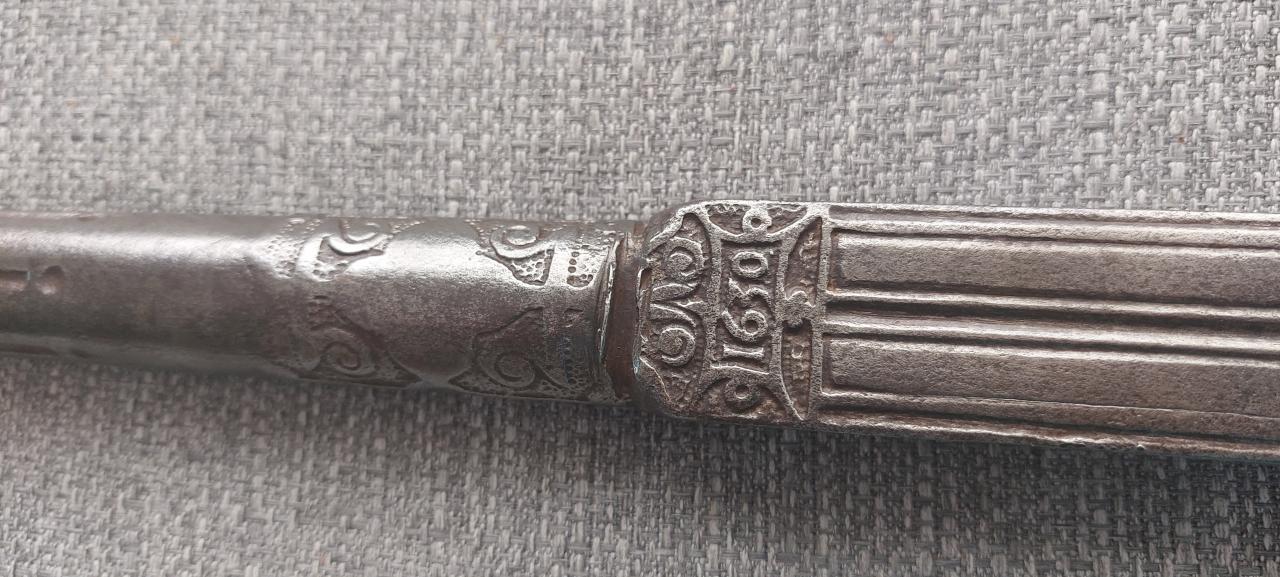

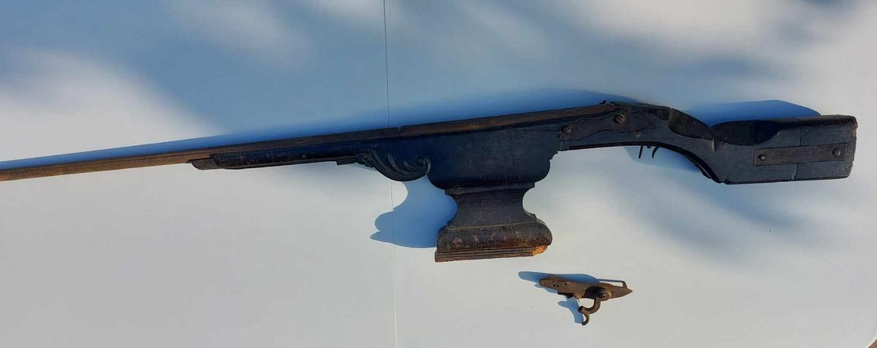

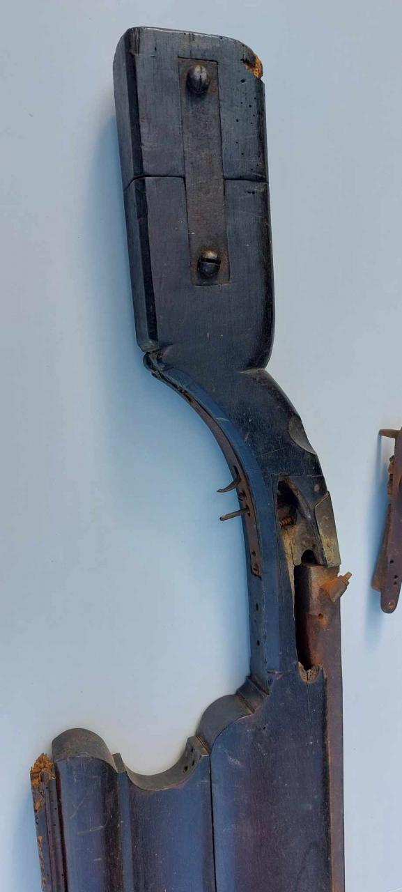

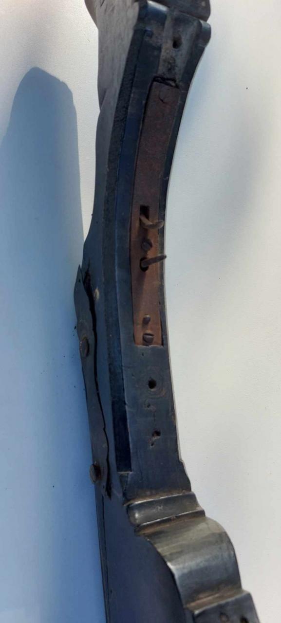

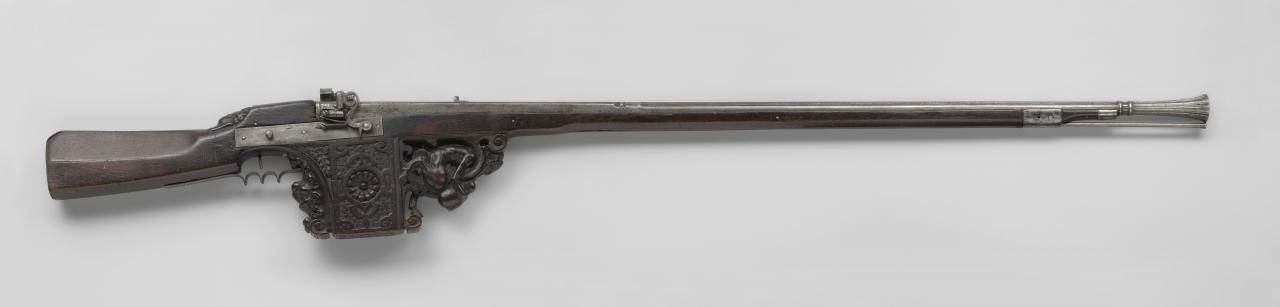

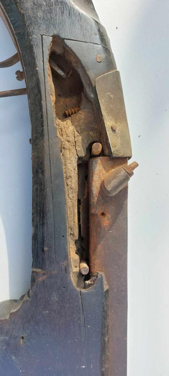

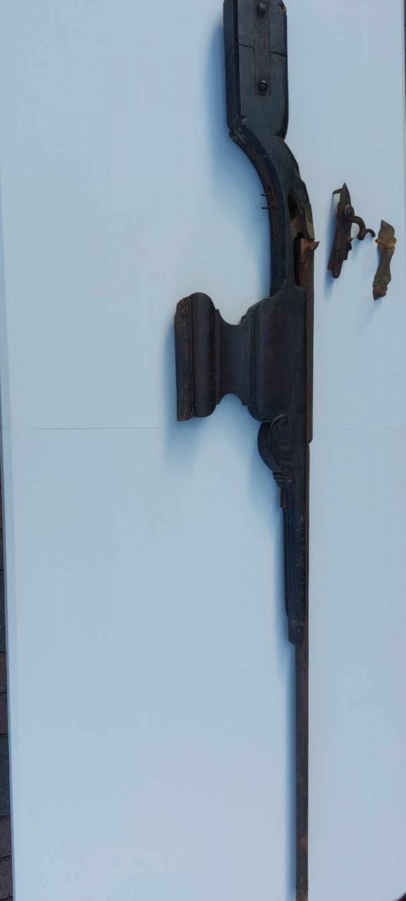

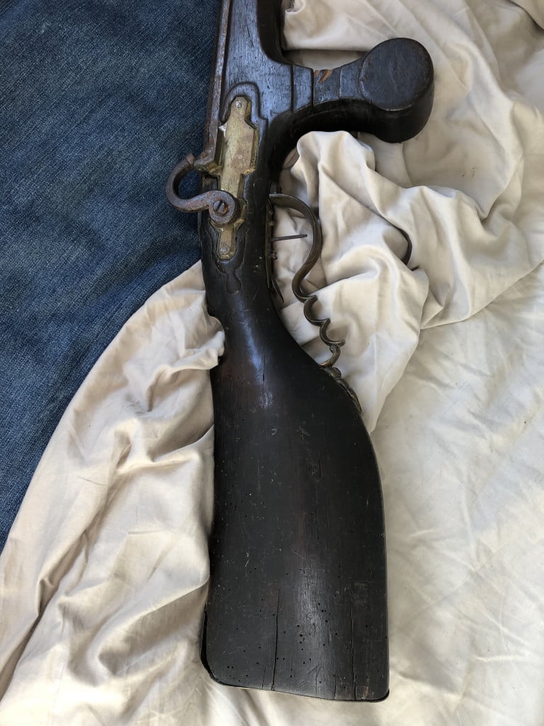

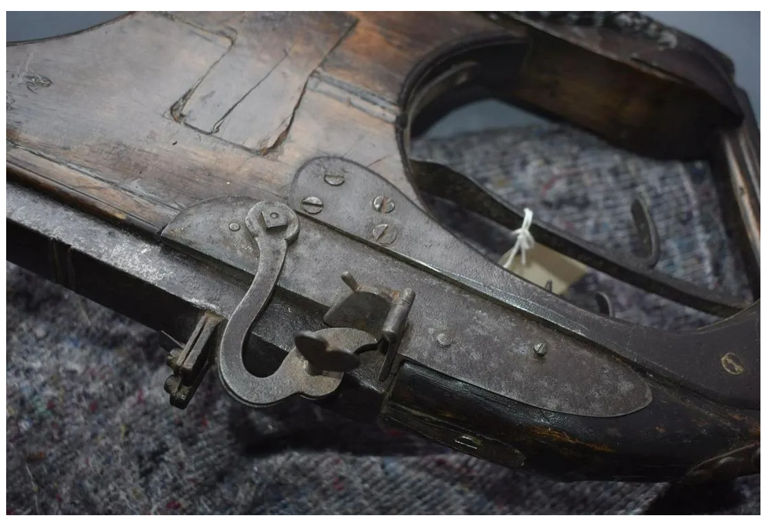

This special "arquebuse" (for a lack of a better term) came to me recently. First the obvious, it is in need of restoration. A delicate proces i intend to do right.
The lack of sources on these guns makes it difficult to be sure how this gun would have looked like complete. Especially the lock is up for debate.
My, somewhat educated, guess is that it would employ a snap match/tinder lock. This would work best, i think, in combination with the set hair trigger action. This is also underlined by earlier work by Michael and Richard: http://www.vikingsword.com/vb/showthread.php?t=7524 post 7 and 8.
The barrel has been altered to percussion action but even though the new addition, there is no evidence to sugest a powder pan integral to the barrel. Which leads me to assume it would have been a powderpan integral to the lock. Of this i have seen some other instances as well with these type of guns.
As to the rest, it has some wood worm damage and cracks. And, something which upsets me without bounds, a damage to the barrel mouth. This was done during transport and was due to a lack of good packaging. Lessons learned, always instruct the people that handle your precious antiques, they seem not to comprehend simple logic... pointy item will want to point through some bubblewrap and a single layer cardboard box.. end rant, sorry.
The rest of the gun has to speak for itself as i did little to no investigation on its marvelous decorations and design, yet.
My question to all who might find these guns interesting too is: Do you have pictures or information on any of such Dutch target guns. Lock type (in and outside), trigger guard design and sights are most precious to me, but any information is welcome. I will of course update on the progress, which might be slow.

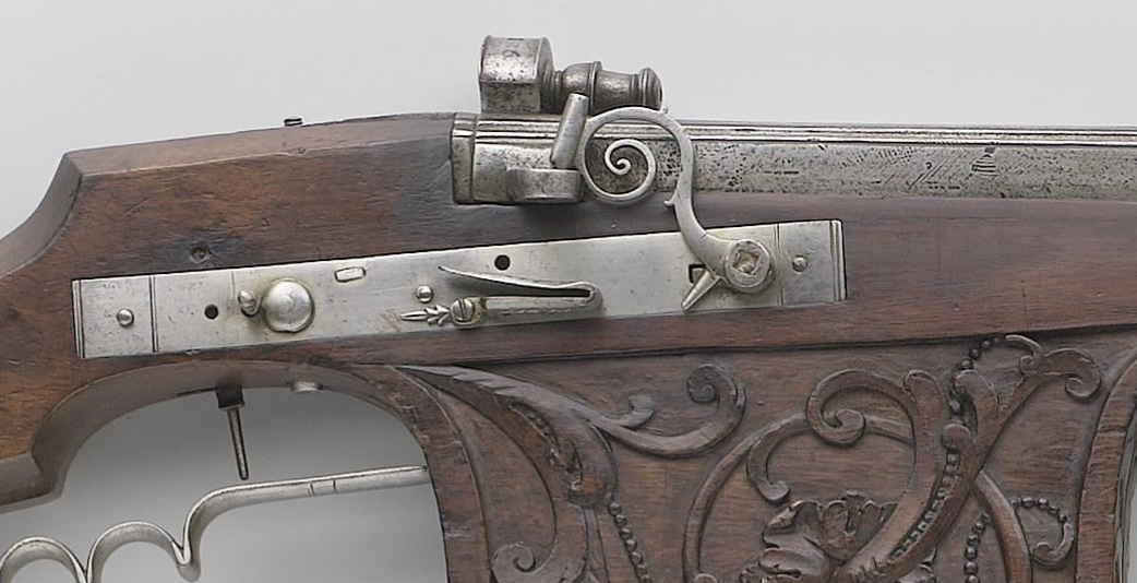

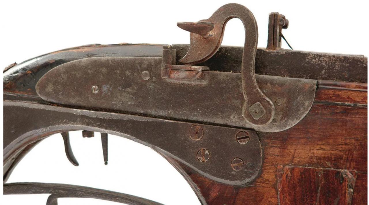

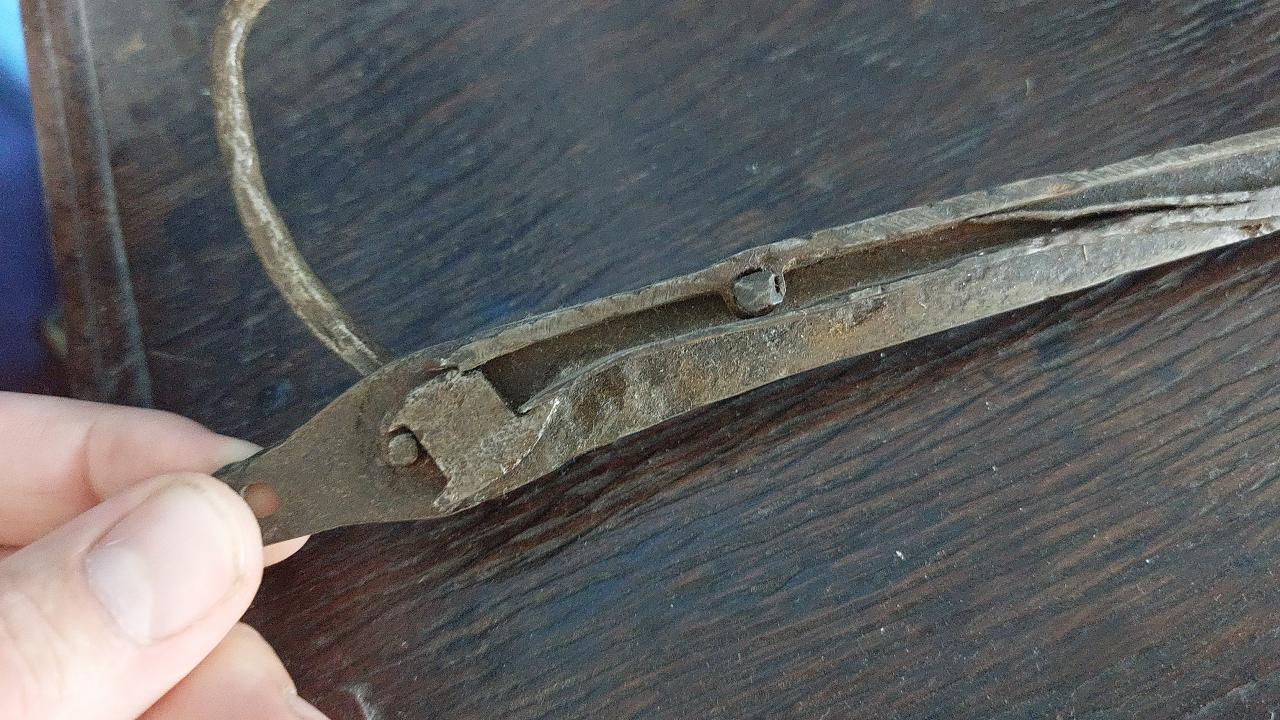

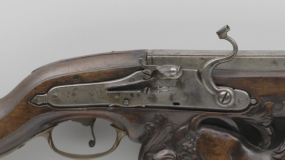

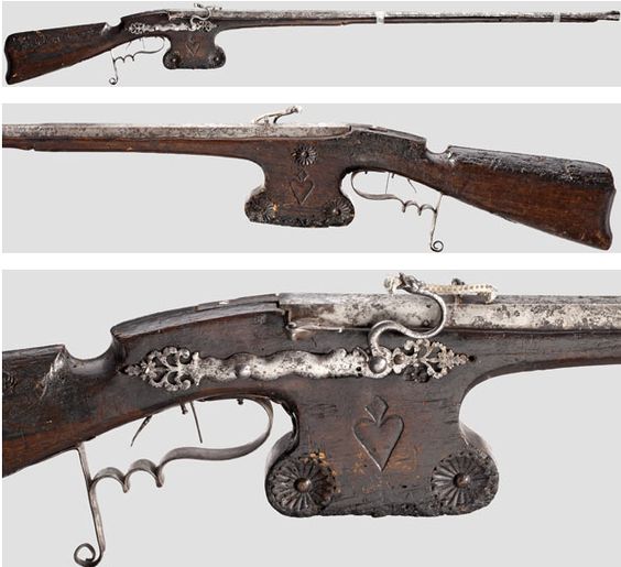

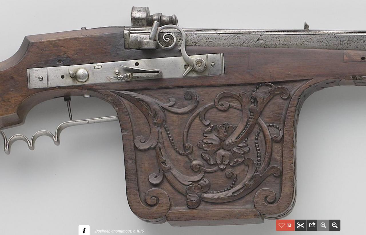

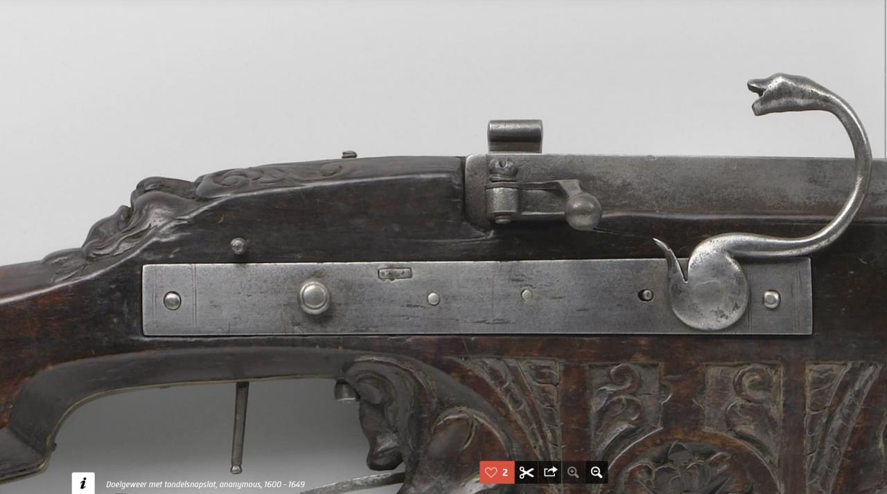

A lock like this could make a good candidate, it dates from around the same time.
Many thanks to Richard for this image (found somewhere else )

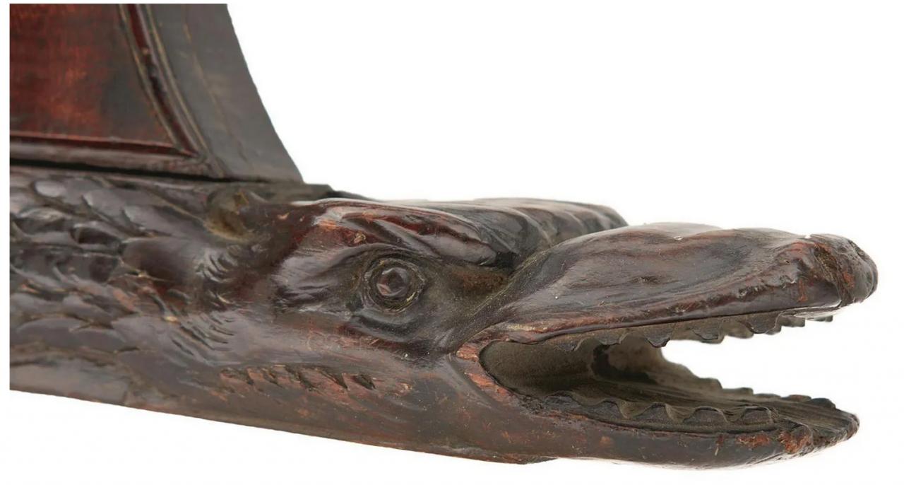

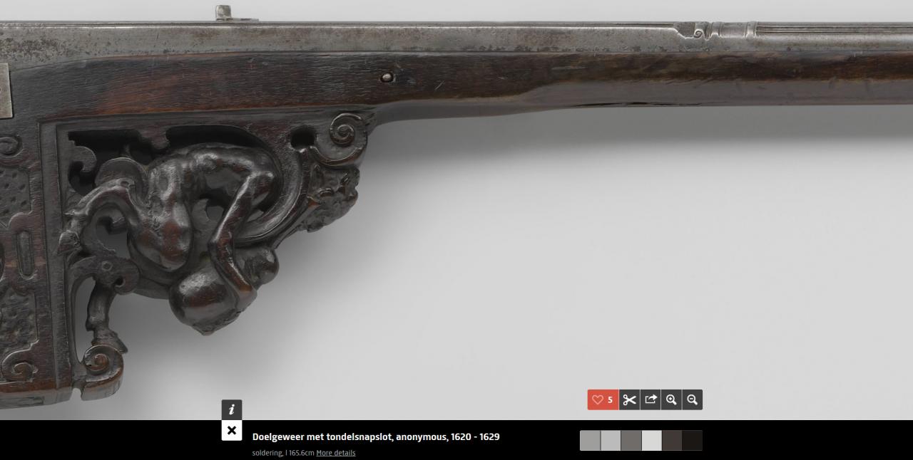

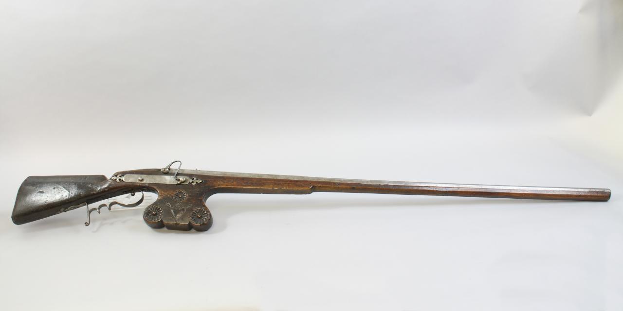

Sold at auction, lock with integral powder pan. Somewhat excentric looking.. must be Dutch

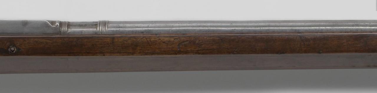

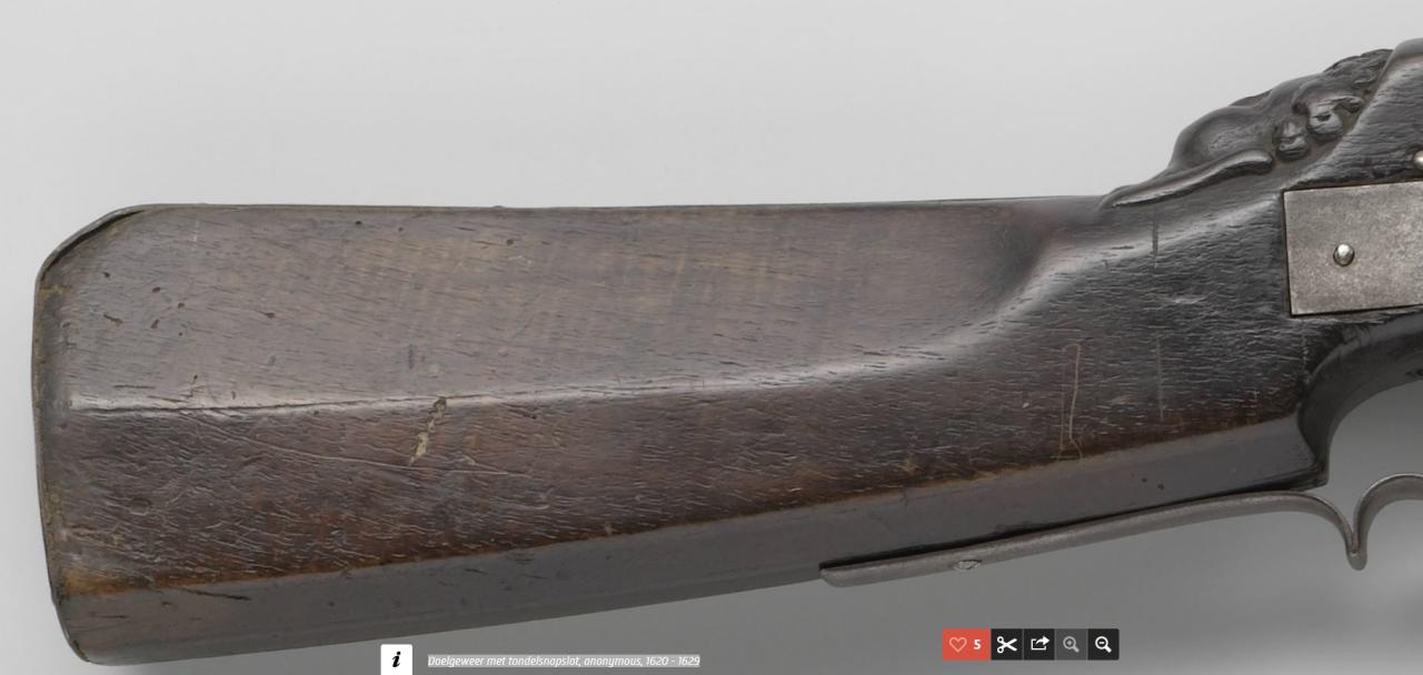

Its a fascinating thing Marcus but I wouldn’t personally relish the responsibility of deciding what to do with it. Although I sympathise with the desire to see it as a converted snap matchlock this needs thought . Although the stock looks convincingly early I would need to convince myself that this wasn’t a nineteenth century re use of an earlier venerable barrel in which case the percussion lock and stock might be contemporary. The worry is why would anybody go to the trouble of fitting a new percussion lock to a matchlock target gun? Hopefully their is some good evidence that this is not the case.
Since their is no indication of the flash pan being dovetailed into the barrel we have to accept that if it was a matchlock it would be the later style of lock with the flash pan as part of the lock plate following emerging dog lock / flintlock form . I also doubt whether there is sufficient space within the lock rebate to fit an earlier style of matchlock without a lot of new cutting and patching of the woodwork which I think would be unacceptable. A responsible compromise might be to remove the percussion bolster , plug touchhole and make up a new matchlock with a lock profile matching the existing rebate . Basically similar to the reference example you post. The percussion lock can be archived as part of its history and the restoration is potentially reversible. I am at a lost explain what appears to be a detachable extension to the but . The extension itself appears to have been cut down . The reference example you post has the same feature but the extension is much longer and appears to end in a spike. Further research might show the purpose of this.
On the subject of conservation in my experience this degree of woodworm is terminal. Only a paper thin layer of solid wood remains on the surface of the stock and given the weight of the barrel any rough handling could cause the stock to break. Soaking in cellulose wood hardener can help but it won’t add much to restoring the integrity of the wood. I think I would want to consult with a museum conservation specialist to see if their were any better modern solutions.

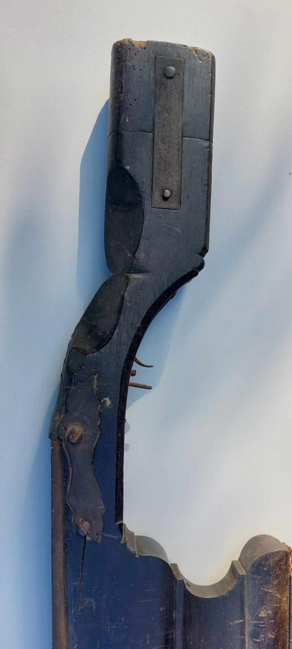

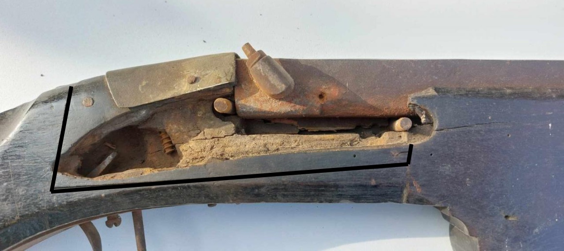

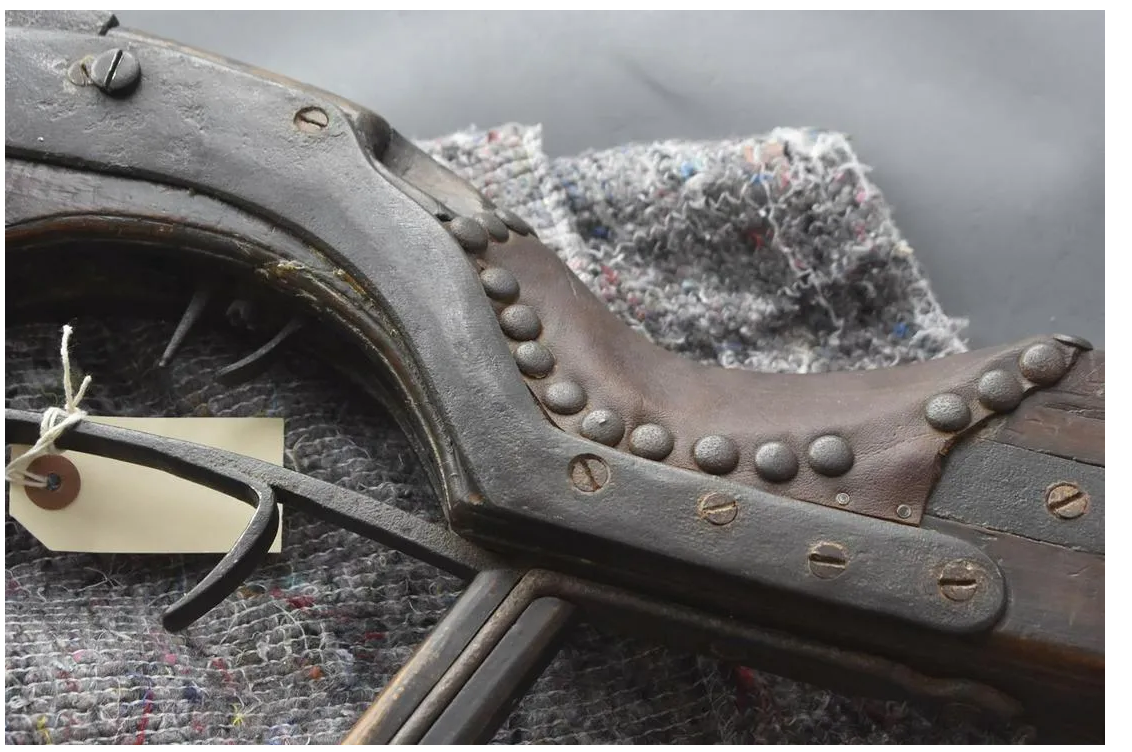

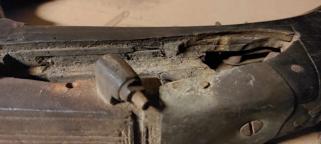

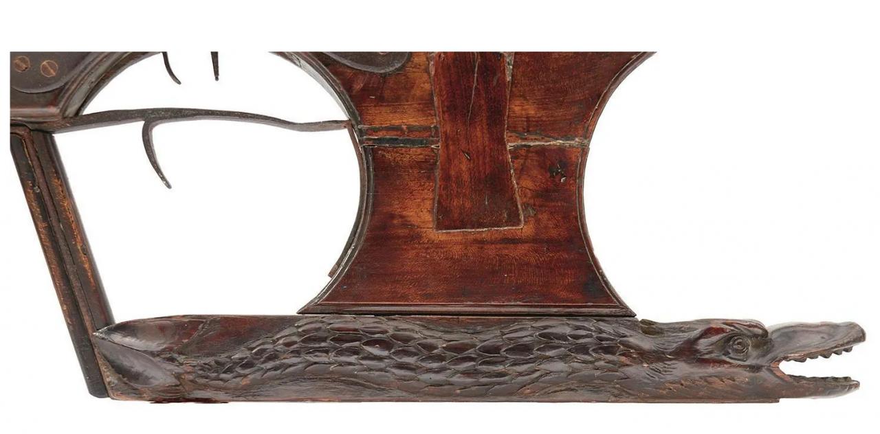

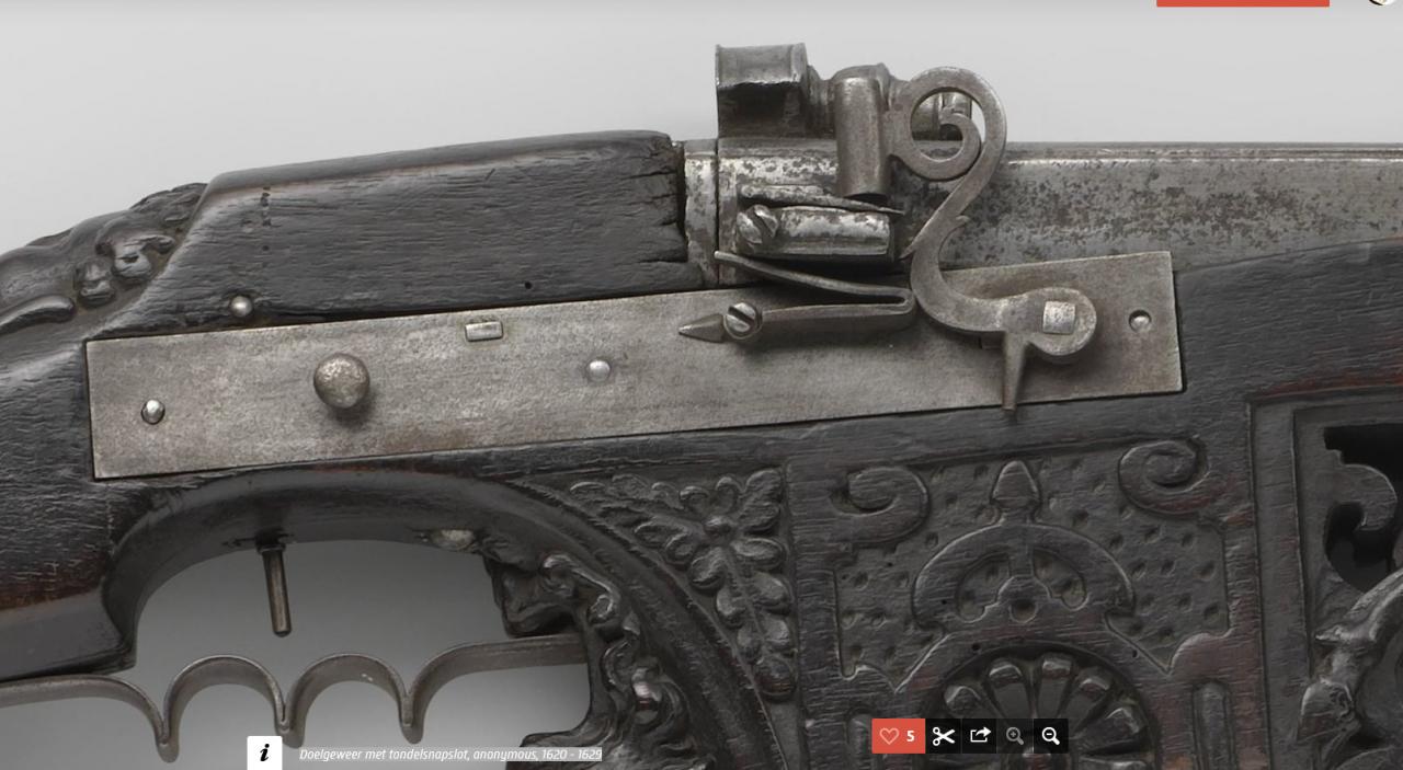

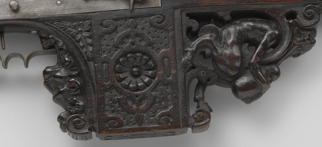

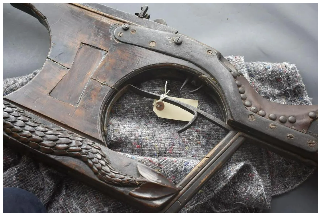

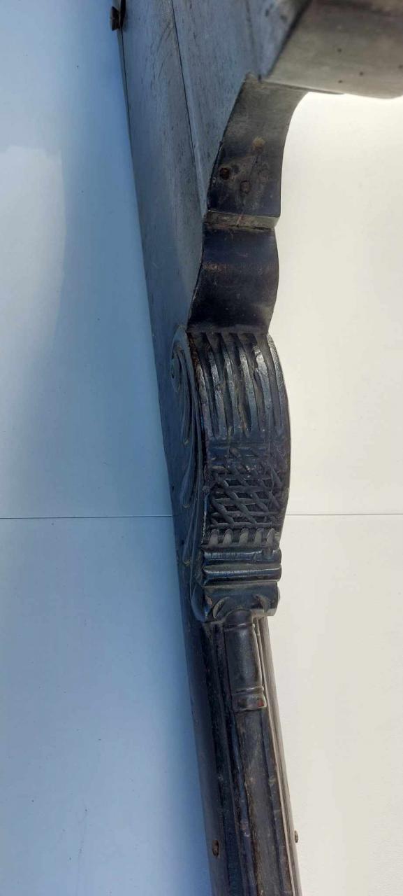

Might the area inside the line on this detail be a later patch ? This might indicate the approximate shape of the original lock which would justify the matchlock re conversion.

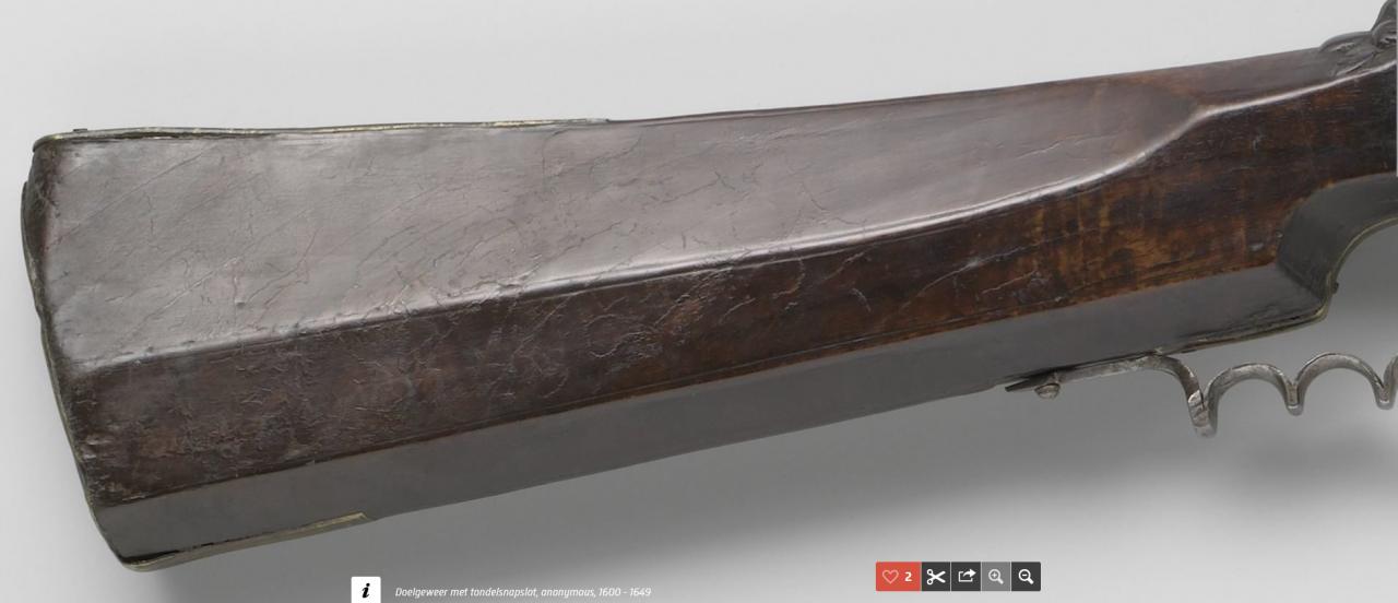

Very astute observation and thank you for pitching in. Indeed this piece of wood has been added later into what appears to be a rectangular shape. Attached two pictures from the inside were the same line can be seen. The only odd thing is that the cut seems to go up all the way towards the tang of the barrel. This piece is now obscured by a thin sheet of brass.
As to the age of the stock it is good to keep all options open. The shape of the stock does correspond with the few examples i know of from other Dutch target guns from the early to mid 17th century. It is quite an odd ball for any other later musket.

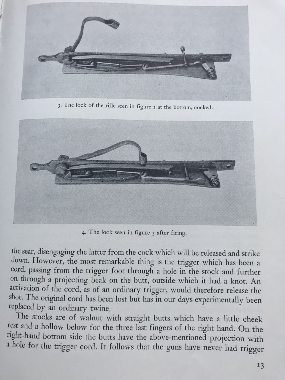

The other gun i posted does have a metal bar at the butstock, for whatever reason (see picture). Why these stocks are made in two parts eludes me as well sofar
Luckily the worm damage has only affected a small portion of the butstock and the resting slate of wood on the "foot" of the stock. Other than that the wood is structurally sound. There is one crack at the counter lock plate were there is evidence of older holes for lock fastening bolts as well as the new holes for the percussion lock. For safety reasons i have treated those parts with profesional wood worm killer (used for antique wood).

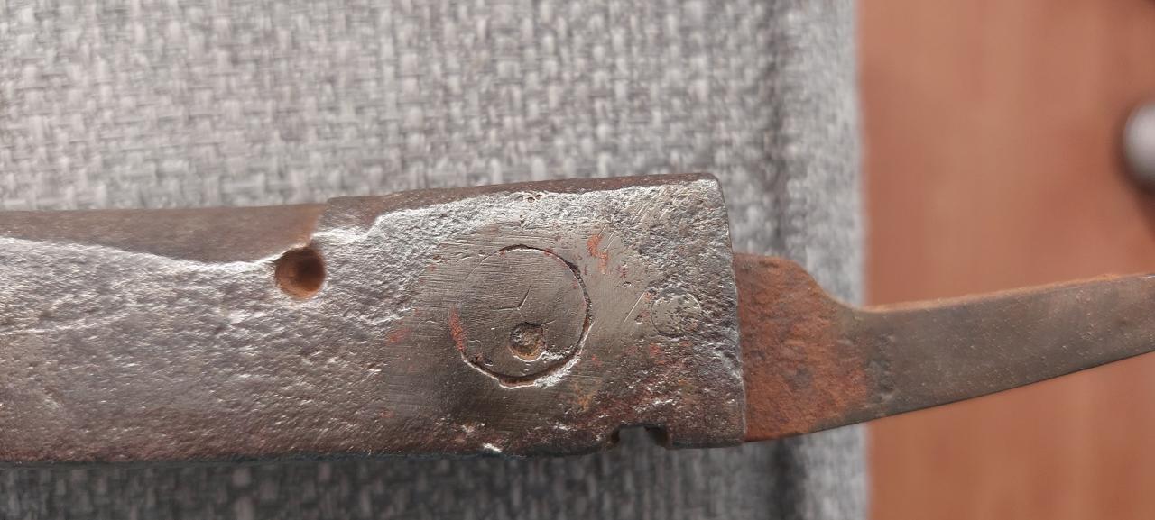

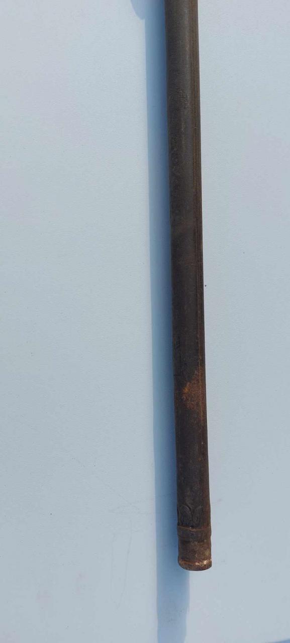

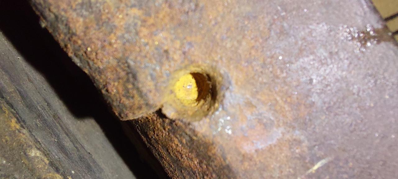

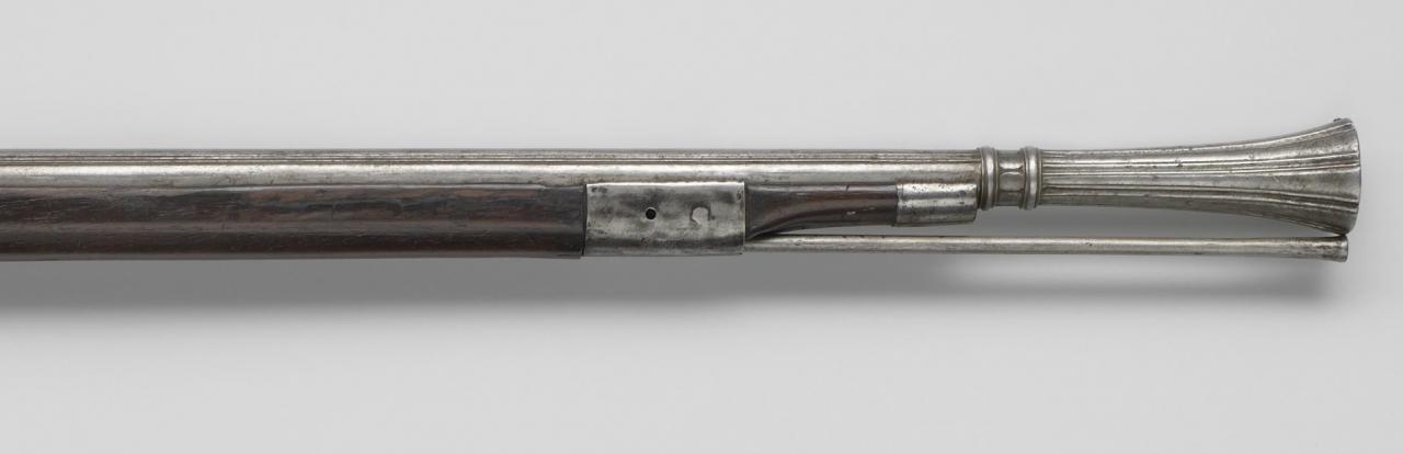

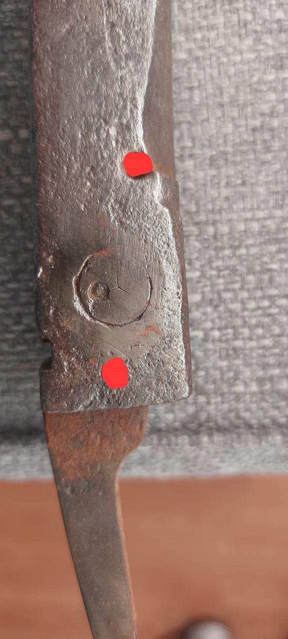

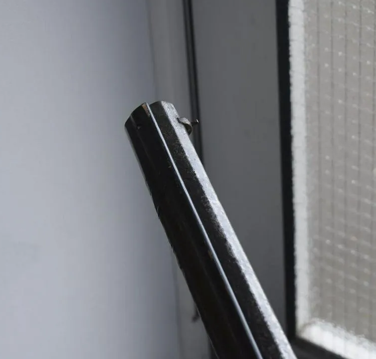

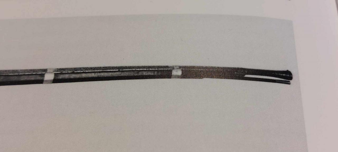

Thats all good news. Out of curiosity what is the drilling in the barrel to the right of the percussion bolster? I was wondering if the detachable stock extension had something to do with accommodating different styles of shooting. Either with the extension resting on the shoulder like a tiller or without the extension shooting from the bench rest.
Raf is offline   Reply With Quote

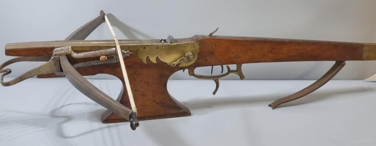

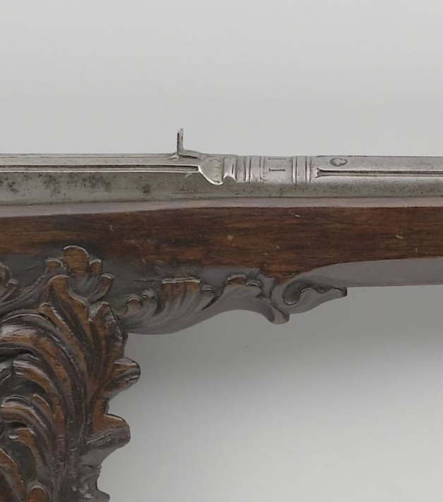

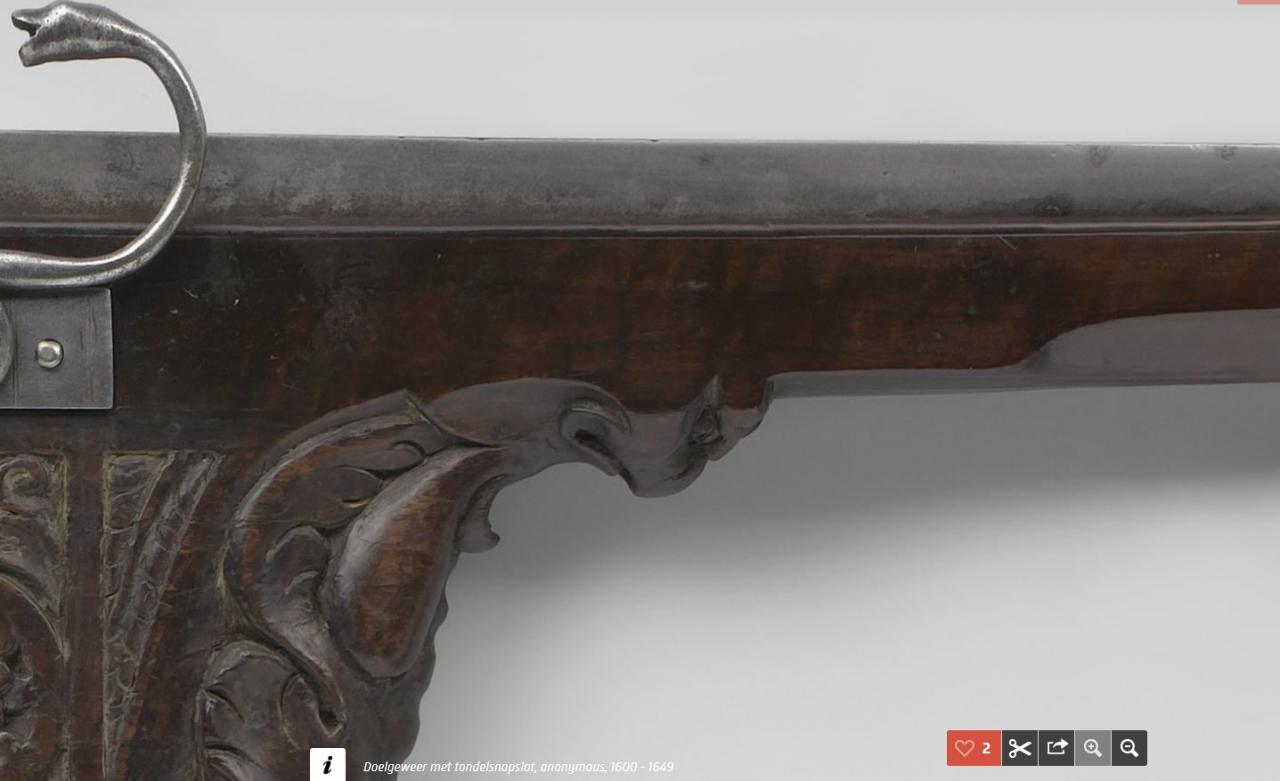

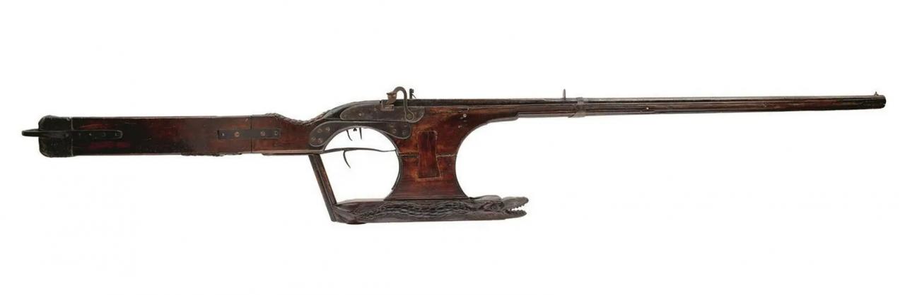

An obvious parallel is the Dutch bench rest target crossbow. Note the set triggers and maybe an idea for the form of the trigger guard.
Attached a picture of this hole. It is hard to see but i think there is a screw thread inside. It is not punctured all the way trough the bore either. I think it might have been a fastening point for the original lock.

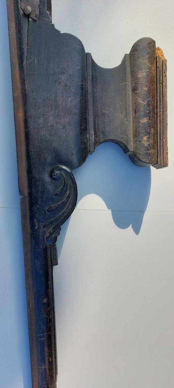

You make a good point about the stock. I own a air rifle which can be modded to all sorts of uses. The barrel and action are all one piece but the rest can be altered. The same could be true for this target gun. Rather ingenious, thank you for that
Exactly, do you know if that style with a bench rwst was also employed in other countries? Trigger guard is a nice starting point too

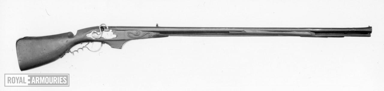

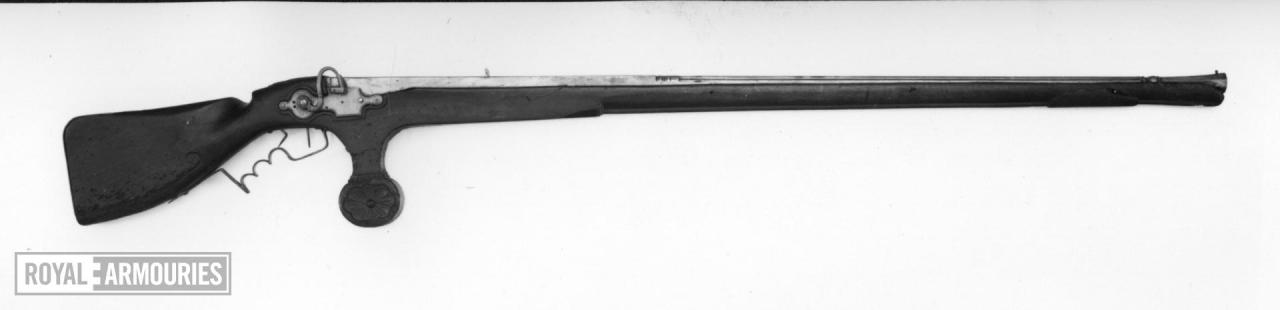

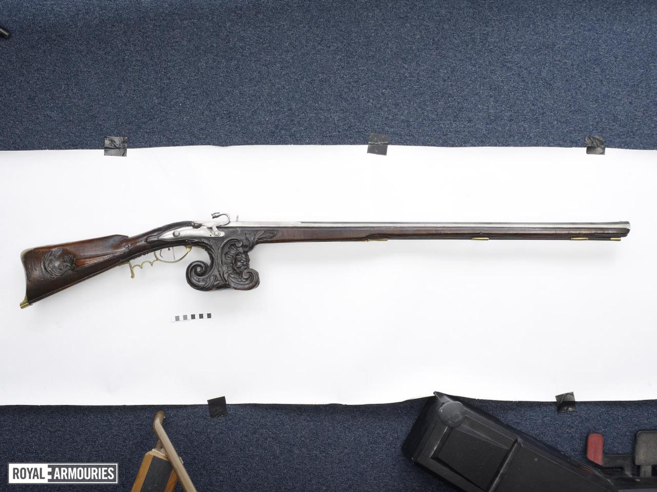

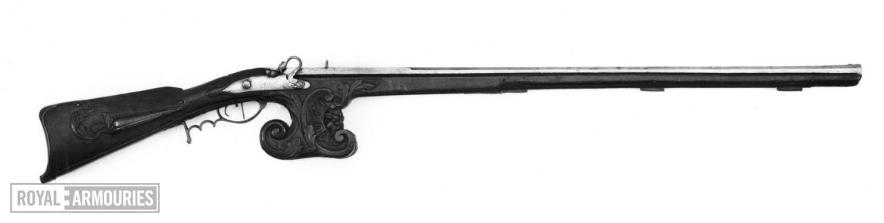

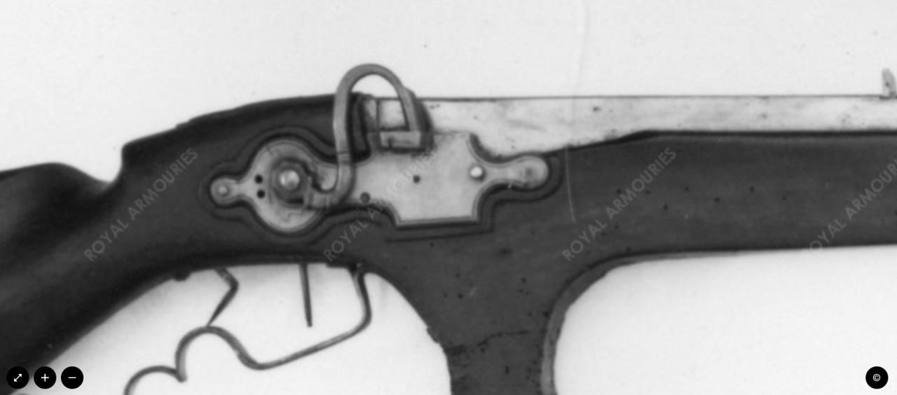

Default Royal armouries Matchlock target gun - Matchlock target gun - about 1680

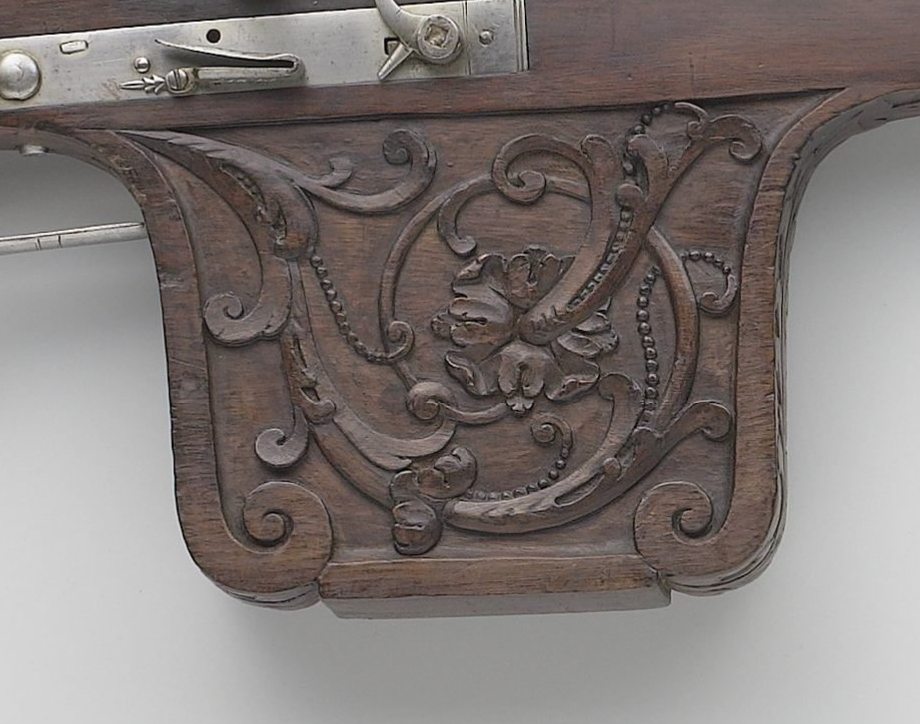

Long barrel of square section ornamented with ribs and flutes towards the breech then round with widely spaced flutes the flared muzzle being octagonal. Wide Vee backsight. A nearly obliterated mark possibly that of Antwerp is stamped near the breech. Lock of similar type to that of No.XII.18 but with brass lockplate and match-holder. Pan-cover and scear missing.
Stock with butt of 'bellied' form; the projecting grip for the left hand is carved with an eight petalled flower. No ramrod is fitted, a false rod being simulated on the fore-end by carving. Indented steel trigger-guard. Double-lever hair-trigger
Dimensions:
Barre lLength 1283 mm
Calibre .60 in
Place: Flanders, Antwerp
Date: about 1680
Location: Study Collection
Object number:XII.20
Provenance: Old Tower Collection
https://royalarmouries.org/collection/object/object-218

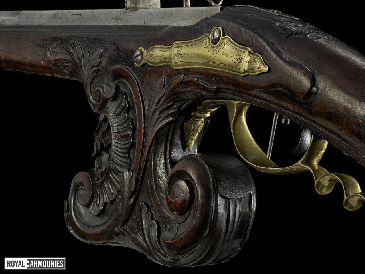

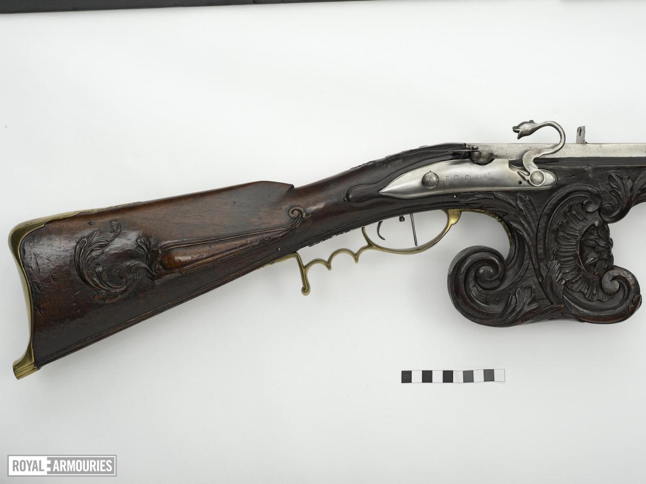

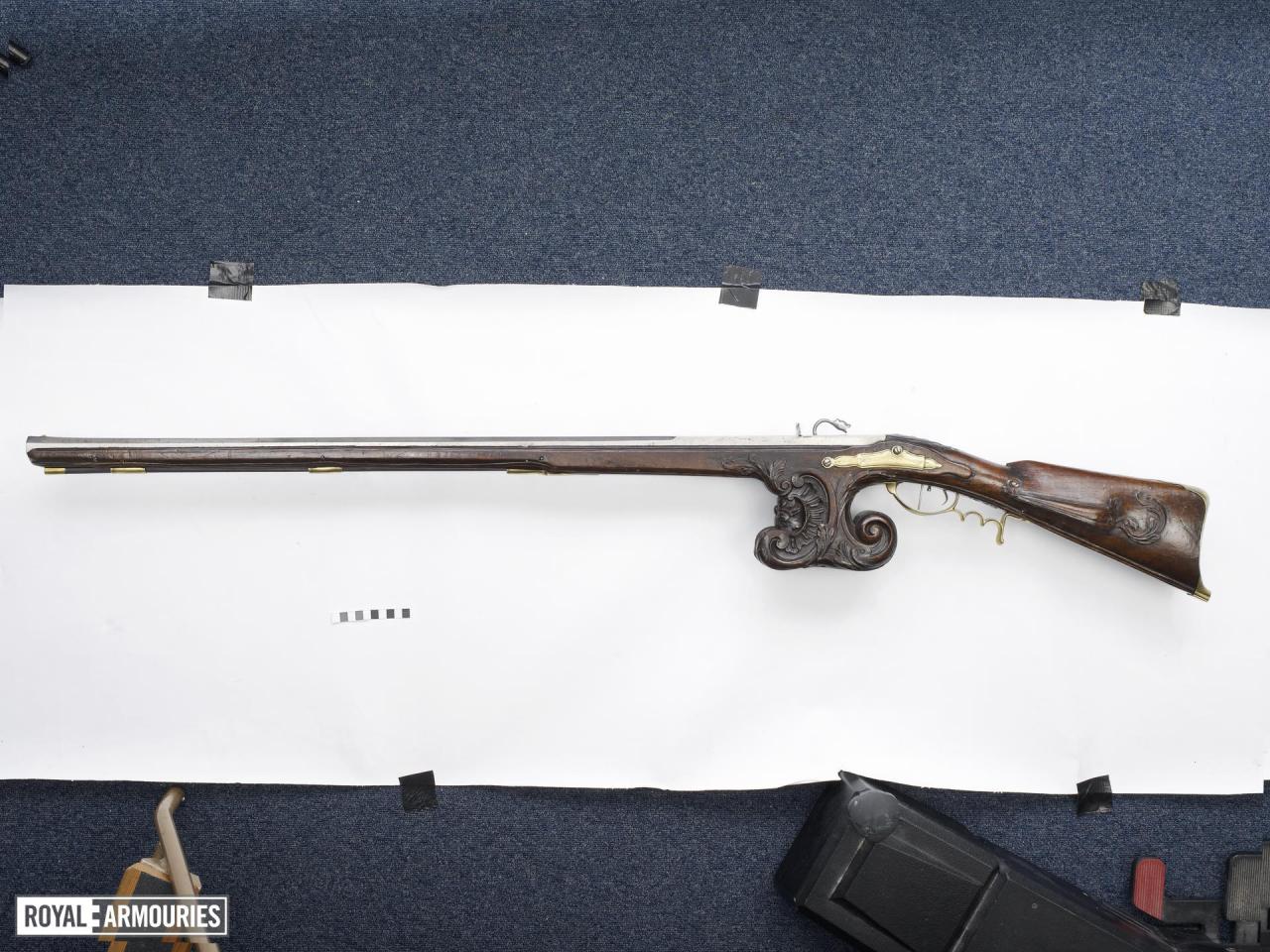

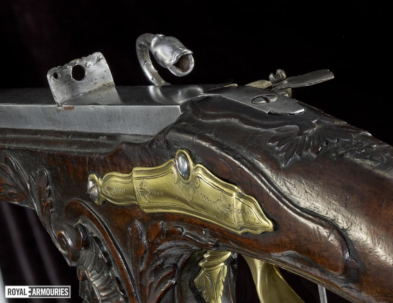

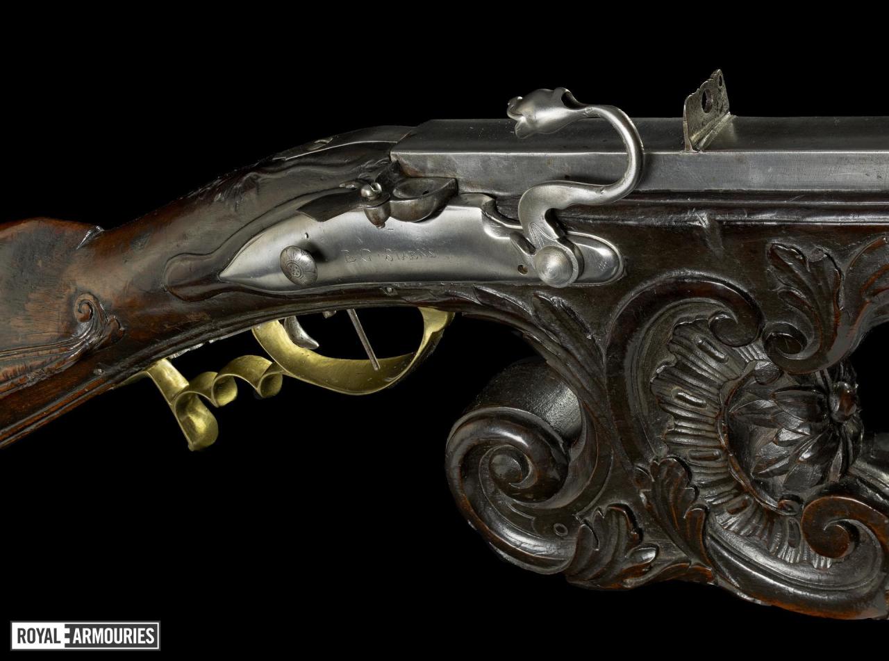

Default Royal armouries Matchlock target gun - By E. G. Siaens - about 1750
Of similar type to No. XII.18 and 20 but differing in detail and of later date. Barrel of square section at the breech altering to octagonal. Wide, flat backsight pierced with a large aperture and originally fitted with a pivoted plate drilled with a smaller aperture for optional use. The pan retains it's pivoted cover.
Lock with mechanism similar to that fitted to No. XII.16, the lock-plate however being of flintlock shape. It is engraved with the name of the maker E.G. Siaens.
Stock, the butt with cheekpiece on both sides, the large hand-grip carved with rococo scrollwork and foliage in high relief. Brass mounts, the trigger-guard indented for the fingers. Double-lever hair-trigger. Ramrod missing.
Dimensions:
Barrel Length 1067 mm
Overall Length 1502 mm
Calibre: .56 in (26 bore)
https://royalarmouries.org/collection/object/object-219

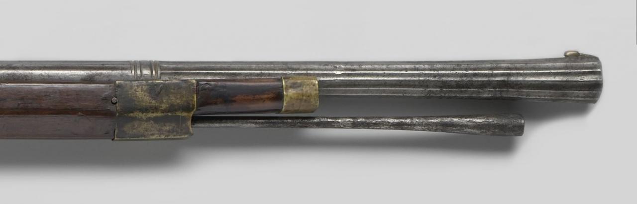

Default Royal Armouries Matchlock target gun - By Jacobus Van Oppy Anvers - about1680
Slender octagonal barrel flaring at the muzzle where it is ornamented with flutes. Brass bead foresight and tall V backsight. The Antwerp control mark (a raised left hand, the palm towards the viewer) is stamped on the left at the breech and a barrel forger's mark on the underside. Lock with S shaped match-holder mounted at the rear of the lock plate and working with a forward motion. The mechanism incorporates a mainspring and tumbler of flintlock type the later with a single cocking notch, The pan is mounted on the lockplate and has possessed a pivoted cover now missing. The lockplate is engraved with the name of the maker JACOBUS VAN OPPY ANVERS. There is a projecting grip for the left hand in front of the trigger guard the end of which is missing. The base of the fore-end is carved with a simple design of scrolling foliage. Brass mounts the triggerguard indented for the fingers. Double lever hair-trigger, steel ramrod possibly original.

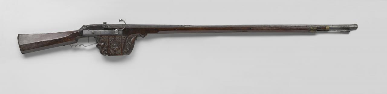

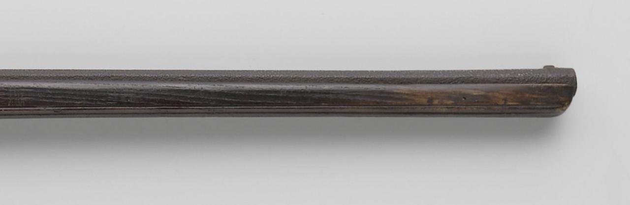

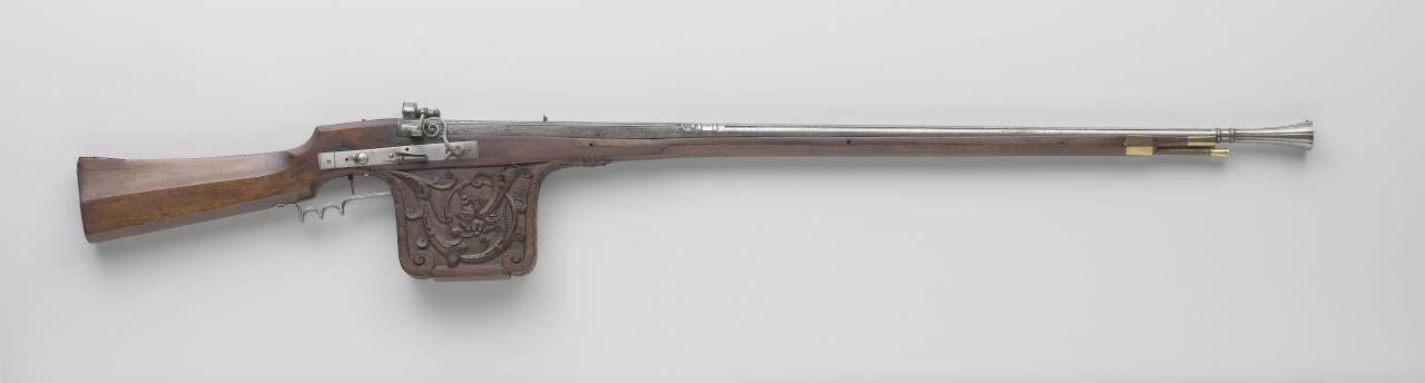

Default Dutch national museum (Rijksmuseum) Target matchlock 1618

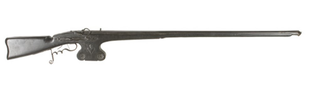

The lock plate has ends in the shape of three leaves. The barrel is of the so-called halber Kistenlauf type, with a breech of square cross-section; the tubular iron rear sight is decorated as a spiral; the sight grain is made of copper; the barrel is partly chiseled with panels, lines, letters and numbers and shows remains of inlaid copper wire, including a diamond with an O and the letters la[..]we[..] flanked by copper incrustation in a zigzag pattern, and the year 1618 flanked by notches. The walnut stock is simply carved and ends at the bottom in a support bobbin with a flower on the sides and at the bottom the remains of an old paper sticker written in ink: This s[?] is fromt a[..] / [.. ]sie; the stock has two cavities on top, one for the shooter's thumb, the other for his hand. The iron fittings consist of a trigger guard that extends into the support spool at the front and has three projections for the fingers, the rear of which is in an S-shape, and of a butt cap with an iron eye soldered to it for hanging the weapon; no provision for a ramrod. The rifle is rusted and dented.
length 191 cm
length barrel 117.3 cm
diameter 14.5 cm
weight 8.6 kg
Purchased from the H.L. Visser Collection, with the support of the Prins Bernhard Cultuurfonds, the Ministerie van OCenW, the Ministerie van Defensie, the VSBfonds, the BankGiro Lottery and the Rijksmuseum Fonds
https://www.rijksmuseum.nl/en/search...G-2002-23-10,1

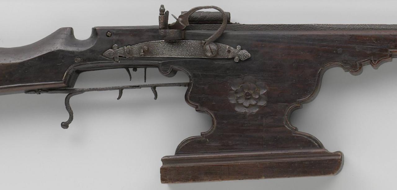

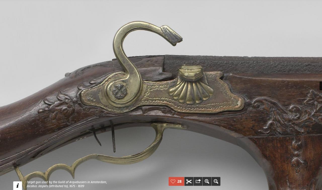

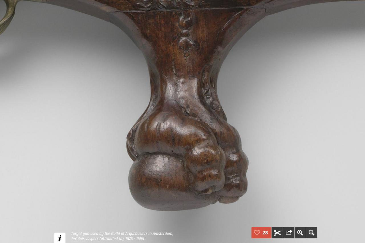

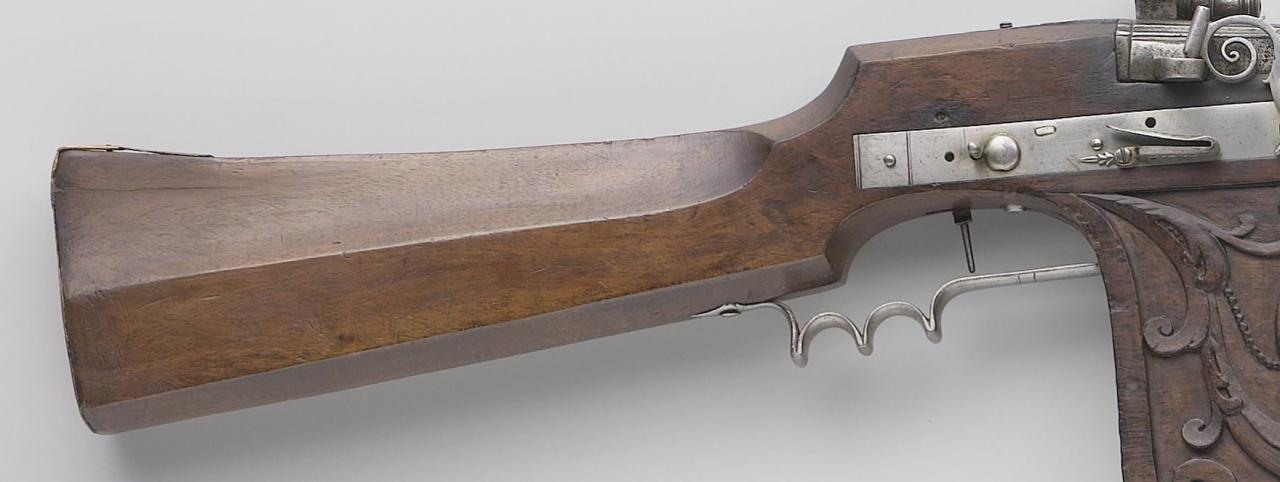

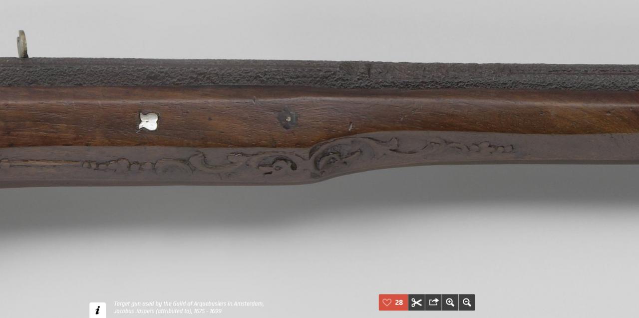

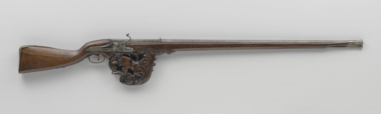

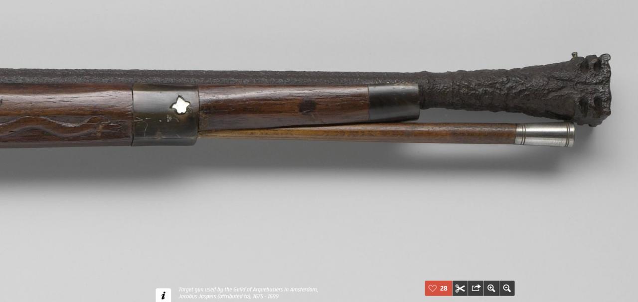

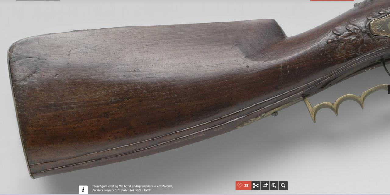

Default Rijksmuseum Target gun used by the Guild of Arquebusiers in Amsterdam, Jacobus Jasper
The support stand on this target gun is in the form of a taloned eagle’s claw grasping a ball, a reference to the Guild of Arquebusiers in Amsterdam. Civic guardsmen would grasp the support with their left hand, while pressing their left elbow into their side. The gun has a tinder lock, which uses a piece of smouldering dried fungus, rather than a slow match, to ignite the powder.
Target gun or target rudder. The yellow copper lock shows traces of earlier gilding; the lock plate is finished with copper; the pan rests on a base in the shape of a seashell. The barrel is ribbed and grooved on the back; the square trumpet is shaped like a Corinthian column; the sight and grain are made of yellow copper. The stock is inlaid with mother of pearl and carved in relief with foliage, snakes and dolphins; the support bobbin for the trigger guard ends in a bird's claw around a ball that is flattened at the bottom. Apart from the cow horn drawer hood, the fittings are of previously gilded yellow brass and consist of a screw plate engraved with a name, and a butt plate with a spur across the entire handle; the ramrod has an iron cover.
length 163.8 cm
length barrel 124.6 cm
diameter 10.9 mm
weight 6.8 kg
https://www.rijksmuseum.nl/en/search...G-2002-23-14,2

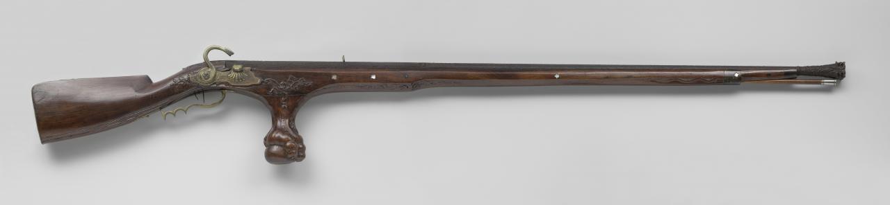

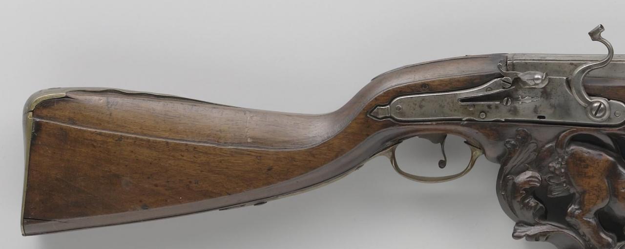

Default Rijksmuseum Target gun, anonymous, 1628
The lock is equipped with a circular fire screen on the side of the pan; the neck of the rooster is marked EDP, EDR or EDB on the inside. The barrel has three flutes on top and a flared trumpet in the shape of a snake's head with a flattened ball; brass grain, blued iron sight; decorated on top with debossed dots in a cross pattern; Marked on the back with a U or C. The stock is equipped with a support block consisting of a pillar with a circle underneath. The gold-plated, brass fittings consist of a trigger guard protruding from the butt with serrations for the fingers, a raw screw plate, a large oval cartouche engraved with the representation of Saint Christopher flanked by the year 16 (and) 28, and a butt plate in two parts : one on the lower tip of the butt, the other partly on the back; no provision for a ramrod.

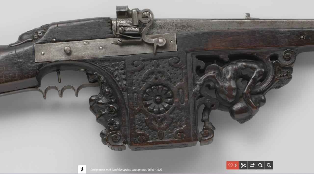

Default Rijksmuseum target gun with tinder snaplock

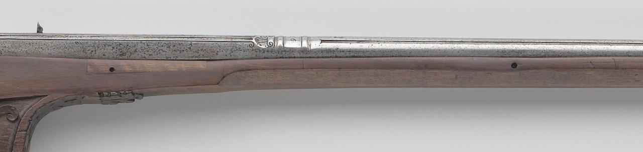

Target gun or target rudder. The tinder snap lock has a rectangular lock plate with a cock on which a tube for the tinder is brazed. The barrel consists of a quadrangular part that after a ring, stamped twice with a mark in the shape of a key under a crown or finial, via a round and a second ring, ends in a cup-shaped trumpet showing the remains of a sight grain; equipped with a visor with viewing hole stamped with an incomplete year. The stock has an octagonal grip and a massive supporting bobbin under the lock, the sides of which are carved in relief with panels based on the architectural style decoration of late 16th century book covers; the front and back of the support bobbin are almost three-dimensionally cut and pierced with, among other things, a half-seated faun with a bagpipe and a large lion's head; instead of a thumb plate, the stock behind the barrel is cut with a cobblestone. The iron fittings consist of a drawer cover and band made of iron sheet, a trigger guard shaped to the fingers, and a butt plate with a spur across the entire grip; the steel ramrod dates back to the eighteenth century at the earliest.

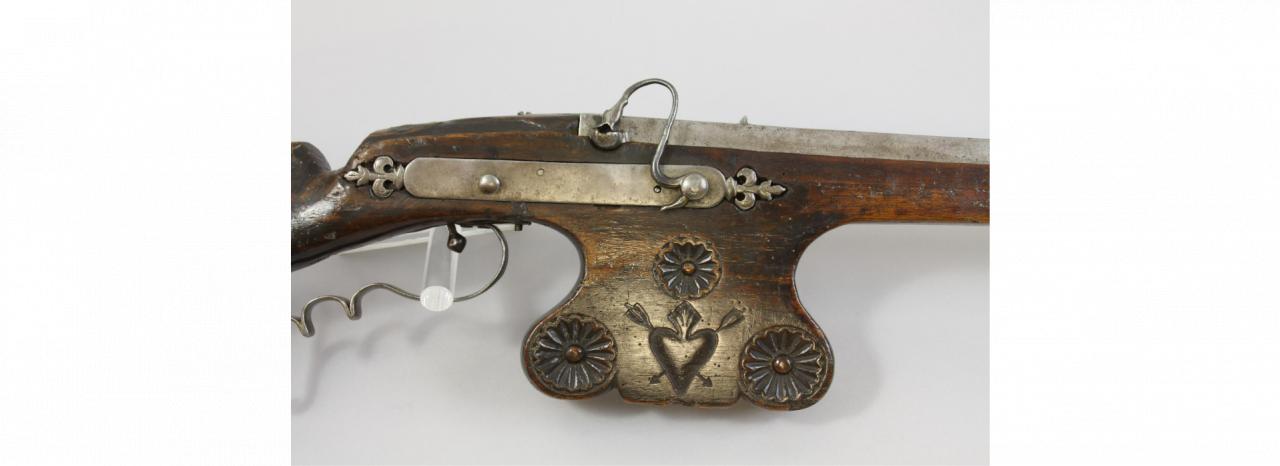

I know a beautifull matchlock target gun housed in the Musée McCord Stewart
https://collections.musee-mccord-ste...47117/no-title.

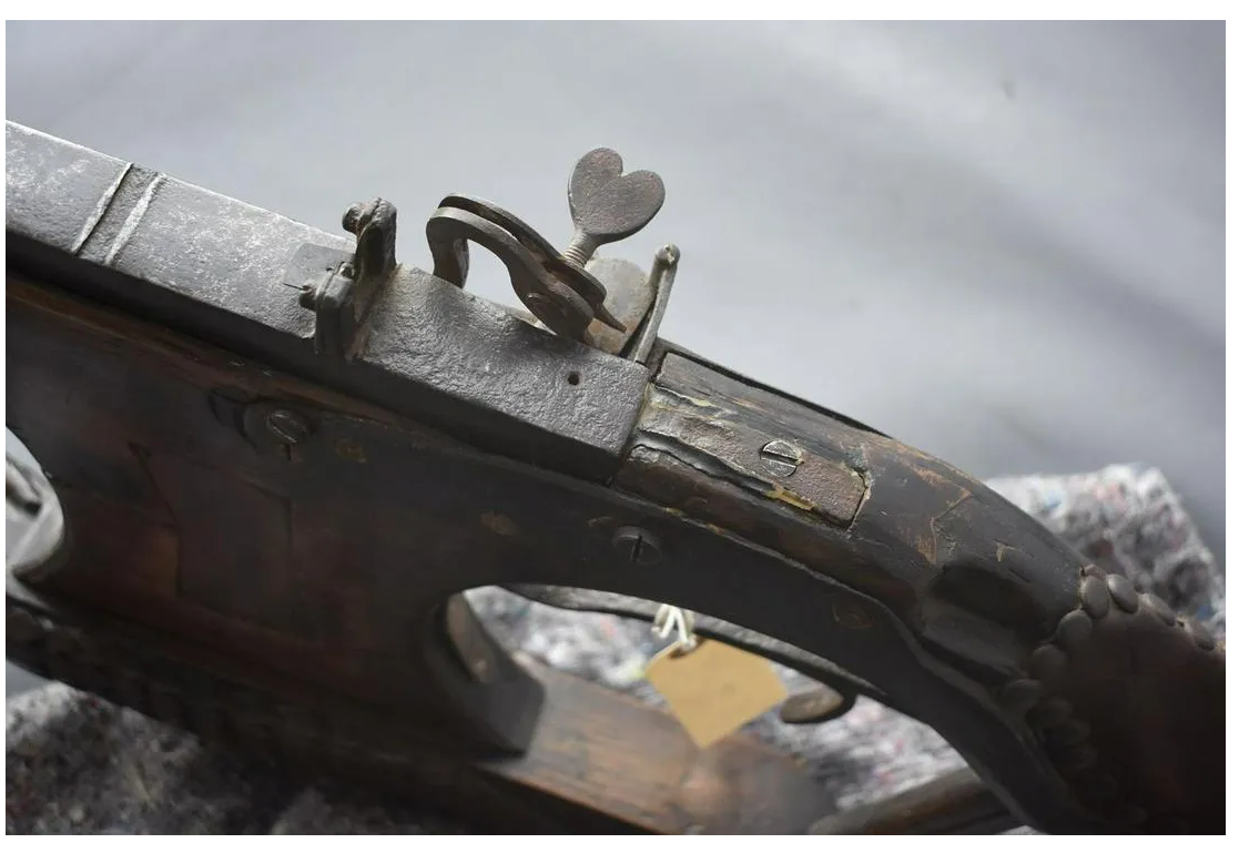

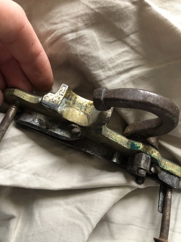

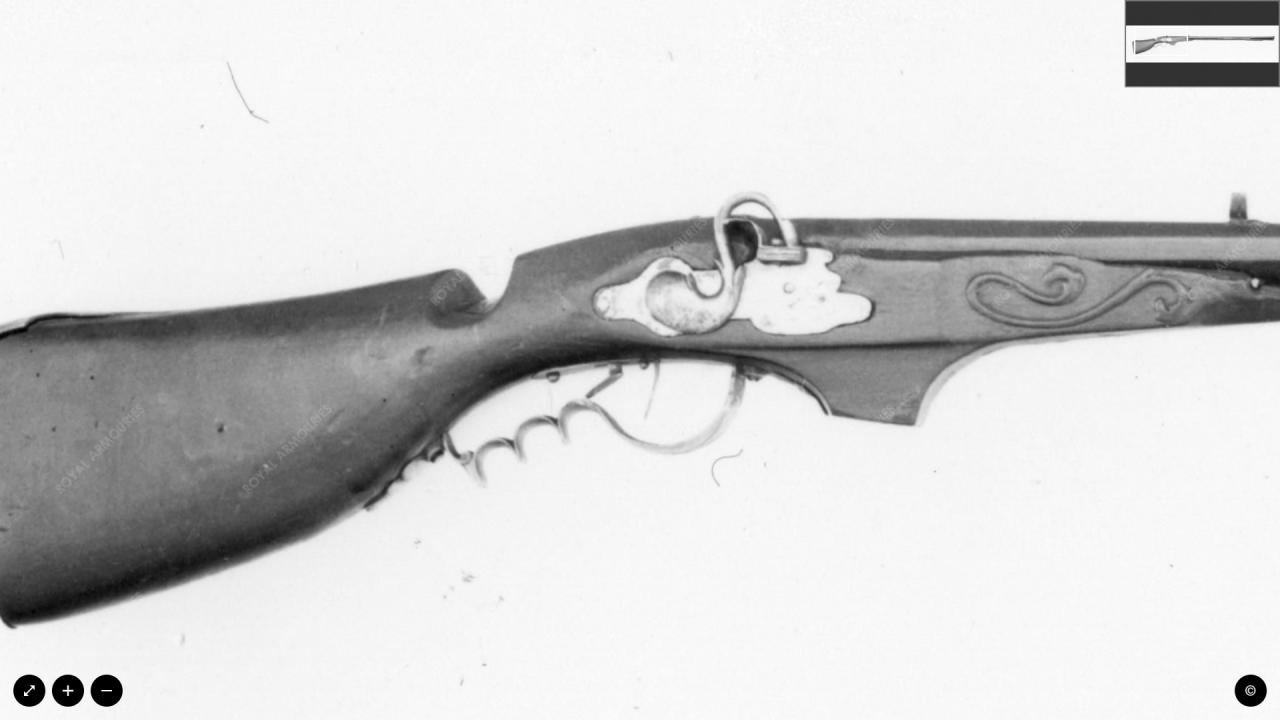

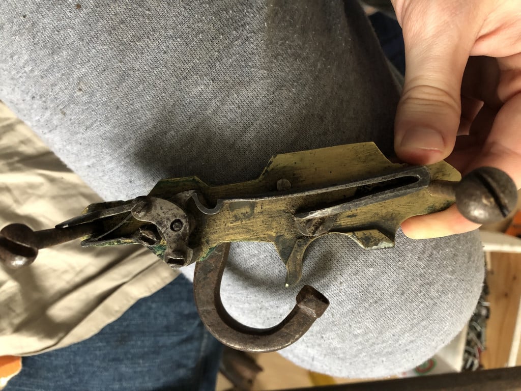

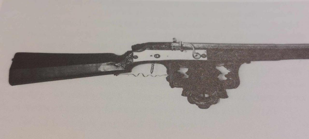

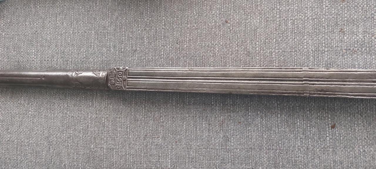

Here , out of interest is another conversion of a snap lock target gun to percussion
Old 24th June 2024, 03:52 PM   #23
Marcus den toom
Marcus den toom's Avatar
Location: Netherlands
Posts: 543
Thank you both for the contributions.
Thank you Cerjak for pointing out the rare wheellock gun as well!!
As to the dates, i am not sure why so many have been dated. Maybe the shooting guilds had an annual competition and these guns were the price (far fetched i am sure)?
The choice for a snap lock has, i think, also another reason. A conventional matchlock requires sufficient power to operate the mechanism. The target gun with hair trigger lacks that power, it is alot of energy put into speed rather than power. A snaplock serves best with it stored energy, ready to be released with a small squeeze of the trigger.
That lockplate you posted Raf seems to have been reused, but the internal workings have been (completly?) been remade. Is this yours?

Old 29th June 2024, 03:42 PM   #25
Marcus den toom
Posts: 543

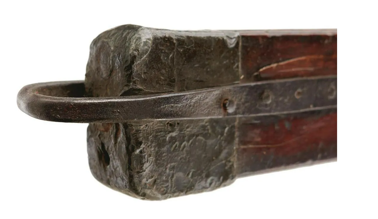

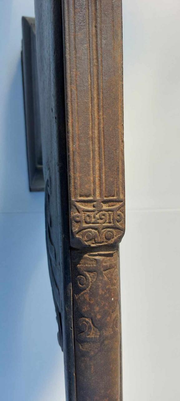

The barrel has been repaired and cleaned. The percussion tower has also been removed. This revealed a second possible screw hole, since filled.
My idea is the barrel had a screw on powderpan.
Attached pictures
The lock could than just have been a rectangular snap tinder lock.

Posts: 252
It's a reasonable idea especially since the front drilling is offset avoid drilling into the bore . Otherwise what are these holes for ? For clarification is the hair / set trigger arrangement part of the trigger assembly as in the x ray image in your previous post?

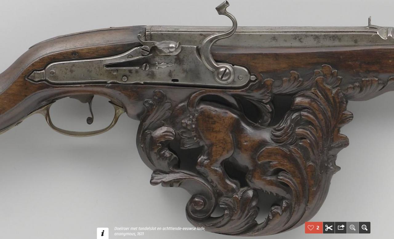

I have asked the Rijksmuseum in Amsterdam for pictures of the inside of the rectangular locks. These internal pictutes would complete the puzzle.

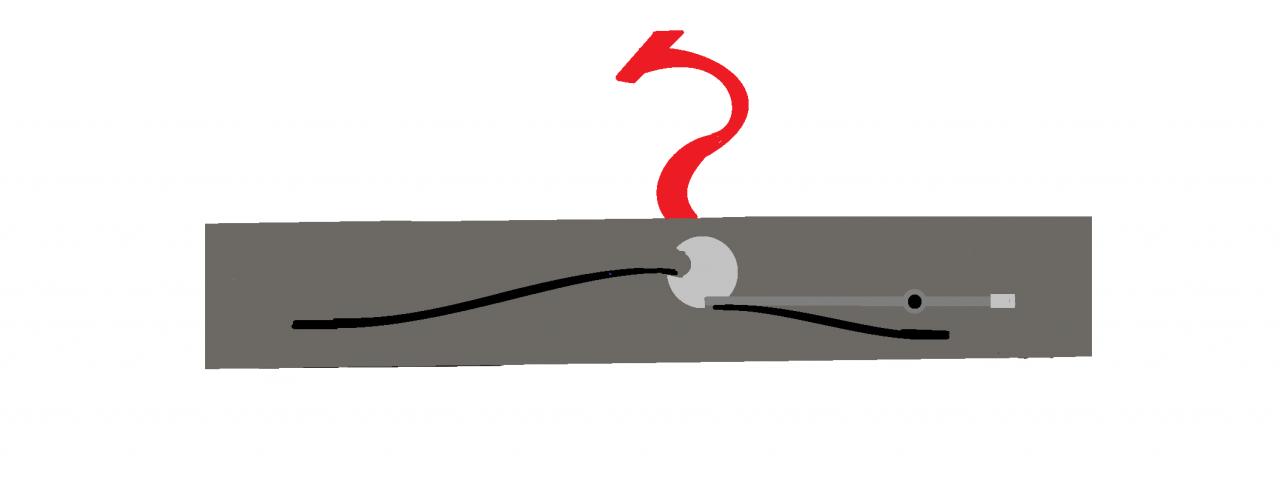

Old 4th July 2024, 04:05 PM   #28
Marcus den toom
Posts: 543
Sofar i have been unable to find any other locks belonging to this type of gun.
My best guess is as follows (see picture):
A rectangular lock plate with an early tumbler and sear mechanism as seen on flintlocks. The black parts are the springs, the red part is the tinder holder.
A similar mechanism can be seen on a 1530-40s snap tinder lock.
Will keep looking, any help in finding more of these guns is appreciated

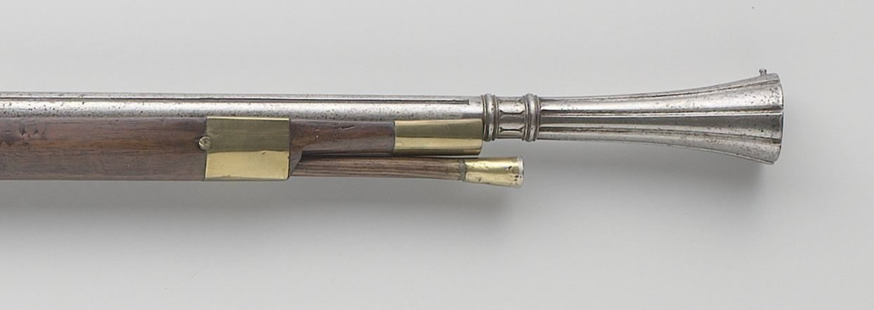

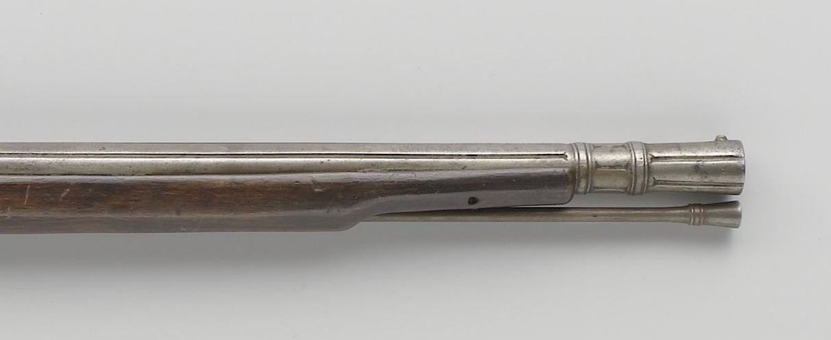

A chaperon from the "Schutterij", a city guard comprised of citizen soldiers, of the city Dordrecht. In this instance it belonged to the "kloveniers gilde" a Dutch interpretation of the French word couleuvrine, a short musket.
The Chaperon is embroided with a royal tree (emblem of Prince Maurits), crossed with two target guns very similar to the one in post 17. There is also a date of 1622, which is another great example of how these guns seem to have been around mostly during the first half of the 17th century coinciding with the golden age of the Netherlands.
It is very difficult to decern but it looks like the guns have a diopter visor on the front.
Old 9th July 2024, 06:19 PM   #30
Marcus den toom
Posts: 543

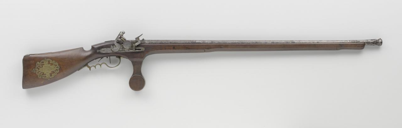

Another one without any further information. Found in the book Schutters in Holland, page 224.
Among this example are also all the target guns currently in the Rijksmuseum, this one did not make it to the collection and is for now at unknown wereabouts.
