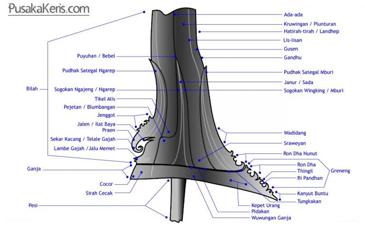

Please help me understand the significance and meaning of the components of the bilah and ganja (as illustrated in the attached diagram). My interest stems from gaining a better understanding of the Moro kris and its history.
Can you explain what the various components of the "elephant trunk" area represent: the praen; sekar kacang/telale gajah; jalen/ilat baya; and lambe gajah/jalu memet on one side; and the ron dha nunut on the other side.
Also, on the ganja, can you explain what the following represent: the cocor; sira cecak; kepet urang; kanyut buntu; padakin; wawungan ganja; and the three components of the greneng (ron dha, thingil, ri pandhan).
Lastly, can you point me to references explaining how these elements came to be arranged in this formal manner for a pusaka keris.

Perhaps an acceptable way to begin on this exercise might be to strip away as much of the obscurity of language as we can, so here is a word list, I have used a number of dictionaries, so you have dictionary meanings, not my own ideas:-
praen --- features, countenance (Javanese)
sekar --- sekar (Jv.-- krama for kembang)
kacang --- bean, peanut (Jv.)
telele --- correctly:- tlale --- elephant trunk (Jv.)
gajah --- elephant (Jv.)
jalen --- (jali) --- a kind of grass, millet (Jv.)
ilat --- tongue; also --- a peg to control water flow
baya --- crocodile (Jv.)
lambe --- lip, edge, rim (Jv.)
jalu --- spur on cock's foot (Jv.)
memet --- intricate, complicated, joined into one, difficult to grasp, mixed
together from separate parts (Jv.)
ron --- leaf (Jv. -- krama for godhong)
dha --- a letter of the Javanese alphabet
nunut --- to ride together with (Jv.)
cocor --- beak (Jv.)
sira --- correctly:- sirah (Jv. -- krama for endhas)
cecak --- small house lizard (Jv.)
kepet --- unaccented "e" -- hand fan, accented "e"'s --- caudal fin, tail
fin, second "e" only accented -- thin, empty (Jv.)
urang --- shrimp, prawn (Jv.)
kanyut --- to get carried away (by a current) (Jv.)
buntu --- blocked at one end (Jv.)
padakin --- unknown, perhaps "pidakan"? pedal, to step on (Jv.)
wawungan --- unknown, perhaps "wuwungan"? "wuwung" = rooftop (Jv.)
greneng --- a complaint, but specific to keris:- a small crooked ornament
it seems likely that originally this word was "glendheng",
which means long uncut stalks of bambu or wood, but over
time it has become corrupted to "greneng" (Jv.)
thingil --- something that stands higher than its surroundings (Jv.)
ri --- abbreviation of "eri", a thorn or a fish bone (Jv.)
pandhan --- pandanus (Jv.)
pusaka --- heirloom, revered object, inheritance, family rice field (Jv.)
