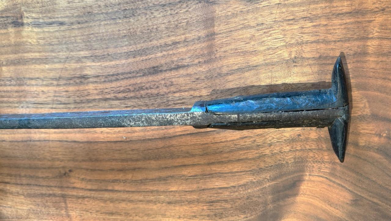

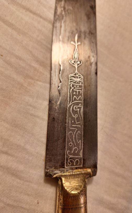

Hi, new here....
I picked this up back in the 1990's somewhere in SW Asia. Not sure where, I was traveling a lot in that region and on the African continent. Anyway, what do you guys think I've got?
I think the arrow head (on both sides) must have been like the "Front Toward Enemy" you see on Claymore mines these days

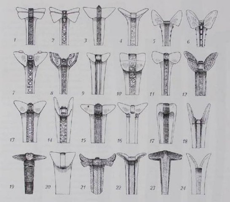

I agree, the grip looks like # 19 and is indeed typical Ottoman Asia Minor.

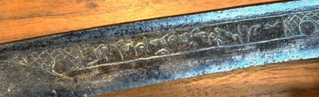

The blade looks also like a Yataghan bu the inscription decoration is interesting and I would like to see some close ups if possible after a little cleaning to see what exactly is written.
Compared to the usual Ottoman one, it looks a little more simple in its execution, but that also could be the work of a simple maker from the country side or a beginning crafstman...

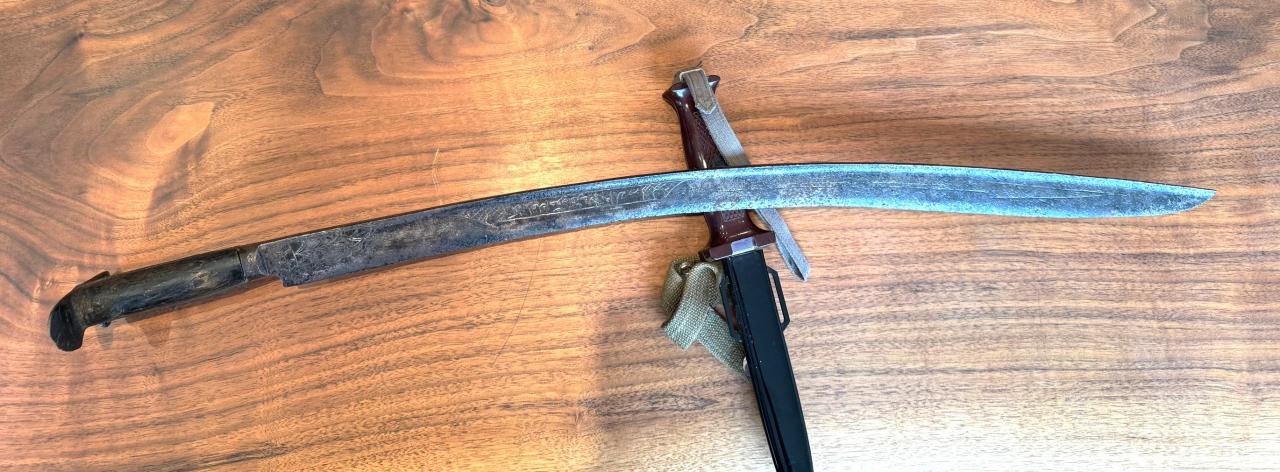

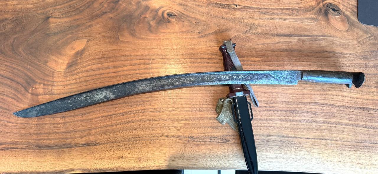

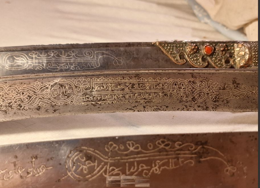

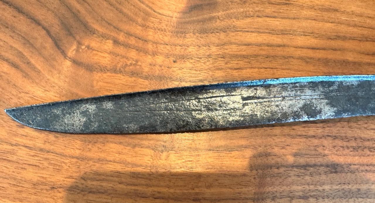

Default "Cleaned"
This is after first scrubbing using soapy water and a stiff brush then letting vaseline sit on the blade for 10-12 hours.

Posts: 4,736
SchwartzStock, still no pictures. Please check that your pictures are not too large and are of the correct format. Are you trying to attach them to your post? When I open and edit your last post there are no pictures attached to it.

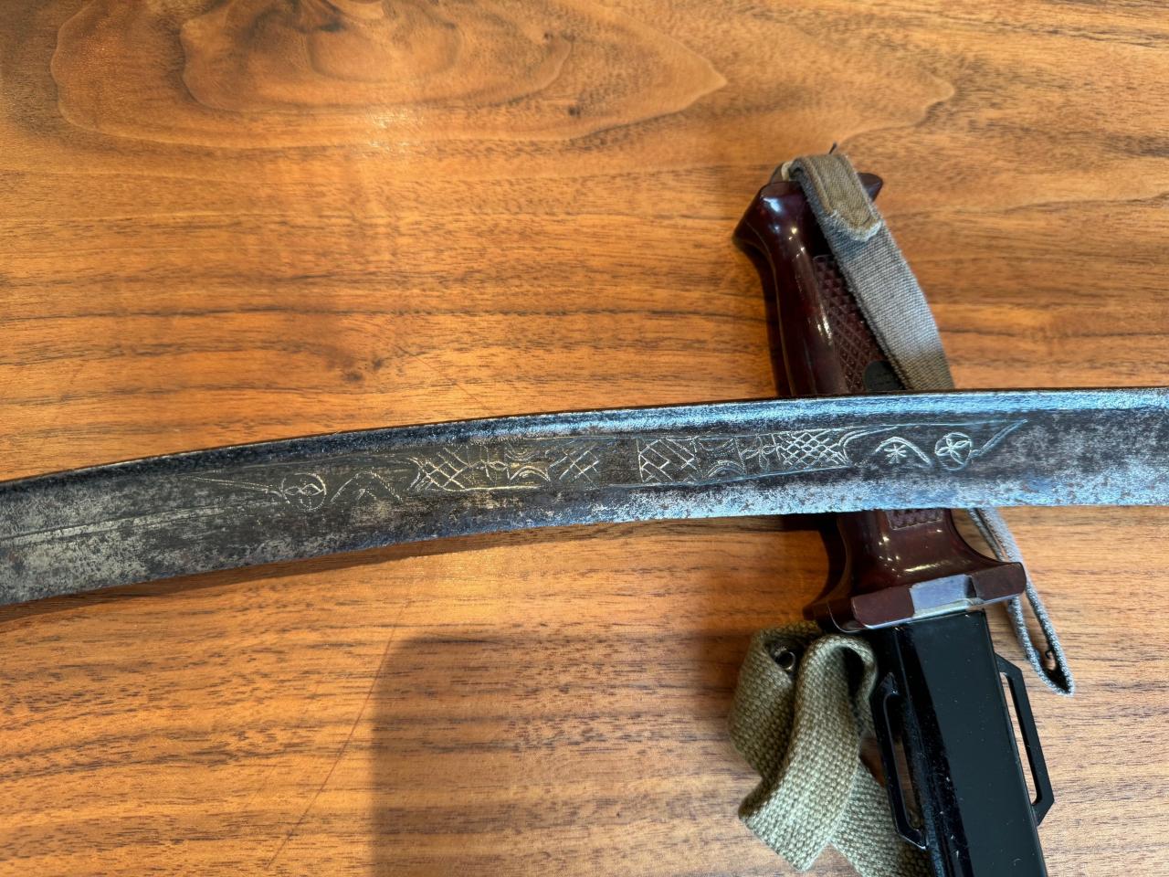

Posts: 11
Again...
