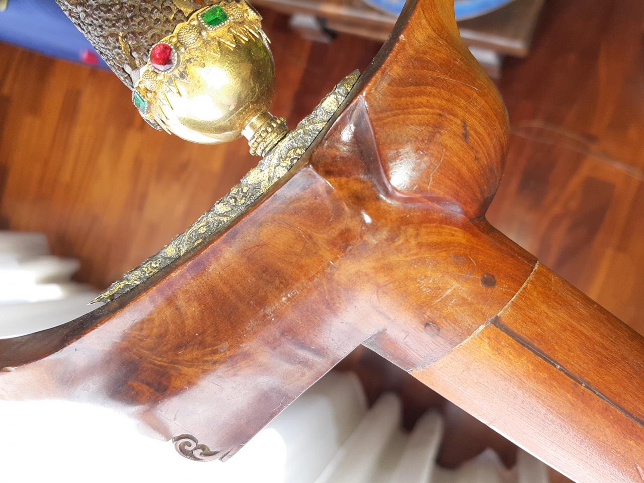

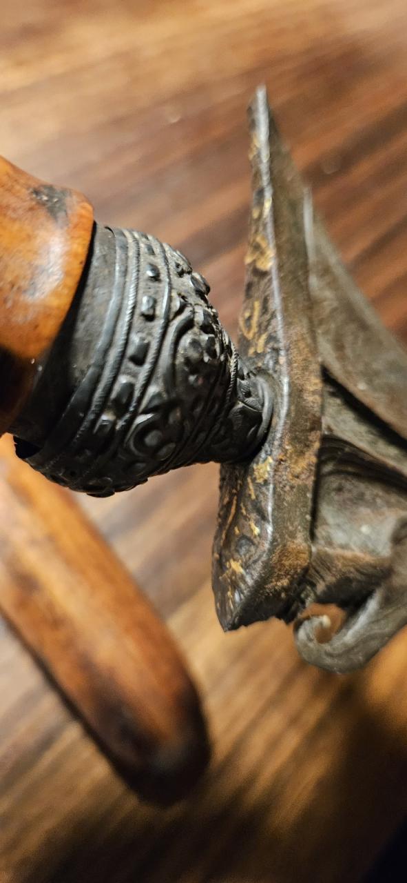

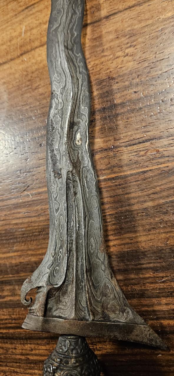

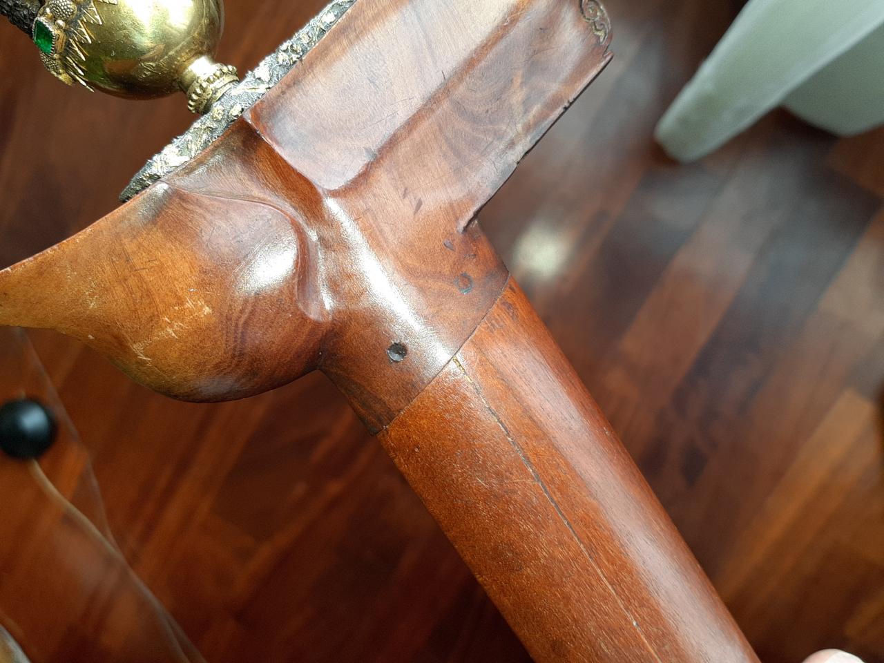

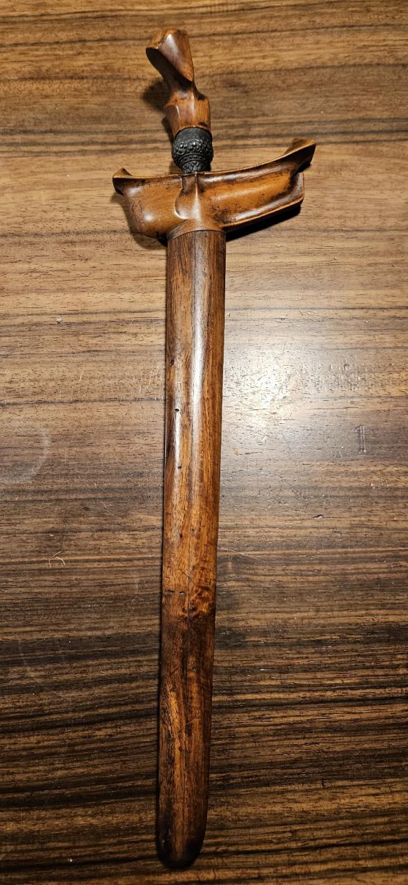

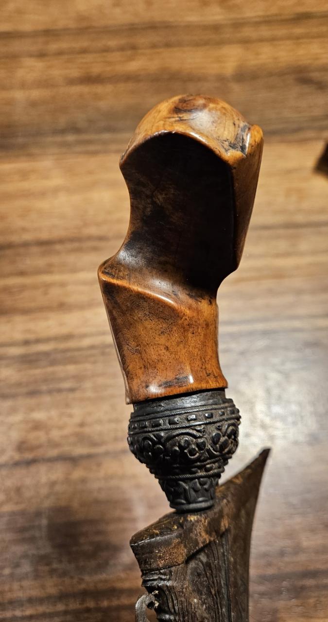

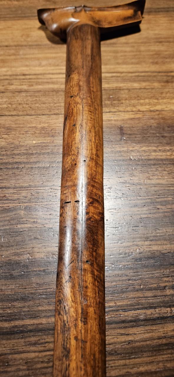

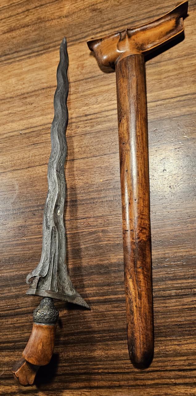

Hi, this is the other Palembang keris I bought at a flee markt. Also a nice one I think. Less smooth as the other one, but as i see it still a very good quality blade. It has some remnants of kinatah on top of the ganja. The grip is a bit less robust and the wood is of a lesser quality wood. A weird thing, which I have never seen before, is that the scabbard is made of two parts but split in the middle, not on the sides. So there is a left and a right part, instead of front and back. Can't imagine that this wasn't covered with a pendok.
Is this also a Palembang blade or from another area incorporated in a Palembang dress? Any thoughts or comments on this piece?
The total length of the keris is 53 cm, the blade without peksi is 40 cm.

I recently parted with a Bugis style keris that had the same method of gandar construction. It was the only one I had ever seen --- until I saw the picture of this one.
Old 22nd January 2024, 09:21 PM   #3
Post
This is a pretty common way of construction of scabbards for northern Melayu keris coteng.
Also typical for western Sumatran Sewar - thus, this idea has been around.
Very unusual for Palembang or all of southern Sumatra though.
I also have one. Now you can say you have seen two !

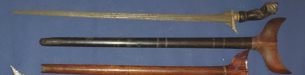

A panjang with the same gandar construction.

It is interesting the way these are showing up. I have only ever had one in my hands & had never seen another.

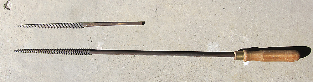

Probably this way of making a gandar might be something that is limited to Sumatera & the Peninsula, to my mind this means that historically these places did not know about the segrek, the tool with reverse teeth that is used to make a gandar with no joints.

Hi Peter. Looks like everyone got distracted by your split gandar and missed your question.
Yes, i would say that the blade most probably true to the dress and of Palembang origin. Over all an very nice keris. And the "selut" looks like tarnished silver so if this were mine i would hit it with a polishing cloth and see if it shines up.
I'm not convinced the split down the middle means this gandar would have been covered with a pendok. Ususally a lesser wood would have been used if the gandar was intended to be covered and this stem seems a bit too bulky to cover. Nice flea market find.

However, if we were to remove all dress items from this blade, what classification do you believe most experienced students of the keris would give it?
By "classification" I mean "tangguh".

I wasn't asked, so please excuse me for butting in, Alan. But I am interested and it's been awhile since your question has gotten a response.
Would this keris permit a Banten classification?
I can see some similarities, but not nearly enough to make that a viable guess for me.
Sorry i didn't respond to the question earlier, but i somehow missed it. I have never considered tangguh my strong suit. I am often much better at noticing why a particular blade could NOT be something rather than proclaiming what i believe it actually IS. I see some similar ricikan that we might see on Banten keris, but not the level of execution i would expect. The blumbangen seems a bit too square and small (more like Mataram) here and i would expect to see greneng and perhaps even jenggot on keris Banten. We don't have a good overall shot, but from what i can see the luk seem too shallow for the usual Banten blade. And if i recall, don't most Banten keris have something more a kin to a Bali finish? In fact i liken Keris Banten somewhat to the look Bali keris.
Not sure i know what answer Alan was looking for, but i might have suggested Palembang regardless of dress is pushed to make a call.
