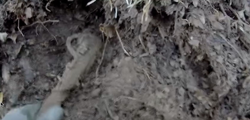

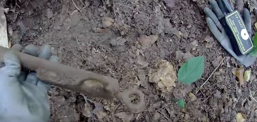

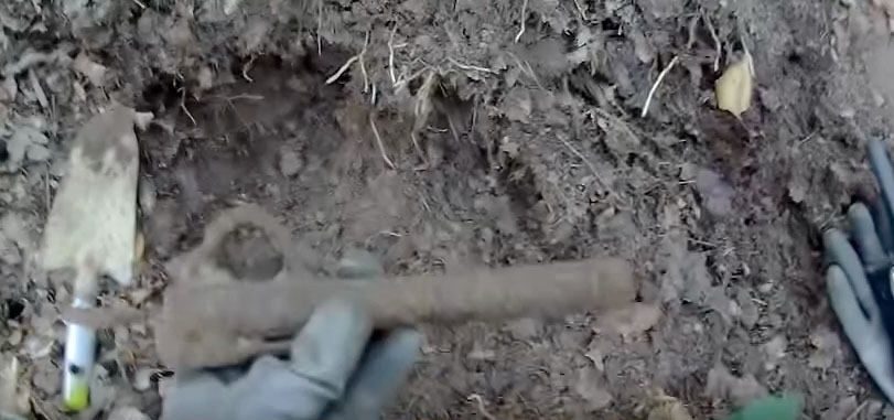

Just in case the link vanishes here are a few stills to complete the thread.

Sorry to burst the bubble, but this person makes forgeries for ebay.
He sells haquebuts poleguns etc as well.
The fact that this piece is:
-so well preserved after a odd 500 years
-only 10 cm in to the earth with "fresh" leaves covering the piece
-the fact he knows what this is for an "amateur"
-the real Monk's gun is just a curio, not a standard firearm of the time and finding another one in the earth like this is more than curious.....
Still a fun display and interesting if it where in "new" condition.

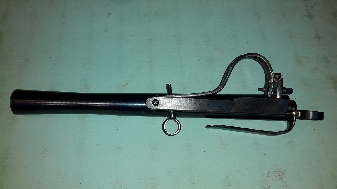

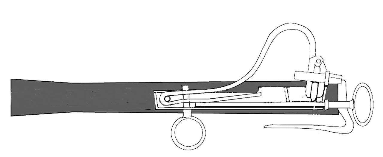

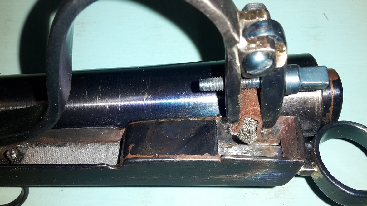

Looking at the plans by Peter Kunz at https://www.feuerwaffen.ch/waffenkonstruktionen.htm, as well as the images of the original & several reconstructions- it seems the exact nature of the friction plate isn't well described. In only image that almost shows it is from the Rüstkammer, and there seem to be linear slots in the plate similar to that of a wheellock, rather than perpendicular cuts like a file or rasp (image below). I don't see any indication that the spring wraps around to put pressure on the bar, but it may further in. The style of rasp and its composition could greatly influence the reliability of the device, and may be why some reconstructions have been more successful than others.

Thank you for posting this new picture. You may be right and there is no evidence that the serpentine is not simply hinged as in Peter Kunz reconstruction. However it also shows two unaccountable errors which would undoubtedly affect its functionality. The friction bar is made both too wide and too short. The admittedly poor illustration attached shows the friction bar is less than 1/4 inch wide and has an effective frictional length of about 4 inches . Which corresponds to the frictional area of early Wheellock wheels. Also in the section nearest to the handle the two horizontal groves are well defined but the rest of the bar appear worn. This may be circumstantial evidence that it did actually work.
In my practical experience of the vagaries of wheel lock ignition I find it difficult to see how the required frictional velocity could have been achieved simply by pulling on the operating handle. Furthermore as far as I'm aware no one has made a reconstruction that proves it actually works in the way it is described.
However I may have over complicated the problem and it is just possible that a short lanyard tied to the handle pulled sharply overcoming the pressure of the pyrites on the friction bar might create a velocity sufficient for ignition.

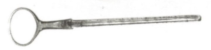

Looking closely I believe the friction bar is a separate part from the pull ring, with a rivet just above the juncture. Possibly a repair, or because the bar is made from carburized sparking steel while the pull ring is a softer alloy. Interestingly I found images of another reproduction which was sold sometime last year, and the gunsmith specifies that he produced a greater spark using flint in the device (demonstrated in the third photo!). I obviously have no insight into the accuracy of this reproduction, but as flint generates sparks by cutting (rather than pyrite, which is cut) this could explain why the original bar is very worn. With this in mind I'm considering if the the pyrite which survives in the device could be an erroneous addition, and has misled its interpretation. Matchlock's stylistic ID to 1525-30 isn't far from the earliest written mentions of flint snaplocks, so I don't think it's too outlandish of an idea.

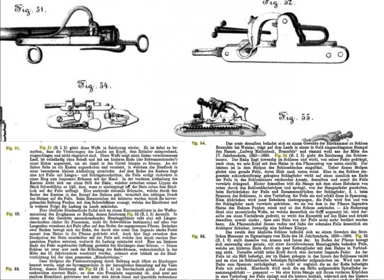

I managed to track down this clip from Thierbach which discuss the Monks gun in the context of other friction bar ignition systems. Could any kind person help with a translation as I can't get Google translate to do it?

Great find Raf, it seems to describe the monk's gun operating with pyrite as has been discussed, with linear & oblique cuts to the friction surface. Fig. 52 is a cannon lock from the 18th century with nearly identical construction, while 54 & 55 are spring driven friction bar systems from the 17th & 16th centuries respectively. This is what I gleamed using machine translation, and I can't find any opinions in the text regarding the efficacy of the device.
What I'm most curious about now is Fig.56 from that book, which shows an early 16th century lock where the friction surface is the segment of an arc. Functionally this would be the missing link between the linear bar & wheel, but not necessarily chronologically.
