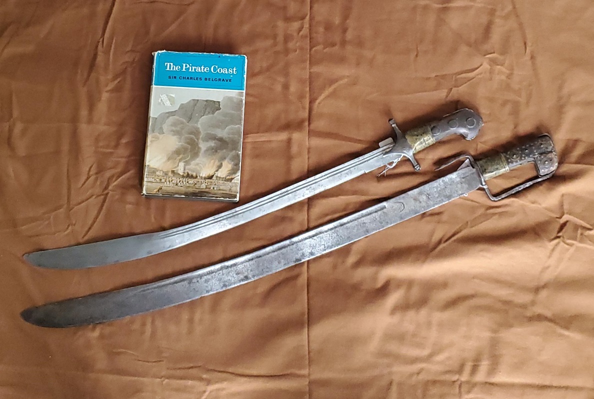

There were pirates in the Persian Gulf in ancient times, but the subject here is those who preyed from the Strait of Hormuz at Ras al Khaima along the coast, southward. These regions were known as the 'Pirate Coast', until 1820 when the British signed treaties with many of the sheikhs in coastal principalities with these regions termed 'The Trucial Coast'.
While the complexities of these ongoing circumstances in these areas, it is interesting to note this obscure area of 'piracy', which typically of course is centered mostly on the familiar pirates of the Caribbean.
In these areas of Arabia, the focus here is on the al Qawasim tribe (termed Joasmi by the British) many of whom formed the groups of pirates who raided and attacked along the coasts of Eastern Arabia, vessels of the East India Co., and even as far as the western (Malabar) coast of India.
It seems that these coastal regions in the Gulf were studded with islands, twisting creeks, treacherous sand banks and ideal for pirate activity.
The book, "The Pirate Coast" by Sir Charles Belgrave (1966) is a wonderful source detailing the history of piracy in these regions.

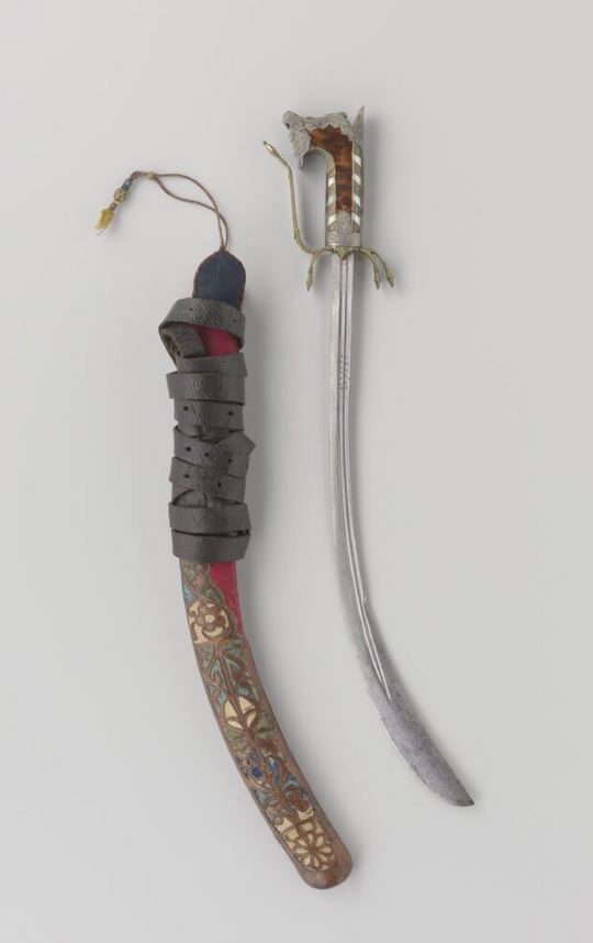

The top example strongly resembles the 17/18th c. example in "Arms & Armor of Arabia", Robert Elgood, 1994, 2.1,

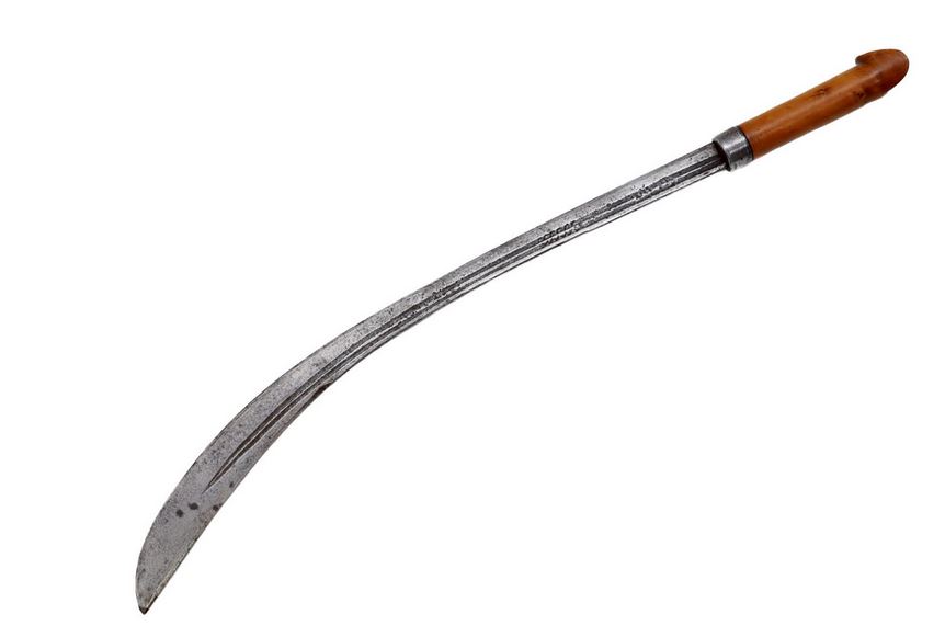

note the mention of resemblance of blade widening resembling the 'Moplah' weapons of the Malabar coast of India, where it seems these pirate vessels had certain contact. Both of these swords have similar widening of distal third of blade. While the mountings of both of these seem of course far more recent, the blades seem much older.
Would appreciate thoughts, ideas, other examples. I am not specifying these are 'pirate' swords but that they might be of the forms used by either these tribes of Ras al Khalma or perhaps Muscat. It is known of course that there was notable Yemeni influence in Oman, and the lower example, has a hilt shape with the blockish shape seen in the Yemeni sa'if (often termed Zanzibari). in example posted with ring guard.

Fascinating topic Jim. The swords you show, including the one in Elgood's book are all from Yemen. I have a similar one as well, but I am not sure we can link them to pirates from the opposite coast of the Southern Arabian Peninsula.

Teo and Lofty thank you so much!!!

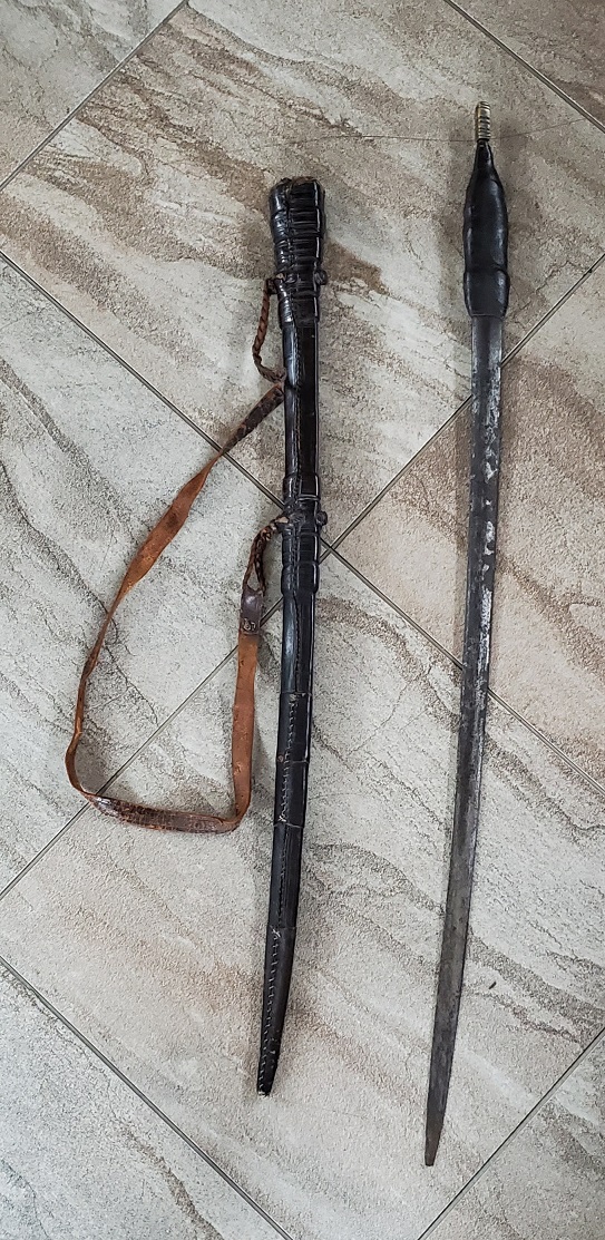

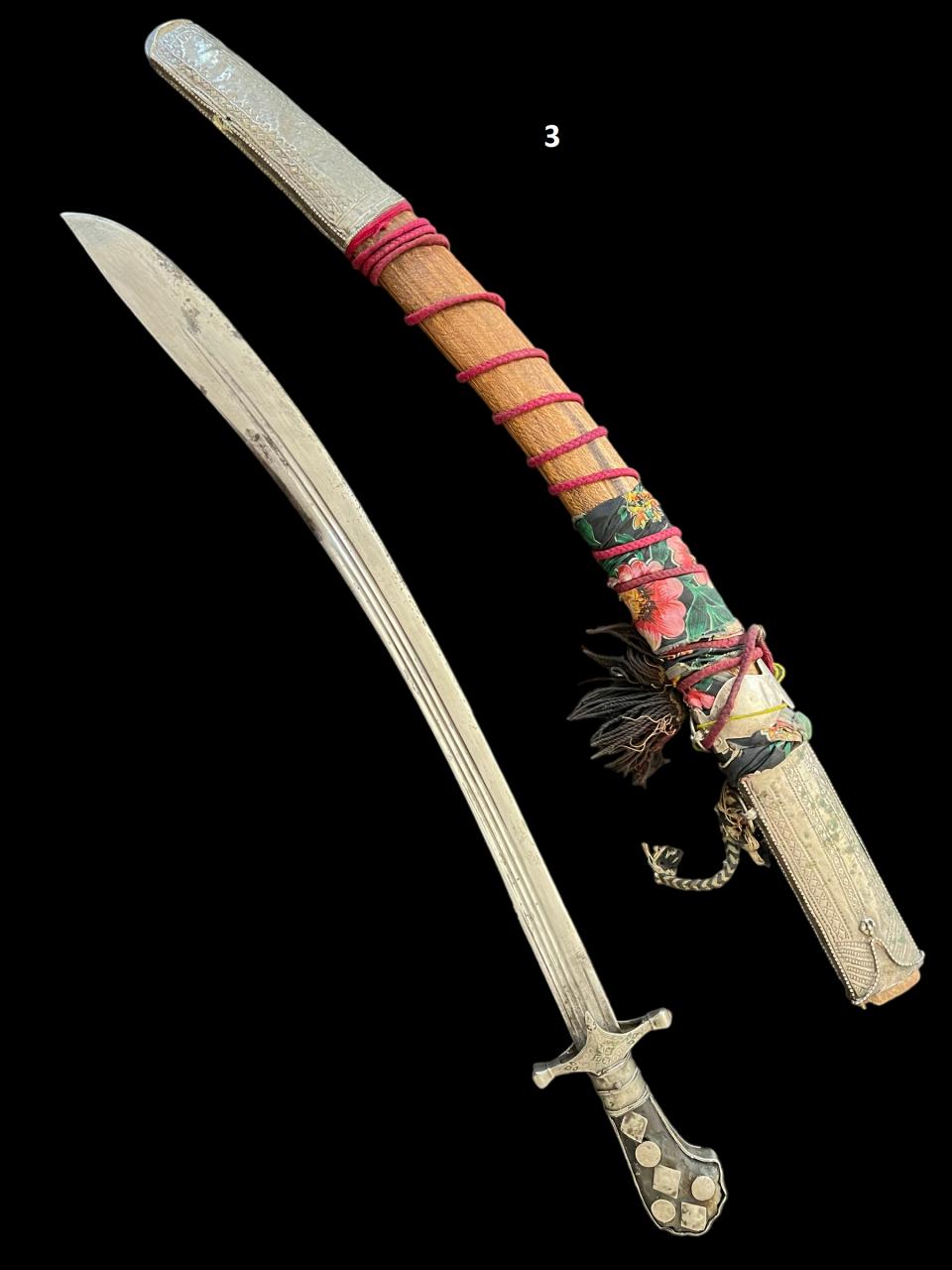

While my ideas were admittedly wild speculation as far as linking my examples to this rather esoteric sector of piracy (the raconteur in me could not resist).....it is wonderful to have definitive attribution to these.
Though the examples I have cannot be linked to these regions as I had hoped, I think the topic itself deserved further pursuit. As always in research, often one door closing simply means others to open.
It does seem Yemen carries the recognition as a primary source for the wider range of sword types in the collective of Arabian forms, with of course the Omani examples having their own distinction. The sa'if I pictured in the last photo is one of the types in the so called 'nimcha' genre, and with the ring guard typically has been classified as 'Zanzibar' type.
In Buttin (1933) these, along with the other similar types are collectively termed sa'if, without further specification. I have often wondered if these sword types have had colloquial terms used locally for them (beyond the 'collectors' terms widely used in references).
This example when I acquired it about 20 years ago was said to have been part of a number (about 40) swords found in an old arsenal in Yemen, and these examples (mostly with ring guards) were said to have come from Zanzibar (hence the term applied).
I think the thing with identifying swords in the context of piracy itself is pretty much futile in most cases,as naturally, these groups operated largely independently and would use whatever weapons available. With that being the case, of course any number of weapon forms might have been taken in their 'activities' thus there was likely quite a range of possibilities.
It seems likely that individual anomalies might have filtered in with those instances, but as you note Lofty, the forms through regular trade channels into the Qawasim sphere would seem be most familiarly present.
I look forward to those images!
Guys thank you again! I hope the topic itself can keep going here......my curiosity is totally piqued in looking further into the swords which indeed might have been used in these regions by pirates.
While the Qawasim leaders seem to have been established as wearing the standard Omani sa'if (commonly termed kattara in collectors parlance) with the open cylindrical type guard, the other forms noted would be interesting to see as well.

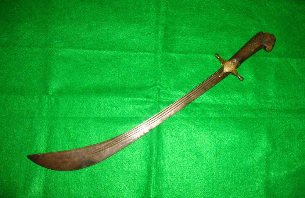

I see what you mean on the Yemeni/ Zanzibar (Oman) form sa'if (like #1 commonly termed nimcha), cruder and simpler. These hilts actually seem cast.

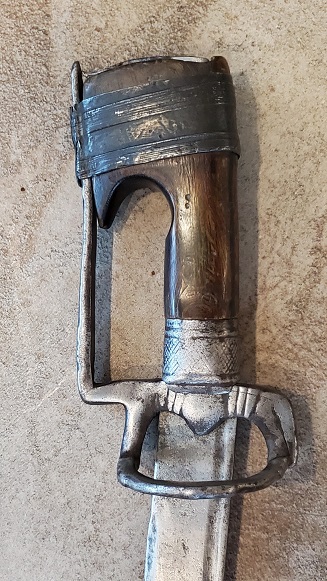

The conical Omani sa'ifs as noted (my example #3 is pretty rough) were it seems often highly embellished, silvered etc. as worn in a status oriented sense. In research a number of years ago, as per burton (1885) and Demmin (1877) these were entirely unlikely as combat weapons.
However the similar conical hilted examples with curved blades (usually German) were. These were the actual 'kitara' swords (illustr. #4).
I agree with your observations on these Omani forms being most likely in the Hormuz, Muscat areas, and if any of the Yemeni forms did find use there it was surely incidental. Thank you again, well explained insights!

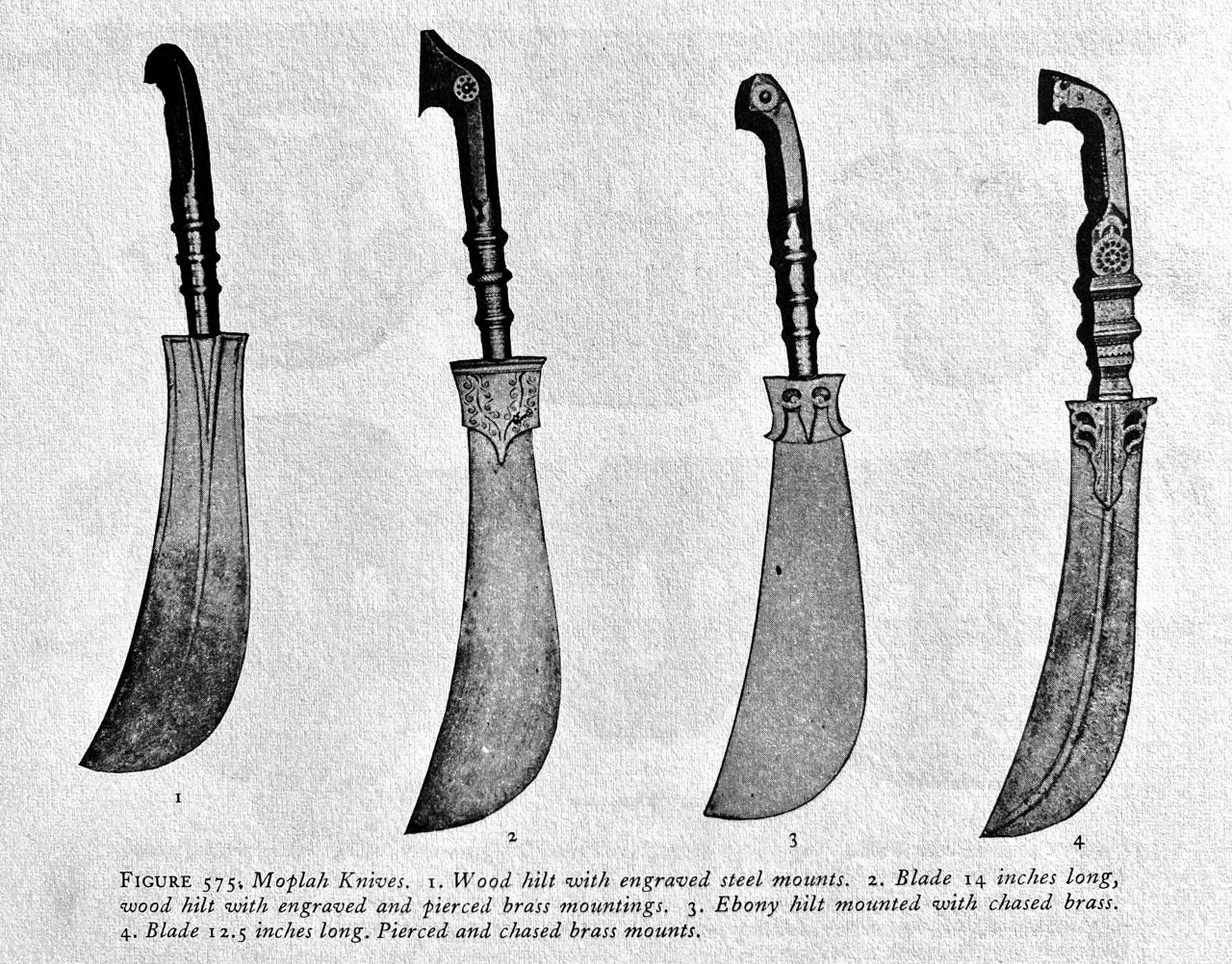

Jim this is an excellent topic. The wide blade in the Moplah style is fascinating.
I think this is an important design transfer dating before the rule of Saaid The Great. I think that the hilts are also similar to the Nimchas from both Zanzibar and Morrocco. In my view I suspect that the Omani Navy used the Zanzibari Nimcha format for weapons probably Naval Officers dress Swords long before the appearance of Saaid the Great in about 1806....It may be remembered that he influenced weapon designs on Omani Khanjars of the Al Saaidi style and reformatted the hilts of Sayf Yemaani ....Other designs such as the Cummerbund and Turban are also down to him and of course the Omaani Sayf ...a straight bladed conical Hilt with very flexible blade and perhaps 30 years later the sister to it The Omani Kittara with the curved blade and identical Hilt from Bunyoro-Kittara in The Great Lakes ....In pointing to the Moplah style of blade you indicate a valuable and entirely plausible case for the Moplah to have influenced Nimcha blade design right through the region ... Thanks Jim ... Excellent indeed!...

The 'moplah' type blade does have pretty old ancestry as per many of the references, Elgood notes it as 17-18th c. and it seems "Arts of the Muslim Knight" has these shown (need to find the photos).

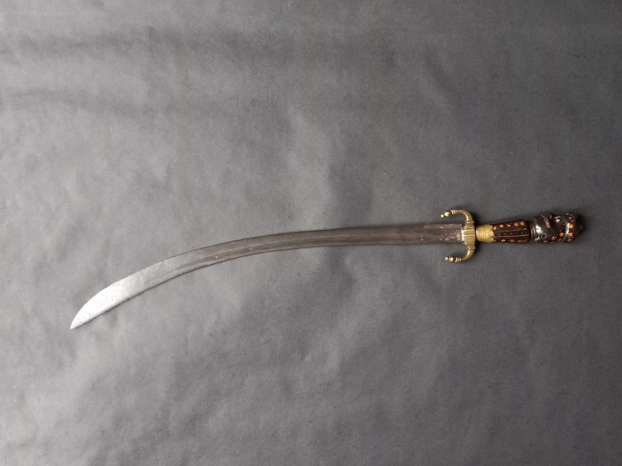

It seems one of these (with the Maghrebi style guard system,as pictured below) was captured by Thomas Hopsonn in 1676 from an Algerian corsair. It seems this further supports the Yemeni associations noted by Lofty and Teo on these weapon types, and with these 'Moplah'(?) influenced blades.
In this, there is still a bit of potential for a 'piracy' connection with these two examples, tenuous though it may be. The hilts are clearly far more recent, however the blades resembling the earlier types noted may well have been circulating in these earlier times.
In that case, the regions of North Africa where the Sale' Rovers operated from that city/state in Morocco, as well as the notorious Barbary corsairs from the various Barbary states 17th into 18th c.
It is surprising to know that many of these 'pirates' were actually former European privateers, who moved into these regions in peace time to carry on with their 'trade'. Usually these men converted to Islam and took new names.
As with the often far ranging regions where these groups of 'pirates' operated, along with the complex trade networks which were present through all these areas, the diffusion of weapon forms must have been remarkable.
With that ratiocination, there are of course many possibilities.
Still, by the numbers, the suggestions for probable 'pirate coast' (eastern Arabia) connected to Oman and the 'Barbary Coast' (North Africa) and its connection to Yemen (S. Arabia) seem most plausible.

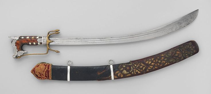

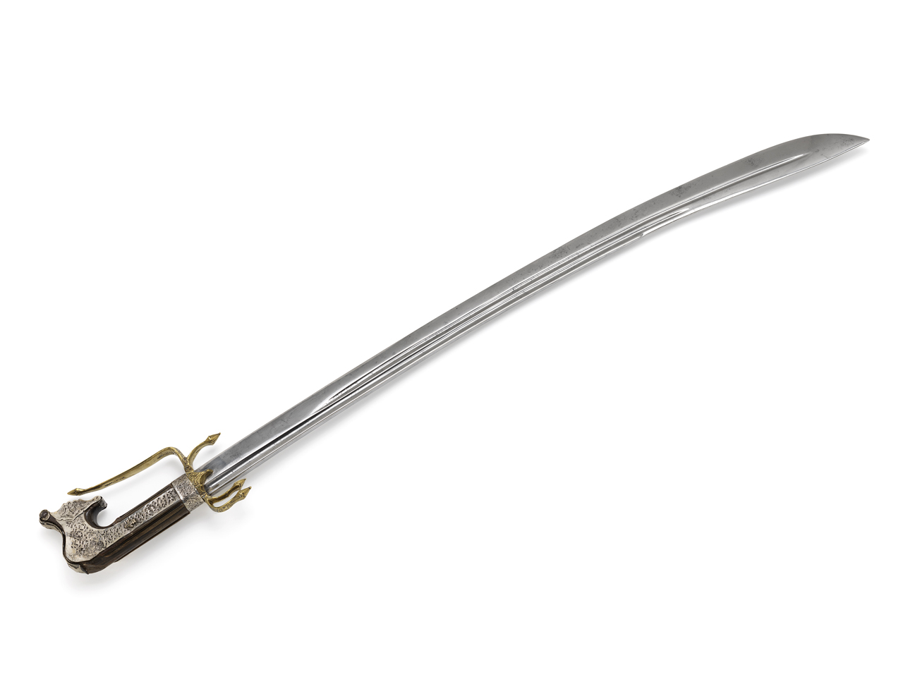

Jim, the nimcha you have posted is the one from the collcetion of the Met in New York. It belongs to a type of which there are multiple examples, including one captured by the great Dutch admiral De Ruuyter in 1655, a couple in the Real Armeria reportedly from the battle of Oran in 1732, as well as other examples without provenance or dating in Malta, St. Petersburg and private collections.
Hopsonn's nimcha currently in the Maritime Museum in Greenwich is slightly different, as you can see on the attached photo of it, but generally from the same time period and just of a slightly different grip style. it is similar to another nimcha in the Rijksmuseum that belonged to Cornelis Tromp.
Personally, I do not quite see the connection to the moplah/adya katti. The Moplah cleavers have the cutting edge on the opposite side. On nimchas the blade seems much more likely to have derived from the Italian storta and the Ottoman and Mameluke blades (the yelman part).

Here is a link to the storta in the Met Museum, dated to ca. 1490. It is often shown as a sort of a predecessor to nimchas, and one can certainly see some similarities.
https://www.metmuseum.org/art/collection/search/24904
I am not aware of any nicmhas that predate this storta. The earliest nimcha is potentially an example in the Hofburg Imperial Armory with a straight broadsword blade and gilded mounts in Ottoman style. At least Eric Claude dates it to the 16th century. The nimchas in Malta are almost certainly not from the Great Siege, but from later naval engagements (the knights were just as much into piracy as their Ottoman and North African adversaries).
All in all, Anthony North's theory all the way back from the 70s that the nimcha derives from the storta still seems the most plausible to me today, at least when it comes to the blade and guard, while also accounting for Ottoman influence. The grip is more mysterious and that may actually have South-East Asian influences, if not origin, but that is a different topic.

Thank you Teo, I think you're right, the storta, with this interesting hilt form reveals the kind of guard system seen on the nimchas. I think this was discussed by the late Tony North in his article "A Late 15th Century Italian Sword" (Connoisseur, Dec. 1975).
The blade types as you say probably do derive from falchion types of these early times, and the 'moplah' thing is more comparative for the heavier flare distally. I have always wondered just how much of the flared blade came from falchions, as well as the widened blade yelman, then of course the Meditteranean kopis (which indeed had the inside cutting edge) all of these features having varied considerations.
It has always seemed that the Italian influences on the edged weapons of so many places have been profound because of the prolific trade contacts, so much so I was compelled to buy the huge "Armi Bianchi Italiene" volume (1975) . In studying the development of so many forms, the Italian ancestry being so consistent, it was essential.

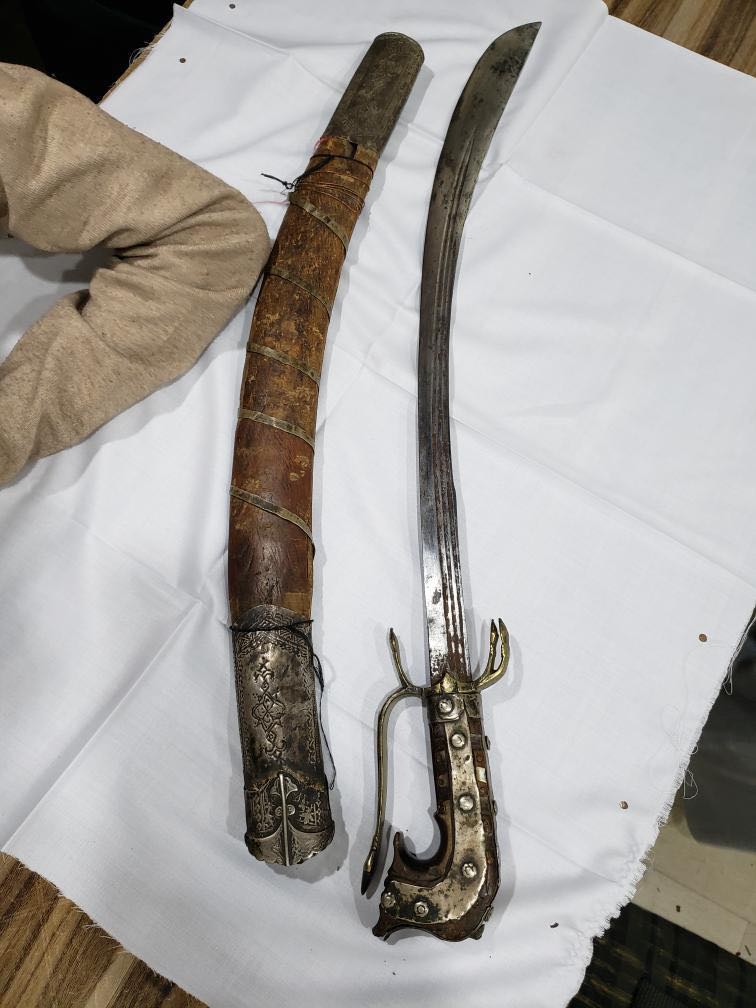

I remember emailing you images of an 'Algerian' nimcha that was found in Yemen with later Yemeni mounts. It was restored but I shall upload the before and after images upon receiving it. Perhaps the mariners had influence on Yemen which explains the high usage of short blades.
Last edited by fernando; 10th February 2024 at 12:00 PM. Reason: Please do not quote entire previous posts, just relevant small sections when necessary.
Old 10th February 2024, 10:44 AM   #14
A.alnakkas
A.alnakkas's Avatar
Join Date: Nov 2010
Location: Kuwait
Posts: 1,340

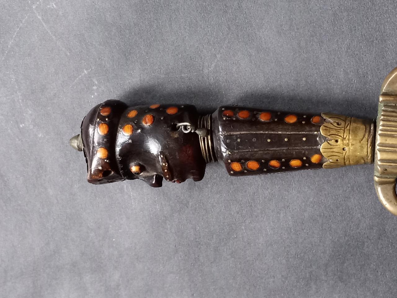

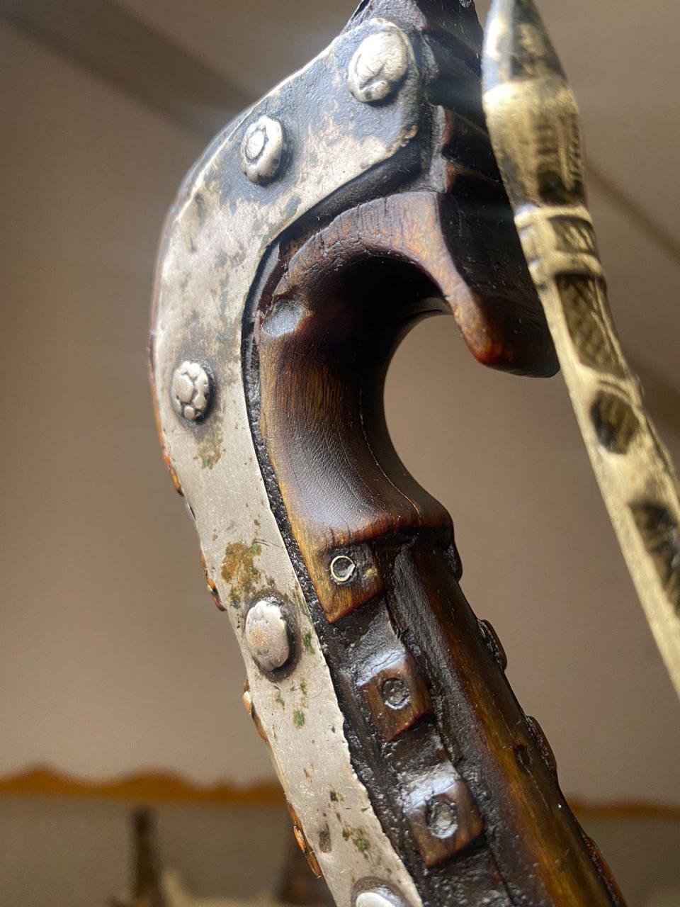

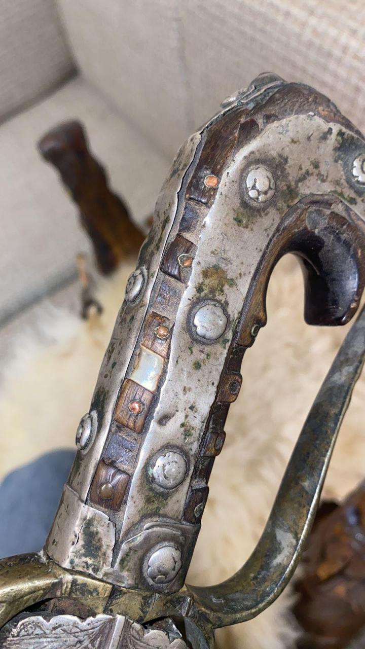

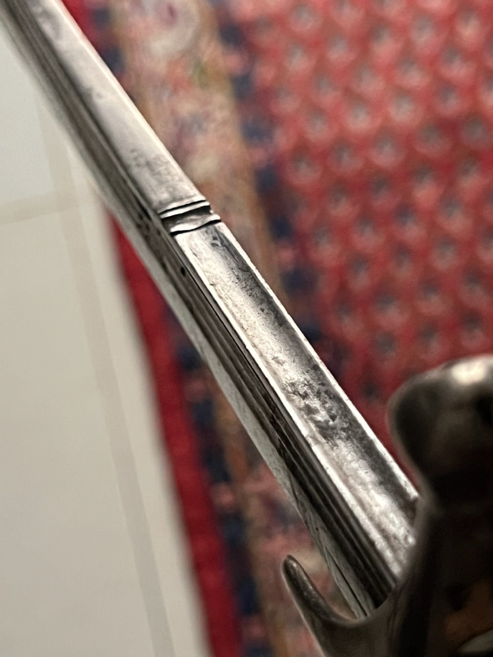

Here are the images. Note that the nimcha will have further restorations to the hilt with MoP and coral. though my restorer will confirm if its a viable option or will negatively effects the handle.
This particular example has two lockets which is odd, the older having Ottoman style niello work over a later, 19th century Yemeni locket (matches the chape and carrying rings) so this likely had quite a journey. The blades on both examples are short cutlass type.
Last edited by A.alnakkas; 10th February 2024 at 10:49 AM. Reason: Additional images of the hilt added
Old 10th February 2024, 10:49 AM   #15
A.alnakkas
A.alnakkas's Avatar
Join Date: Nov 2010
Location: Kuwait
Posts: 1,340

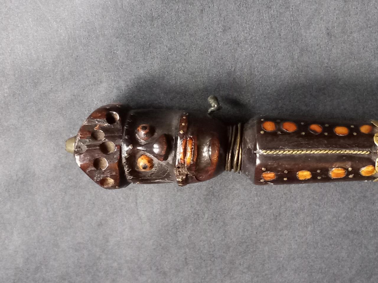

Images of the nimcha hilt
Old 10th February 2024, 03:18 PM   #16
Posts: 10,852
These are great examples Lofty! and its amazing to see them restored.
I think the hardest thing in describing these variations in the spectrum of Arabian sa'if is the terms used for them. Though often not linguistically or geographically correct , these typically serve well semantically in specifying which form or example is being referred to.

Very interesting Lotfy, thank you for posting these. Do you also have pictures of the blade of the Algerian nimcha?
Yes sir. I am mostly using old photos of when this was being prepared for restoration. The blade is in much better shape now.
There appears to be both import and 'local' production of relatively good quality. I am mainly basing this on the varying finish quality but all seem to maintain the very wide spine and drastic distal taper.

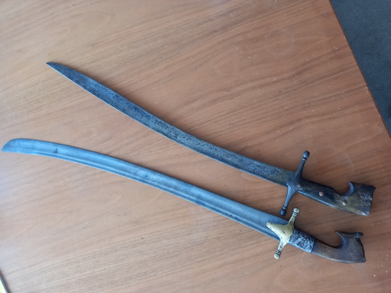

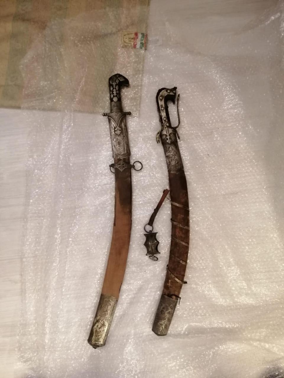

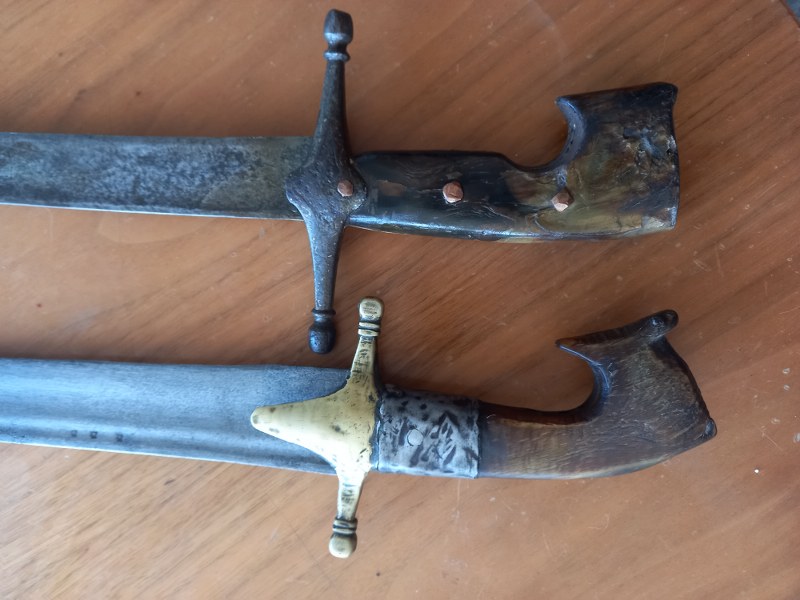

I believe these two are for pirate use also.

Eftihis, the sword and yataghan you show with nimcha grips could have certainly been used in a naval context, and in fact, it is even likely that they were.
I very much agree, and it seems that Arab swords in these forms were likely used in maritime contexts as the Arabs were of course so prevalent in trade which of course was by sea.

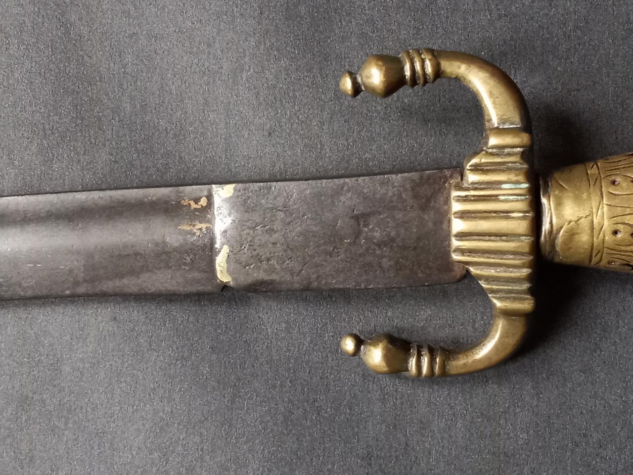

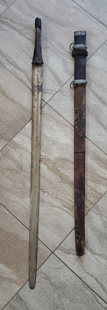

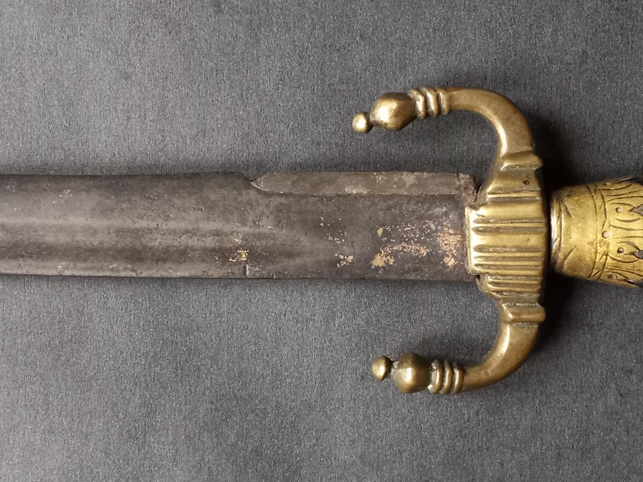

I would like to correct my earlier posts where I showed a sword which I had assumed was one of the 'kitara' swords, which was in fact a Manding saber from Mali.
The first image is the one in question; the 2nd a proper Manding saber.

Hello Jim, Your #8 Post shows the clear evidence of several design features probably made through cross regional movement in the Indian Ocean... Here I want to comment upon the broadened blade aspect of such a design movement also shown at #2 By TVV. . Clearly there has been a lot of sword design flow across the Indian Ocean
I have looked through some excellent entries on Forum in this regard and at the web in the case of the following reference https://www.mandarinmansion.com/glossary/moplah-sword centuries gone by.
Key artwork for inclusion here is on the distinctive broad blade of the Moplah...my suggestion being to illustrate how such a blade could well influence swords could have been influenced across the Indian Ocean from the home of the Moplah.. The Malibar Coast.

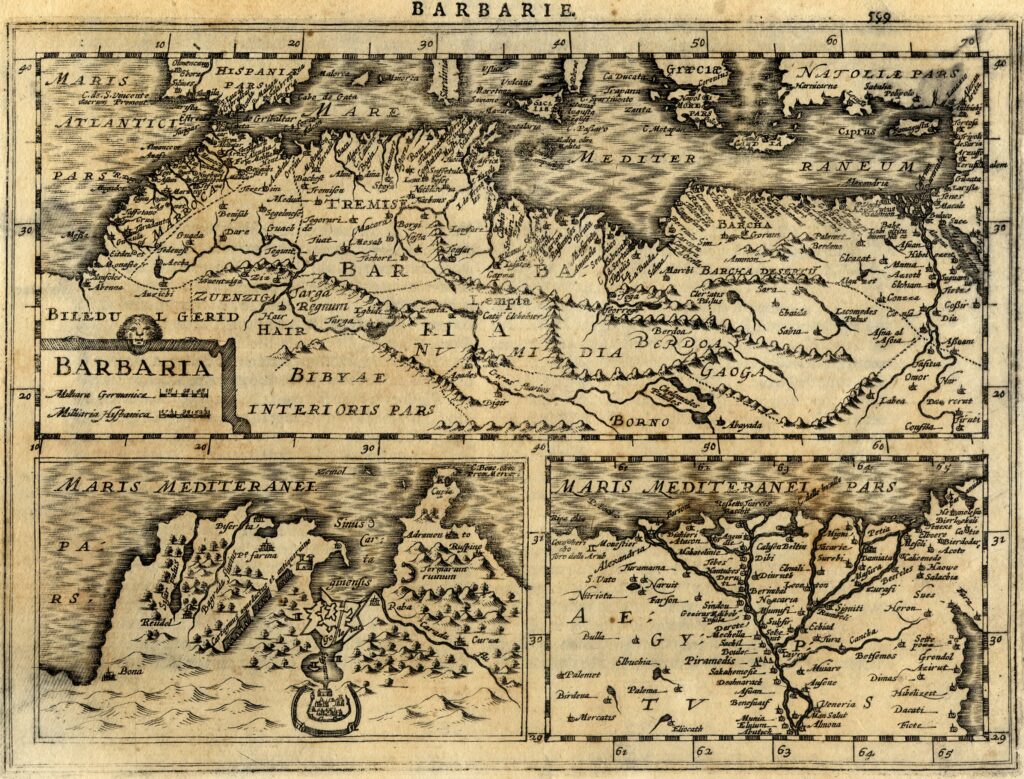

With regards to the Barbary Coast, there is quite a diverse and interesting history as part of it was / concerned the present Moroccan city of Salé , where I have worked for a year in 1980.
It is opposite Rabat , separated by the Bouregreg river and used to be an independent for a while and a cente of the pirates.
Many of whom were Dutch renegades, like Jan Janszoon van Haarlem (AKA Moerad Raďs 1570- 1641).
Enclosed a sword captured by Michiel de Ruyter, most likely in the battle at Salé, approx. 1640-1664, Rijksmuseum NG-NM-10412. I can highly recommand a visit to the city of Salé !

Absolutely, the so called Sallee Rovers were the forerunners of the Barbary Pirates, though Im not sure if they melded into the Barbary category or not.
This is amazing artwork and adds so much to the context here.
These activities were prevalent along these coastal areas of North Africa and which seem often to have extended much further to other coasts.
It is interesting that European renegades often joined the ranks of these 'rovers' and that circumstance prevailed into the 'Barbary' period as well.
formally the Sallee pirates reported to the Ottoman Empire, but had some independence. This was more or less centrally controlled from Tunis and Algiers.
Later the Sallee pirates took on a special status. But many Dutch renegades were found in both places.
It is interesting to see that the Dutch VOC was a prominent arms dealer at that time. Along the entire coast you will see cannons in the kasbahs with the VOC sign and city name; From Tangier, via Sallee, Safi and El Jadidah (Mazagan)..
pics :
CUTLASS BARBARY PIRATE SHORT SWORD 1650
and a Barbary Corsar AD 1500-1800 Torquay Museum
and most interesting:

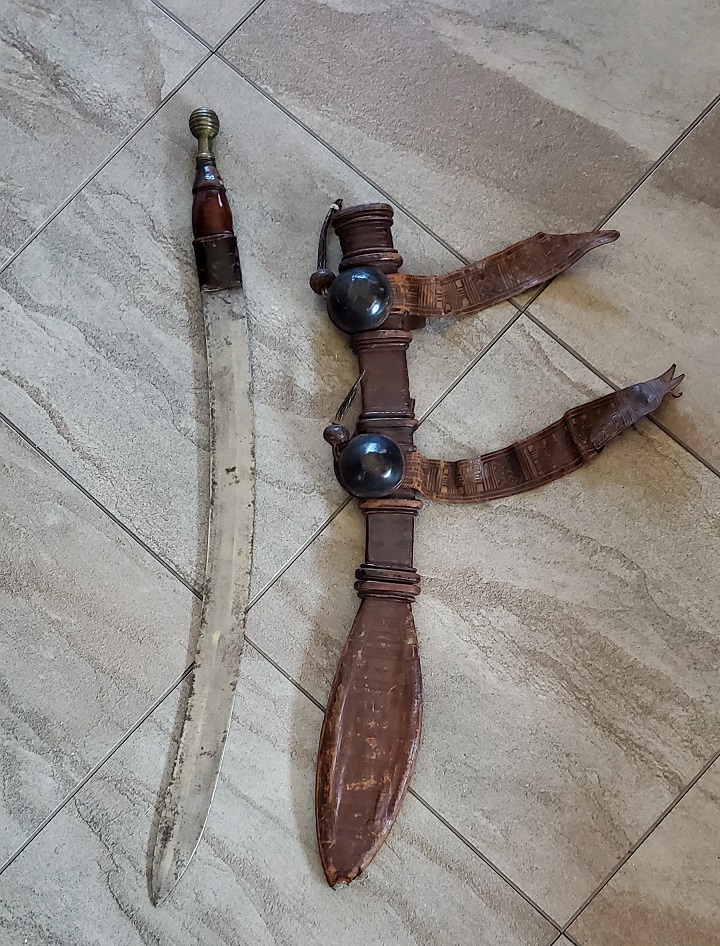

On the topic of Italian influences on Indian Ocean pirates, what do you make of this one? The hilt is a typical example of the "Turk's head" type of mid-eighteenth century Genoan dagger, but the curved blade resembles that of a Moplah knife (Albeit, quite a small and delicate one.). At the same time, the pommel cap design reminds me of Zanzibari nimchas.
Orang Lama is offline   Reply With Quote

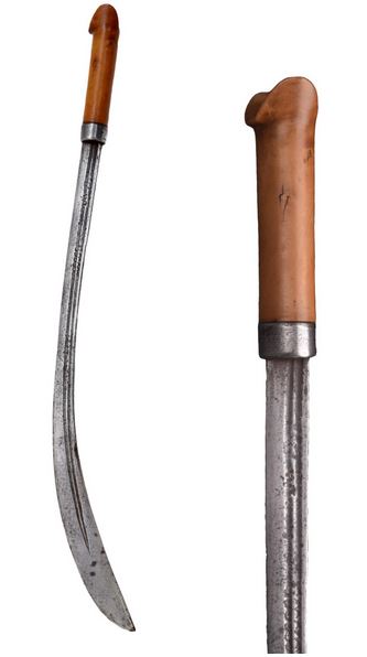

The Ottoman Sword most likely to have similar aspects as the Zanzibari Nimcha is as below The Pallash. The Hilt is very similar and has quillons almost the same etc etc... The Ottomans were there in the Indian Ocean from the 16th C and the design flow could easily have followed that situation. The paragraphs above clearly show Ottoman equipment including Cannons being supplied to neighbouring countries by sea routes well established in that period. Copying what was a shipbourne sword style would be a very plausible step. See the picture on my next post please.
Peter Hudson
Last edited by Peter Hudson; 17th February 2024 at 12:32 PM. Reason: adding artwork
