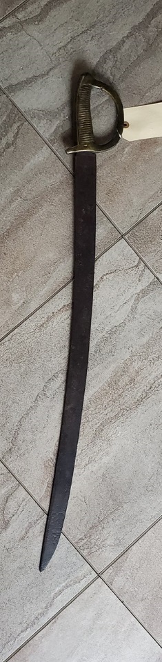

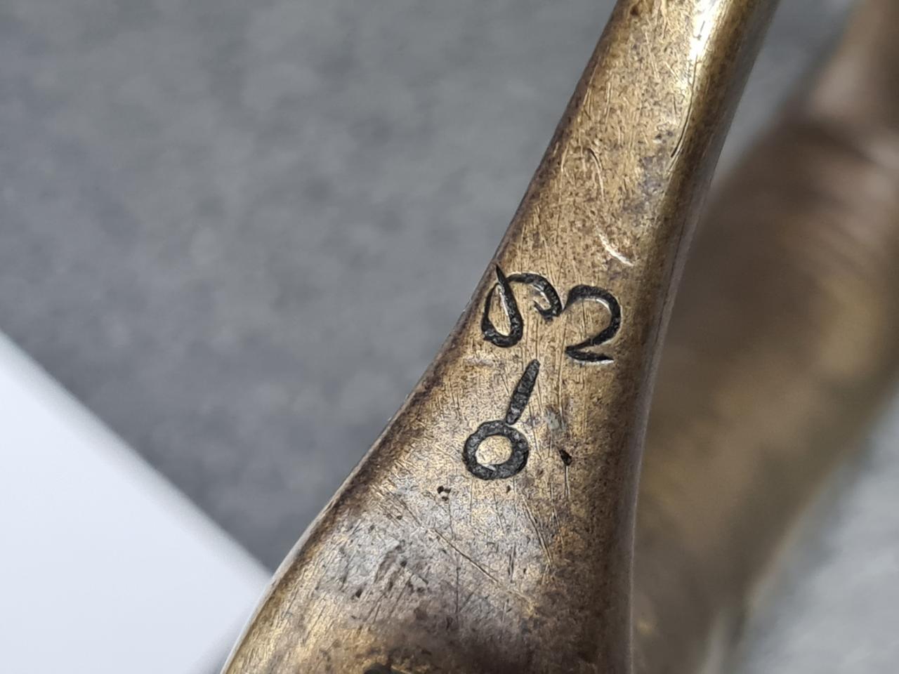

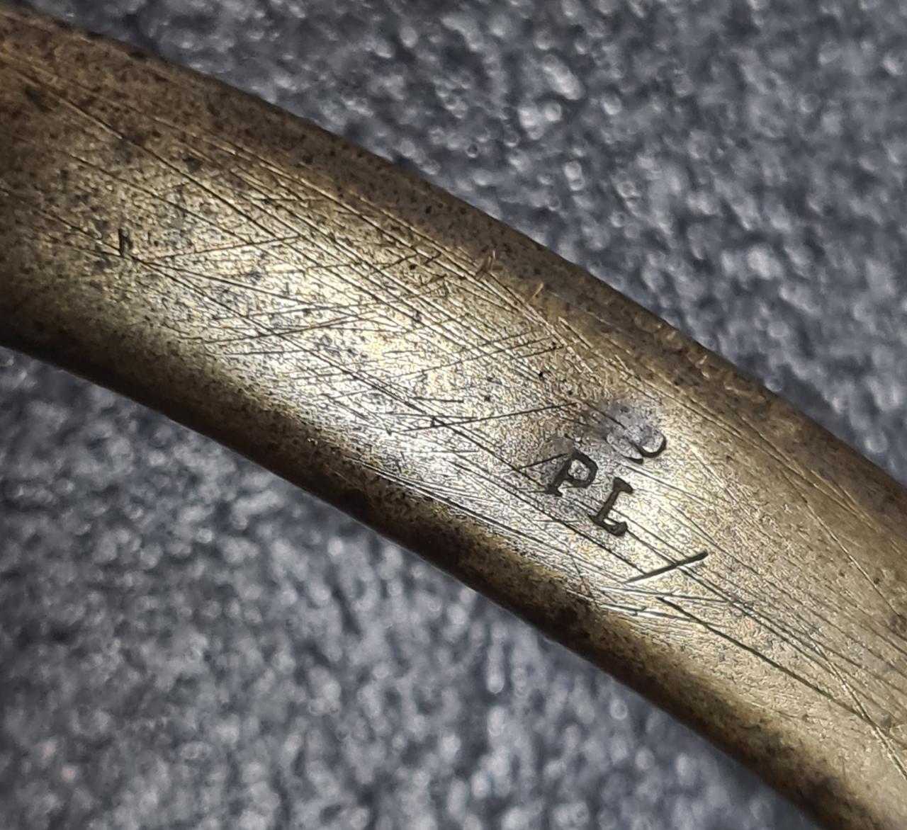

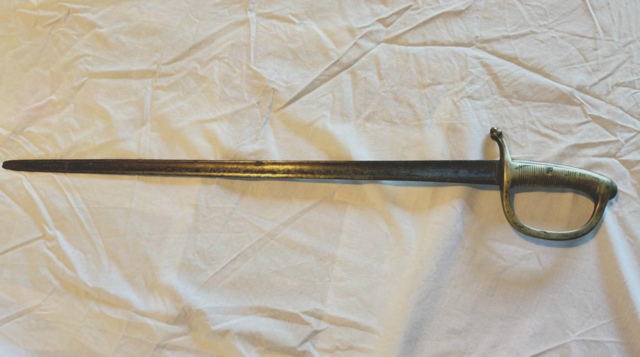

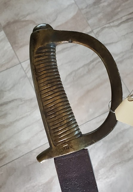

Friends just shown me a sword he picked up in Bali/ Indonesia, shop keeper said it was Dutch, has a small crowned PL ( Paul Luneschloss?) to the brass knuckle guard and what looks like Islamic? Siamese script to cross guard. Any thought appreciated.

Please post a full length picture of the sword, as required for all translation requests. Thank you.

sure, ill remember that for future, full length photo, think blades a period refit, you'll see tang pins been removed

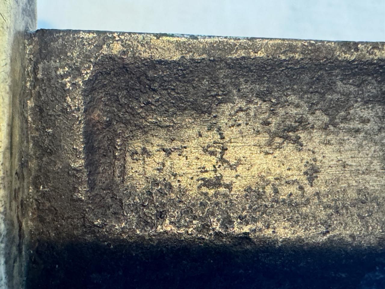

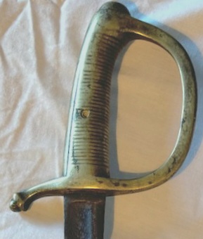

handle, note drilled for tang pin

This is of course an example of the ubiquitous 'briquet', which is the common infantry sidearm used so widely throughout European countries in the early into mid 19th century.
However, this example is profoundly unique in the history it holds.
According to J.P.Puype "Blanke Wapens", p.74, #108.
This is an infantry saber No.2 (M1819) which is indeed a briquet following French model ANIX (1801).
The tang button is apparent in the example shown.
The crowned PL must be some sort of regional acceptance mark, especially with the crown. If not mistaken Luneschloss was later in the century (not that this pattern did not remain in use)...and in my impression used the initials PDL in marking blades (often in oval cartouche).
As noted, this was from Bali, which, while most of Indonesia's population is Muslim, Bali is 87 % Hindu. These markings appear to be Sanskrit characters.
Perhaps though a Dutch weapon, this example was issued to someone in a local levy or police unit?

Only thing I will add is that the Crown over PL is likely an inspectors stamp. The auction catalogue for the Dutch Army museum sale lists such an inspectors stamp (but doesn’t show an example) so it is quite likely to be a central rather then regional mark.

As for the sword Phil's friend has aquired, looking closer at the blade, I suspect that it originally came from a Dutch m1820 infantry officers sword, which was an identical copy of the British 1796 Pattern infantry officers sword.
I personally doubt the replacement was done 'in period', but it would have happened during the 'working life' of the sword. Most likely the briquet blade had become so worn from re-sharpening that to get the remaining utility out of the handle someone matched it with a broken officers blade.
Even with the shortened blade, the sword shown would still make a perfectly adequate slasher.

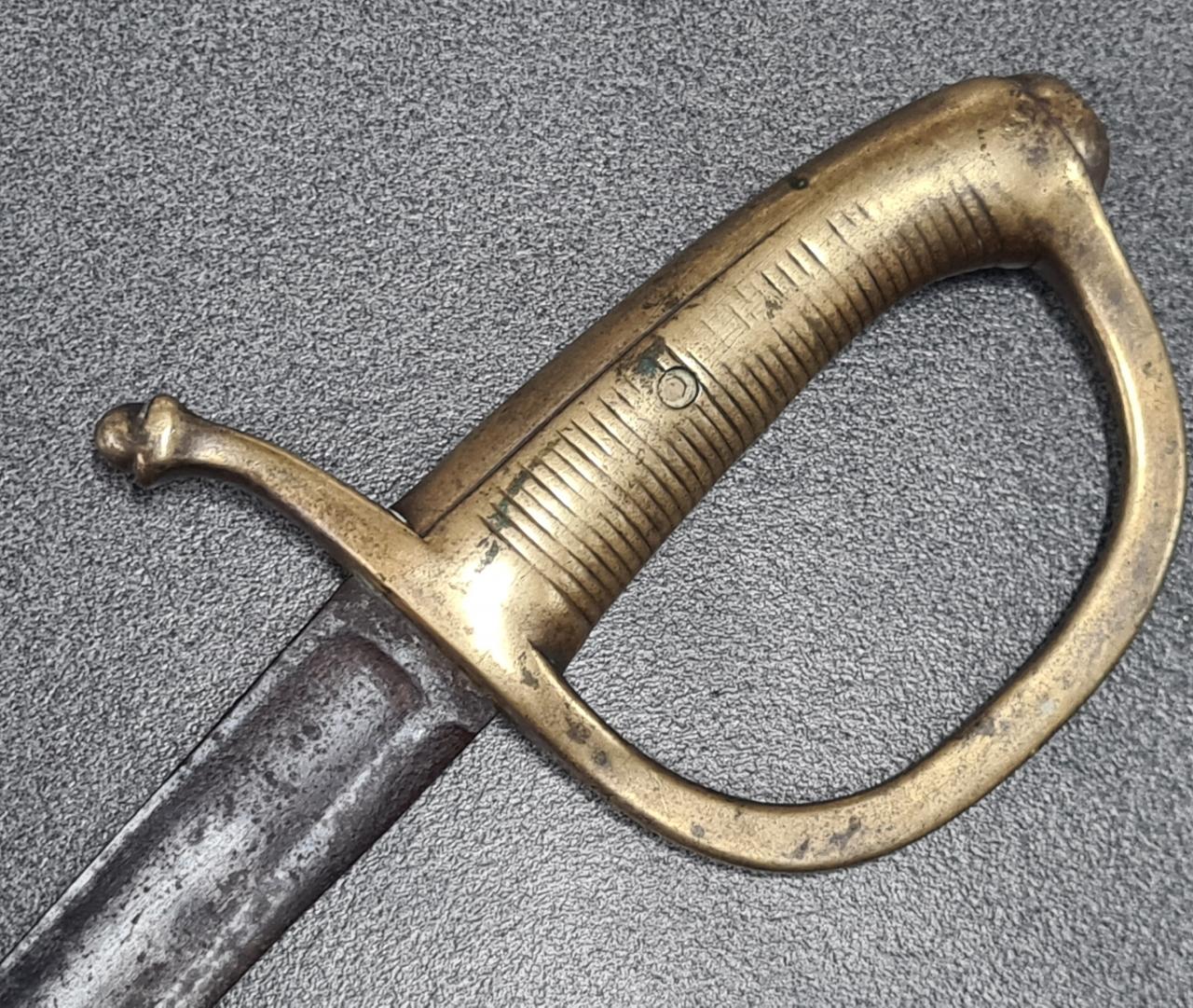

It seems the 'briquet' was one of the most ubiquitous patterns of simple other ranks hanger with its fully cast brass ribbed grip hilt in Europe, with most countries apparently having their production virtually all the same.

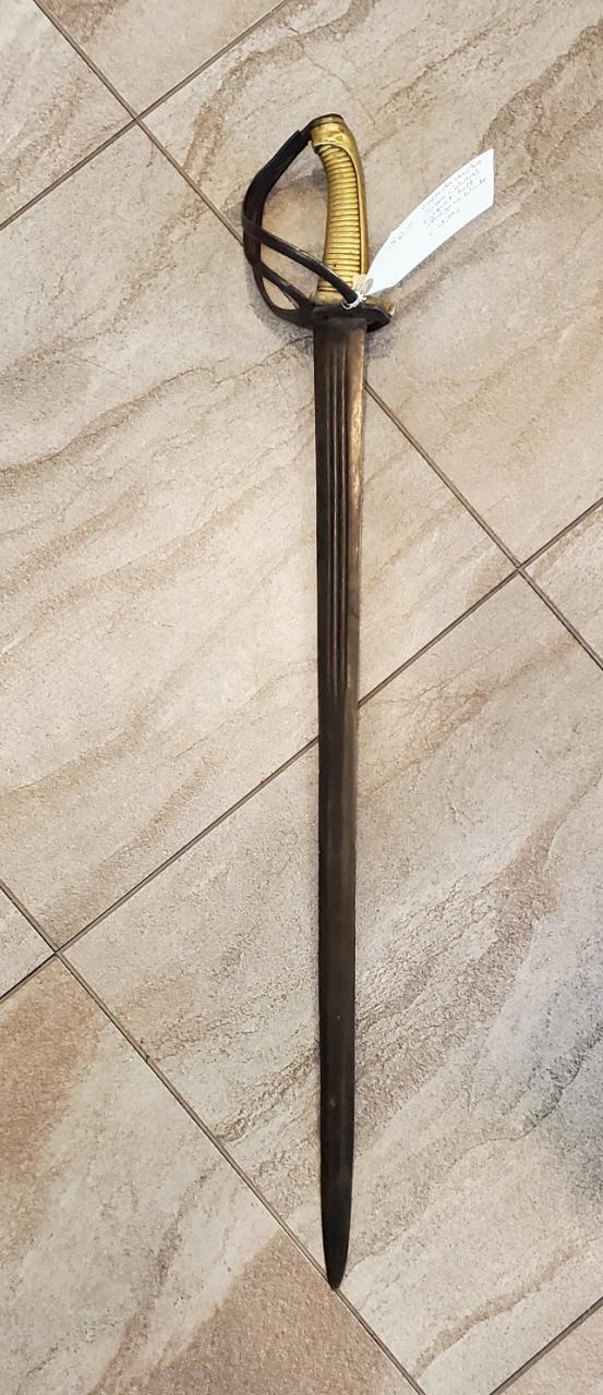

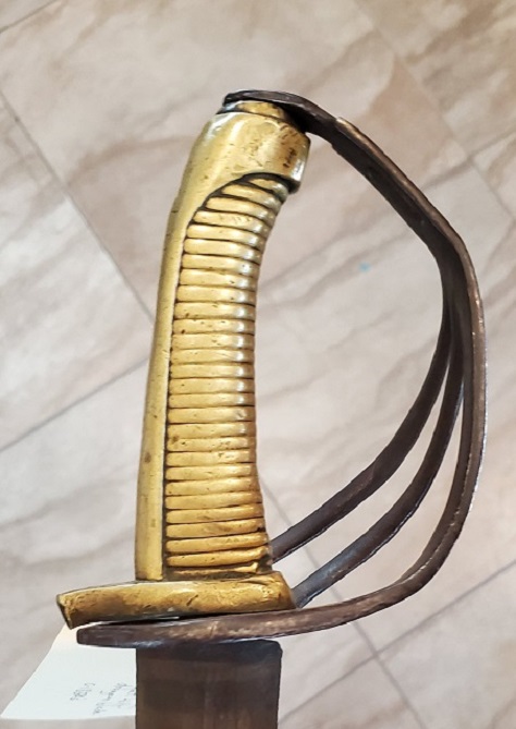

Such as this Spanish colonial anomaly, which is composite with a briquet hilt, three bar cavalry guard and cut down Spanish dragoon blade in an ersatz effort to create an 'espada ancha' presumably.
As Phil had noted, apparently the sword in original post has similar (but less dramatic) circumstances.

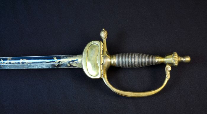

What is the length of the blade Phil? It seems somewhat short for a spadroon blade (also the fuller looks wider than the ones on the m1820s I've seen - but I've only seen a few).
EDIT: Pictures for comparison. Not entirely sure if this one is Dutch, though.

In my post #10, I showed the hilt of a briquet hilt, morphed into a composite 'espada ancha' with addition of three bar cavalry hilt and notably shortened Spanish M1728 dragoon blade. In the colonies of New Spain in the rugged frontera of North Mexico, repurposing of everything, weapons included, was of course common.
This seems to compare in kind with this briquet example shown from Bali, using a blade from other sword, shortened for wear or use more in the effect of a hanger.
Attached shows blade of the example I showed in post #10 , clearly a shortened dragoon blade.
