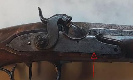

I am wondering if the lack of a makers name on the lock plate is an indication that it has been converted from flintlock to percussion. I don't know how to tell. Does the plate get replaced? The wood to metal fit around the lock is certainly not as good as the other side.

The arrow marks a place on the lock plate that looks as if the screw hole for the screw of the former battery spring was located there. This would prove that this is a former flintlock pistol that was converted to the percussion system. It would be conceivable that in this case the signature of the lock plate was removed after it had been softened.

Regarding what Corrado says, which is a modification of the spark key, you cannot clearly see the plug of the threaded hole of the frizzen spring. Nor can it be seen where the hole in his spike would have been. A better photograph would be needed, and above all, of the inside of the key. In addition, the threaded hole in the frizzen would be missing, which would have to be seen. Additionally, if it is a spark modification, the method followed for placing the bomblet or mascot, for placing the chimney, should be seen on the barrel.

You will also pardon me Udo, but i find it hard to process that this pistol has a converted system .
What I wanted to say is, that this pistol eventually has been converted

Hi Udo, now I understand and I have examined that area closely and there is no sign of a previous screw hole.
