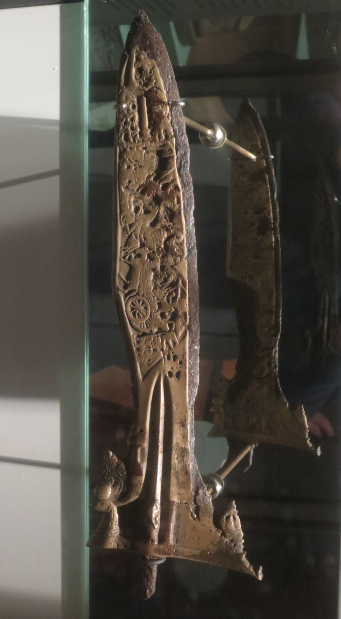

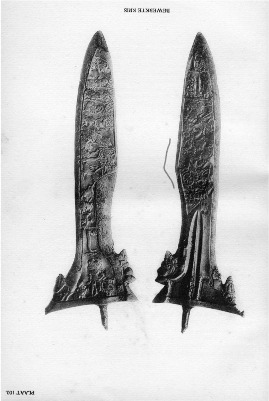

While reeding van Duuren's booklet I was stunned how thin in fact the story of Charles Knaud's brothers grandson (who "was familiar with direct descendants existence, but not personally acquainted with them") is - not better and not worse then contemporary keris-selling-stories in Indonesia.
There surely are many questions about this object, because almost every physical part of it is a question. I would like to adress a small, seemingly unimportant feature.
On the Sogokan side of the bronze plaque there is depicted a carriage, drawn by two horses (?) and a single rider on a horse. My problem with this depiction is a following one: until now I don't know of any similar representation of carriages wheels in such spatial way in East-Javanese period art.
The same I can say about the representation of the dynamic motion of the horse with rider - I don't know the proper name of this motion, let's call it a leaping horse. It is something we can find in Middle-East/Indian/European art, perhaps in later Javanese manuscript illuminations or Wayang, but until now I haven't seen anything comparable from East Javanese period.
Also exactly the same spatial rendering of wheels of carriage (and the animals which are drawing it) can be find on Wayang Kulit figures, which date back to 19th century.

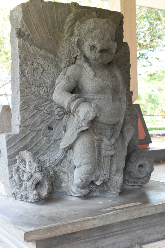

The possible possible model for Knaud's keris?
Old 3rd November 2022, 09:55 PM   #18
Posts: 7,230
Yes Gustav, precisely so.
This statue is located in the museum at Trowulan, the site of the capital of Majapahit. I visited this museum and took a number of photographs of this statue on 3rd. April 2018. This photo you have posted is exactly the same as one of my photos, but I cannot recall posting that photo to this forum.
That depression in the blade edge was caused by damage it is not original to the statue. The info board identifies this statue as either:- Garuda, or Minak Jinggo, or Maha Kala, or Bairawa. In other words they're not too sure exactly who it is supposed to be.
So, exactly when was that statue discovered and made available for public viewing?
This would have been before the Trowulan Museum existed because the museum was built in 1924, and Charles Knaud had the keris in his possession long before this.
When we know more about the statue, then we have the possibility of knowing more about when the Knaud keris was actually produced.
When I photographed the statue I made no connection between it & The Knaud, it was only later when I was looking at my photos of it that it dawned on me that I was looking at the inspiration for the Knaud Keris.
However, even without that gift of the statue with its damaged keris, there are far too many abberations present in The Knaud for it to be accepted as a product of the Majapahit era.

Gustav, I read your post #17 before your Post #16, but now I have looked at your #16.
You have reached the same conclusions about The Knaud that I reached about 40 years ago, but was unable to substantiate.

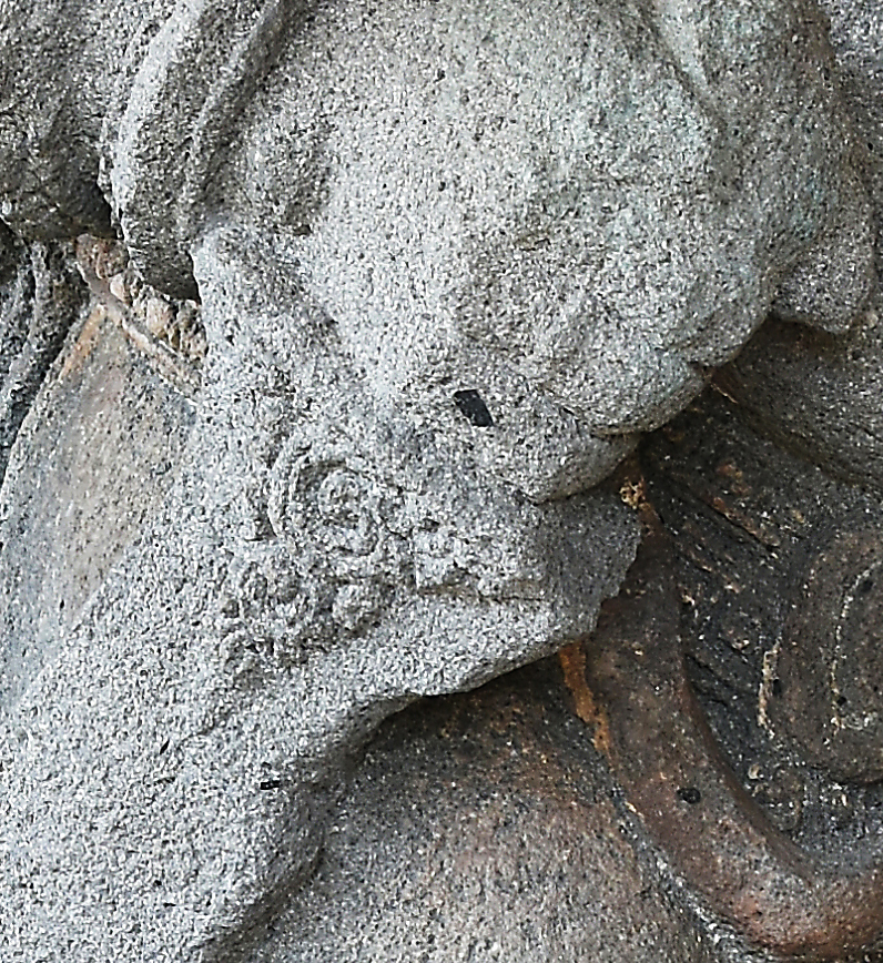

Lightbulb
Hello Alan,
Just for your peace of mind: You did post pics & close-ups of this statue here a while back.
We did discuss the broken edge of the blade back then. I did not made the connection that this might very well be the basis for the Knaud keris - it's a pretty convincing working hypothesis. Iconic and unique pieces/representations can be traps for forgers, especially when working from published pictures. If they only had stayed more true to the actual decor on the blade, the piece would have raised much fewer eyebrows!

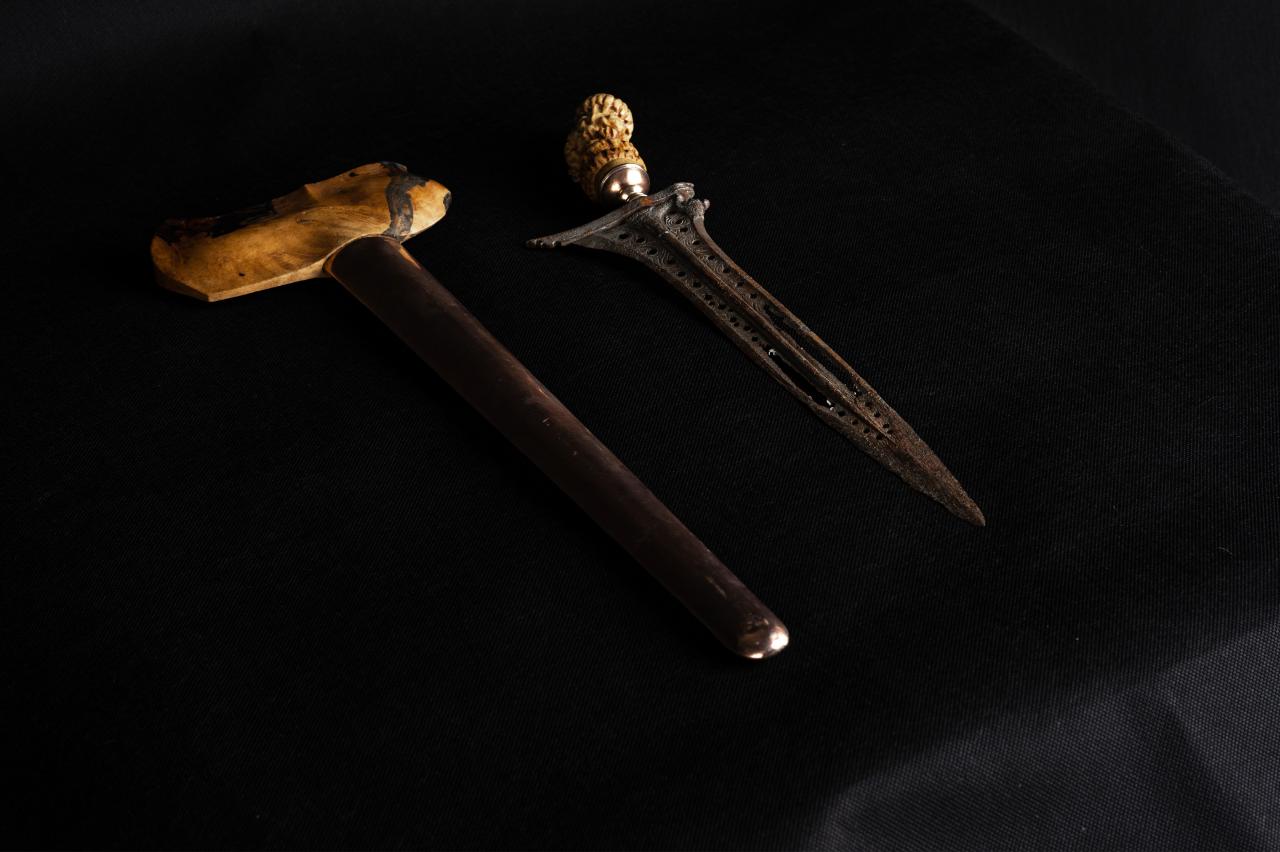

Old 4th November 2022, 01:51 AM   #21
Hello Gustav,
Thanks for your insightful postings!
I would like to make an illustration of that feeling with another keris, the state heirloom of Kutai Kartanagara. The tradition says, it comes from time of Majapahit, it is depicted as drawing in Schmeltz's article from 1890.
It's pretty clear that keris like these would be referred to as Mojo.
As you already inferred, it's obvious that quite a few of these keris buda (and related pieces) are of much later manufacture though.
Thanks for posting the pic - I had not seen any pic of this piece and it's a valuable addition to the artwork in Schmeltz!
Old 4th November 2022, 02:41 AM   #22
Posts: 7,230
Thanks for that Kai.
I did a quick search but I could not find where I'd posted it.
As I wrote in my previous post I did not really make a connection when I saw the statue, I was too busy dodging the photo police, it was only much later that I made the connection.
Yes, true that if the conman had made something that stayed true to type The Knaud would probably have been accepted as real, but if you want to sell something for big duit to an art collector, it helps if what you are presenting is a dated one off, and way, way back the internet was not around. I most sincerely doubt that even the smartest shonk could pull off something like The Knaud today.

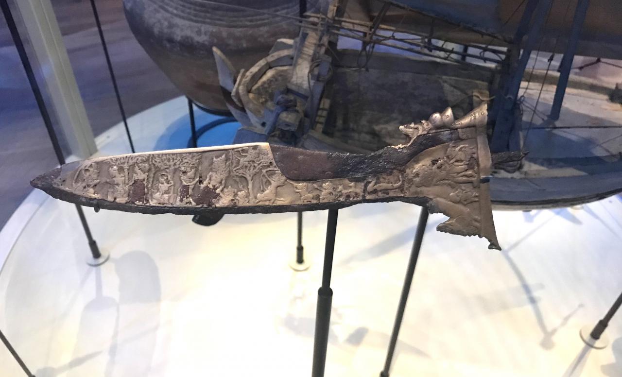

Old 13th December 2023, 10:20 PM   #27
Pendita65
Join Date: Feb 2023
Location: Amsterdam
Posts: 178
Default Knaud's Keris on display at WereldMuseum Amsterdam
Hi there,
i enclosed a picture of the Knaud Keris that i took two weeks ago in the World Museum former Tropen Museum Amsterdam.
I didn't read the book by van Duuren although i went through it quickly in the Museum store.
David van Duuren has been many years the conservator of the Asian department of the Tropen Museum and wrote several books about the Keris and other subjects of Indonesia.
Best wishes, Martin
