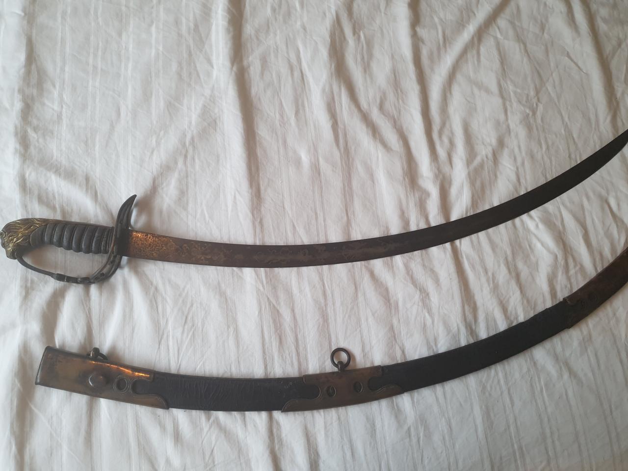

Reaching out to the Hive mind on a sword I picked up this yesterday. I have posted this on the FB page but thought that there are many who do not use social media.

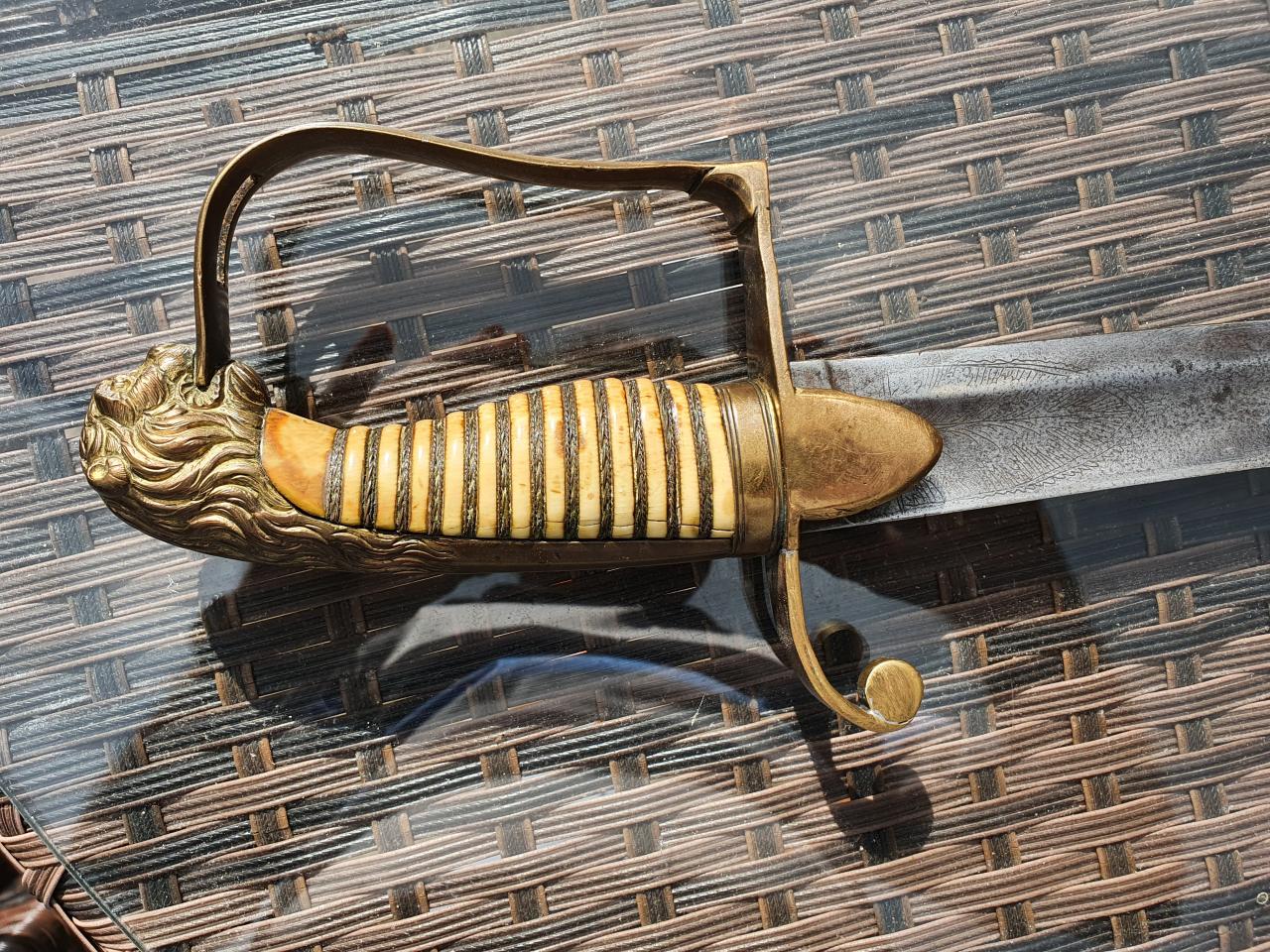

At the gun show, initially I saw a British Yeomanry or Flank officers’ sword, circa 1780 – 1800. The guard is white metal (nickel-silver), brass pommel & strap, ivory handle but the blade is an indo-persian shamshir! The blade has a definite pattern too it, the picture I've posted just hints at the pattern. I plan to very gently clean off the dried oil, nicotine and gunk to get a better idea as to the pattern.
I’m now thinking a composite sword, note how the guard fits the pommel and how the hilt has been peened to make it tight to the blade. Note that the ivory handle does quite fit the ferrule. Clearly, this sword was put together over 200 years ago but is this normal for Yeomanry/Flank swords to be non-standard or bespoke? There have been some interesting ideas on-line that this is a trophy sword but what does the Forum think?

I love these stirrup-hilted lion pommels with the sidebar. At first glance, I'd say British militia/volunteer officers sword rather than yeomanry.
As a rule of thumb, cavalry used steel hilts. But there are always exceptions in this period.

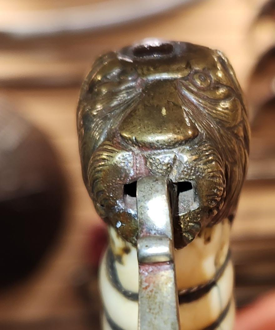

However, it is a concern that the metal between the guard and the pommel doesn't match. They should be the same and match the buttons of the officers' uniform. Also, I am concerned with how the tail of the knuckle bar fits in the lion's mouth. That is quite a broad gap, almost like it should be for a wider bar.
So my opinion is this is made from parts. It looks well done and like it was assembled a while ago, as the peen looks old but I suspect not 'in period'.

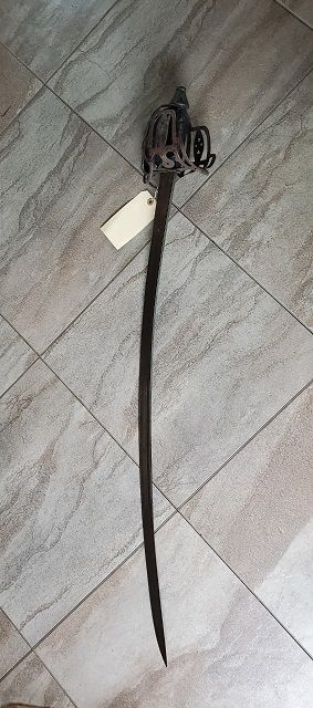

I have an 18th century munition grade military basket hilt (probably by Drury, London) which has been remounted with a M1788 light cavalry blade. I have seen two others like this. When the infantry ceased carrying swords after 1783, these were placed in stores.
It seems possible, that officers in Scottish units in the 1790s, as noted to carry sabers, several of these might have been remounted with these blades as fighting sabers. Admittedly speculative, but possible.

Thanks Jim and Radboud for your thoughts. I agree that the sword appears to be a composite, assembled maybe 1800ish. The guard appears to be of the Grenadier/Flank company type, pre-1800, the pommel and backstrap from a British naval officers sword, and the blade from a indo-persian shamshir.
It has been suggested that this may be a trophy sword, where the blade being captured is incorporated into usable regimental sword. Sadly, there is no history attached to this sword but I'm sure there would be am amazing story if it could talk.

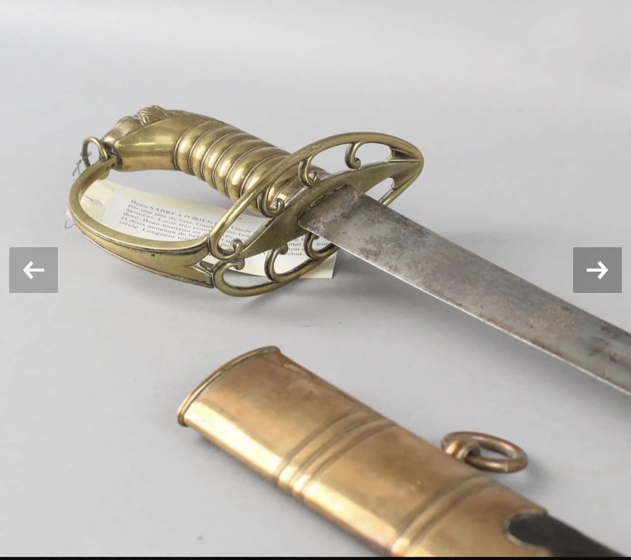

This one is one of mine, probably a presentation saber with a full brass grip.
