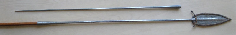

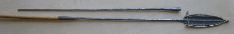

From where can these African spears come from?
Any information at all should be very much appreciated!

Hi,
These are common in eastern Africa (Kenya, Tanzania, southern Ethiopia) and used by several different people groups such as the Maasai, Pokot, Turkana, etc.
- ADS

Hi Stefan,
Its from the Maasai People, native Kenya/Tanzania,
Not sure on age or if it is a tourist piece as it looks very clean.
Ken

despite these being used by many tribes and ethnic groups , hey are really Loikop (Samburu) spears, very common, alongside the more typical Masai Lion spears.
https://en.wikipedia.org/wiki/Loikop_people
https://www.jstor.org/stable/124620
They are very common among the many tourists which flood Kenya and bring them back.
http://www.vikingsword.com/vb/showthread.php?t=21630
