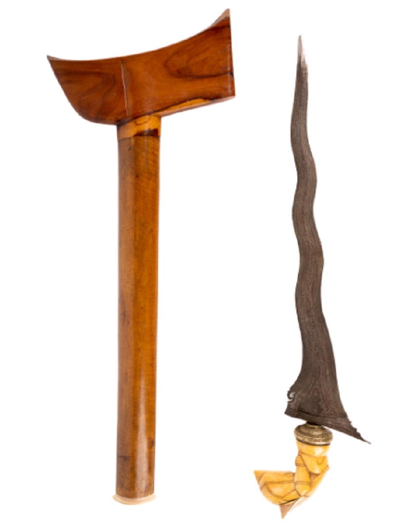

I have several keris that came from European (non keris culture) sources that have hardened layer of protective substance on the blade. This layer had darkened over time. An example is attached.
Can anyone suggest how I can get rid of this layer?
Many thanks in advance.

Hi Nik,
I really cannot see the problem you are dealing with from this image alone.
Can you share detail of the dilemma?
I've found the ugliest of surfaces can be put back normal with a citric bath and a toothbrush.
Gavin

If this came out of an old collection I would suspect shellac, lacquer or varnish would be the coating applied to the wilah.

Before you try the suggestions below go to the kitchen sink and try scrubbing with hot water, dishwash detergent & a hard toothbrush.
Light acid baths are used to get rid of rust, mineral turpentine will remove wax, methelated spirits will remove old fashioned shellac, there are various types of varnish, paint stripper will remove most old types.
I suggest you start with the turps, if that doesn't work use metho, if metho doesn't work go to paint stripper.
Paint strippers are nasty substances, read & follow the instructions on the container it comes in.
For all three work slowly and carefully, demount hilt first.

you can try with Nitro solvent.

I have had 3 times lacquered krises in my possession and I have had great results with boiling water. In fact I boiled the whole kris (blade alone obviously!) in salty water (it increases the boiling point temperature). It takes only few minutes and you see small bubbles forming under the lacquer. A soft brush (old toothbrush) removes the lacquer.
I spoke about this in a thread I created
http://www.vikingsword.com/vb/showthread.php?t=28617
